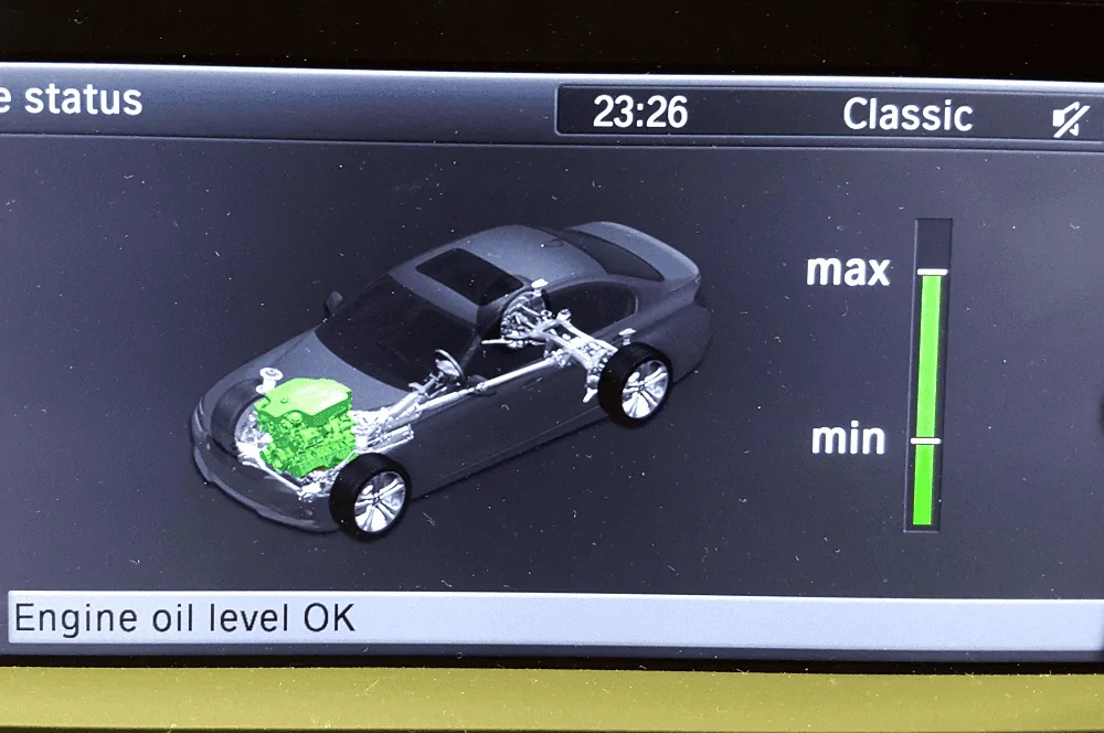

Take a look at my picture below. This is my A91 2021 Supra after an oil change at 1100 miles, and then a full track day (so you know i drove it hard) and then another 1300 miles driven with a mix of sport mode and normal. Car sits at just below 2500 miles. Based on the measurement, my car has only burned about 1qt of oil in the past 1300 miles. (including the track day). THIS is NORMAL behavior. You generally burn more oil during a track day since you're in the upper RPM limit for a lot longer but as you can see, i'm still within spec. I dont expect to see a low oil warning till i'm close to 12000 miles, however i tend to do an oil change every 6 months out of habit.
Could you please clarify how your image would tell us your car has used 1qt of oil? Your image shows your car is at max oil fill line. The gauge will show if you overfill the oil - indicated by any green shown above the "max" line.
My car at ~100 miles had shown oil at the max line (same as your image), as have others online who show their oil levels after an oil change or when their cars are new. I do wish our owners manual would provide a graphical representation of the oil level graph to reinforce this point, but in most cars I've owned (typical street cars) the distance between max and min typically equates to 1qt of oil.
I have previously owned VW, Toyota, and Honda products, so I am still learning about BMWs...but as I dig into BMW's of different generations and their documentation, I continue to find that the oil level should sit between the Max and Min lines - anything above or below the lines indicates either overfill or underfill. Included an example below.
Ah this could have been a mis-reading on my part. I was pretty sure that right after the oil change it showed above that line but i could have not remembered properly.
That being said since our cars and most modern BMWs dont actually use a physical dipstick, im pretty sure that line does not only equal one liter. However i have been wrong before.
I do agree i wish our manual provided more clarity on this and this was just based off of my own assumptions and what i've seen in other people's cars.
