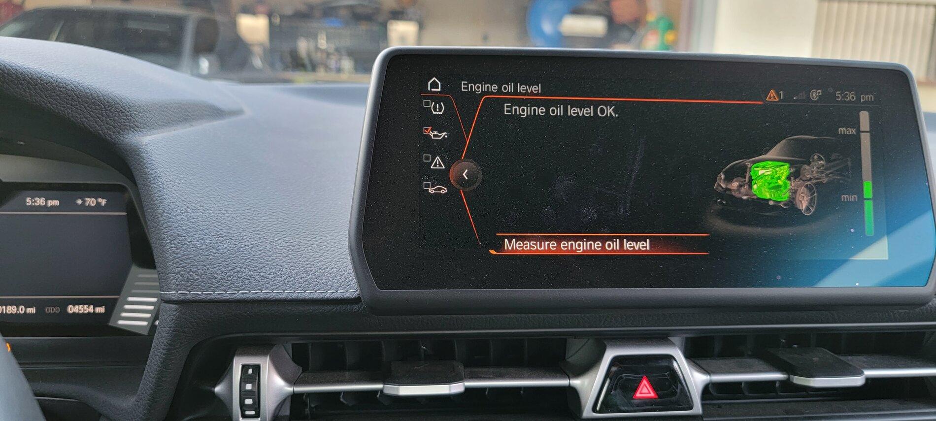

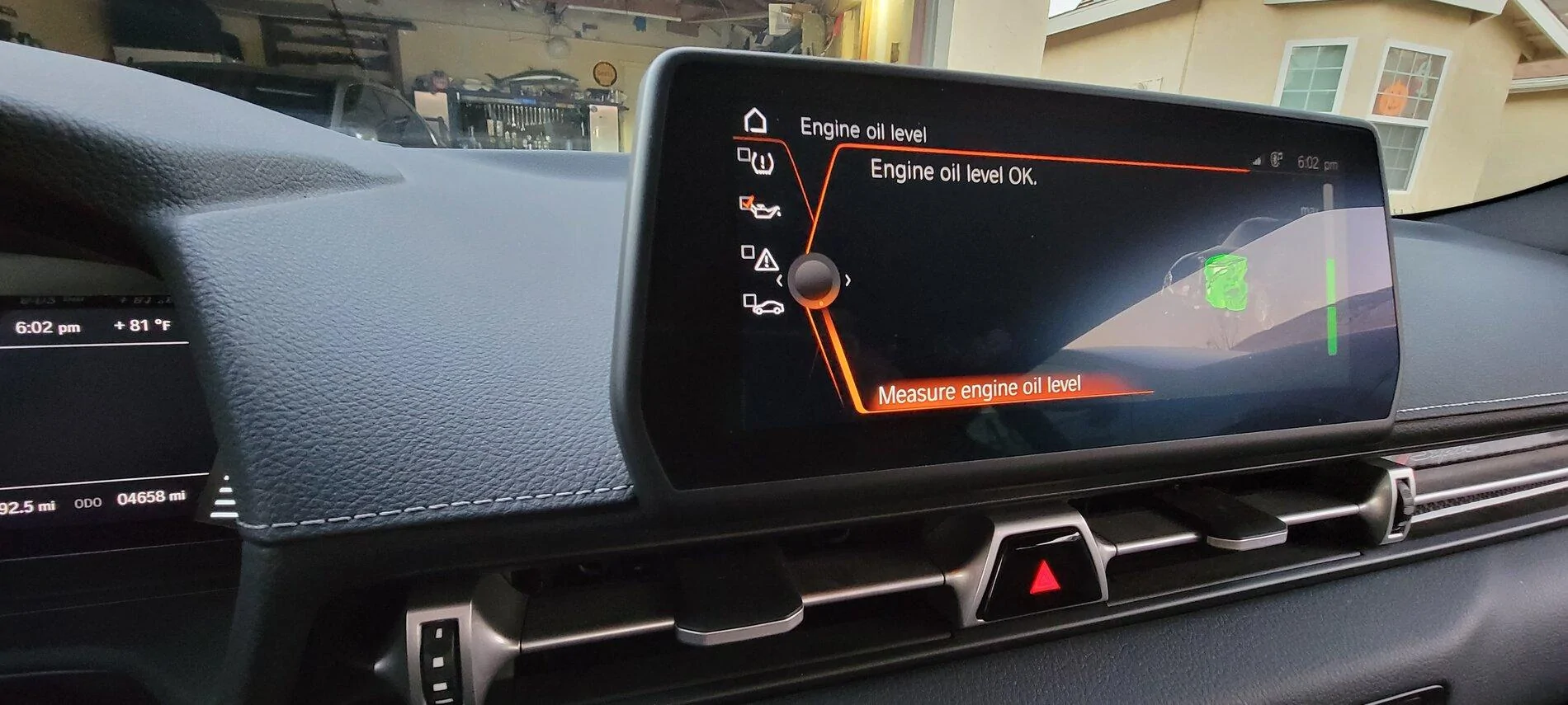

I think I figured these cars out. They actually fill themselves up the harder you drive them. Example. This is before my last auto-x event. 2550 miles on oil.
This is after my auto-x event @ 2650 miles on the oil. So ya, take your car out racing and it will magically fill itself back up!

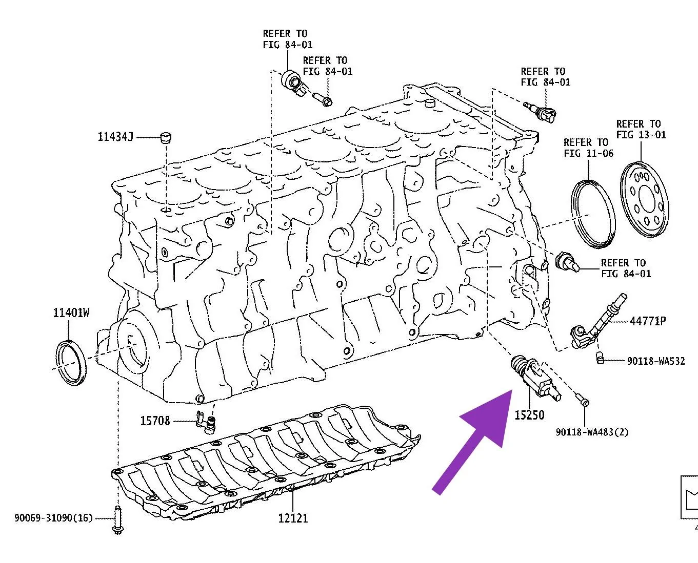

If mine had excessive oil consumption I would change this oil pressure control solenoid ASAP. A few people have reported improvements with it.
- Oil pressure valve assembly p/n 23950-WAA01

Your‘re right there is a bit of everything in here. I’ve only heard of 3 people that had their engine changed or Toyota bought back their cars.
-RJM
If I had a confirmed use issue, this would be course #1 to assess if it fixes the problem. Then continue to monitor as miles/kms accumulate.
-RJM
So what's the theory here that ties this component to the loss of oil? @RenRed2
