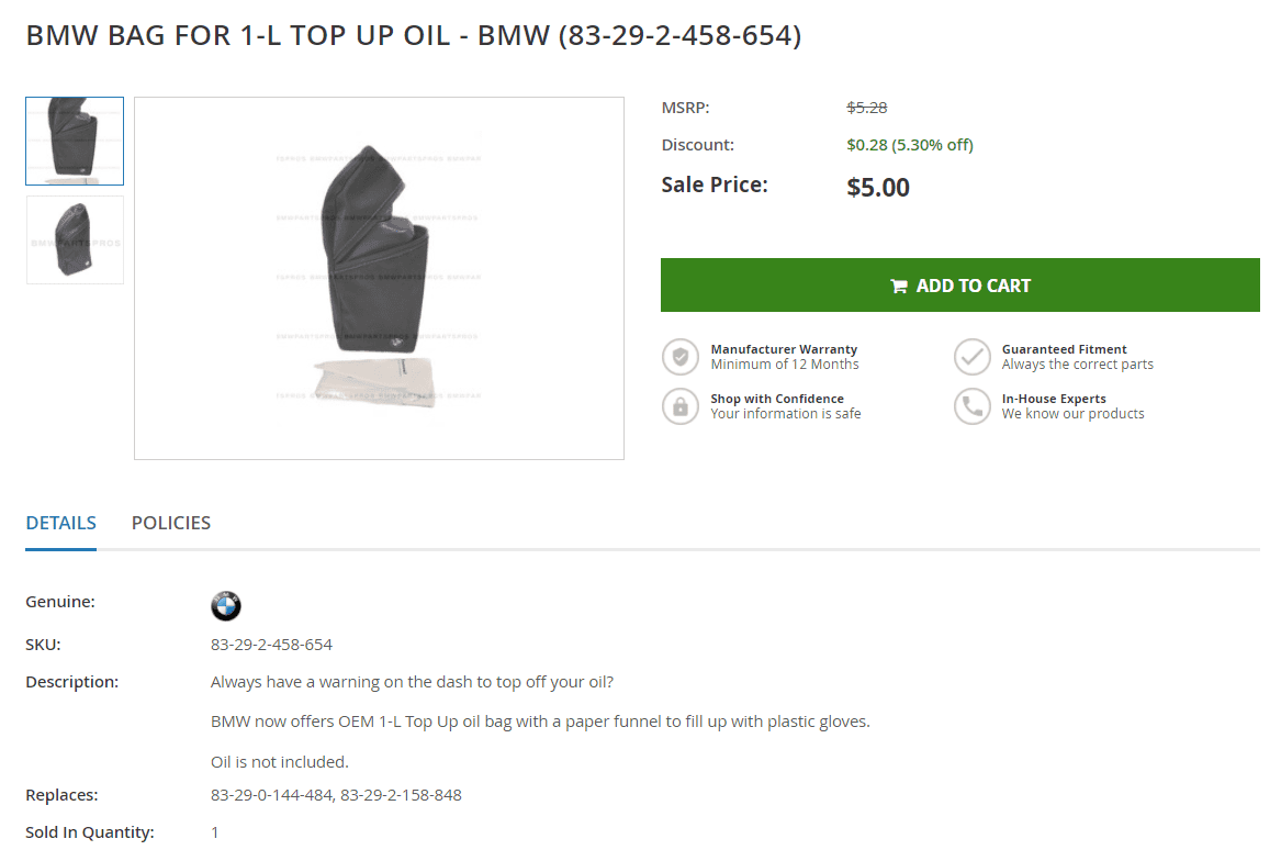

For those that need to keep that previous bottle of oil with them at all times...
