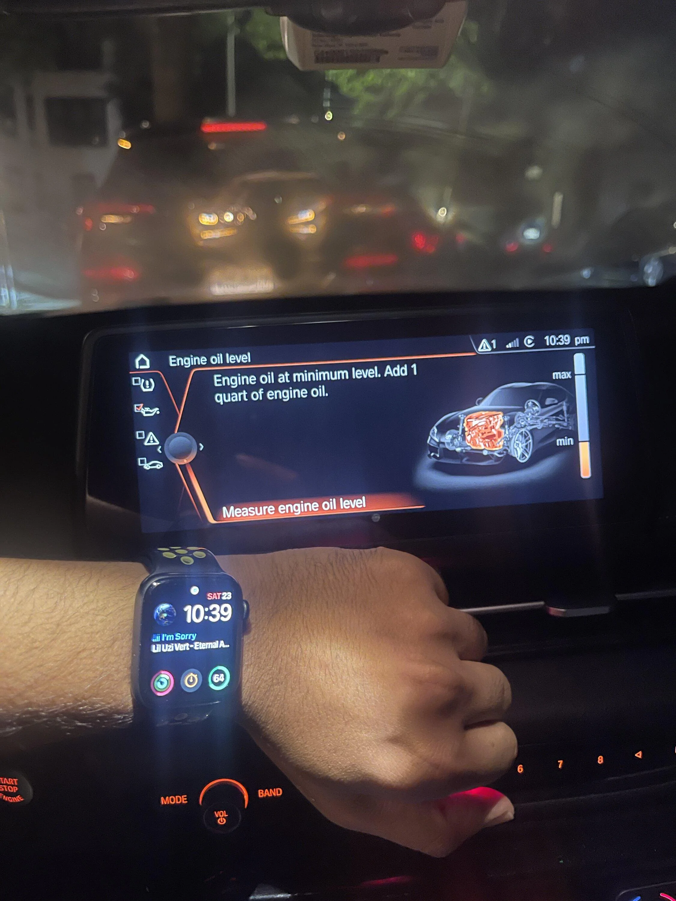

What would y’all consider excessive? A low oil level light came on last night. It’s been about 5,000-5,500 miles since the last oil change.
That's about normal

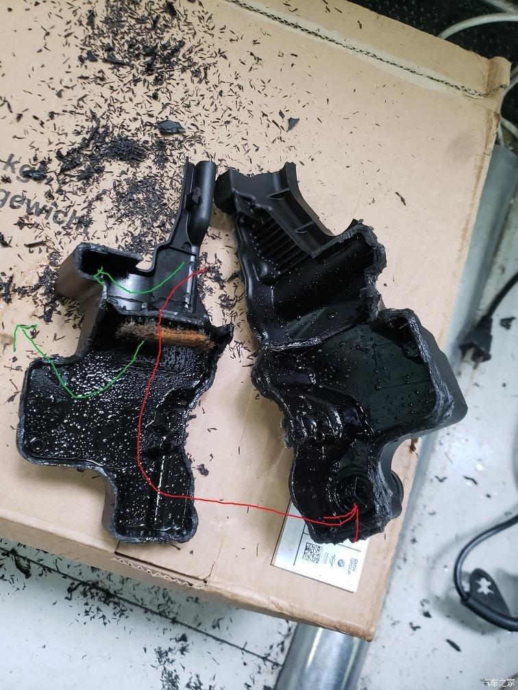

Updates on this, dealer tech first thought there was a turbo leakage, then I found there is oil on the pipe from the oil gas separator to turbo. Manufacturer tech came and said okay, maybe not because of turbo leakage, but some others. And he said the oil consumption issue is not as serious as what is said on the internet. I wanted to say bull shit. Taking a look at how BMW designed b48tu's oil gas separator, use a yellow cotton filter to filt the oil and gas:
(this is from someone cut b48's oil gas separator: https://club.autohome.com.cn/bbs/thread/64bd3f28bd3aa792/101352005-1.html#pvareaid=6835679)
For the next, they start a consumption test and will let me drive for like several thousand miles to see what's going on.

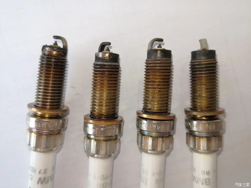

For people who have no matter b48 or b58 engines, which are manufactured from later 2020 to 2022 Jan 11th, you may check your sparking plug. For b48tu, which is what I have, if there is oil in your sparking plug of the first and second cylinder as followed (left two), then good luck~:
(https://club.autohome.com.cn/bbs/thread/a637986ca3c0c1a5/101269739-1.html)
