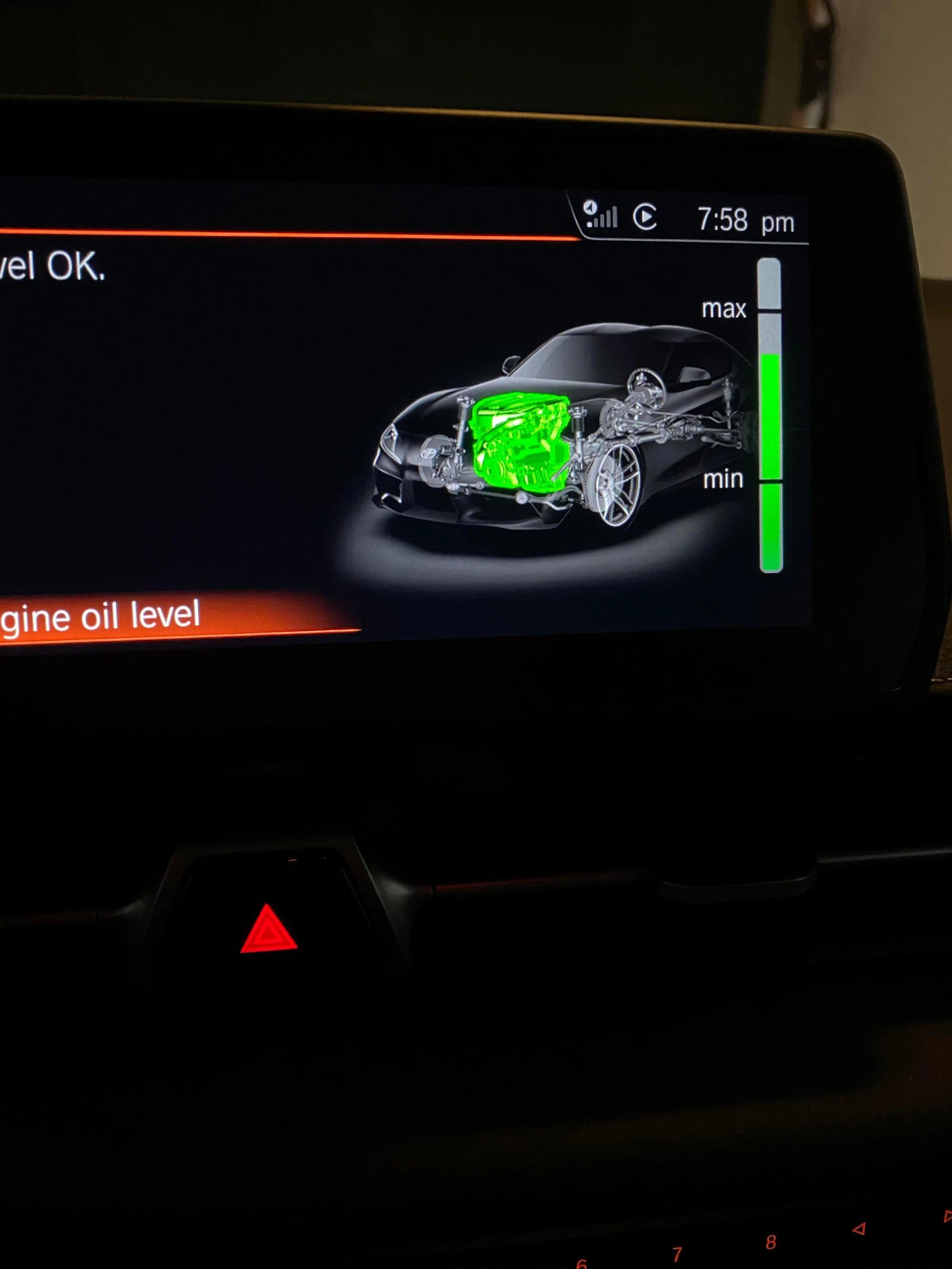

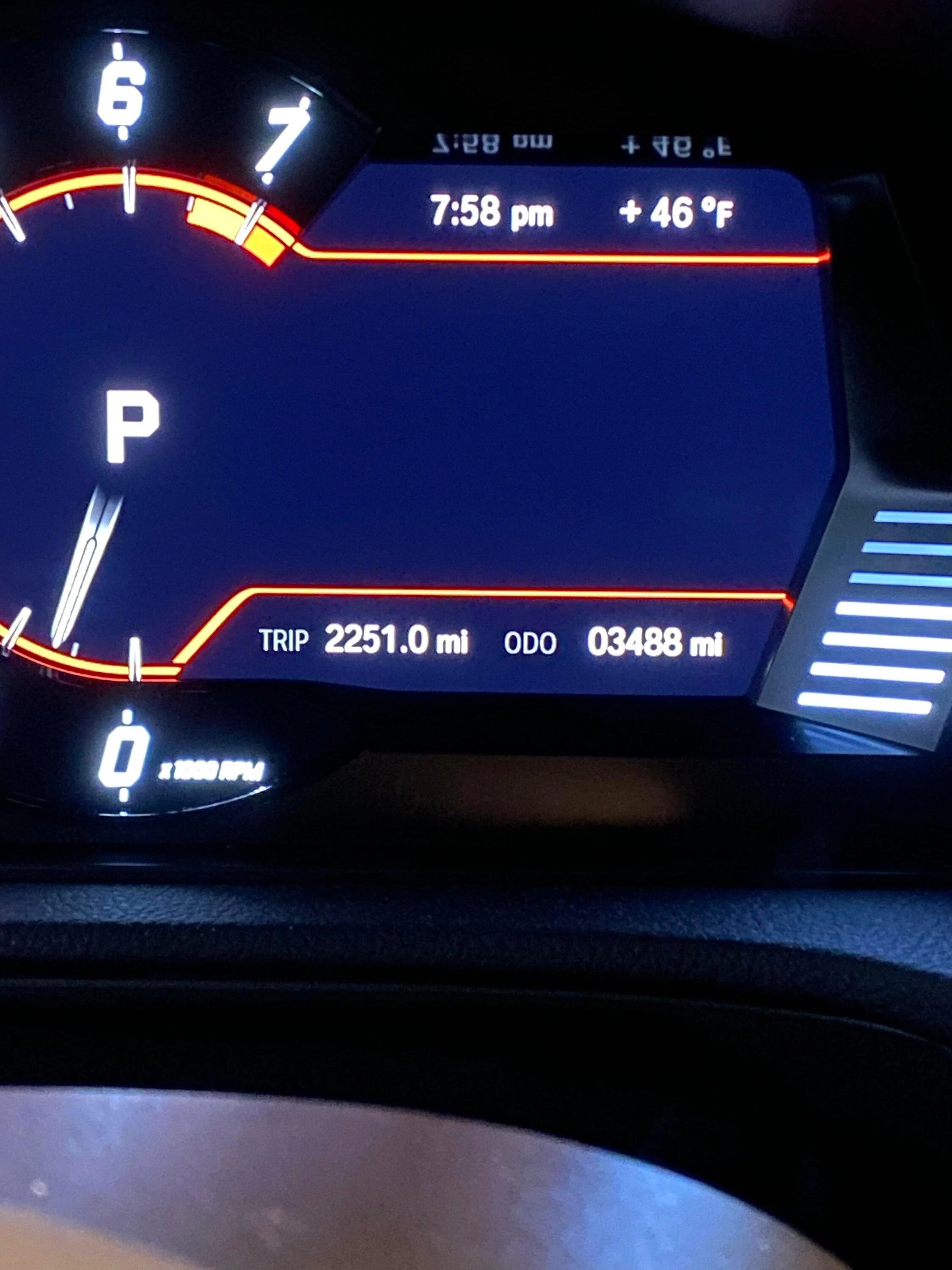

Update:
I have a 2023 and it started showing oil consumption issues @ 2250 miles after an oil change
I used Liquimoly Top Tec 4600 5W30
Not sure if this is 'normal' consumption or if this requires some investigation

Update:
Totally normal. Call me when you burn 1qt or more in 1000 miles

How do you define 1qt? Is the difference between max and min = 1 qt?
No, the car starts with almost 7 quarts. It needs to burn at least 1.5q before it shows the minimum oil level message. It’s a fail safe to prevent the user from overfilling the engine.
So in other words, it's probably burnt only ~0.375-0.5 quart (according to the max min indicator) so far?
Is burning this much oil normal for the car 2k miles in? It seems like my FBO, flex fuel STI burns around the same and that's heavily modified + tuned. My Supra is stock.
How could I prevent my Supra from burning any oil or close to mitigating all of the current consumption? Would the Verus AOS do the trick?

So in other words, it's probably burnt only ~0.375-0.5 quart so far (according to the max min indicator) so far?
Totally normal behavior. It will always burn a little. BMW says it’s supposed to eat 1q every 1500 miles basically.
don’t add oil to the engine until the car tells you too. Don’t overfill.
if you notice having to fill a few times between oil changes that’s fine. If you fill 4-5 times between changes it is a sign of worse problems.

It still seems a little excessive at 1600 miles and 1/2 a quart down on a brand-new engine.
What’s interesting is that on both current polls data is showing about 33% of voters reporting an issue. That means 66% are fine for the moment.
It has to be a bad production lot of rings, honed cylinders or rod bearings. That compounded with the water viscosity of the 0w-20 oil.
-RJM
Is that 0.5 quart? I thought the Max and Min line difference was 1.5 qts. If so, isn't that 0.75 quarts?
See his thread on ecutek oil level analysis
