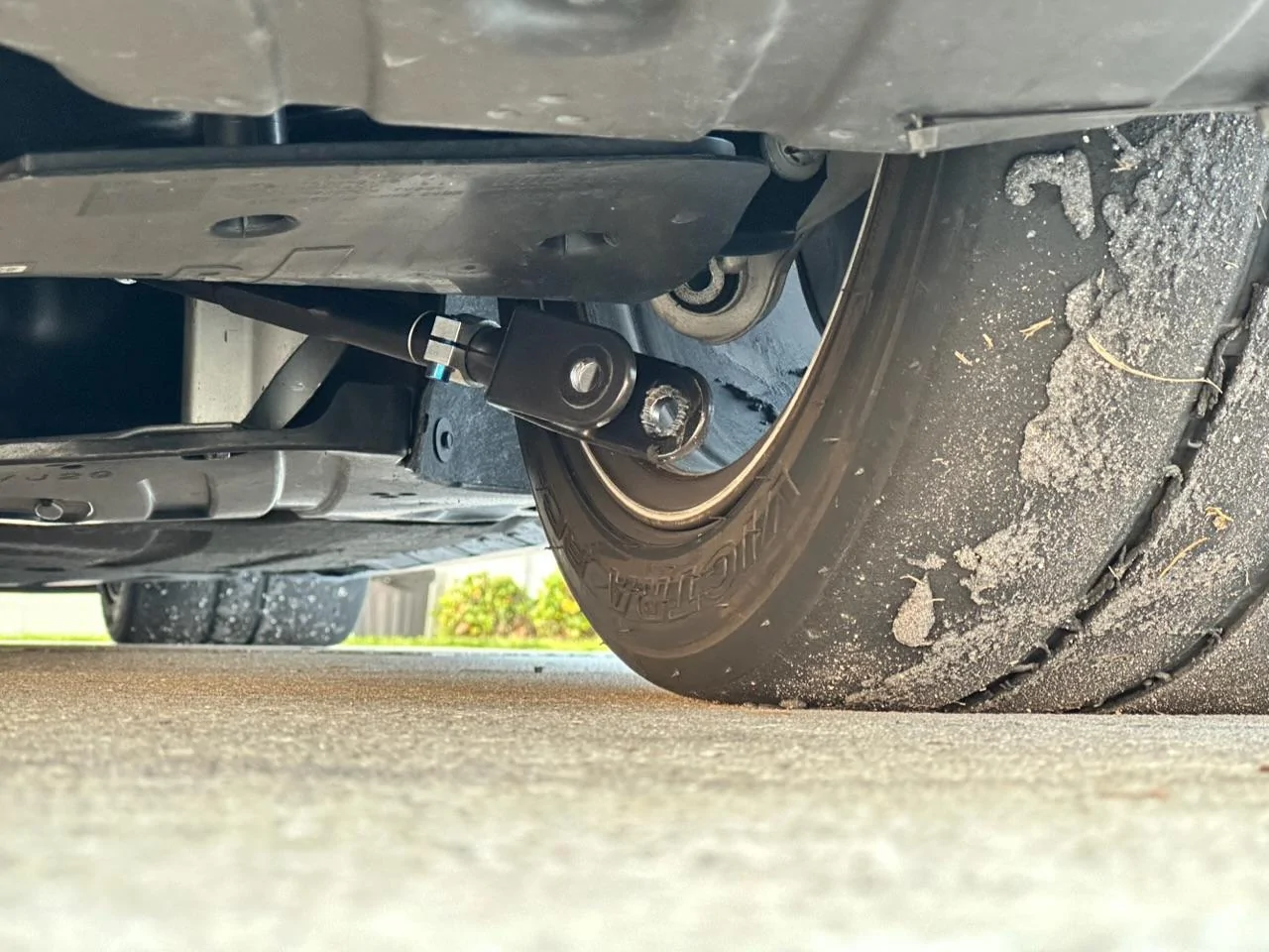

Following up on the actual issue. Took the car to Toyota, turns out lower a arm bolts were loose... caused the rattling and shaking when braking. Toyota said they weren't charging me for tightening them up as if they had done me a true solid...
Lived to drive another day.
Good that it's been sorted.
I was going to say that warped rotors normally only pulsate the brake pedal.
How do those come loose?! Did you mod the suspension?
If I was Toyota and suspension bolts were loose on an unmodified car, Iā€™d tighten them with locktite and go back to look for other examples of that occurring.

I had the same exact thing on hard deceleration, about 145 to 70mph
Itā€™s fixed now
30
3,344
3,302
But yeah, she was shuddering a bit before it happened. You could definitely feel it comingā€¦. End result, new tight bolts & it doesnā€™t do it anymore, lol. Great post @BadCat! I wish I would have saw your post prior to this happening. Will definitely check mine for now on!!
