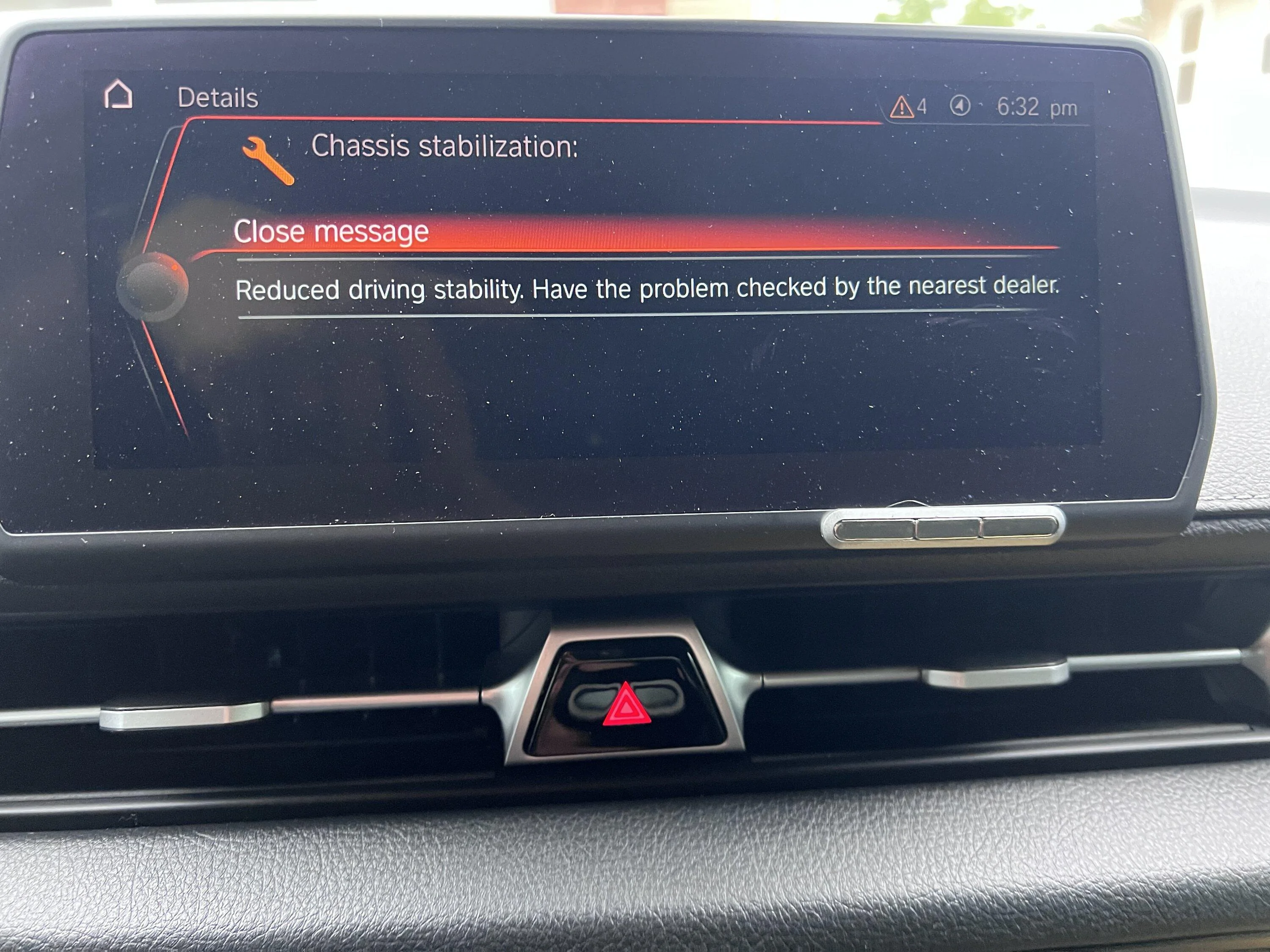

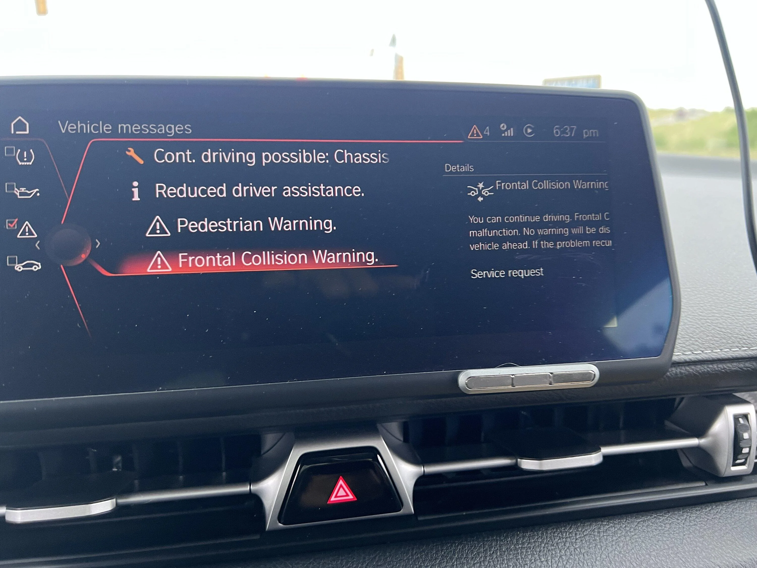

Yesterday we put my new brake pads on. Never been impressed with the stock pads. They don’t inspire much confidence when braking over 100+. Right away after starting it got the message Chassis stabilization, and errors for reduced driver assistance and pedestrian warning and frontal collision warning.
Today put the car on a hoist and so far checked that the ride height sensors are fine. The are still in place and intact Any other ideas before going to the dealer

Tires pressure are too low... Lower than 27 will trigger this message.

Have you recalibrate the tire.?on menu tiles on tires setting, Set tires to summer tires manual mode of course and drive and it will recalibrate it self

This is strange and would not seem to be connected to brakes. I have over 50 track days on my car and went though a lot of pads and never got warnings like this for changing pads. I would drive it a bit and see if it clears. Dealers are usually no help as they do not know how to work on these cars.

I have the same situation so I'm pretty sure it will clear it up for you

Took it for multiple long drives 20-40 miles. Reset the tire pressures still no fix

What about the ride high sensor? Have you take a look at it yet? Maybe it's faulty

Just had it in the air and they both look good. Intact and in the upright position.

Have you looked at the bumper radar sensors. Anything obstructing them. The only other thought is checking shock electronics in case one was pulled lose

I literally have the issue last night when my tire got a nail in it and it deflate the air. And when my tire get under 30psi it show the same message as your.
And I just recalibrated tires and it is fine.
Unless the installations of the pads have some sort of issue. I'm sorry brotha that I couldn't help you much.
I'm following and see if anybody come up with any solutions

I did check all the sensors around the car to confirm nothing was on them. I havnt hit anything or hit a pothole. I usually swerve to miss them

Well the only other thing I can think of is to hold down traction control turning all the way off so both traction control and stability assist are off and drive it a bit then turn back on to normal. Other wise am out of ideas. Will be interesting to see if the dealer can tell you what it is if this does not work.
