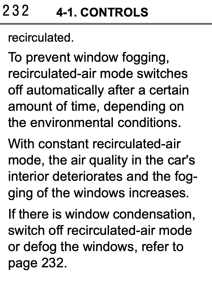

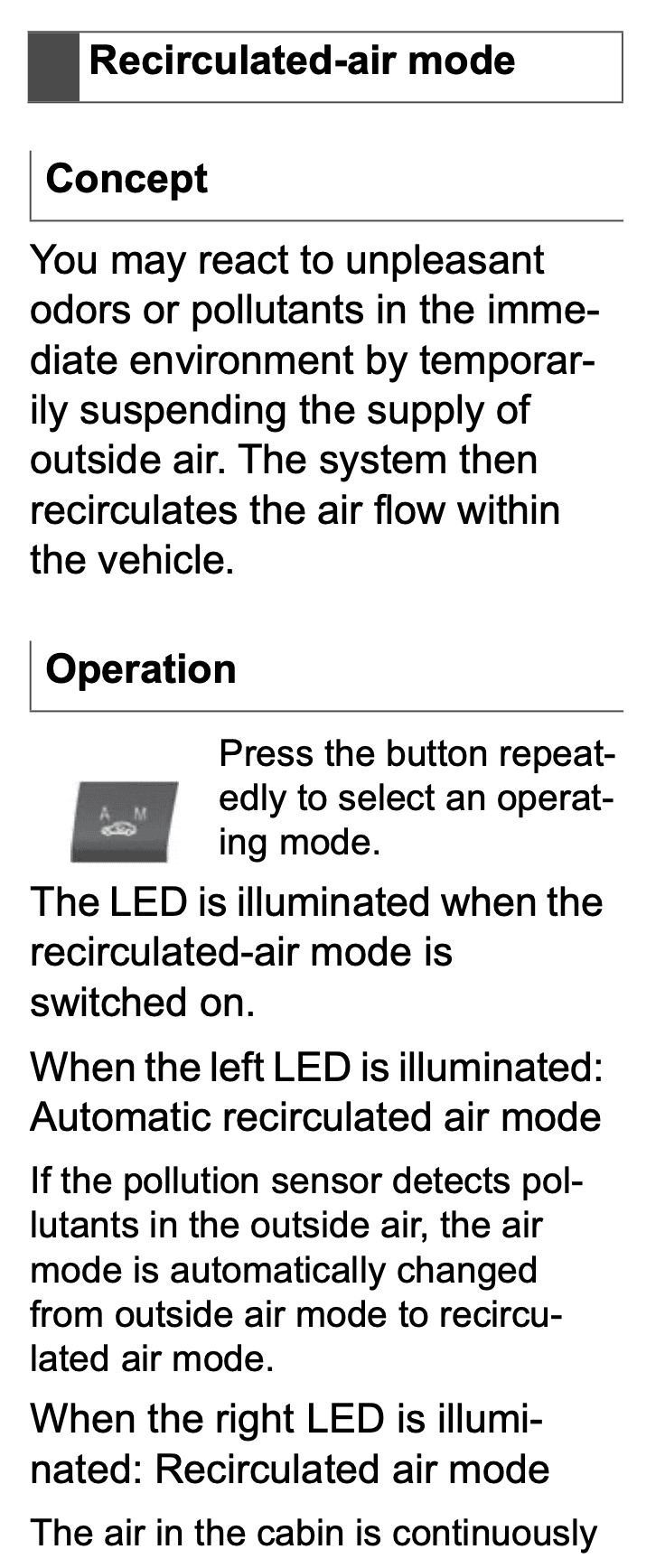

So what's the use of having the "A/C" button ? Speaking of buttons, does anyone know what the meaning of the "A" and "M" lights on the circulated air button? It's either the air is circulated or not. What does "A"uto and "M"anual mean?
