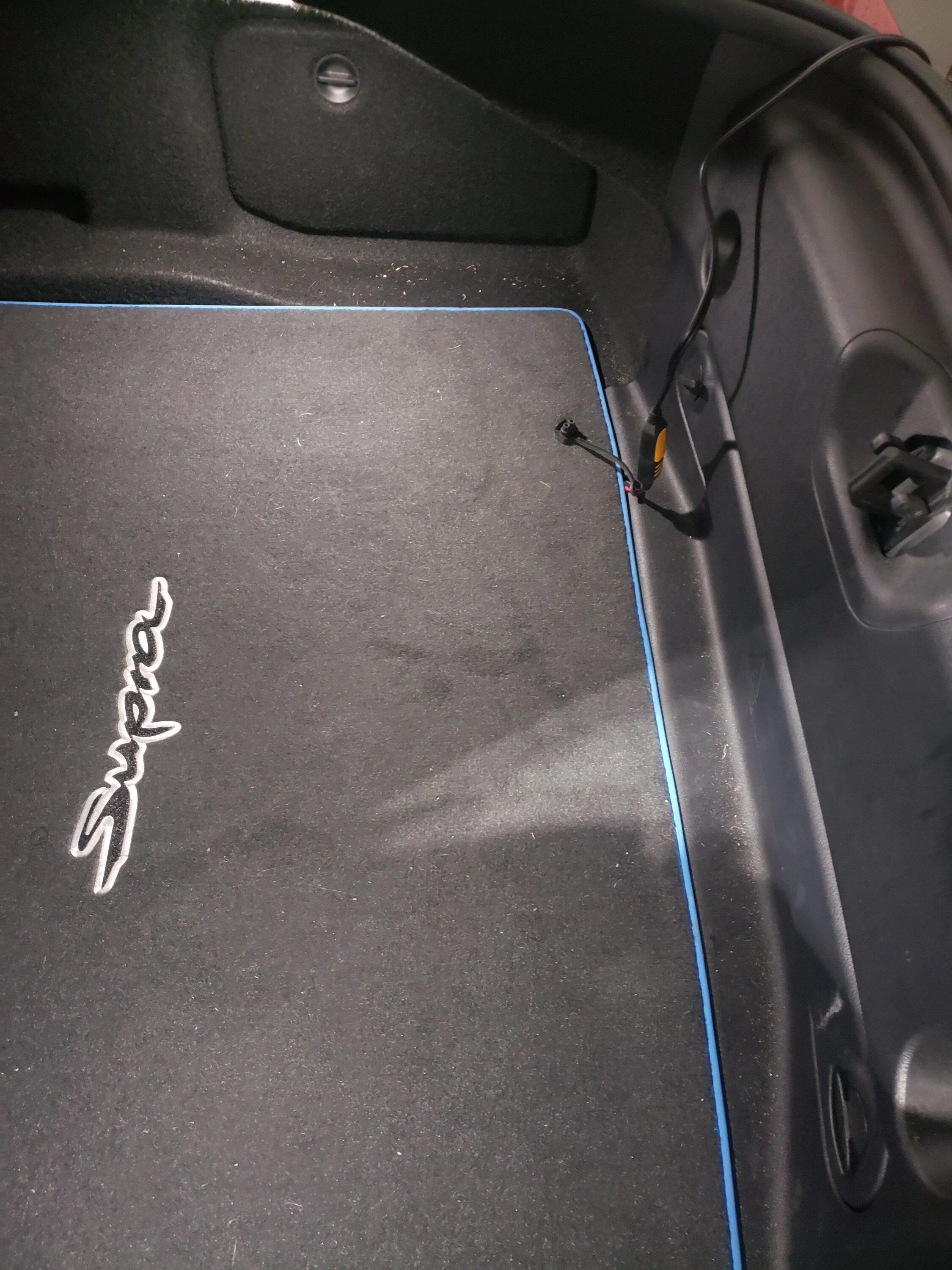

I've seen a few threads where they were installed under the hood, but I don't want some loose wire hanging by the engine all year round. I went into the trunk and the positive cable has a stud specifically to hook up accessories on. Pull off the red cap and there's a nut underneath.
I installed the negative directly to the body underneath the battery tie down. When the cover goes back on the plug can easily be accessed and after winter it can be stored in the battery bay completely out of sight.

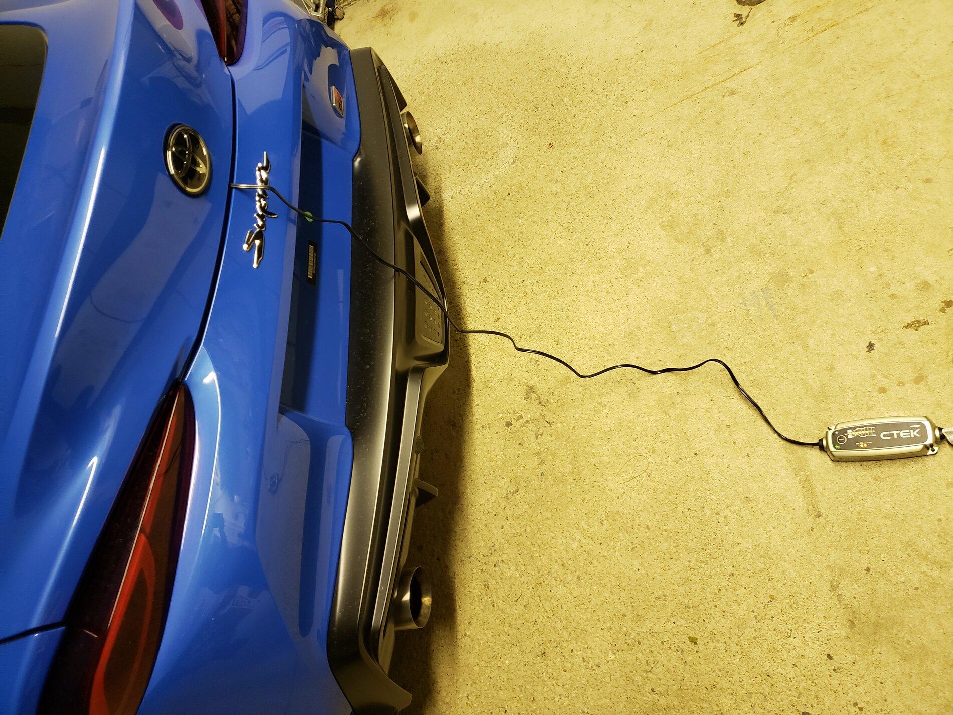

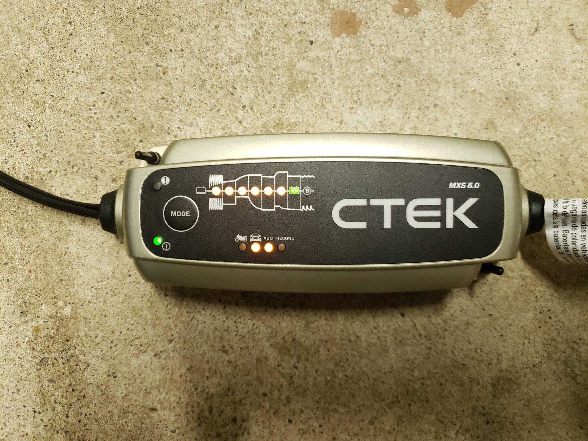

12 hours later, fully charged. I was surprised to see that even though I took the car on a 320 mile road trip, the battery was not fully recharged after that. Sitting on the docks in Jersey for 2 months drained the battery a lot.

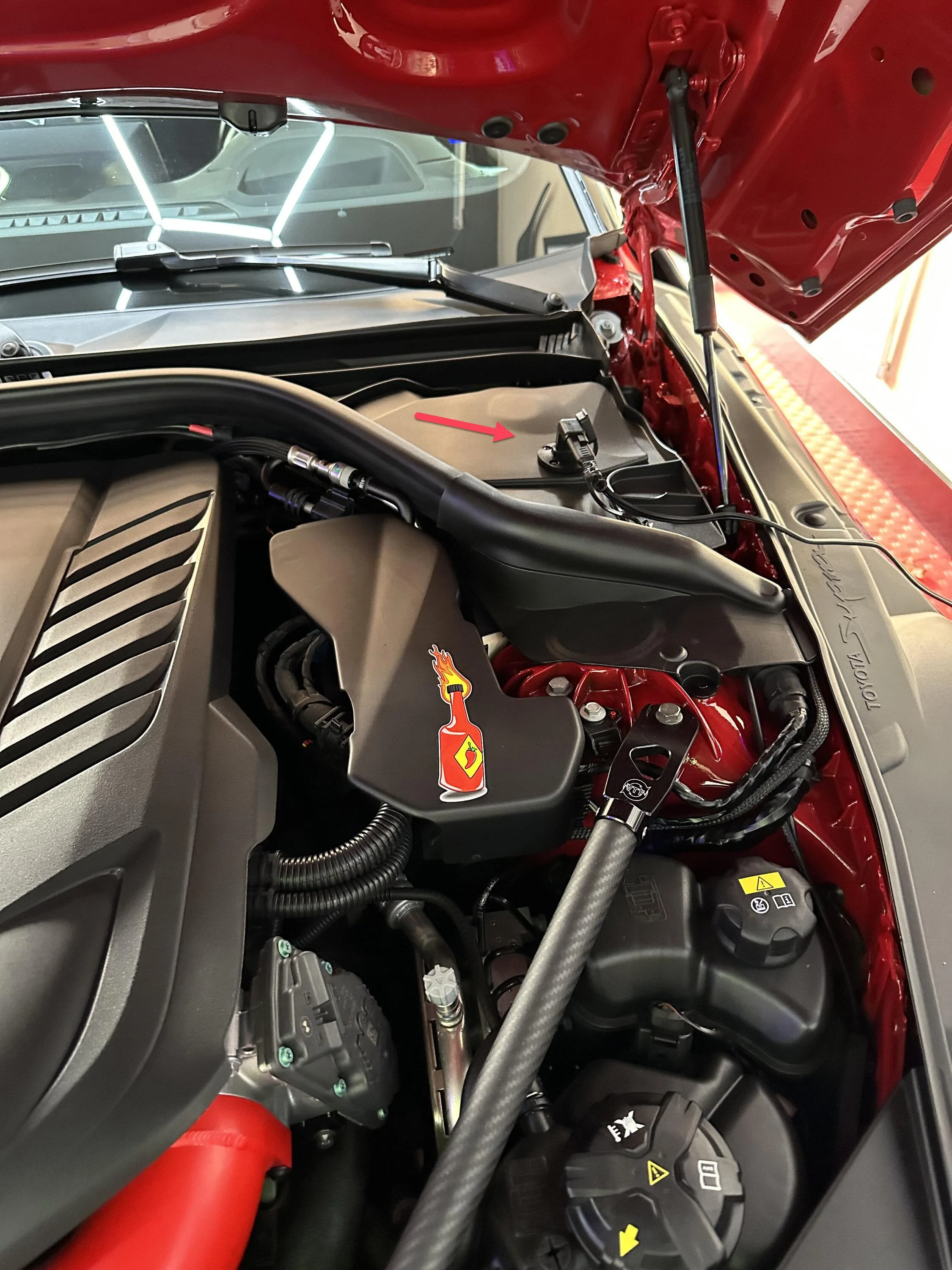

I use the jump points under the hood when I need to charge. The small CTEK connectors allows me to close the hood while doing it too. No need to hook it up directly to the battery

This allows for a permanent solution. When it's not charging, the connection just stores away in the battery location under the trunk panel. When winter comes around, just plug and play. Lay the trunk down, done.

You can do under the hood permanent connections.
