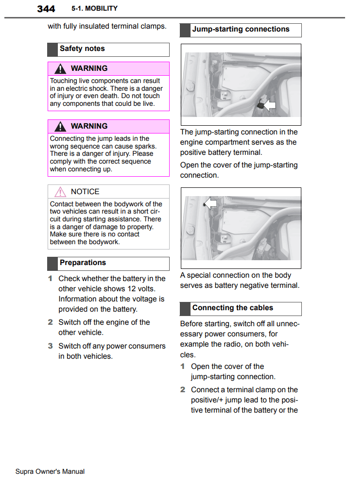

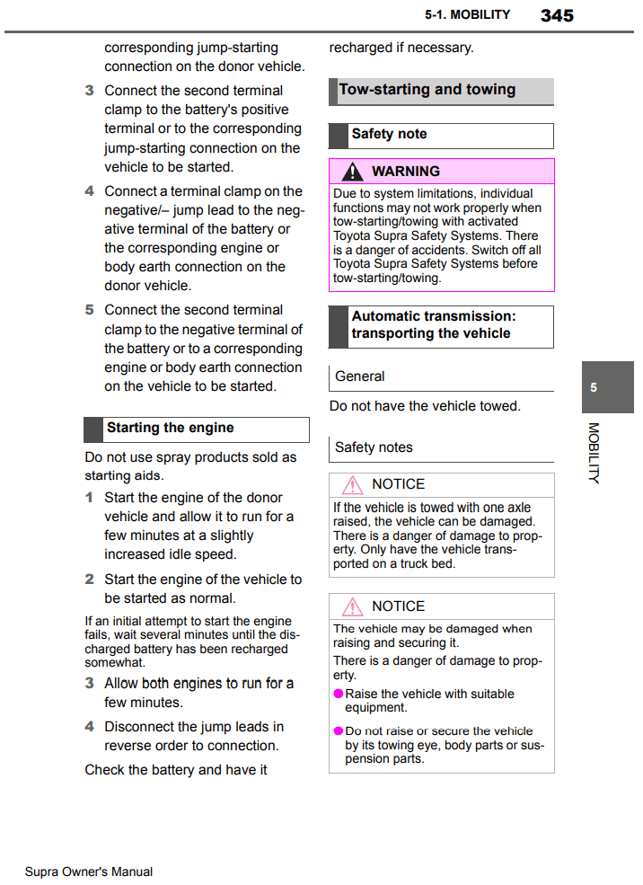

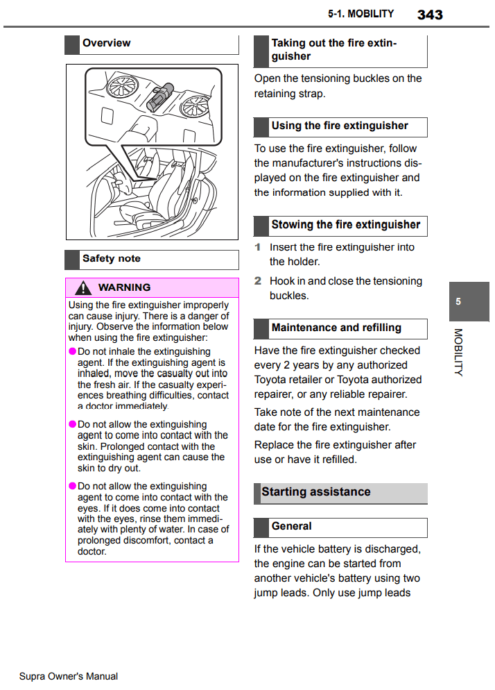

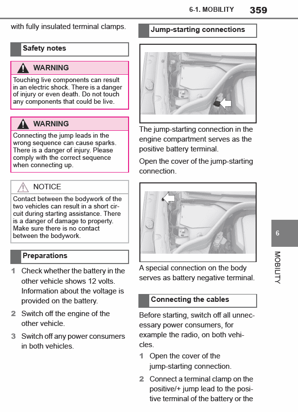

Worst thing ever - the owner's manual doesn't even show any info where to connect the rescue battery to jump the car. This is really bad considering the proper ground lug location is not obvious.

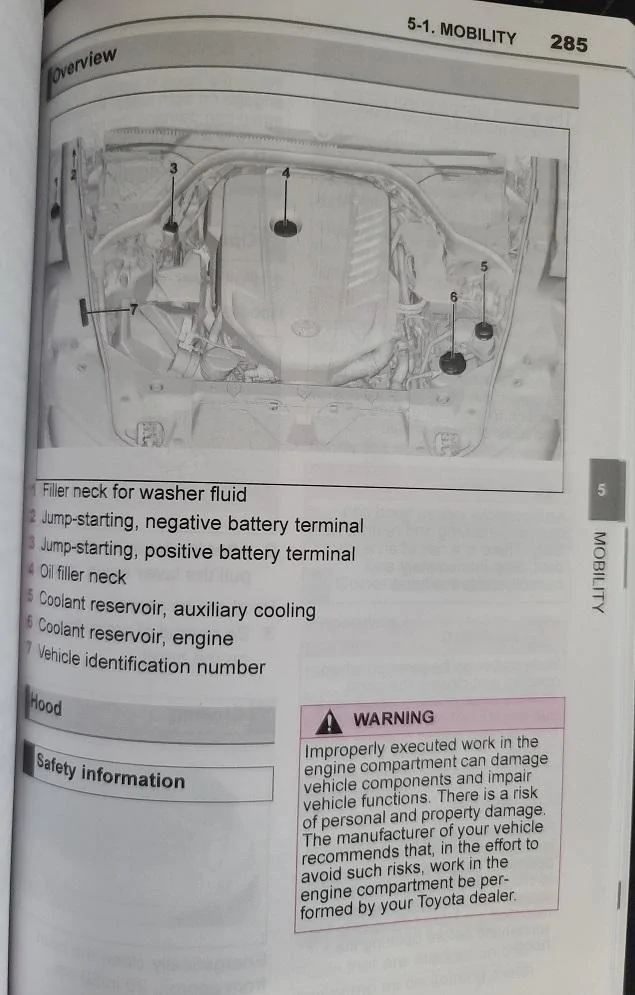

Interesting... Engine compartment overview in European owner's manual:
Clearly #2 and #3 are the hook up points for "starting assistance" and external battery chargers...
And later on there is a full chapter on starting assistance:
Can't really believe the US manual does not include these kind of essential information...

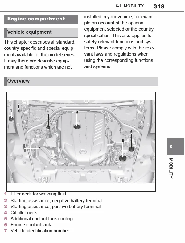

This is very interesting. I have a 2020 manual. Yes I tis my fault that I missed the details about the engine compartment on page 293, section 6-1. Mobility. It does clearly show the connections for jump start.
However, when I search for jump starting, it lists the procedure on page 319, which has no diagram for connection. Anyone with a 2020 manual can attest to this? In fact, my manual has only 360 pages, and @ExtremeMac showed connection diagram on page 359 (WTF???)

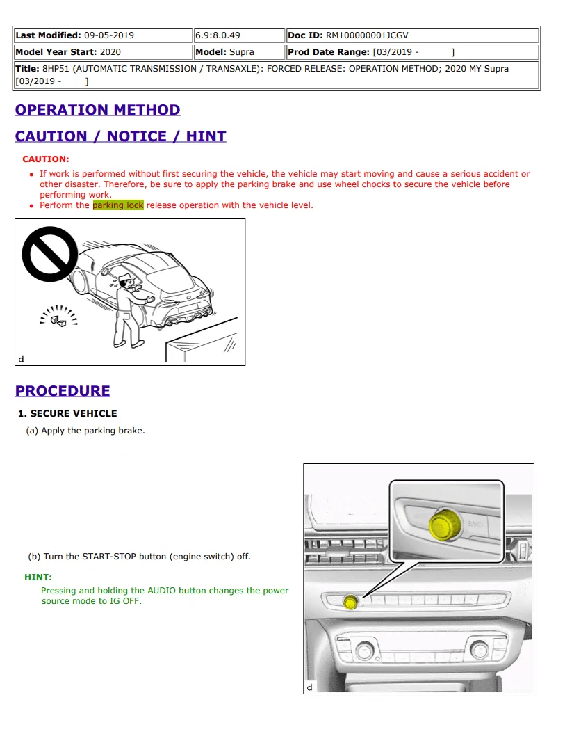

Also, here is the question about towing: how do you put the car in neutral when battery is completely dead? Again, I have a procedure for towing but nothing about putting it in neutral. All it says is flatbed towing is recommended, but the car has to be in neutral for this to happen.

@Fire extinguisher: Don't think the US Supras got it, can only remember some European countries getting it... so, depends on the market.
@AT to neutral: Did a quick search in the manuals, but couldn't find instructions on how to put it in neutral with a dead battery. It states either have enough charge in the battery or hook up a charger, then press start/stop button (if the engine does not start, but the starter is running, press and hold the start/stop button), then put the AT into neutral and press the start/stop button again (or release it).

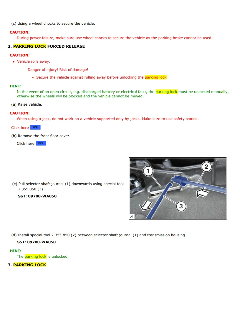

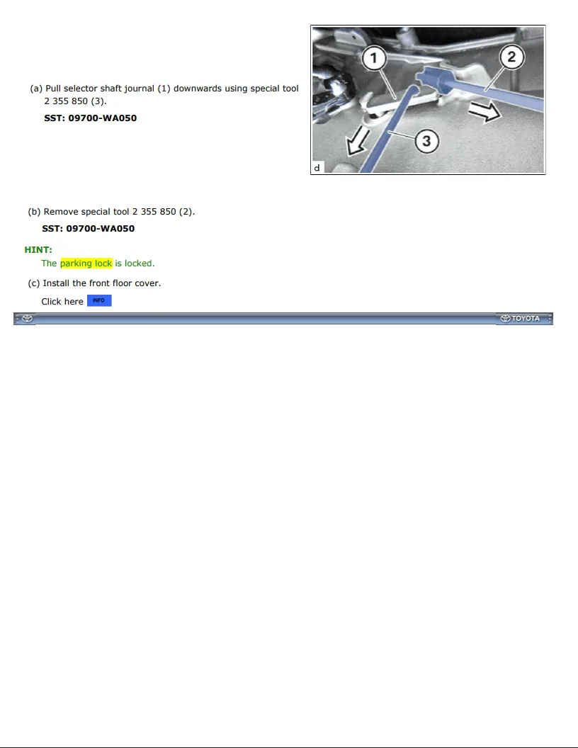

There should be a manual release under the car. I think it requires an allen wrench and can't be reached without a jack. It is definitely not the most elegant solution.
Yep, that would be the release directly on the transmission.
Not 100% sure because I never had to use this and I do not plan to use this ever, but searching through TIS this is what comes up:
No surprise: this information is identical to the one found for the Z4 M40i.
( https://www.newtis.info/tisv2/a/en/...on/24-34-shift-valves-parking-lock/1VneHQeOWI )

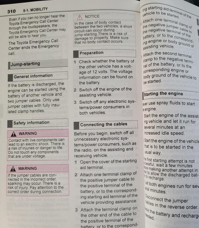

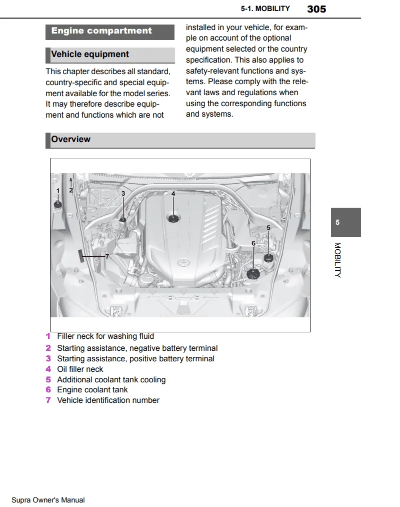

not trying to discredit anyone/anything, just showing the available information. In an emergency situation, first thing anyone would do is to open glove box, so newer online versions may be not come to mind immediately, but in the end it's great that Toyota/BMW is working out the mistakes/forgotten sections and releasing newer versions.
Having said that, I actually went into my glovebox and grabbed the hardcopy of manual for the 1st time :) here is what I found:
The close-up shots of terminals are missing.
Just compared the sections in all the US manuals (toyota.com) and the European manuals. You're right, the close-ups are missing. Even the newest available (US July 2020) does not have the close-ups.
Also interesting to note: the US manuals do have around 360 pages, some of the EU ones around 450. I won't compare each page, but it looks like not only text and whitespace was added ^^ But to be fair: the german 2019/03 manual had 440 pages, the most recent 2020/03 has 468 pages and a lot of the changes seem to be restructuring.
It's not the scope of this thread, but would be cool if anyone could compare the US manual with the EU one...
