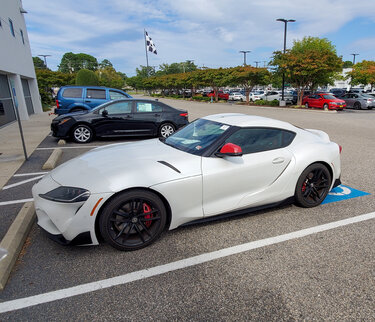

That’s the 5th report I’ve heard of a bricked ECU. All 2020s.
Waiting for the conspiracy theorists to say it's BMW/Toyota locking them on purpose. Having the 2021 engine with a locked ECU I can live with....a locked 2020... noootttt soo much.... decisions decisions
