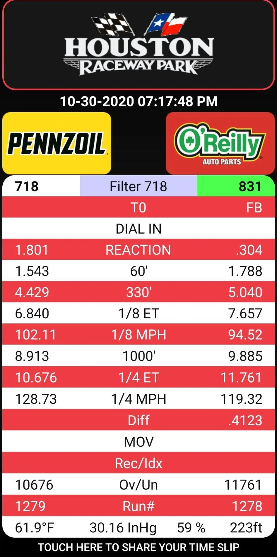

Finally had some decent weather last night took it out to the track
Mods: Dp, Flexfuel tune from @MarinTuned, tires
Stock Turbo full weight No nos/meth

So which one were you and what was your opponent?

Wow! Deep into the 10's! That trap speed equates to 600 flywheel hp with the calculator.net calculator. What tires? Your 60 ft. is great.

So with the flex tune what ethanol % are you running?
I was running e49, using mickey Thompsons et R, if prep was a little better i was hoping to break into the 1.4s but was pulling 1.5s all night so cant really complain

How are you launching? launch control or foot brake? Very impressive!

I hear you. I noticed when Babayaga does his roll races he holds it in second and the instant he takes off he flips it into auto.

Foot brake to 2800 in 2nd
All we have is an 1/8th mile in San Diego. I went Friday and my 60’ times were garbage. 2.0-2.3. That was launching in first gear with vsc on, I just hit traction control button once.
I was really annoyed because I was trapping 99 mph all night. I knew my times were shit but I was hoping to break 100mph.
I went back today and tried launching like OP did in second gear. I wasn’t sure what rpm I was at because they were running a pro tree. Pretty much a go right after I staged. My best time was 7.1 @ 102 mph. My 60’ on that pass was 1.67. I couldn’t believe I got that low of a 60’ on the stock tires.
my only mods are catless dp, flex fuel, ecutek tune by zach @ Counterspace garage. I was running about e52 blend. I’m hoping with a set of tires and a 1.5 or better 60’, I’ll run a sub 7 in the 1/8th, which should be good for a 10 in the 1/4.

Nice ask it takes is practice and good track prep never seen a60 that low on stock tires
