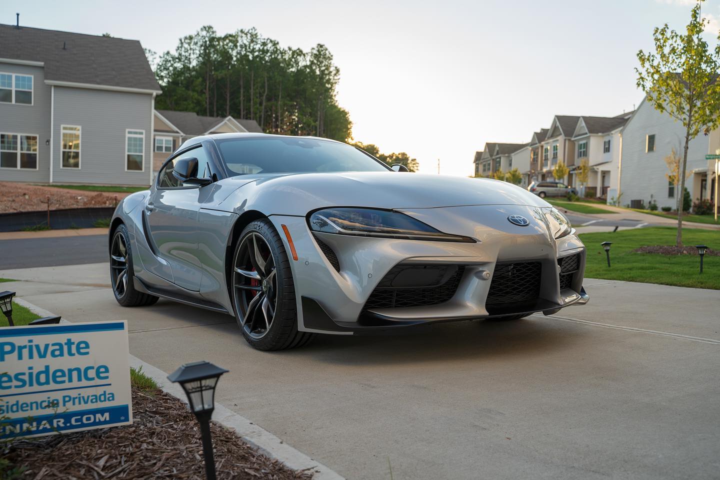

Hey guys, I've been lucky enough to be one of Supra owners. I've always wanted another track car ever since I sold the FR-S (or GT86, or 86, depending on where you are), and I thought why not keep a journal this time? So here we are.
I picked up the car from a dealership near me, by quite a surprise to be honest. I was gonna by the car in February, but they gave me a deal that I couldn't refuse so went ahead and pull the trigger couple of months earlier.

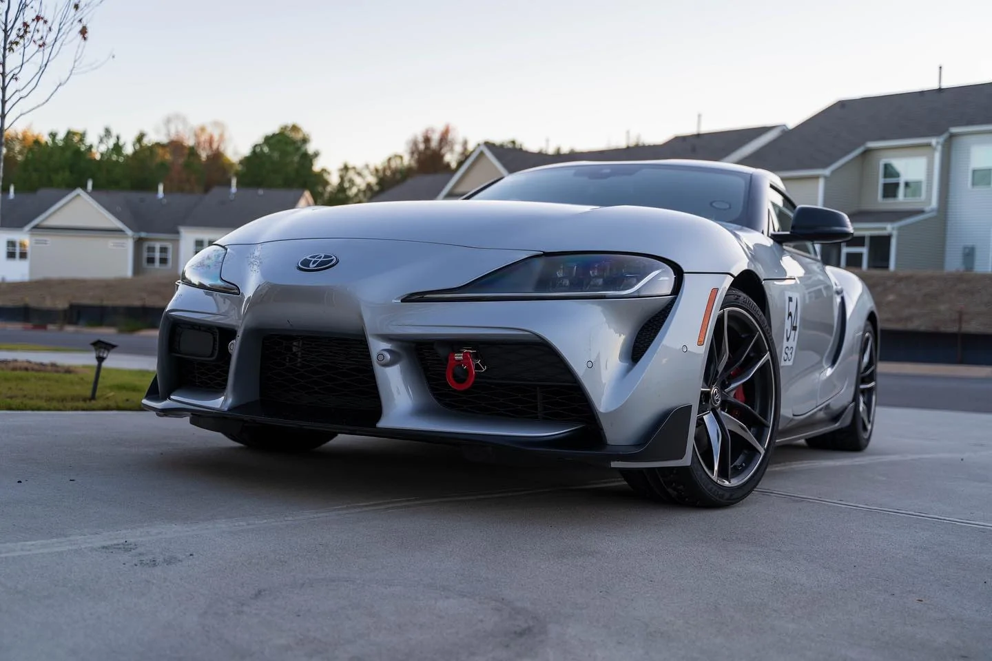

The car doesn't have a lot of mods yet, I will be running the car with SCCA Time Trial series competing in Sport class so all the mods I have right now are within the class regulation, but since it would grow I'll just list here:
Interior:
Cusco x Bride ZETA III Type C
Bride Type FO seat rail kit
Schroth Clubman 2*2 6 point harness
Cusco Power Brace Trunk Harness Bar
Exterior:
Cusco Folding Tow Hook front and back
SunTek Track Pack PPF
Verus Engineering Carbon Fiber Anti-Buffeting Wind Deflector
Powertrain:

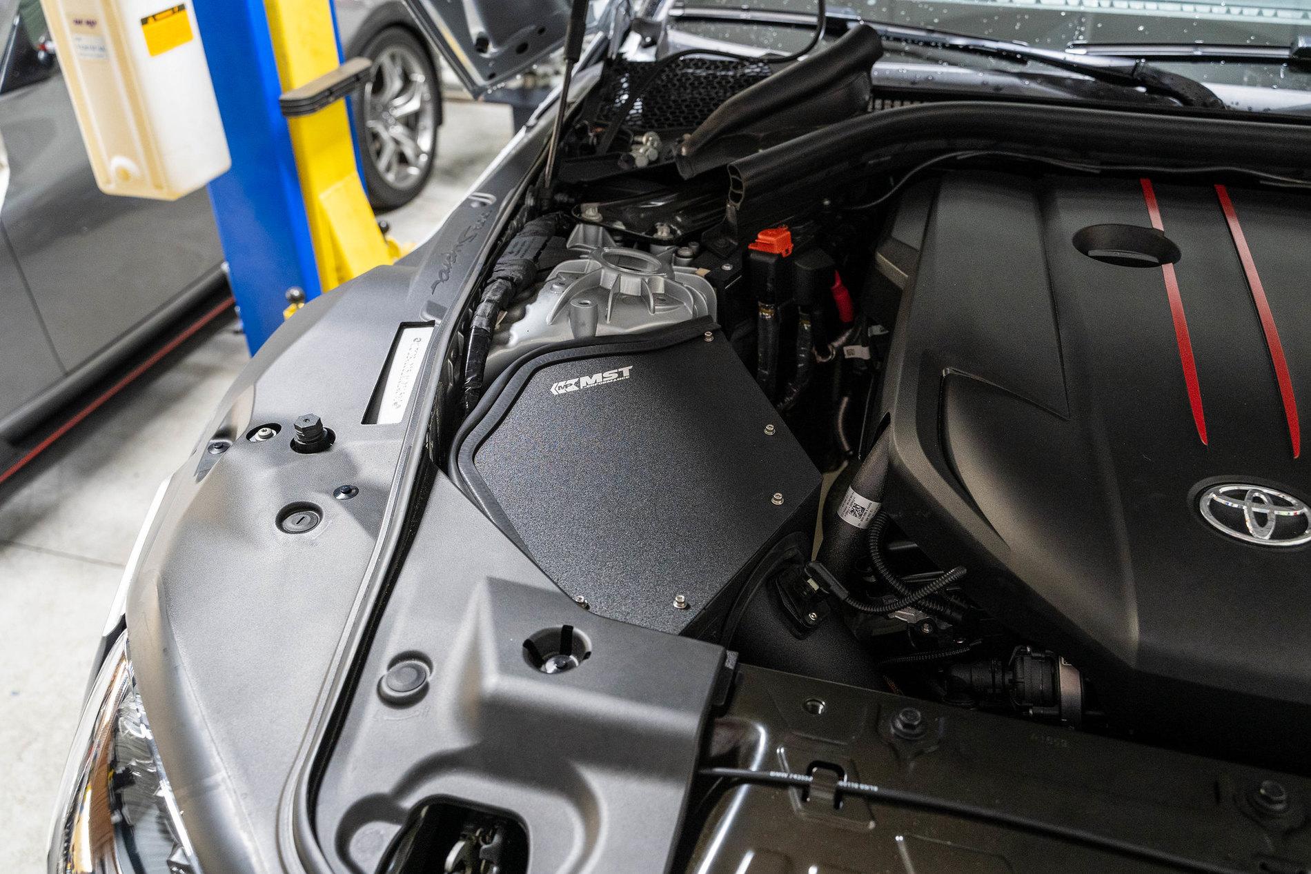

MST Performance Cold Air Intake

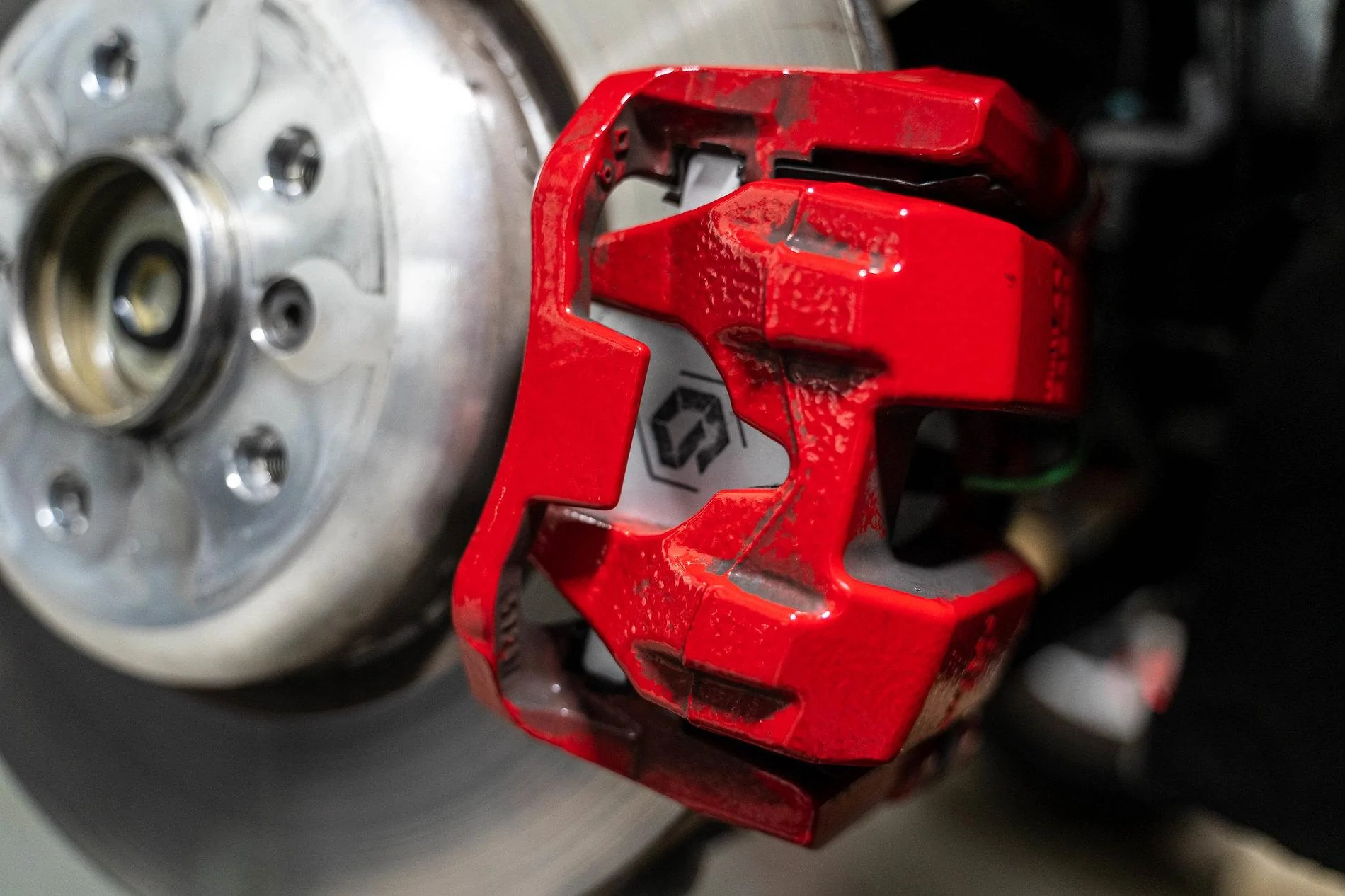

Brake:
CounterSpaceGarage CP pads
Motul RBF 600
Wheels & tires:
TITAN-7 TS-5 18*10.7 +38 square
Hankook R-S4 275/40R18 square
Bridgestone RE71R (255/35R19 275/35R19 stock size, one and done)
Suspension:

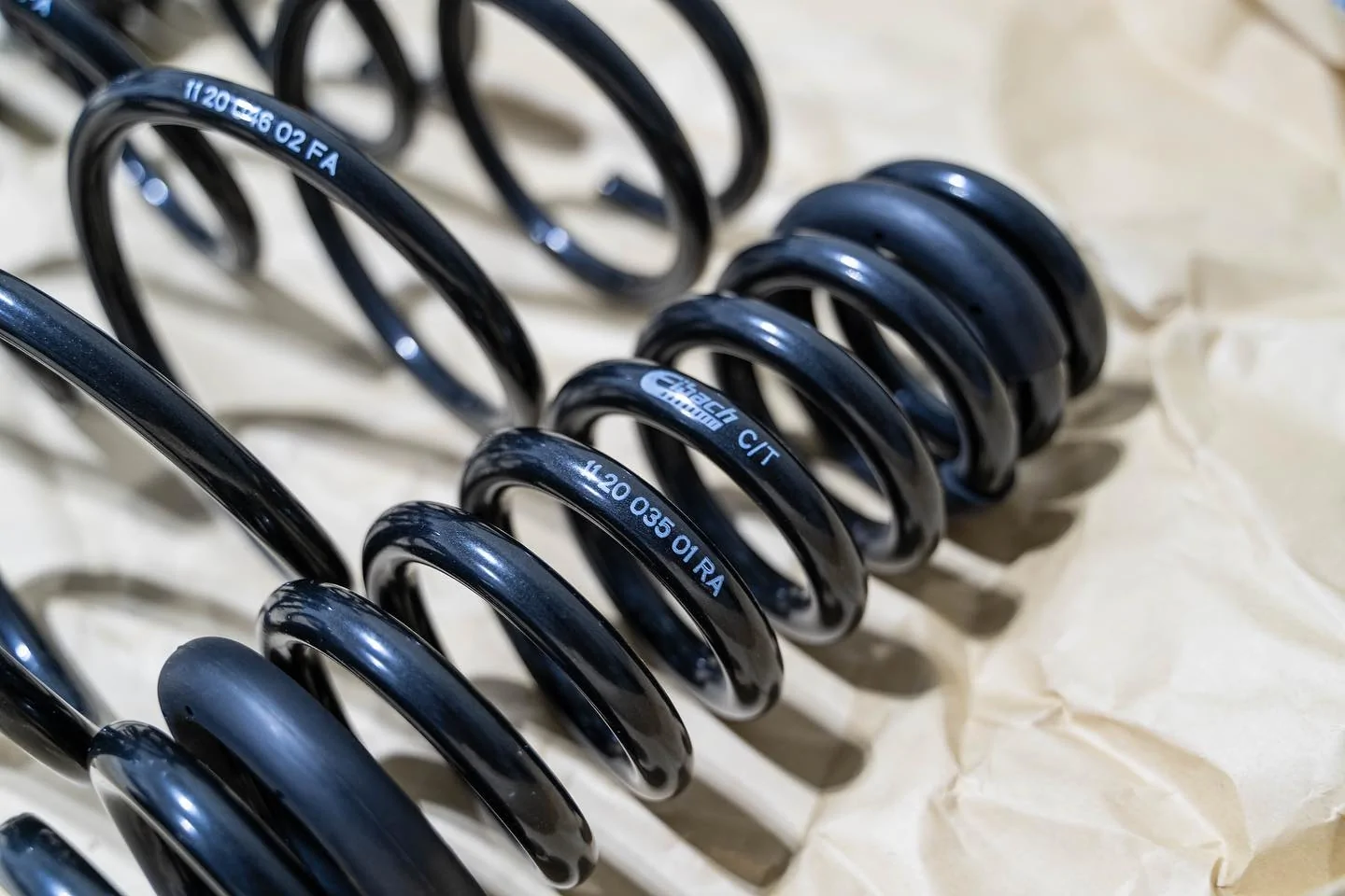

Eibach Pro-Kit lower springs (part number E10-20-046-02-22, out of the car due to wheel fitment issue)
HKS HIPERMAX Touring lower spring kit.
Driver:
Plenty of driver mods needed, A LOT OF seat time is required to unlock this section.

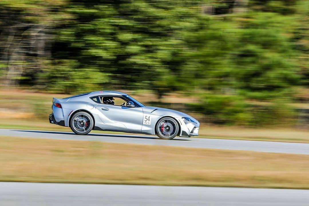

So far it's been a riot, spend 5 days at NCCAR and 1 day on VIR, car is doing well. More to come in 2020.

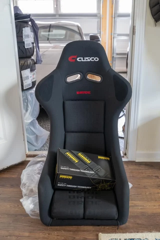

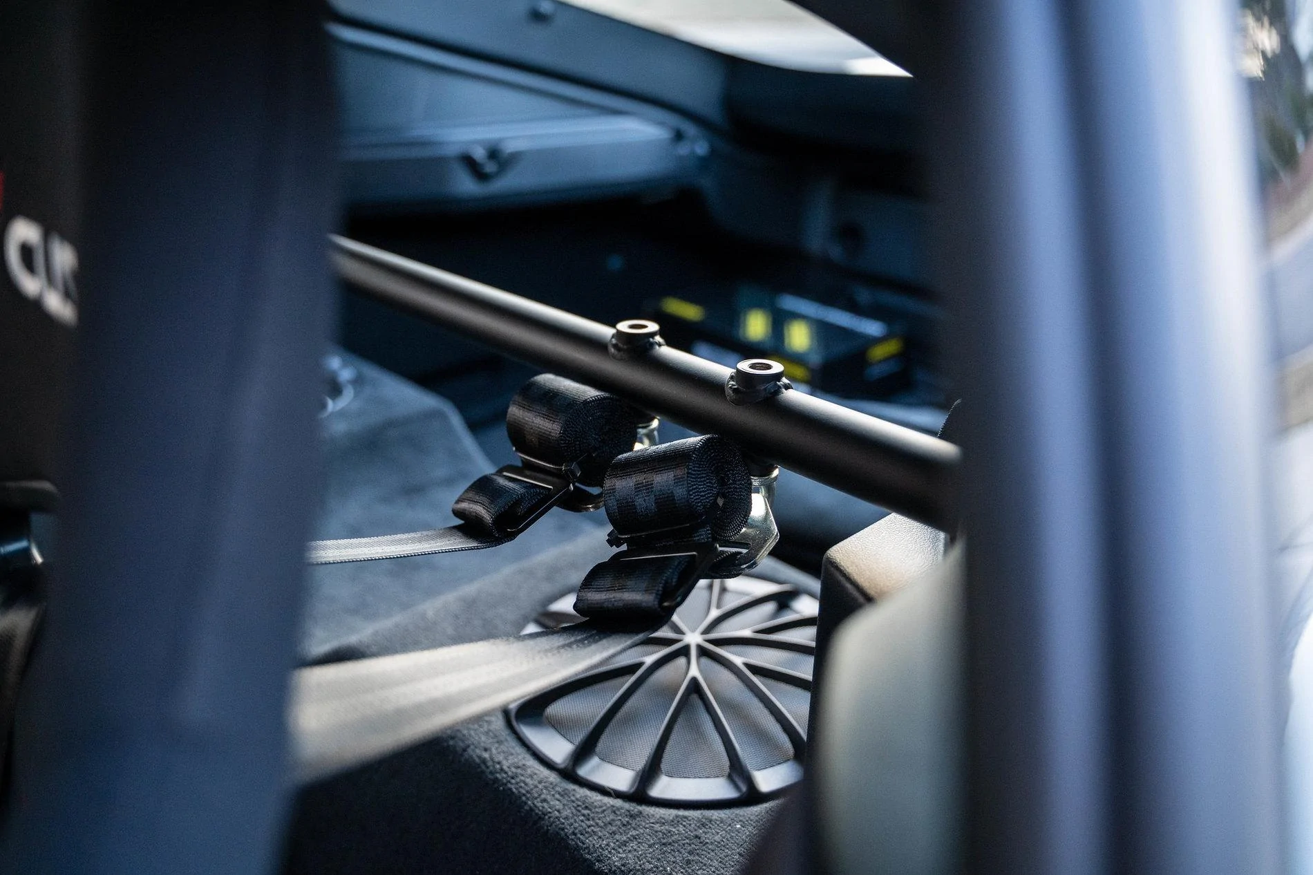

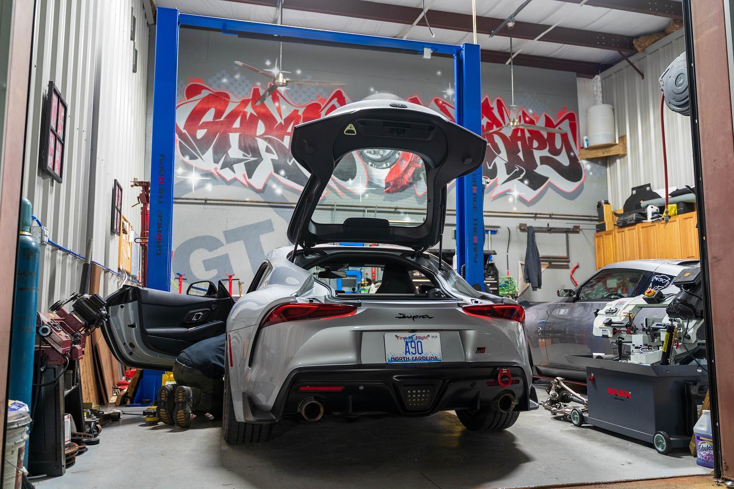

-------------------------------------------------------01/16/2020 UPDATE---------------------------------------------------------------------

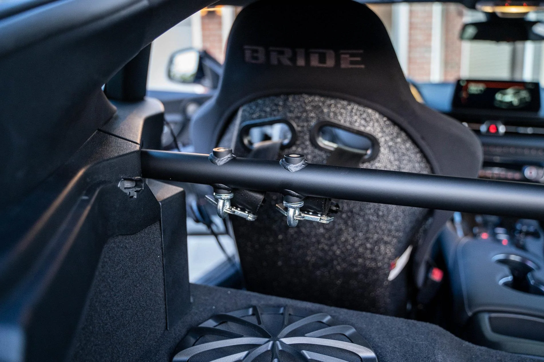

Thanks to the guys at Garage Therapy NC, the seat, rail, harness and harness bar has been installed.
7214861_4233448168726986752_o.jpg?_nc_cat=109&_nc_ohc=_NFvmtdiLTUAX_F6-HE&_nc_ht=scontent-iad3-1.jpg

01/16/2020 UPDATE: Seat, seat rails, harness bar and harness has been installed.

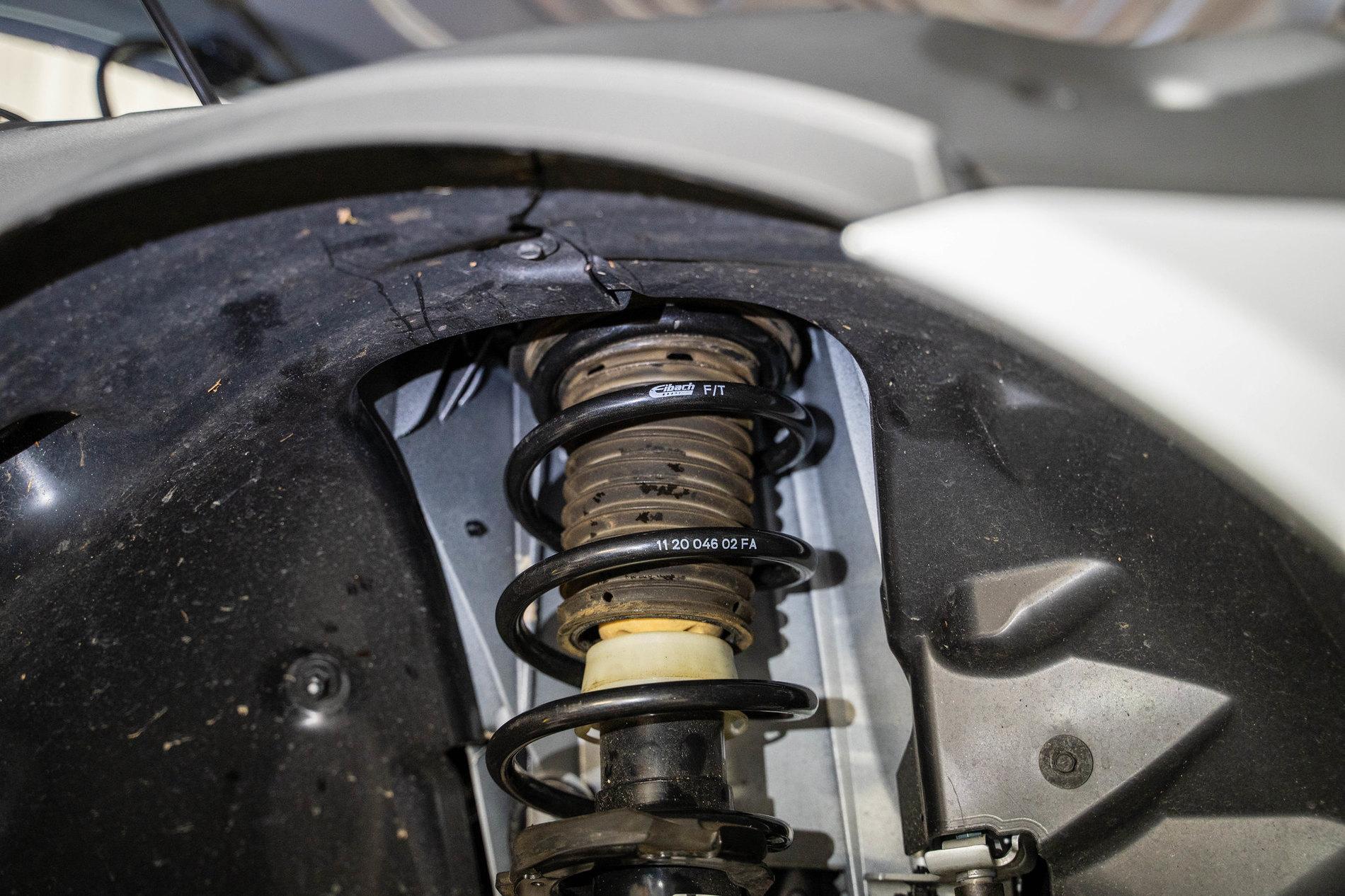

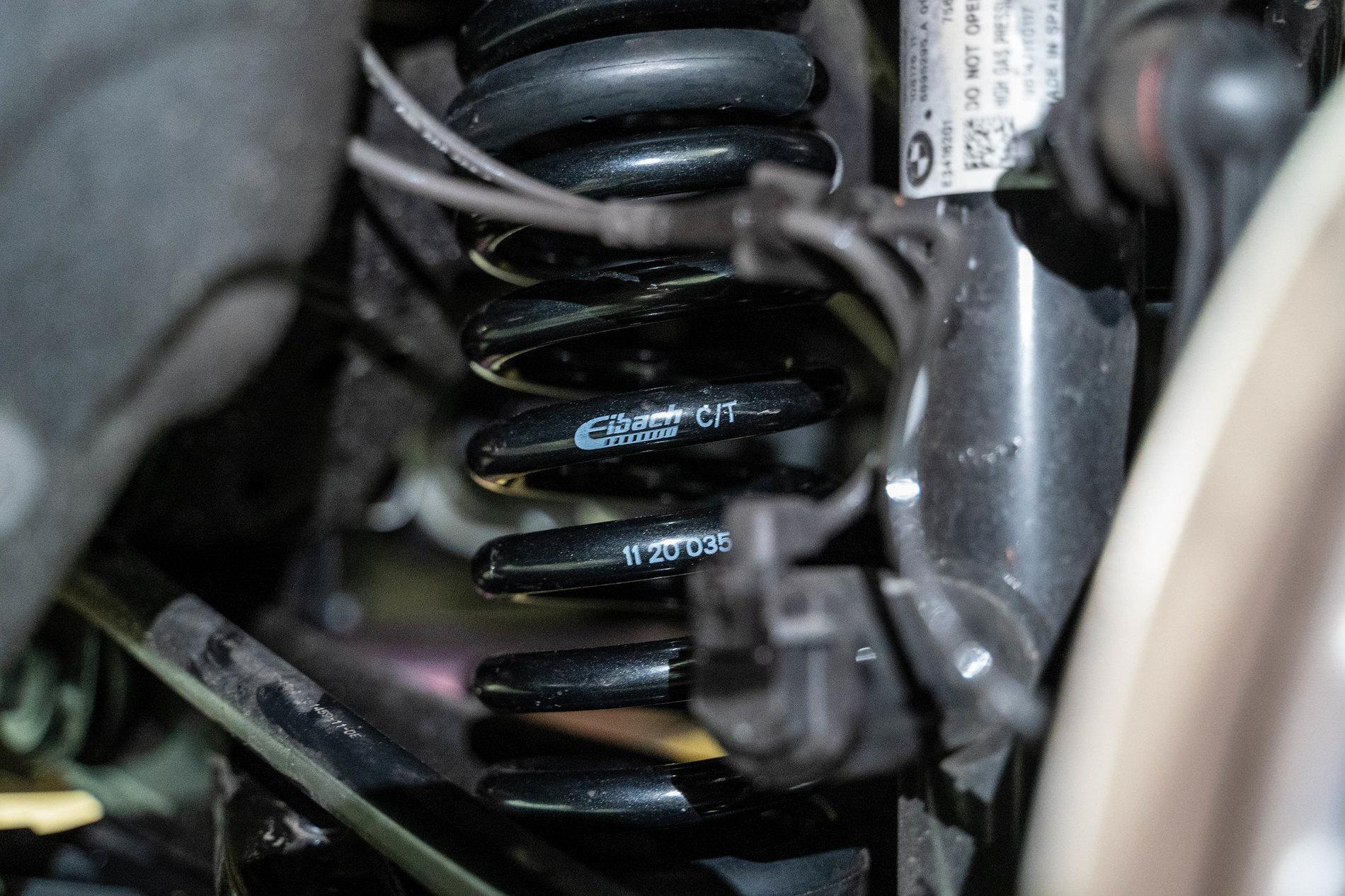

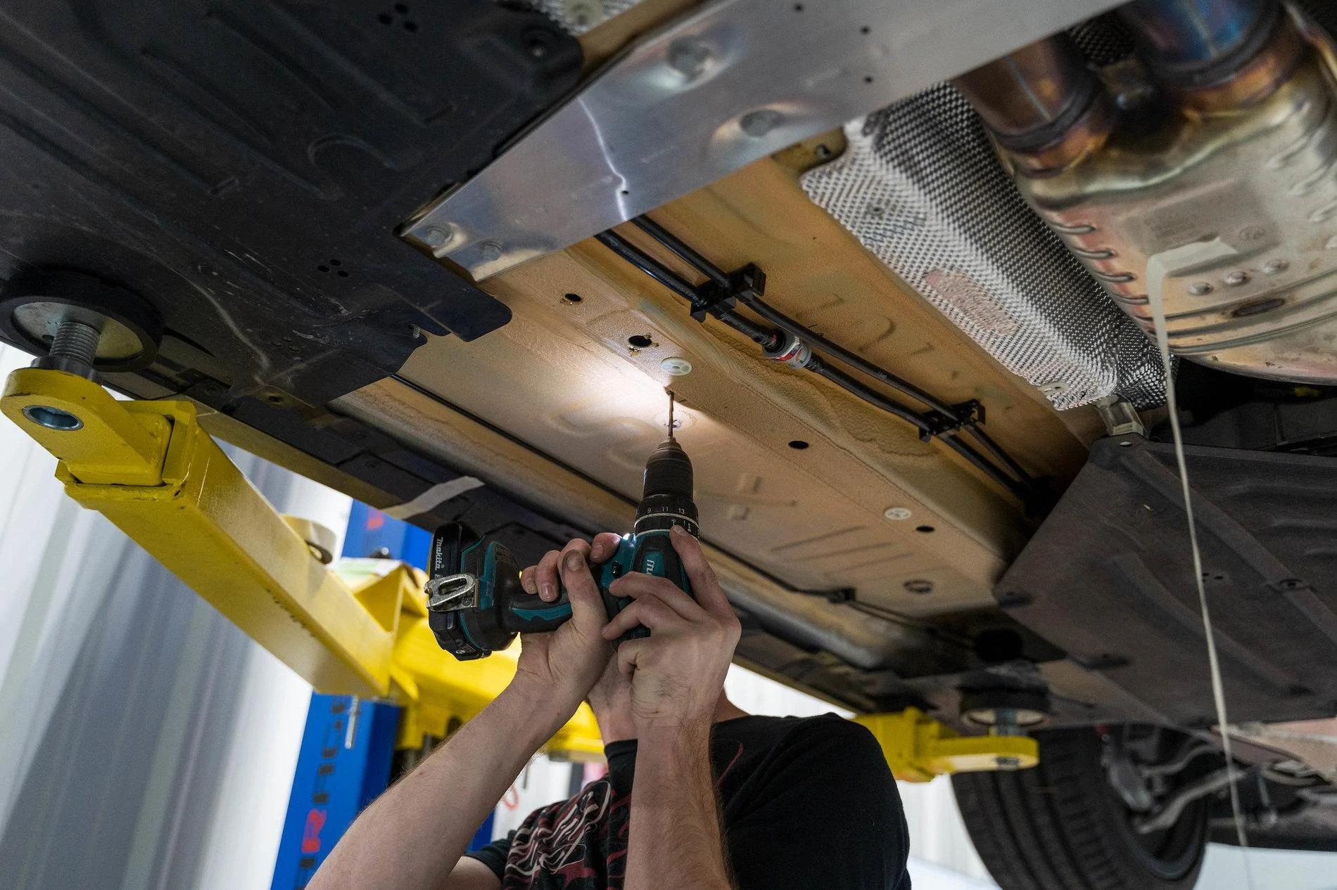

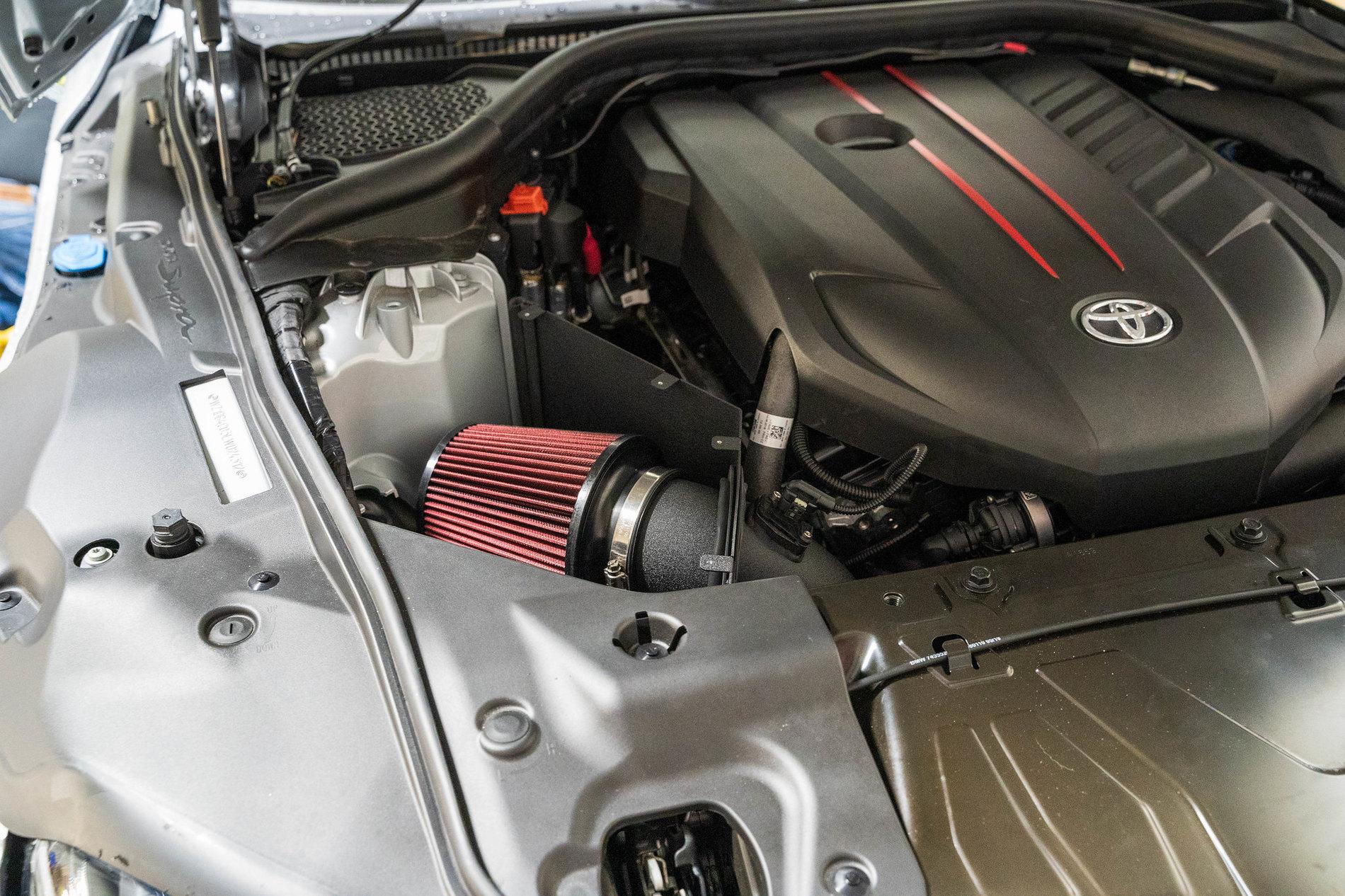

Lower springs and intake system are here, should kick off the install sometime next week. I'll try to get a side by side comparison after I got the springs installed (which means it would involve my shitty photoshop skills)
9945009_4993415938532442112_o.jpg?_nc_cat=108&_nc_ohc=RwcHtDLYTU0AX-pkZ20&_nc_ht=scontent-iad3-1.jpg

why you need to drill under the car for?
arent te seat brackets bolts on to the stock eem holes?

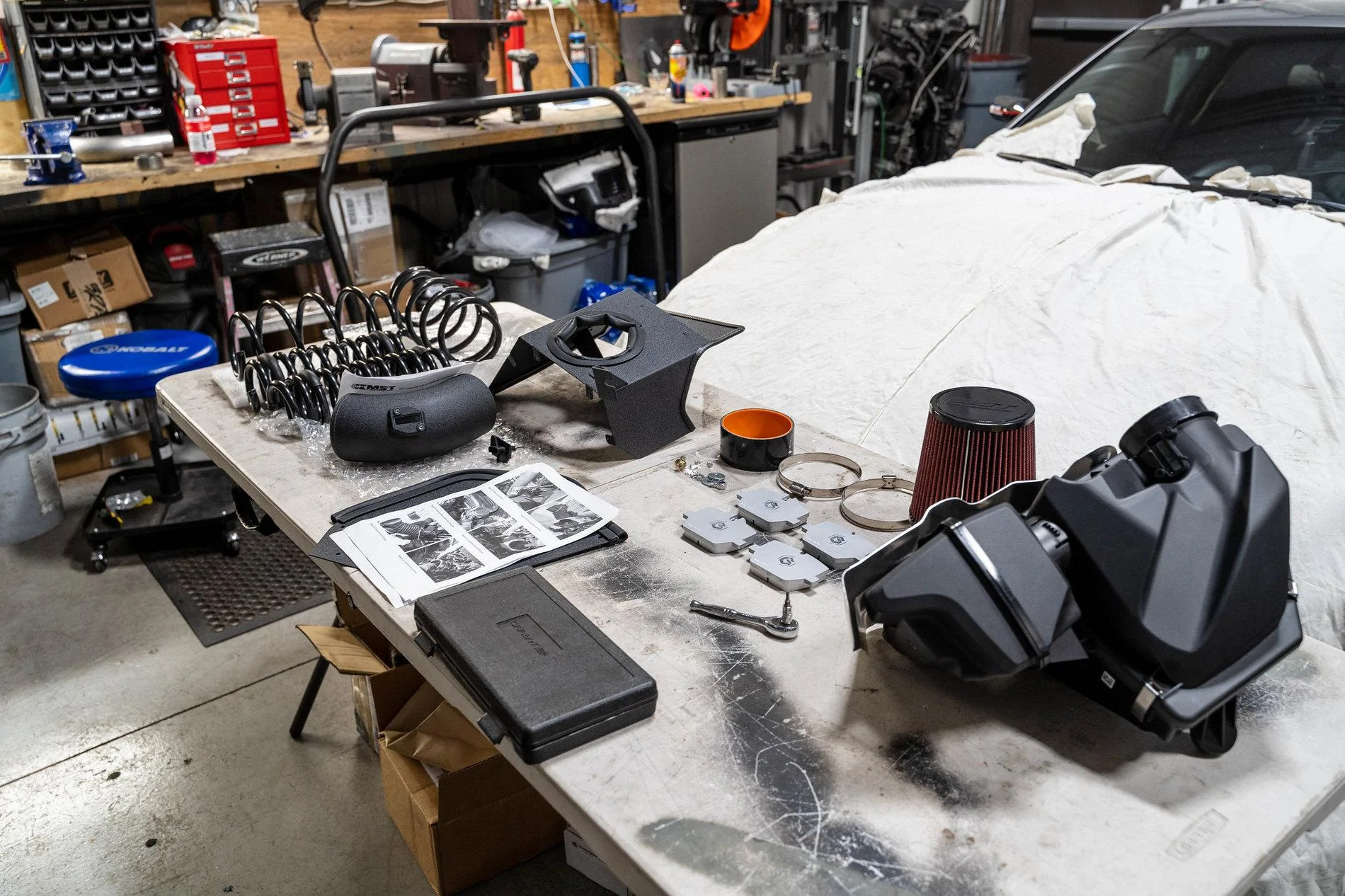

More stuff going in. Intake, lower springs (FINALLY) and rear brake pads which is long overdue.

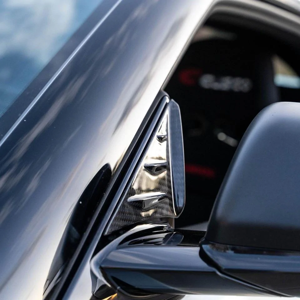

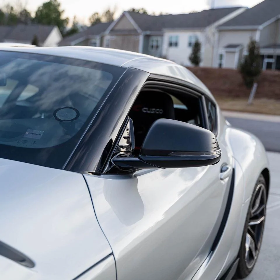

Installed Verus Engineering Carbon Fiber Anti-Buffeting Wind Deflector, might have a bit higher, but I'm glad it works well.
5351853_1419138335120556032_o.jpg?_nc_cat=109&_nc_ohc=14ac9l8zVg4AX_y2okM&_nc_ht=scontent-atl3-1.jpg
5351849_8253592030853201920_o.jpg?_nc_cat=111&_nc_ohc=7YX5rxevcu0AX99i0GR&_nc_ht=scontent-atl3-1.jpg
