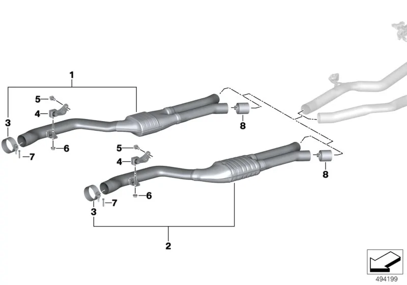

I drove it yesterday Mark and it was my complaint too. Only audible difference between sport and non-sport mode is the addition of crackles that are somewhat subtle compared to US.
I need to confirm which exhaust centre section we got - the US is one variant and EU is another,
Either way mine is getting secondary cat and resonators deleted ASAP and an intake. They really are far too quiet.

I can confirm the Au model has the same middle muffler as the US version - item 2 as seen below:

I only had a quick look but it appears so.
