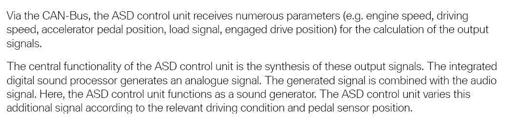

What is Active Sound Design and how does it work?

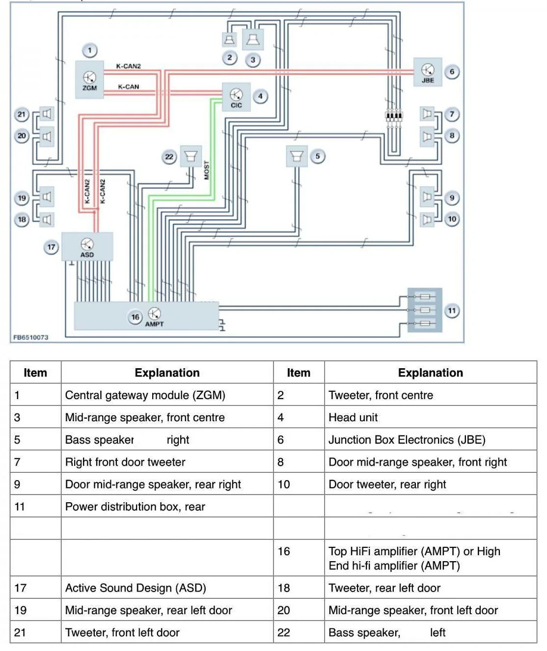

Why remove ASD from the Audio System?

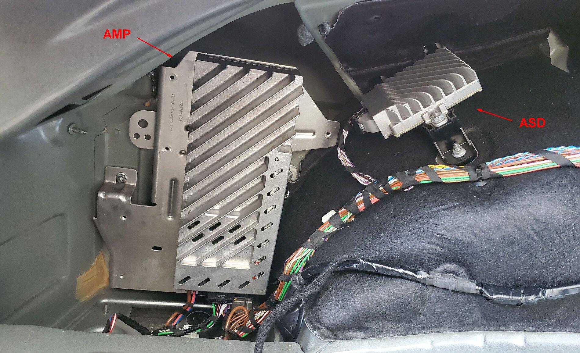

ASD is simply an electrical sound generator which overlays a faux engine sound / noise on top of the audio amplifier speaker channels...Removing this sound overlay significantly improves the sound clarity of the OE audio system...

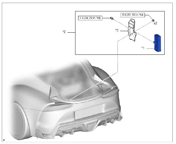

Location of ASD module:
Location of Amp and ASD Module:

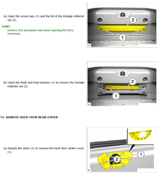

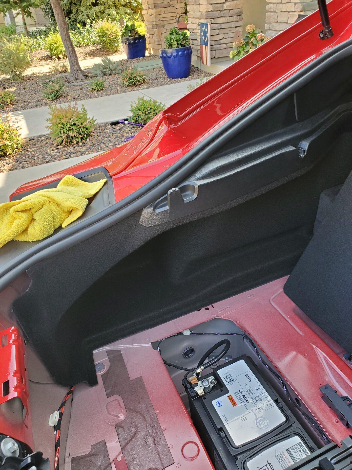

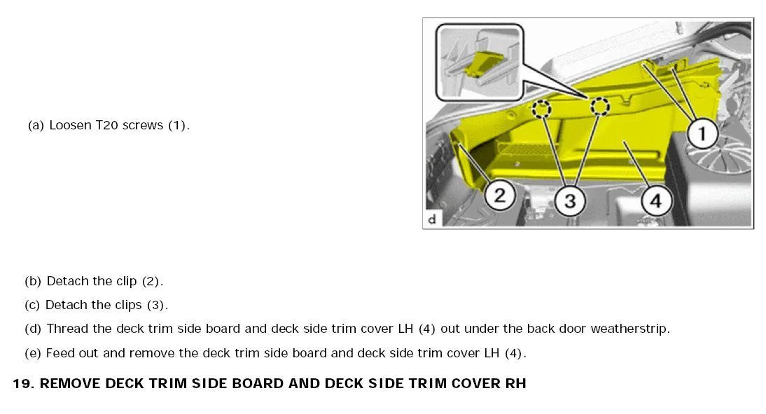

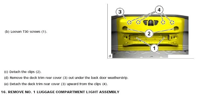

Panel Removal Instructions to Get to ASD Module:

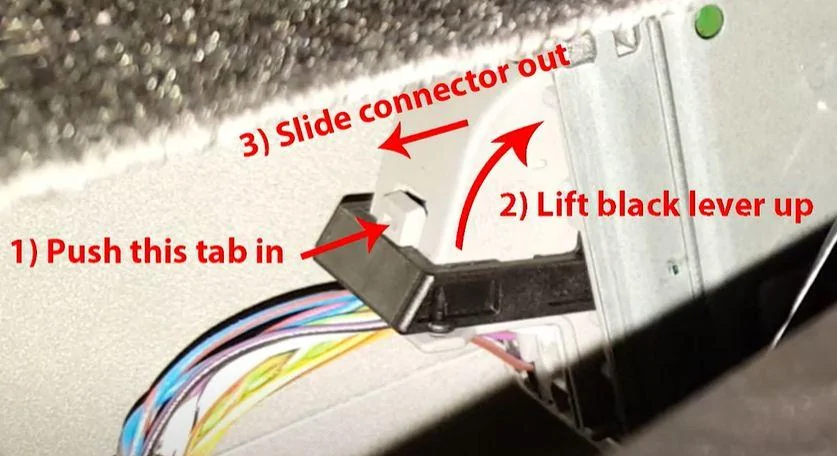

Unlatching / Disconnecting the ASD Plug:

Appreciate the guide here. One thing that I messed up at first is that you actually have to pull off another layer of trim that is further up the hatch in order to reveal the torx screws highlighted by "1." I believe that this piece is what they called the deck side trim cover in the instructions. So it might be easier to pull that off first, then do the torx screws, then continue with removing the clips in "2" and "3." Once you've done it once though, it is much easier to re-do.
Question for anyone else who has done this, was there any rattle from the cable being free and flopping about? I forgot to think about securing it with some electrical tape. I guess I'll find out when I go for a drive later today.

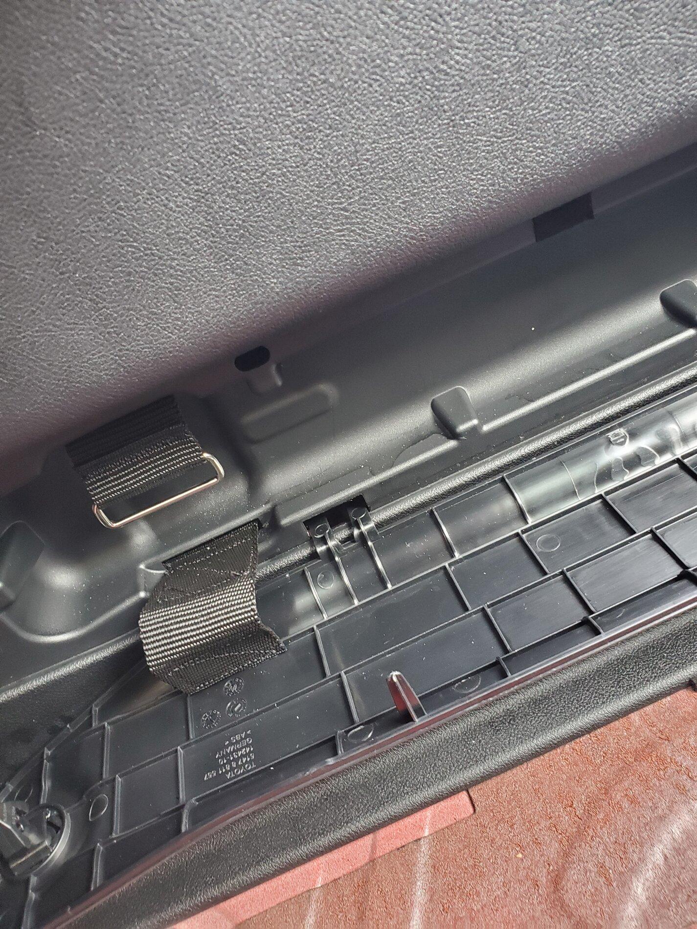

Deactivating the ADS like your instructions say but According to your diagram am I missing something here? Where the loop fasterner wraps around something? It was never wrapped around anything. I had the car in for service and wondering if they forgot to put something back?

Also im stuck at this part. Cant figure out how to remove this side panel.
That is the location where the road hazard stand (during tire replacement) is strapped into...we here in the US do not get one of these so it's empty...
