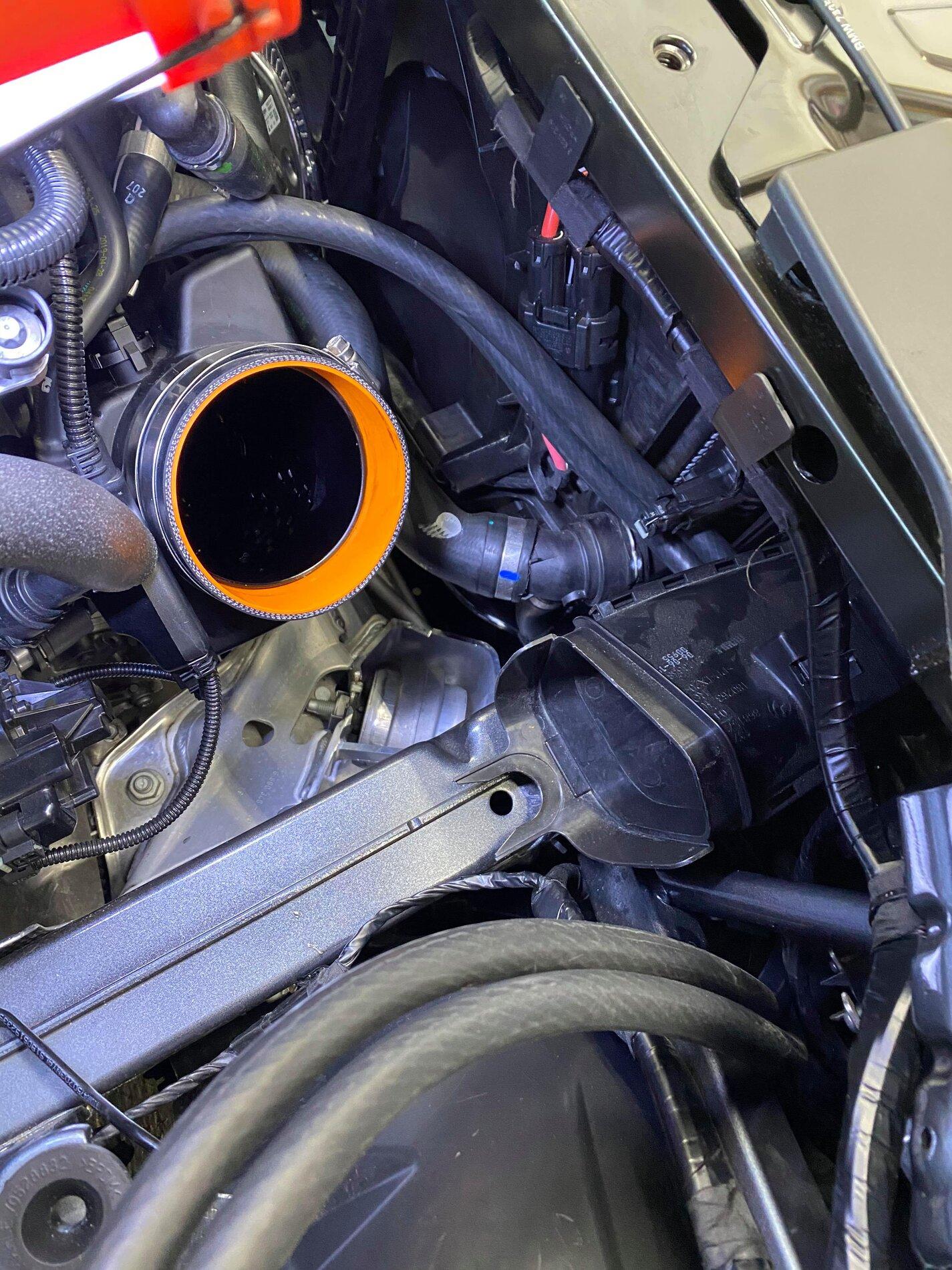

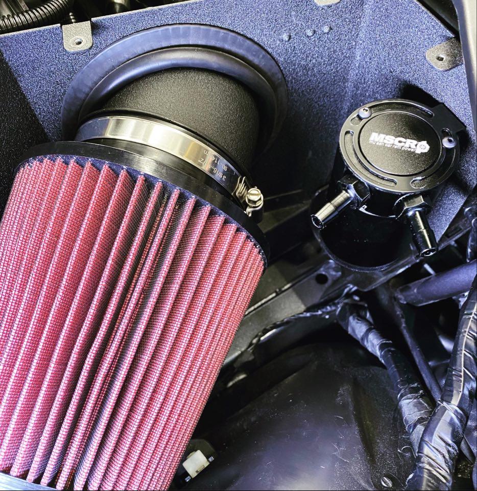

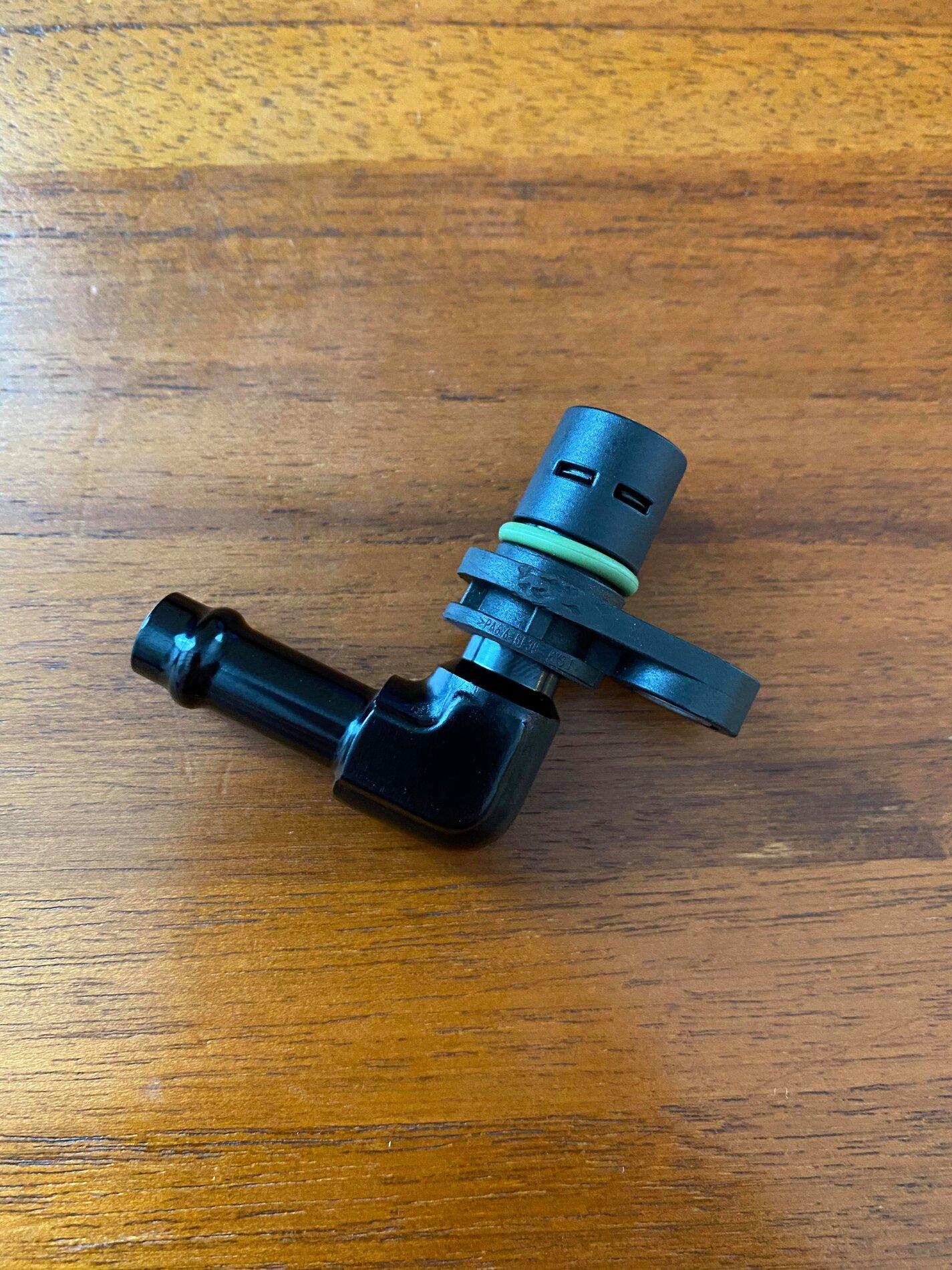

Aight here is my DIY catch can thread... I will list all the parts I used and where I got them... I know some shit is chinese crap, but where do you think 9/10 vendors get their products to relabel as their own, unless it is hand made it probably comes from a chinese/taiwan manufacturer. Sorry USA
Parts List

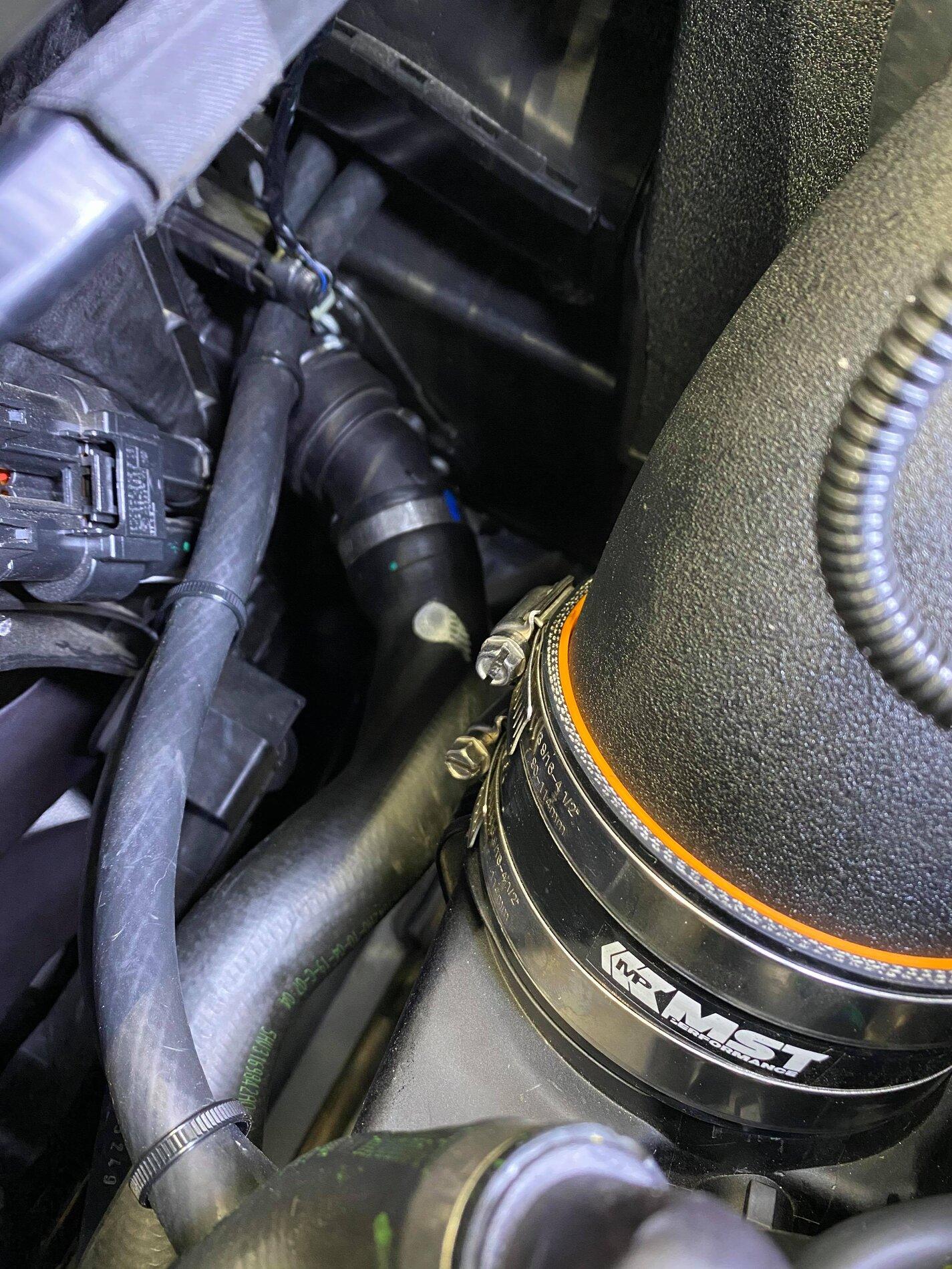

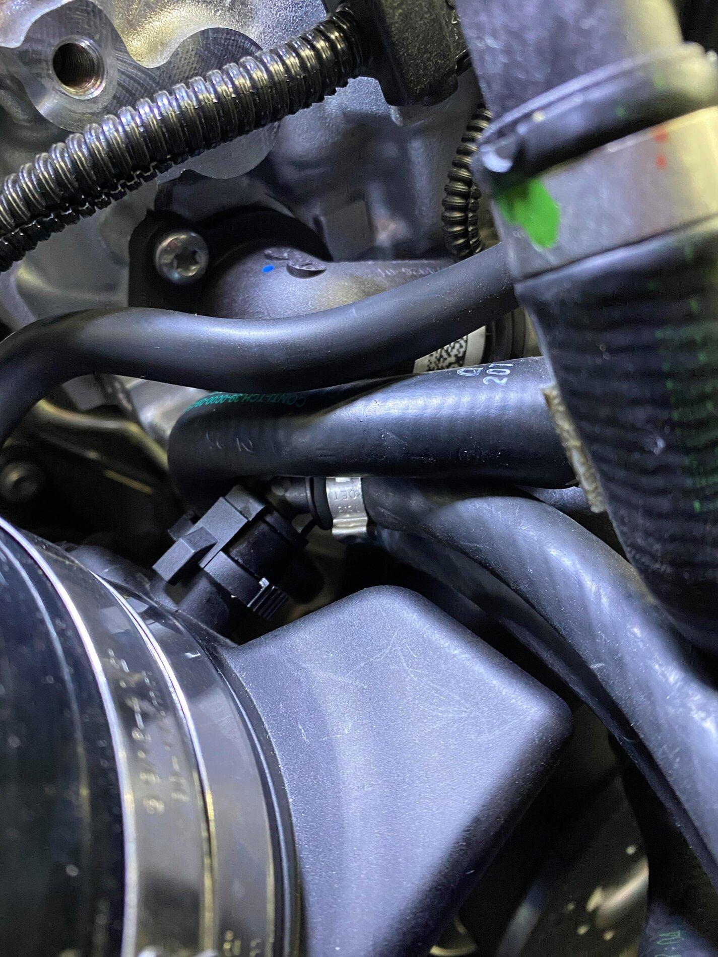

-Used the 1/2" pinch clamp for the fitting on the intake tube as the fitting is for 5/16" hose, and this fitting allowed me to squeeze the 3/8" hose down nicely. It is a pain to get to, so I wanted a maintenance free clamp.

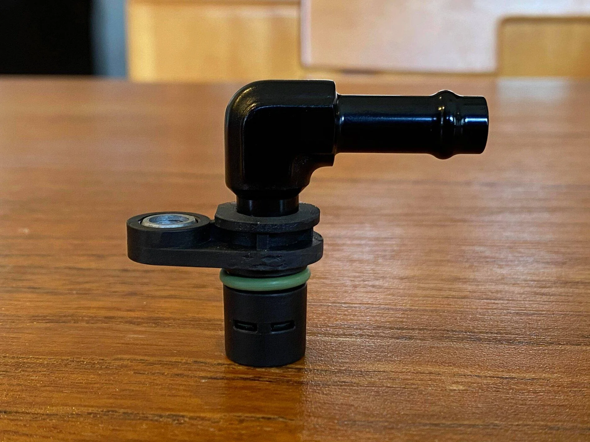

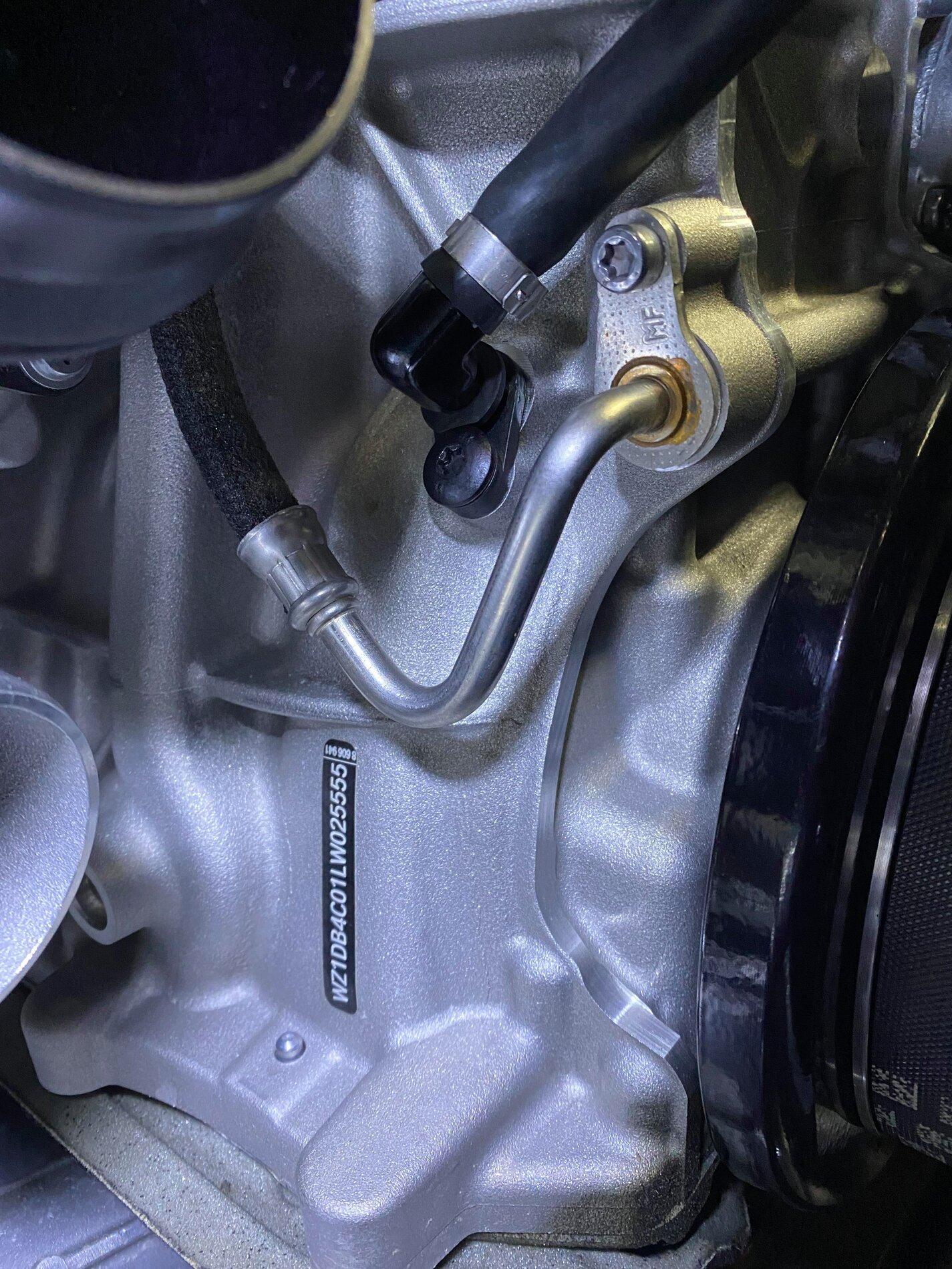

-Used the 5/8" pinch clamp for the 90* fitting coming off the PCV Valve. It is a pain to get to, so I wanted a maintenance free clamp.

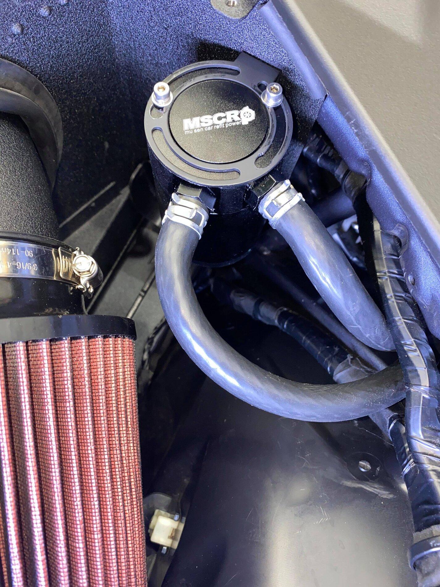

-Routed the hoses under the cold air intake inlet and there is a good bit of room to loop them up back to the catch can fittings without any kinking of the hoses.
-Hose from the PCV valve coming off the block goes to the inlet of the catch can.
-Hose coming from the intake fitting goes to the outlet of the catch can.
-3/8" Drain Cock is for the bottom of the catch can for easy draining.
-1/8" NPT Tap is to drill & tap the back of the PCV valve.
**I removed the BMS catch can that I installed last month as it hasn't captured anything to date... absolutely nothing... when I popped my charge pipe off to get to the PCV valve, a good bit of oil came out again... I will monitor catch can collection and keep you guys updated.**
