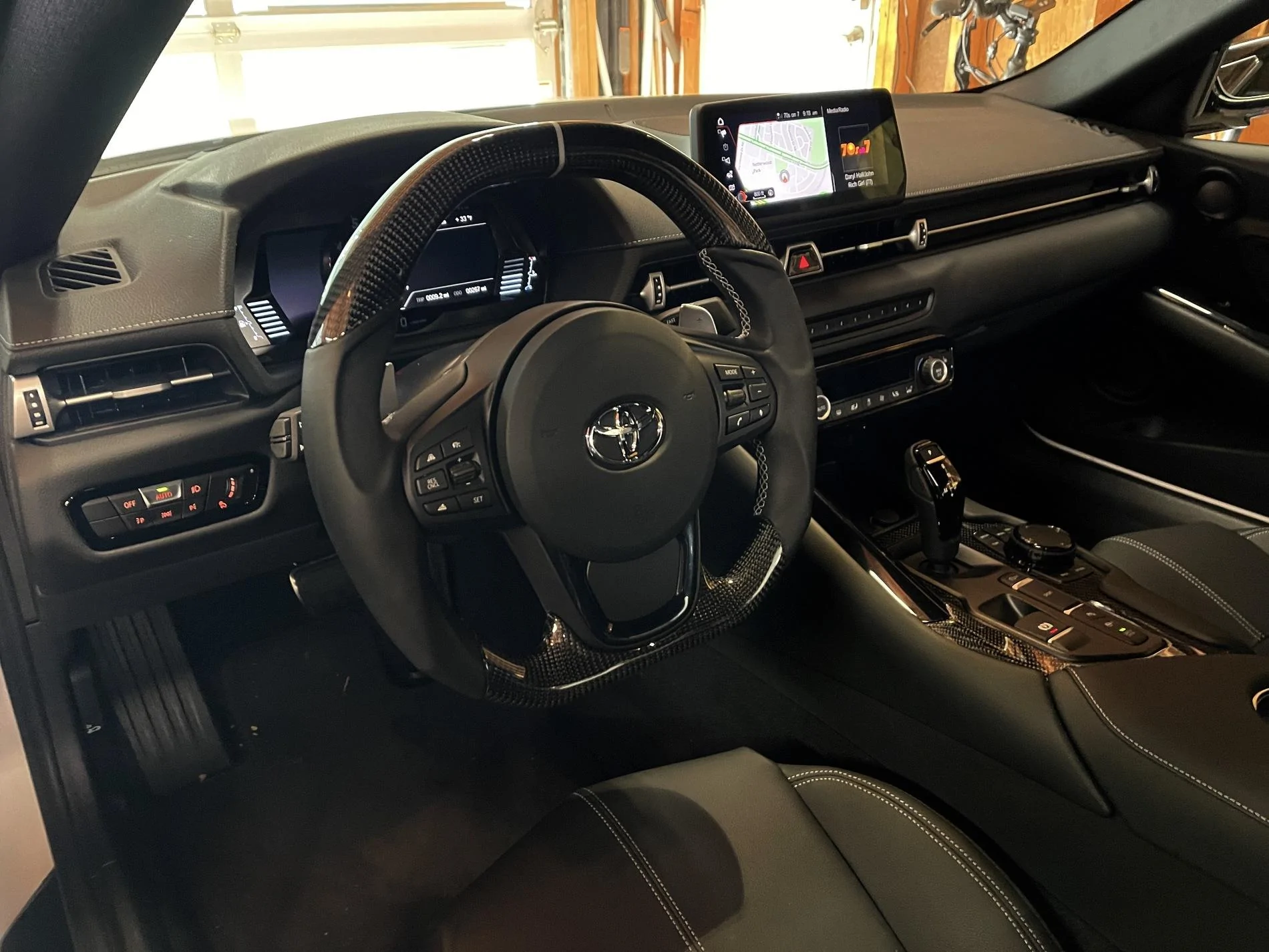

Greetings. I just installed a magnficient carbon wheel in our new 2021 3.0 Premium. This wheel has a center stripe, which revealed the steering wheel as delivered wasn't perfectly centered. This guide will show you a simple DIY procedure to recenter the wheel.

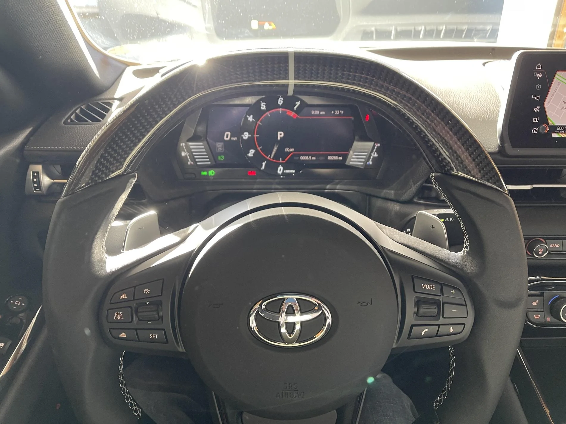

Here's the "center" position of our new wheel before we started. This was the neutral position of the steering wheel when driving straight down the highway.
This is easily corrected with a few tools in about 10 minutes. This guide walks you through a DIY method to center the wheel.

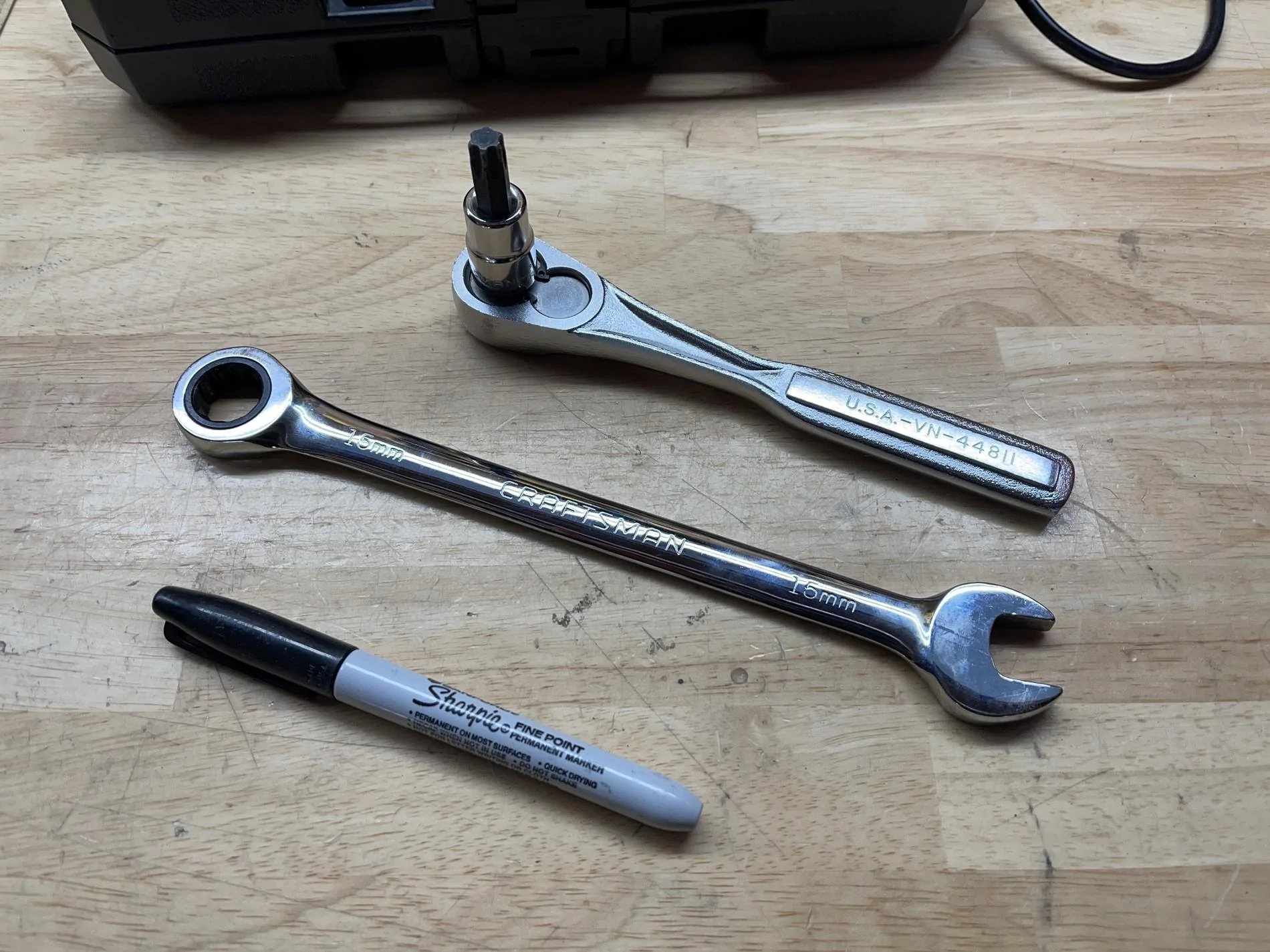

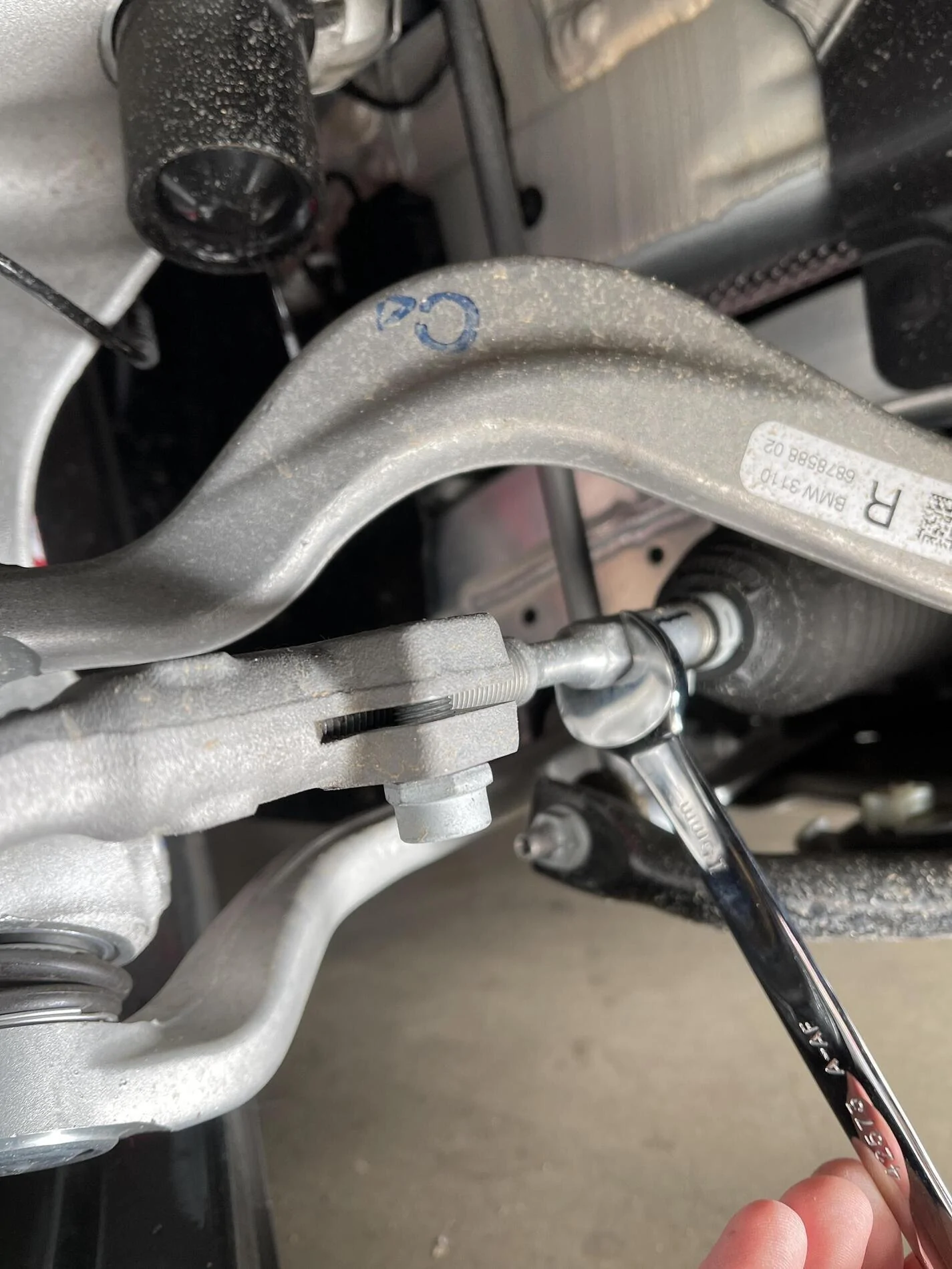

First, you need a 15mm open-end wrench, a T50 socket and ratchet, and a sharpie marker.
Perhaps the hardest part of this is figuring out which way to turn the steering rods. My wheel was "centered" slightly to the left. To recenter the wheel, the wheels needed to point just a bit more to the left. You'll see how this translates to the adjustments, below.
Now, turn your steering wheel all the way to the right, so you have access to the right-side front suspension. Look inside the front wheel, you'll see the suspension including the steering rack.
Note that the steering rack is in front of the spindle. That's pretty unusual, most cars have it behind. Lucky for us, it makes access pretty easy without a need to remove the wheel or put the car on jacks.

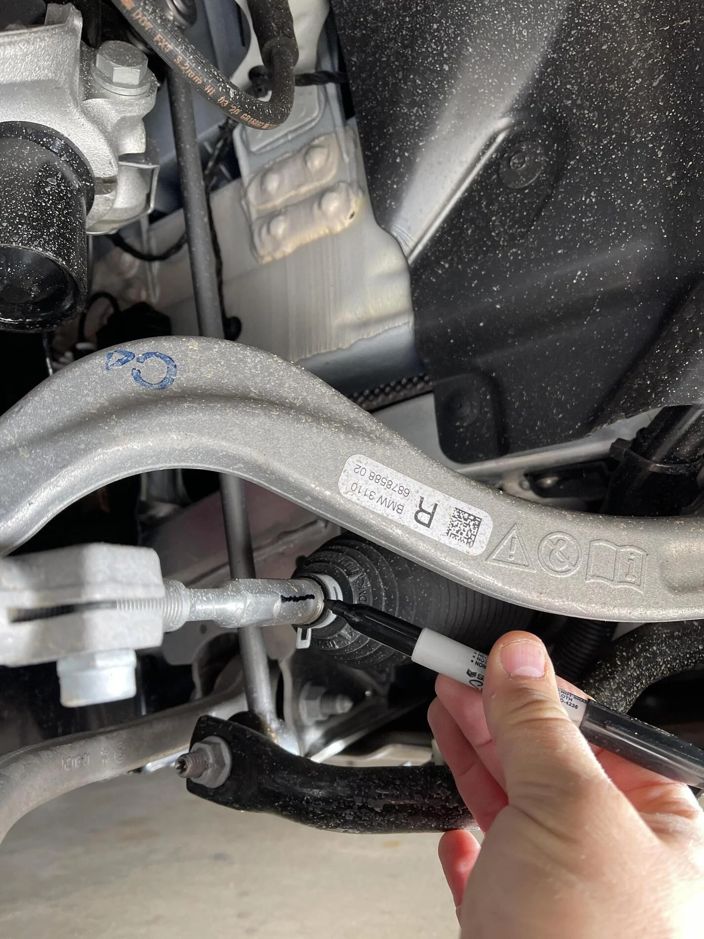

THIS PART IS CRITICAL. Use a sharpie to draw a line on the front portion of the tie rod. This is our reference to make sure we adjust each side the same.

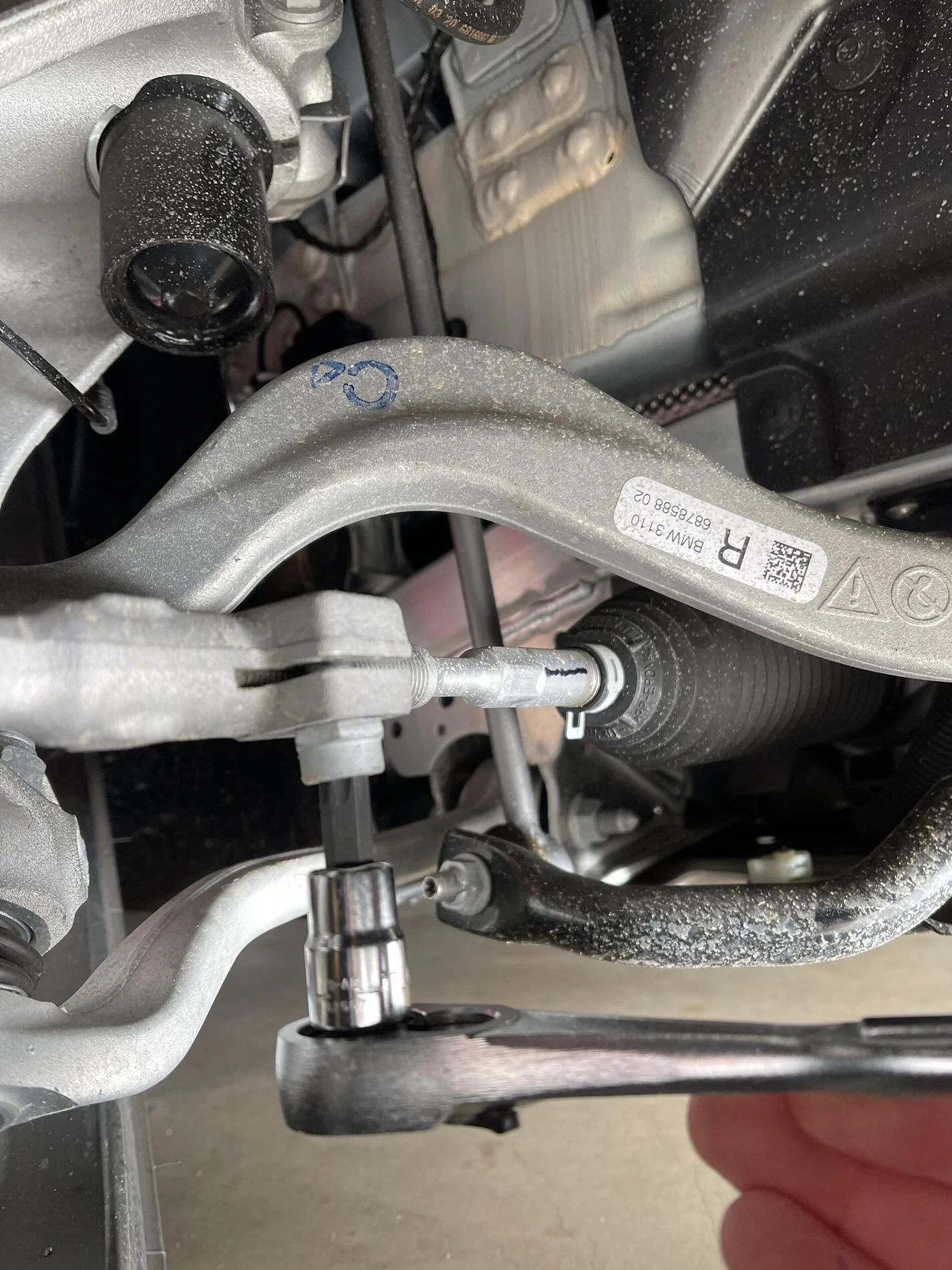

The tie rod is easily adjusted. You must first loosen the pinch bolt. Use a T50 socket and ratchet to loosen this, but don't remove it.
Now for the fun part, adjusting the rod. Both rods are threaded the same, "normal" direction. RIghty-tighty, lefty-loosey. As I need to move my wheels to the left, I will SHORTEN the rod on the right side. This means rotating the right-side tie-rod so that a quarter-turn moves the line I drew on the front to the top. This is clockwise rotation when looking at the tie rod ("righty tighty"), shortening the overall linkage by screwing the tie-rod into the tie-end.
I adjust this rod with a 15mm open-end wrench so my line is now exactly on top. Try to be precise about this, you want the same amount of rotation on both sides. Once you've moved the rod, retighten the pinch bolt with your T50 socket. And, that's it for the right side!

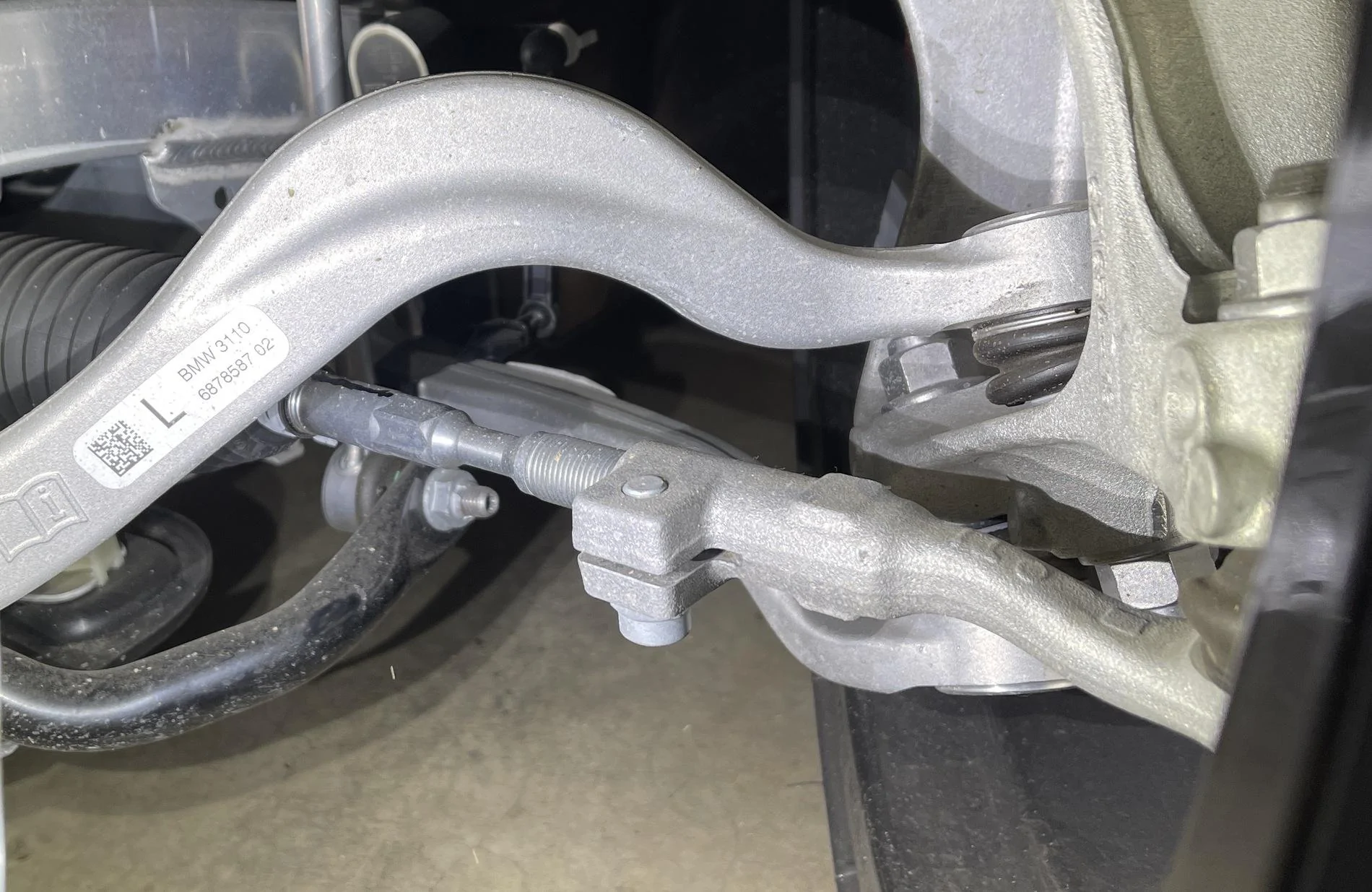

We now repeat this procedure on the left side, with one important exception. We need to LENGTHEN the left side rod by 1/4 turn. The line you drew on the front WILL STILL MOVE TO THE TOP with a quarter turn. However, the rotation of the rod will be counterclockwise when looking at the tie rod from this position ("lefty loosey"), lengthening this tie rod by moving the tie-rod out from the tie-end.
Left side:

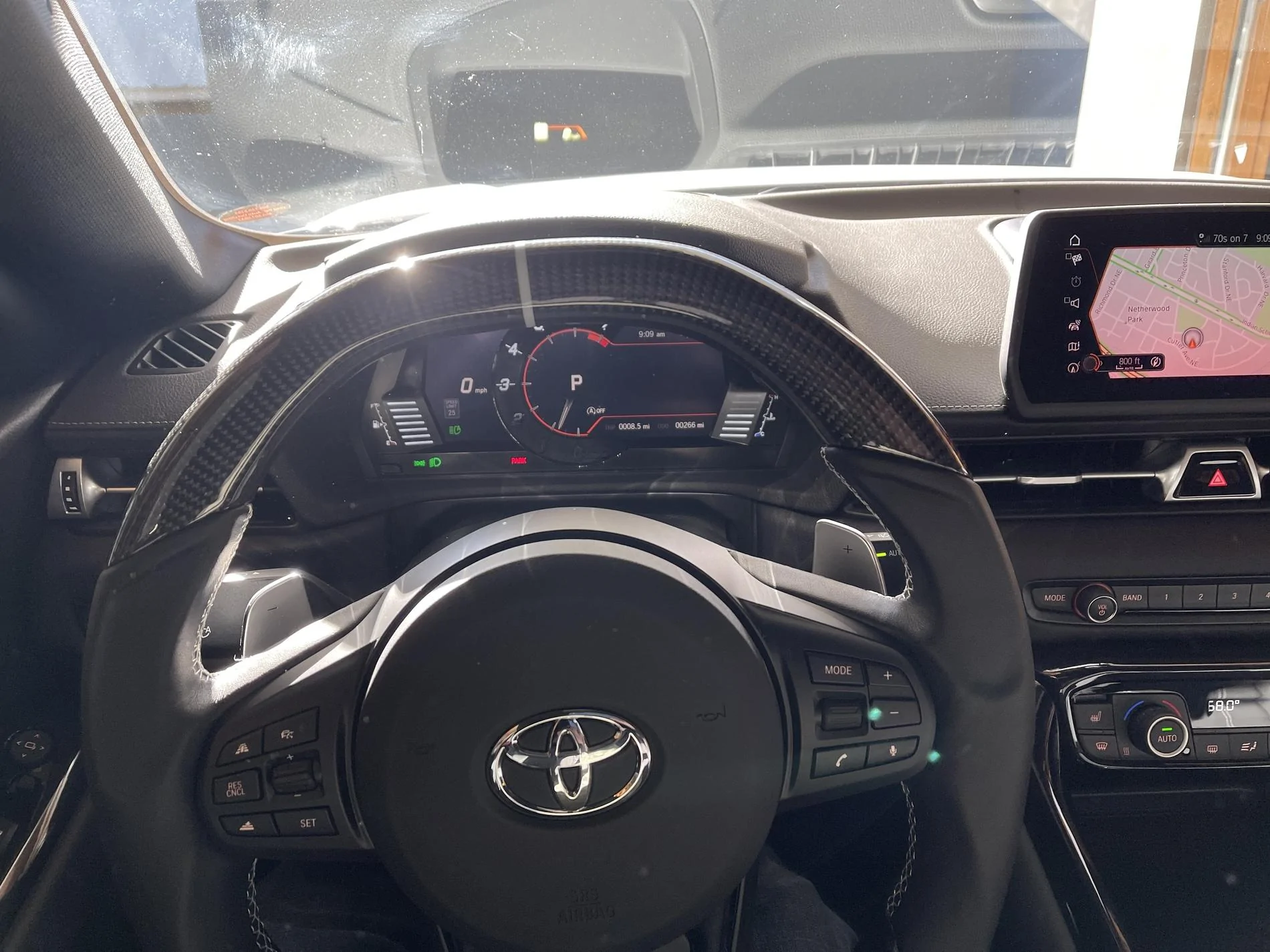

And, that's it! Moving the tie rods 1/4 of a turn on each side resulted in the steering wheel rim moving about 1cm for recentering purposes. This was just about perfect on my car, and the wheel is now nicely centered when Highway driving.
You'll likely need to move your wheel a different amount. Scale the amount of rotation of each tie rod by this value: 1/4 turn ~= 1 cm of rim movement. You may need to test-drive and iterate to get things perfect; this procedure doesn't take that long.
