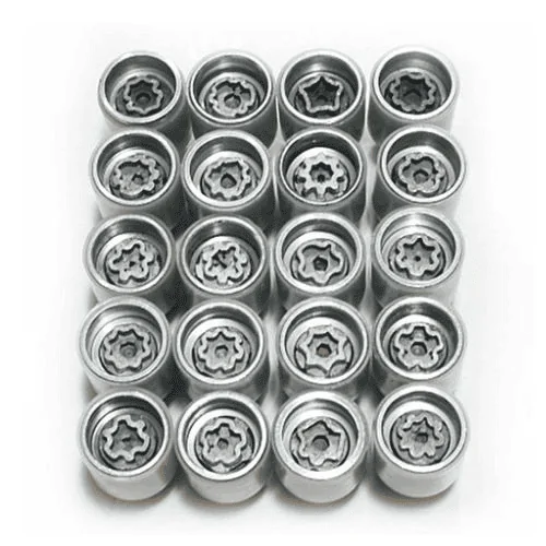

There's not a master key. I used to work at a Toyota dealership and we had a case that had every single lock pattern that Toyota offers. So if we had to remove a wheel lock on a customer's car and he/she didn't leave the key, we'd have to break out the case and try every one of them until we found one that fit.

There's 10 different patterns that McGard makes for TMC. Yours could be any one of those, and the only way to tell is to sit there with the master kit and try them until one clicks neatly into place.

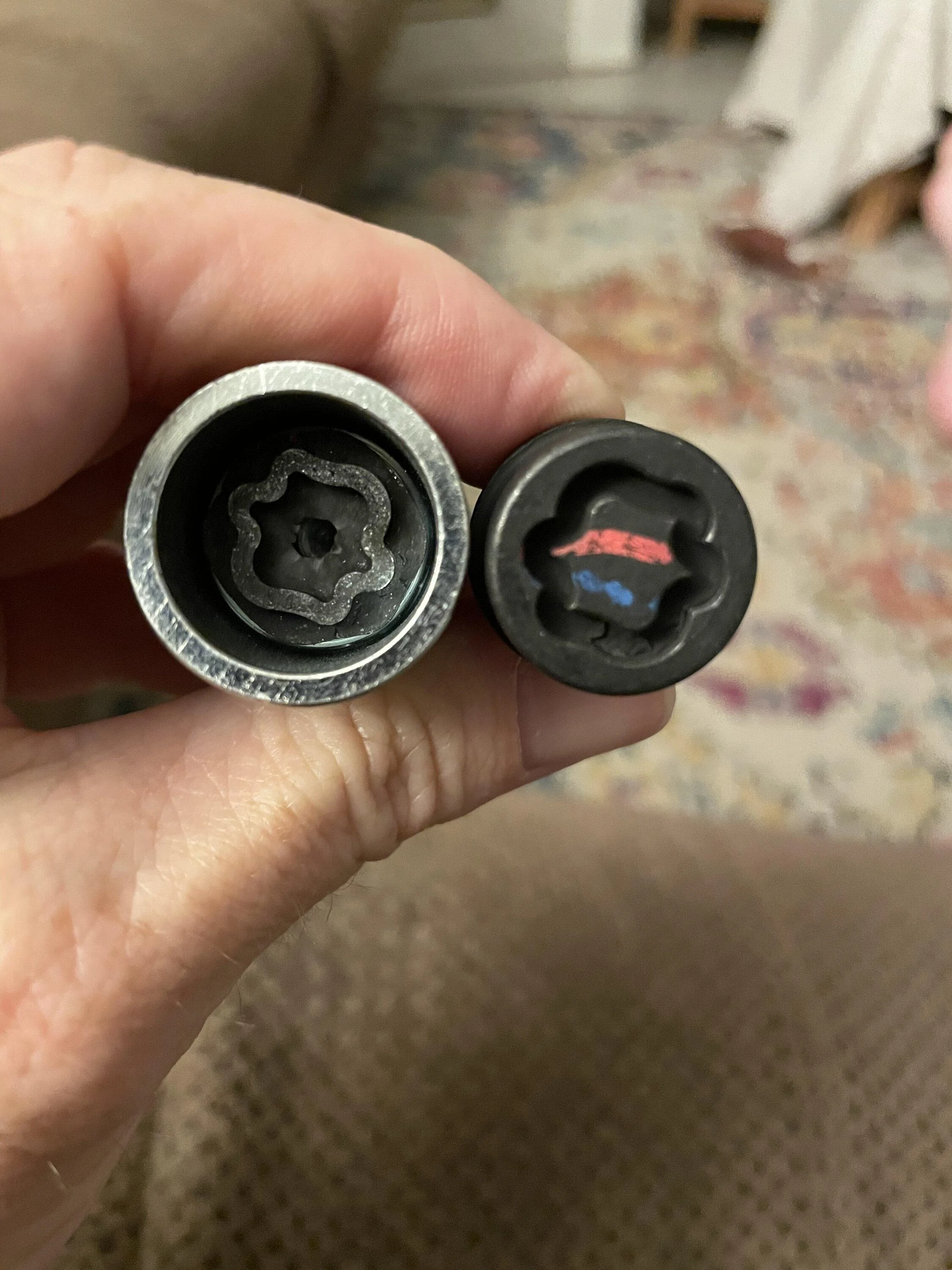

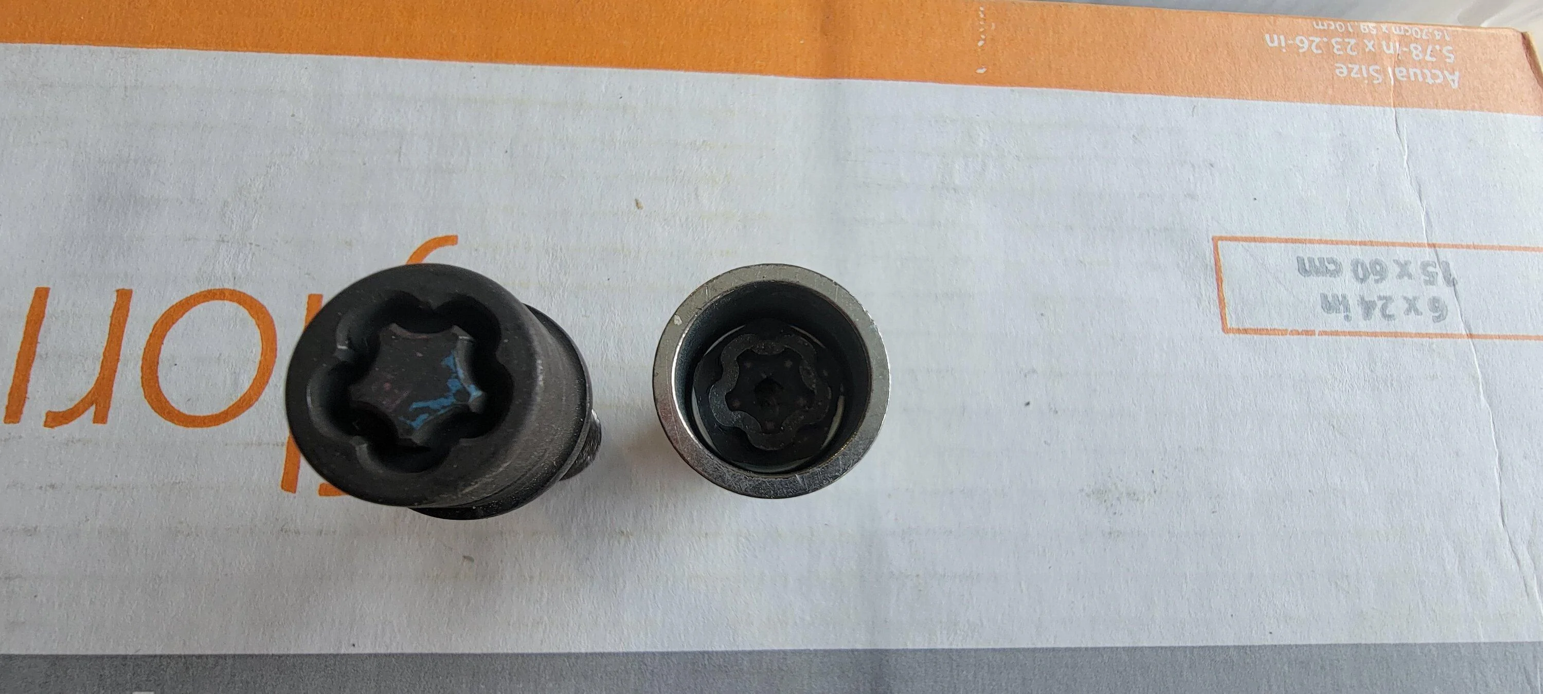

Not sure if it's the same as yours but I have this one.
I mean it looks like that shape yes
Do we have confirmation of any Supra locks differ?
