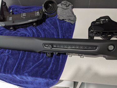

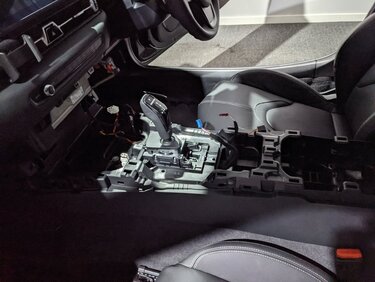

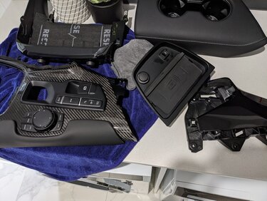

Center console removes dead-easy. Pull up the rubber liner from the cupholders, remove the 2 screws you'll see underneath (T20 torx if I recall), then pull the whole leather cover straight up. It's attached with several clips.

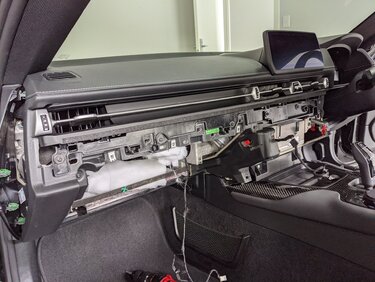

The pieces that are highlighted in the picture below, just the pad and the leather top for the center console
Leather/rubber side panel pulls off there are 10 or so torx screws the whole plastic panel pulls off
There are two Torx screws under the rubber cub holder liner and the whole head rest pulls up easily.
When thats off you can pull up on the carbon fibre piece unlplug the connectors (about three) and lift the entire panel out. The wireless charging matt lifts out unlplugging about three connectors.
Interested as to why you want to dismantle?
If you have creaks - I got rid rid of all my creaks 100% - zero noise over any surface.
I am amazed how easy it is to pull this car apart.
The front panel was the worse at creaking you push on it it creaks, in hot weather it creaked all the time and going over uneven surfaces.
I lined the entire inside of the panel with sound deadening and foam tape.
I did the same with the aircon control housing.
Its really easy and hard to break anything.

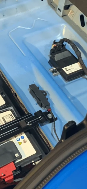

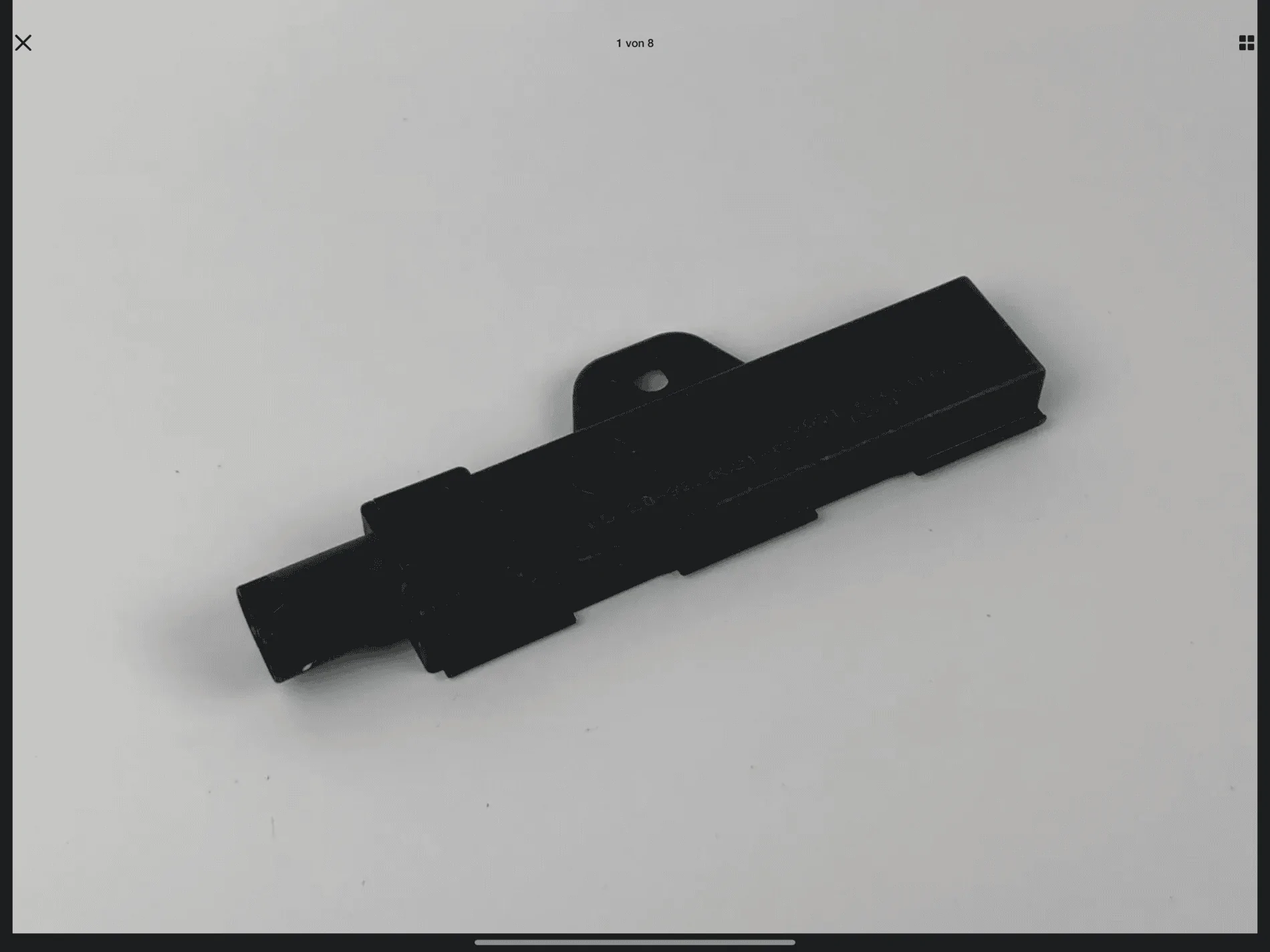

Did you see the antenna for the keyless go beneath this tunnel ? Its not below the armrest.... where is it located ?
I'm not sure what it looks like but if you lift the wireless charging Pad there is Purple antenna connector wire not sure where the wire runs to.

Yes I found this one. But there seems to be another one below the middle tunnel......
