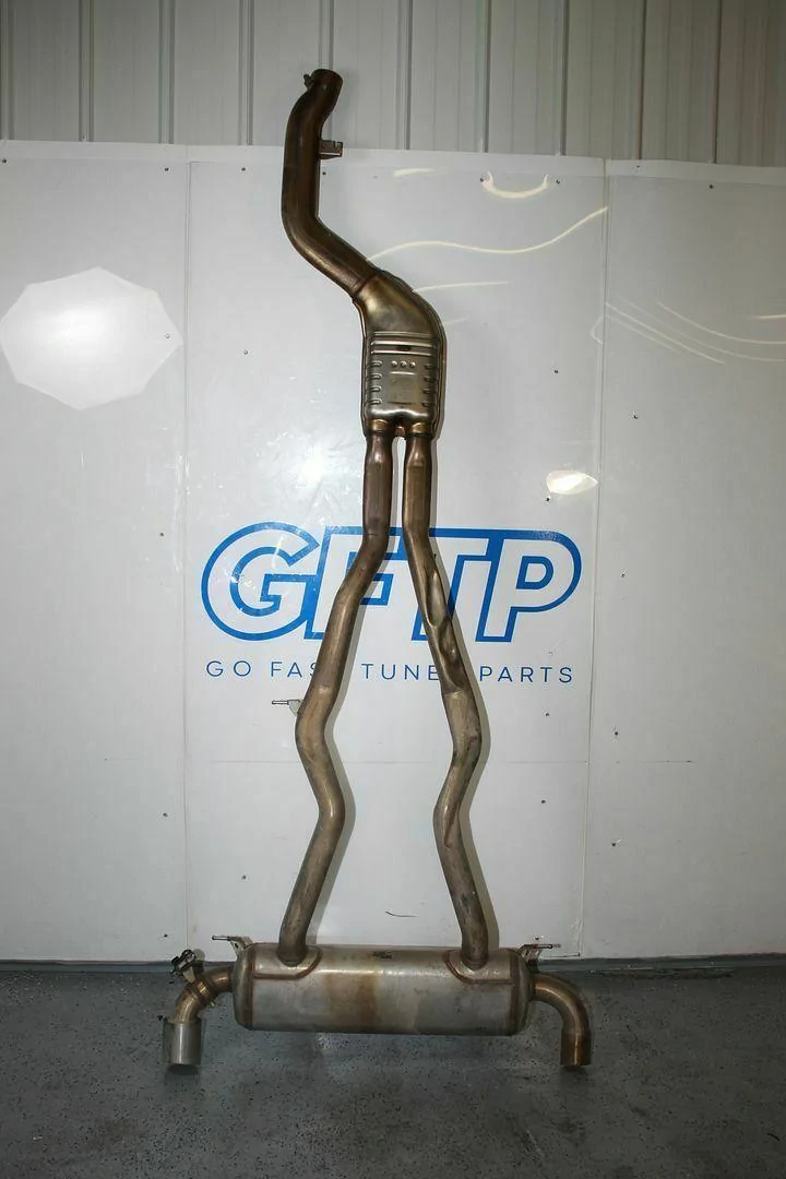

Hey guys,
quick question, does anybody know if the Supra has mid-pipes? I would want to delete those to make it louder.
Xxyion
Nov 14, 2020
301
364
Fremont
A91 Refraction Blue, 05' S2000
Hey guys,
I'm going to take the high road and assume that you dont quite know the terminology you are trying to get across.
All cars with exhausts have "mid pipes". Its the pipe that usually contains a resonator and the the pipe that connects your rear muffler (or axelback) to your downpipe. In some cars this is a separate piece like in the BRZ. For our cars, its welded directly to the rear muffler.
You CANNOT just delete the mid pipe, at that point you'd have no exhaust and it would be insanely loud. Like 120 db loud all the time. I'm assuming you were wondering if the midpipe has resonators or a muffler that you want to delete. Most catback systems for this car get rid of the resonator in the midpipe, so just find a catback that you want and make sure theres no resonator in the midpipe and you're good to go.
