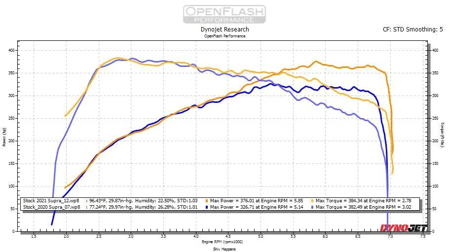

I am not really understanding the power difference highlighted. If research was really done, then it would have been understood that toyota under reported the power of the 2020s and once people got them on dynos they saw it was basically what the 2021 are reported to be now. In the future anyone looking to buy a used supra is not going to hear 2020 and think 335hp if they did any research on the car.
I think you're mistaken. The power difference between the 2020 & 2021 is a real 47hp difference. See below for Dyno results down back to back. I'll link the thread by OpenFlash Performance.
They're both under reported. A 2020 and 2021 were dyno'd right after another and the 2020 made 345 to the wheels, and the 2021 388 to the wheels.
