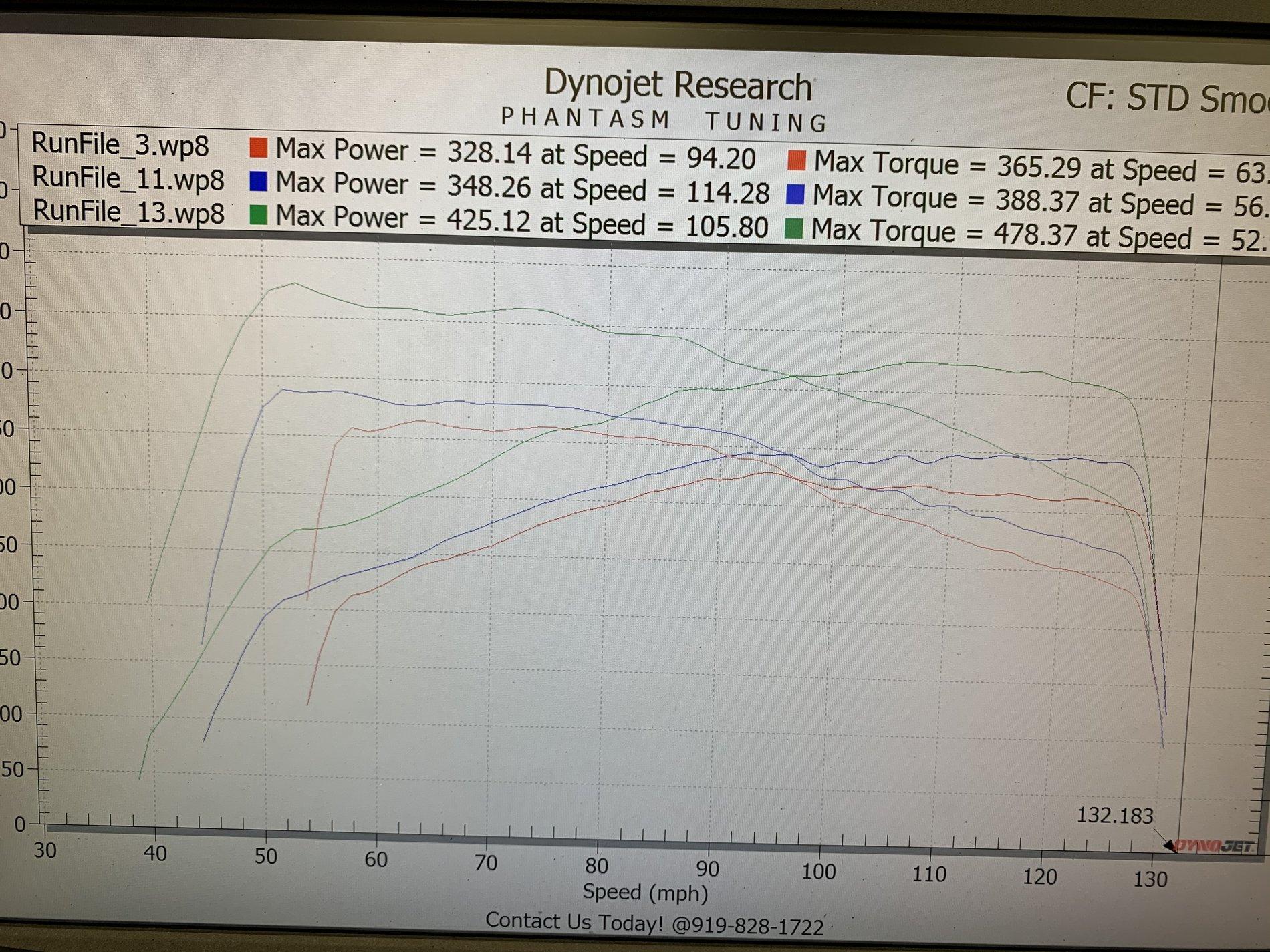

Dyno comparison between stock, ETS Catless Downpipe/Exhaust system and MHD OTS Stage 2 93 pump Map
LG_SUPRA
Luis
Mar 25, 2020
Raleigh NC
Hey everyone, my first post here hope is helpful to some. Here is a great comparison from stock making 328whp to the 348whp with ETS Catless Downpipe and Exhaust system no tuning, then did MHD OTS Stage 2 93 pump map putting down 425WHP. Stock the car felt great and it ran a 12.3 at 114mp. with just the upgrades of the Catless Downpipe and exhaust system it sound amazing but I felt the performance was not what I was hoping for lol but I was happy. After the MHD map and my first street ride I was the happiest Supra owner in the world the difference was night and day! Now moving on to more upgrades, pure turbo, meth kit, intake, forge boost pipe and having Mickey (Michael Botti) Tune the car with ECUTEK next week. I will post the dyno numbers to have all four comparison.

for the lazies :)
would have rather preferred vs engine speed, but wth.

Actually the MHD is vs parts, right? No e85 where you live?
MHD with parts no E85 just 93 pump. I dynod the car with just the parts first before doing the MHD so I can compare.

Yeh. I got the 93 part. You mention you're planning meth injection so I was just wondering if e85 is an option where you live.
Yes E85 Is available in my area probably in the future will add it
