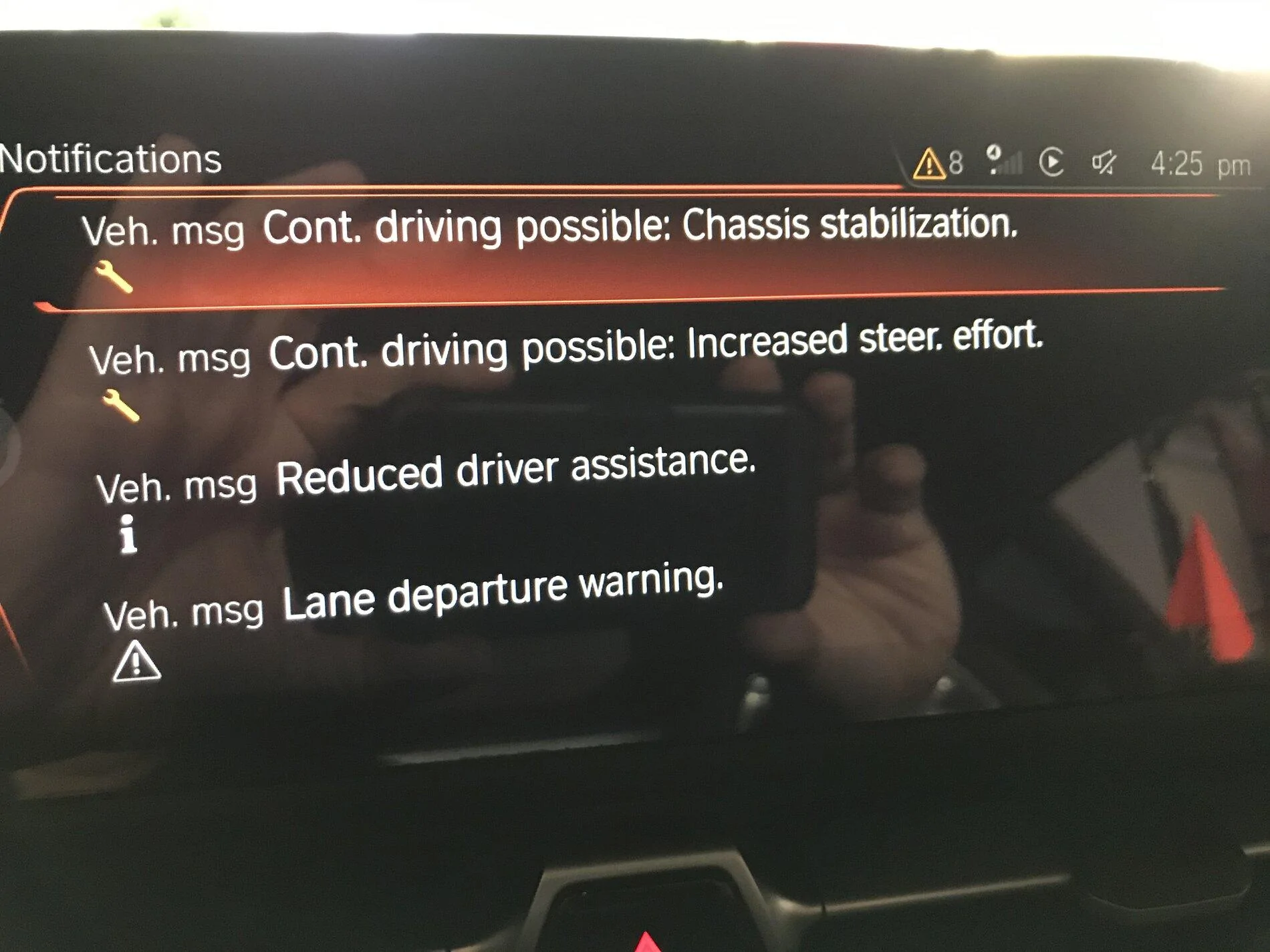

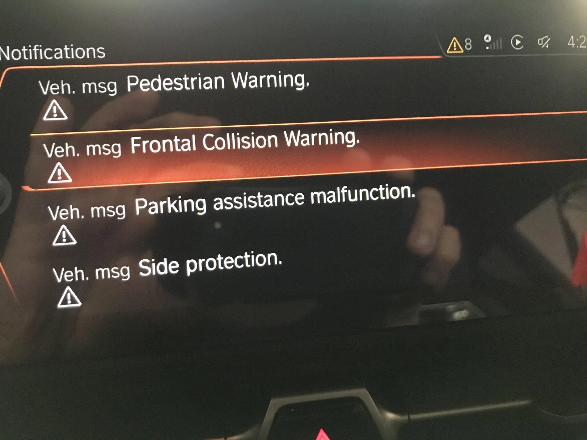

Recently, my 2021 3.0 Premium had between 7 and 9 warning messages popping up every time It started and it would reduce power steering assist & the stopped locking the rear diff. Eventually the EPS (electric power steering) went out completely and I had to have it towed in for service.
The dealer claimed to clear the codes by flashing it with the latest software but they couldnā€™t get the EPS to communicate with the car and had to replace the EPS rack entirely.
They had it about a week and I just picked it up yesterday... it seems to be driving fine so far...Fingers crossed!
Anyone else have EPS issues or EPS combined with safety systems?

I have every code you have except increased steer effort but my steering wheel does feel like it has no power steering. Turned on car on Wednesday for first time in 21 days since had covid and greeted by fault codes.

Yeah I tried on Monday already they claimed all codes are related to recently lowering the car according to tech, SA knows and I've shown proof I've had car lowered since late august but they're playing clueless and want to charge diagnosis plus repair fee for their findings. Ridiculous, I already called toyota usa waiting to hear back

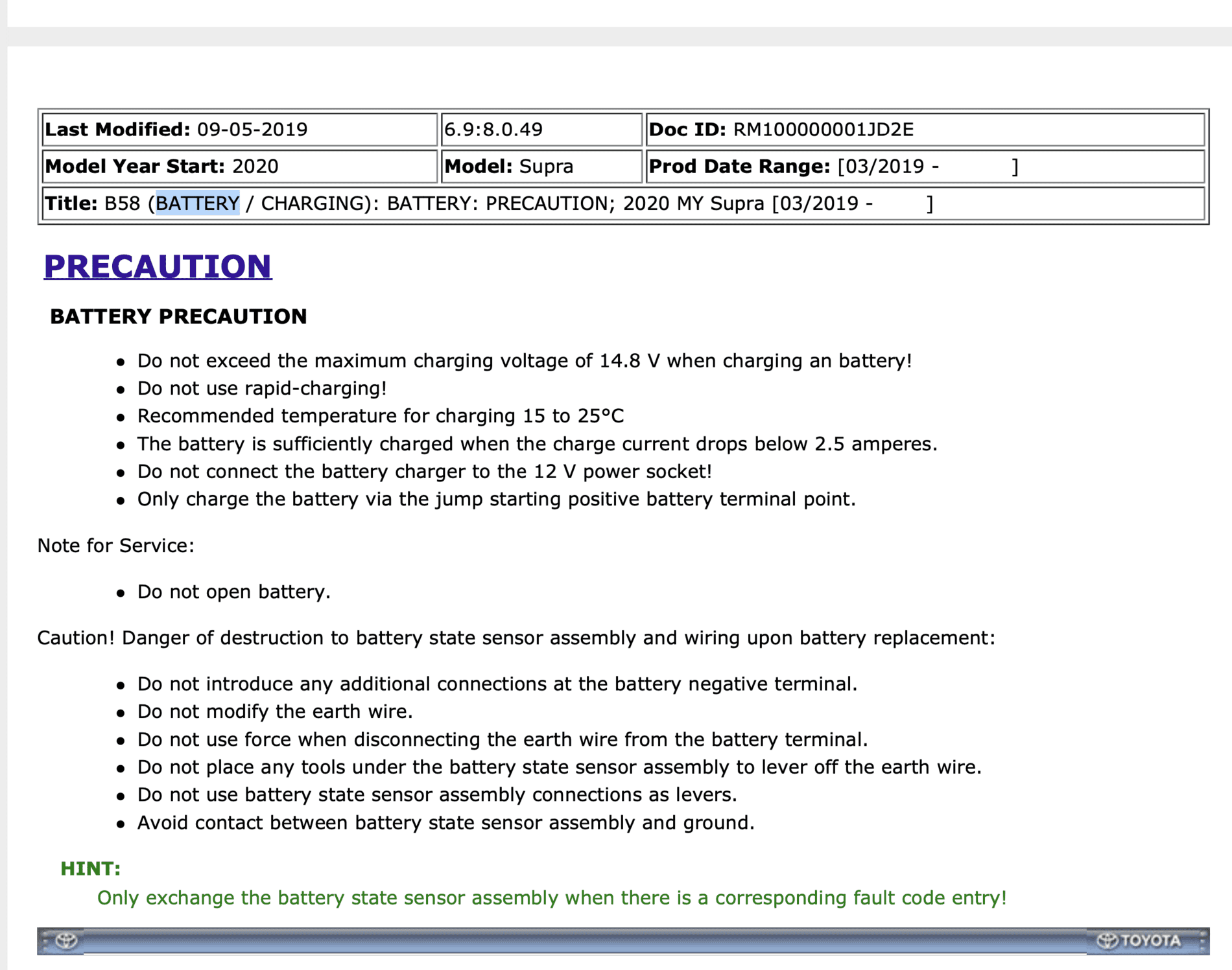

Gentlemen - I believe your batteries are low on juice. All the error messages you showed require battery power to operate properly. I had issue with battery 1 week after picking up mine. The message is "reduced functionality of the LSD" or something to that extent. Get those batteries charged up as soon as you can.
This vehicle uses a lot of battery power even when sitting. You MUST lock it to shut off all the peripheral electronics. Or depress the volume button for about 3 seconds. I learned this the hard way and am in the habit of locking the car after parking in the garage now.

Not to belabor the point but battery voltage doesn't tell the whole story. Also not saying that it is DEFINITELY the battery. Mine was acting up with error messages on the LSD and driver assistance features when voltage showed 12.3V. I use my Radar Detector display to watch the vehicle's voltage. The charging system is managed by the computer. When it is new (as most 2019/20/21 Supras are), the computer doesn't activate the charging system often. Only when you're coasting (foot off gas pedal) does the charger get kicked in (voltage goes to 13 - 14V).
By the way, the "Toyota" battery they replaced in mine was made in Germany. LOL ... A few weeks later when I was in the process of installing the charger in the trunk and need to find a solid ground point, I noticed the main ground wire between the battery negative terminal and the car's chassis was not torqued tight (can be moved by fingers). I was amazed/disappointed but glad I found it. I hooked up my charger between battery + terminal and this ground point and re-torqued everything.
Here is the chronological order of my issues:
  1. Car was never locked in garage - battery drained in 1 week
  2. Got a jump and drove to dealer with error messages about LSD and driver assistance features the entire trip
  3. Battery replaced by dealer
  4. Still not locking car in garage (not everything is shut off)
  5. After 1 week, error message popped up again about LSD and driver assistance features
  6. Bought, installed charger and lock car when parked
  7. No error messages since - knock on wood!
You maybe should NOT be hooking up a charger directly to the battery. It can cause lots of problems. You should be using the jump points under the hood.

Sorry to alarm you. This is normal. Right after starting, the battery is somewhat drained. Mine shows 12.1V right after starting, and I disconnected the charger 5 minutes prior. I am curious as to what the diagnosis for your issues will be.

@consultadrone - thanks for the tip. I think the caution is for people who connect charger directly between red/blk on their battery. Mine is connected between red and chassis. There is a big @ss wire from chassis to battery blk terminal, which should provide enough inductance to prevent high current spike and/or arcing. This is how CTEK recommended. Although I noted that (based on info above) they make a point to say to charge battery via the jumping points. Did you get this page from the shop manual?
