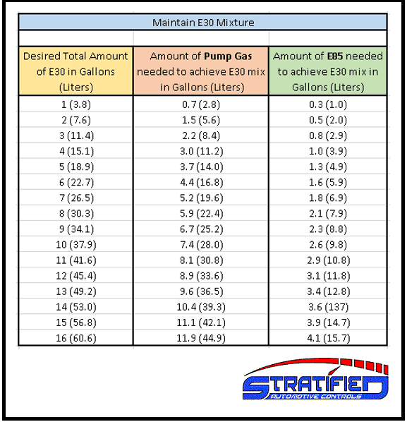

From what I've gathered for Ethanol blends, it is best to run the car til you hit Reserve on the tank. Next you fill up a certain amount of E85 (use the pump meter to see how much you put in), then fill the rest with pump gas. Here is a chart that I see pop up on forums for various cars for E30 blends. This would obviously need to be adjusted for other blends.

The calculator I linked has a number of advantages. You can set it for any ethanol percentage. It also takes into account the concentration of the residual fuel still in your tank. You can ignore the "Select car" option.
