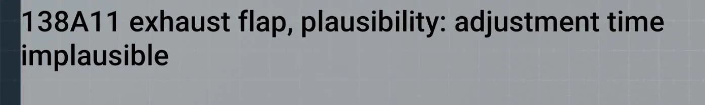

Got a revised bracket from Titan motorsports for their new titanium exhaust flap. Exhaust flap closes fully when the engine is off. Exhaust is always open when the motor is on, no matter what mode I'm in, nor anything I try to do. I'm desperate to be able to quiet the car down a bit when not pushing it.
I've tried two separate actuators, and nothing seems to work. Tried the JB4 flap control and it activates signal lights on the dash, but the valve doesn't shut in any mode.
I did get a CEL for the actuator when the old bracket was installed and it couldn't close all the way.
Any ideas? Is there a way to reset it or anything??
