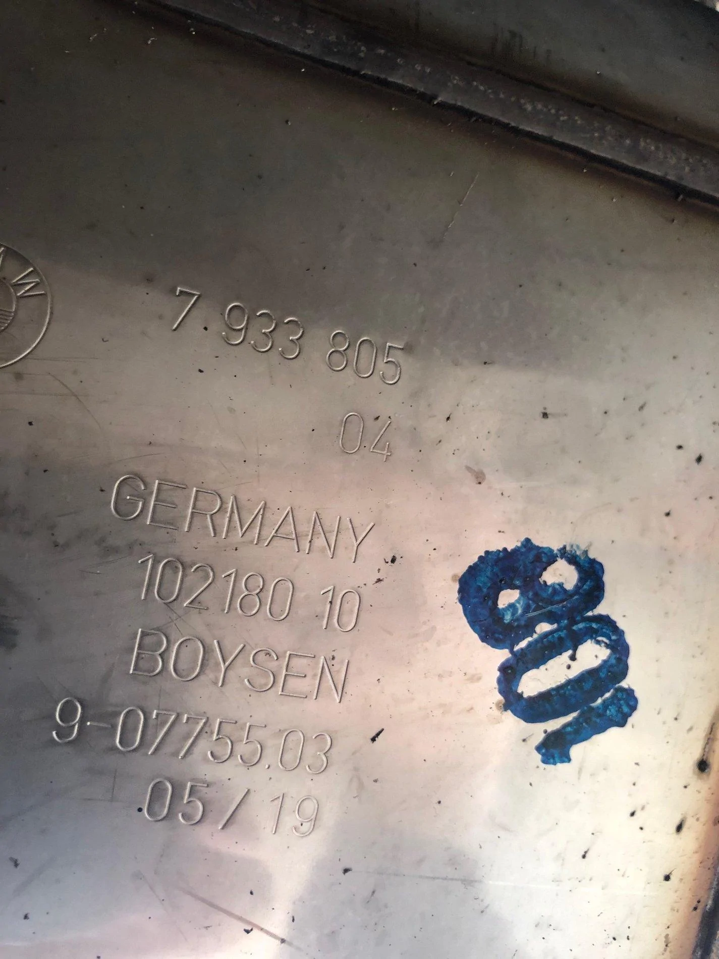

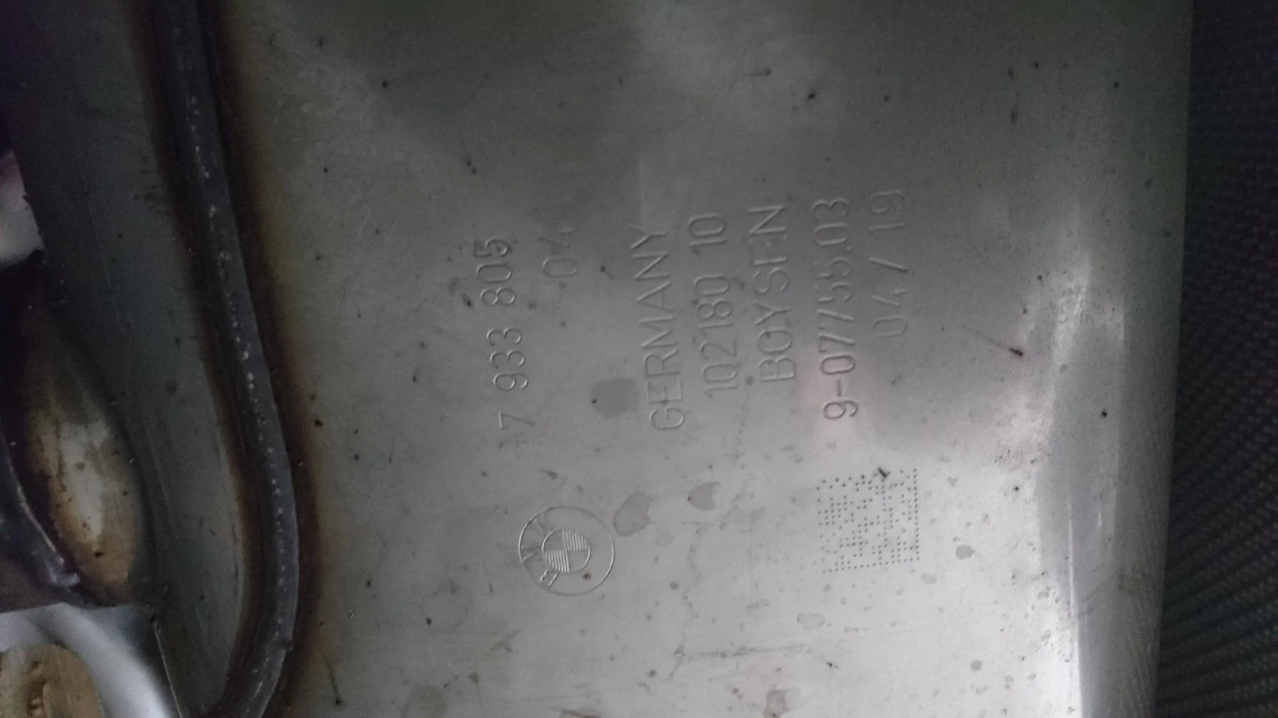

Would you guys mind getting a photo of the part number on the rear muffler, for cross-reference?
This is the UK / EU one for reference:
So same part no as Australia
