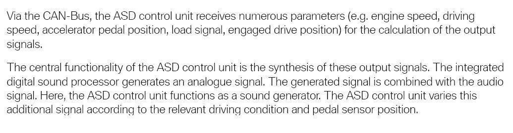

Here is a description on how ASD operates....

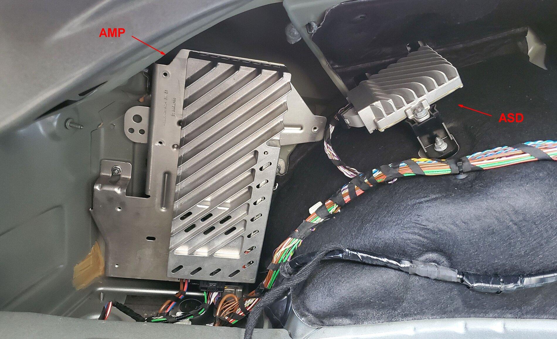

ASD module shown below...

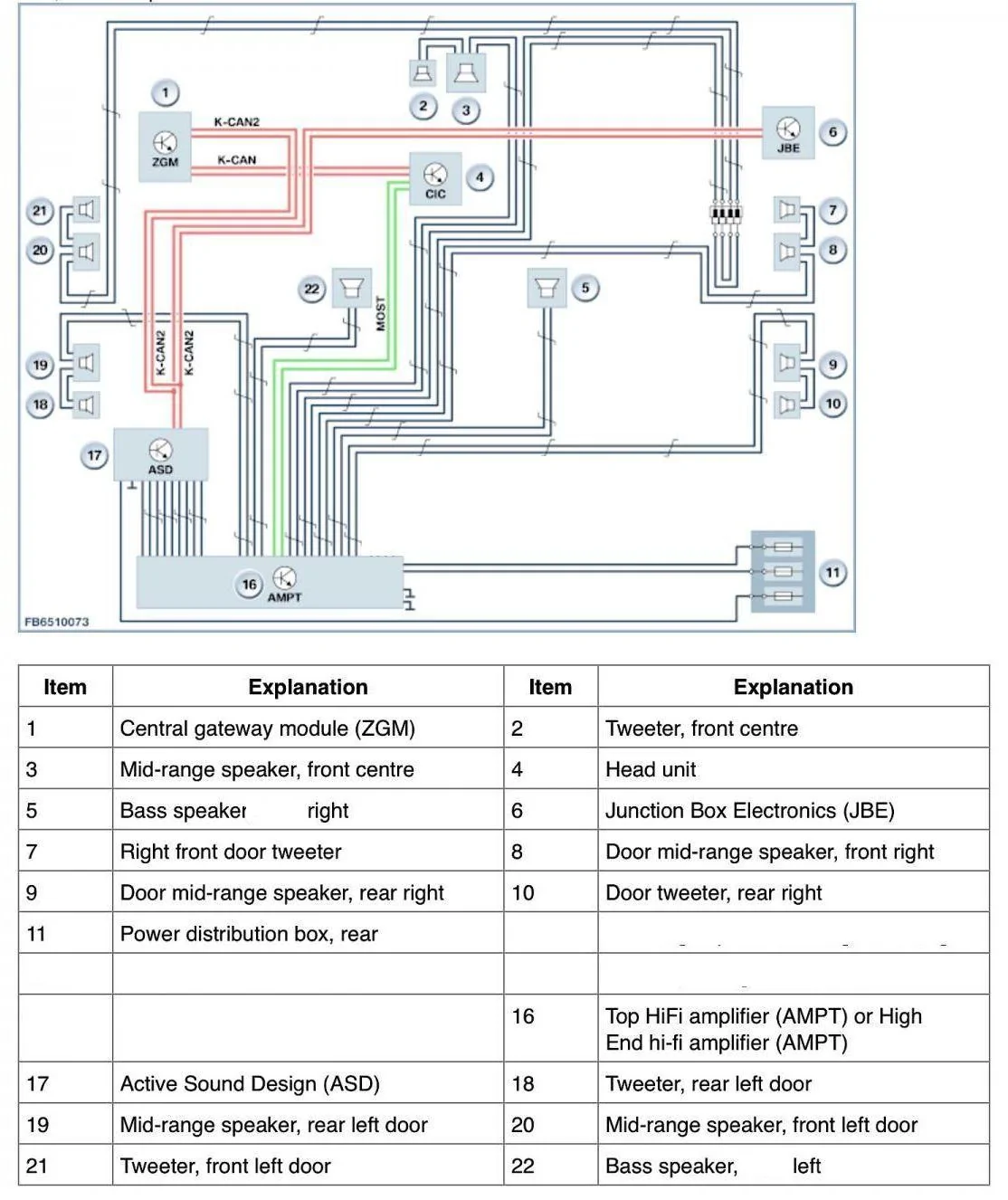

System diagram...
