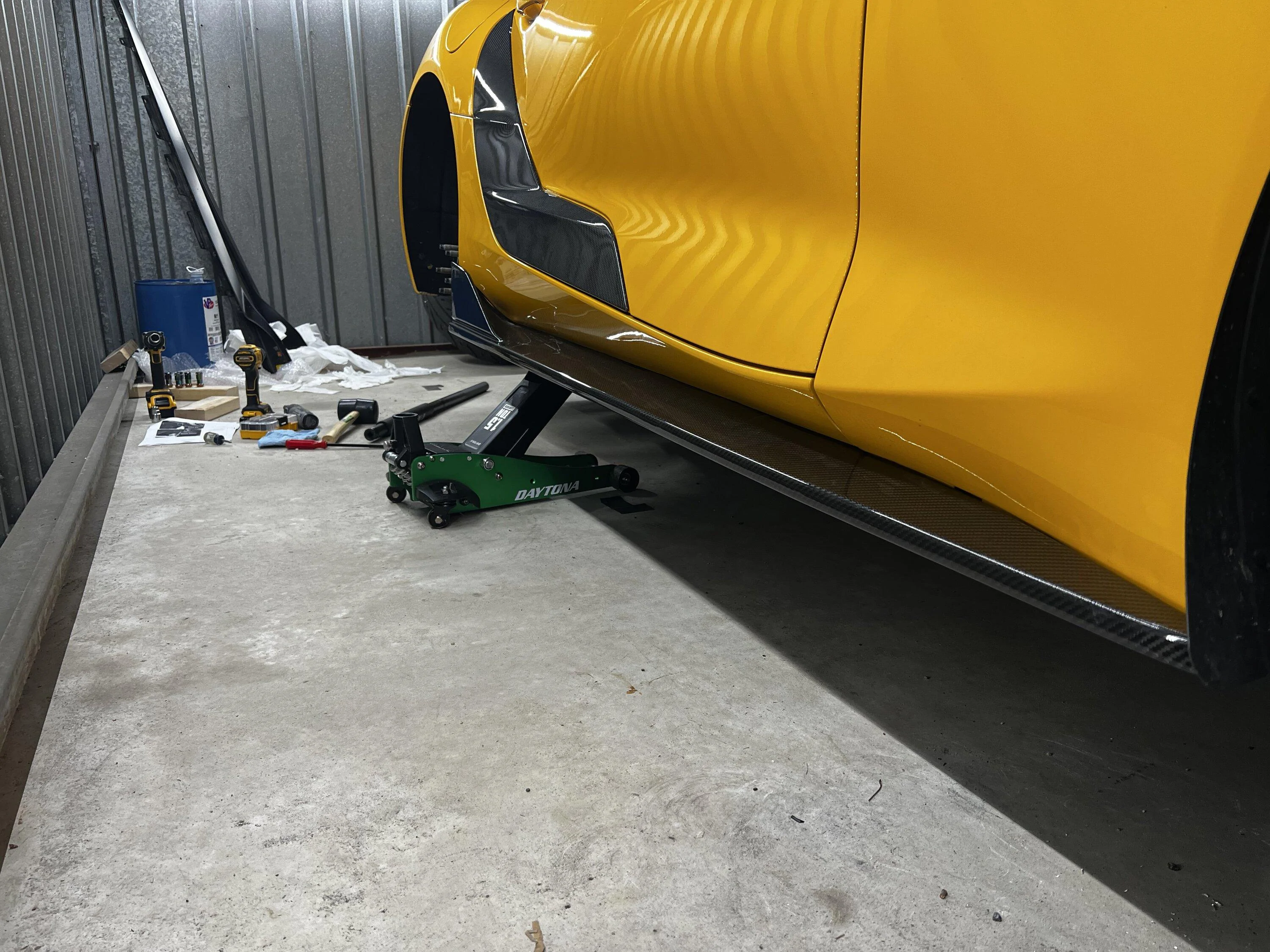

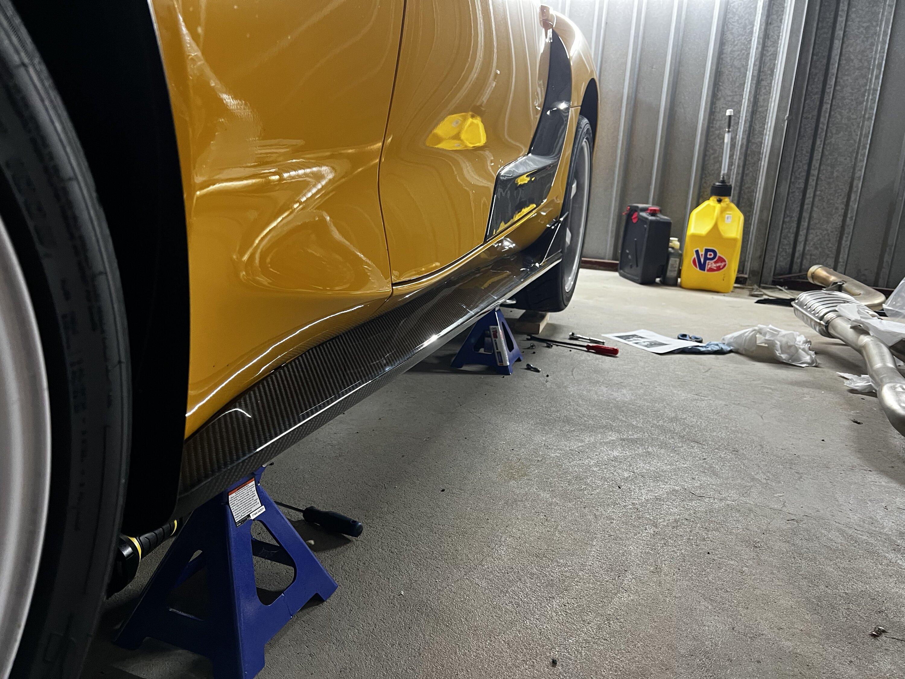

Has anyone recently received their APR side extensions and had significant fitment issues? The rear clips dont capture anything and the first foot of the front looks like the mold is completely off. Did not even bother trying to install the passenger side.
I reached out to APR about it but im curious if anyone else has ran into the same problem recently.

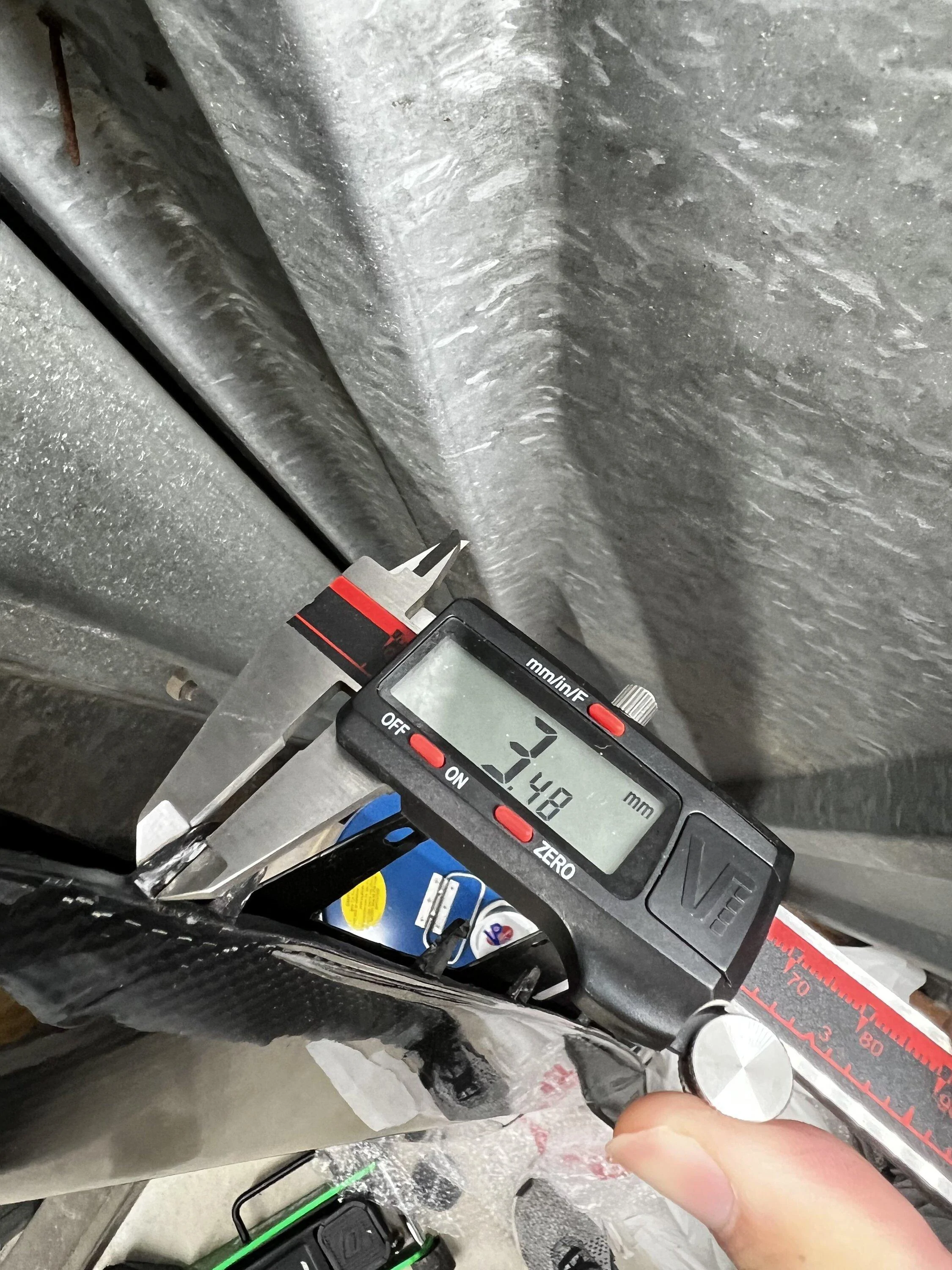

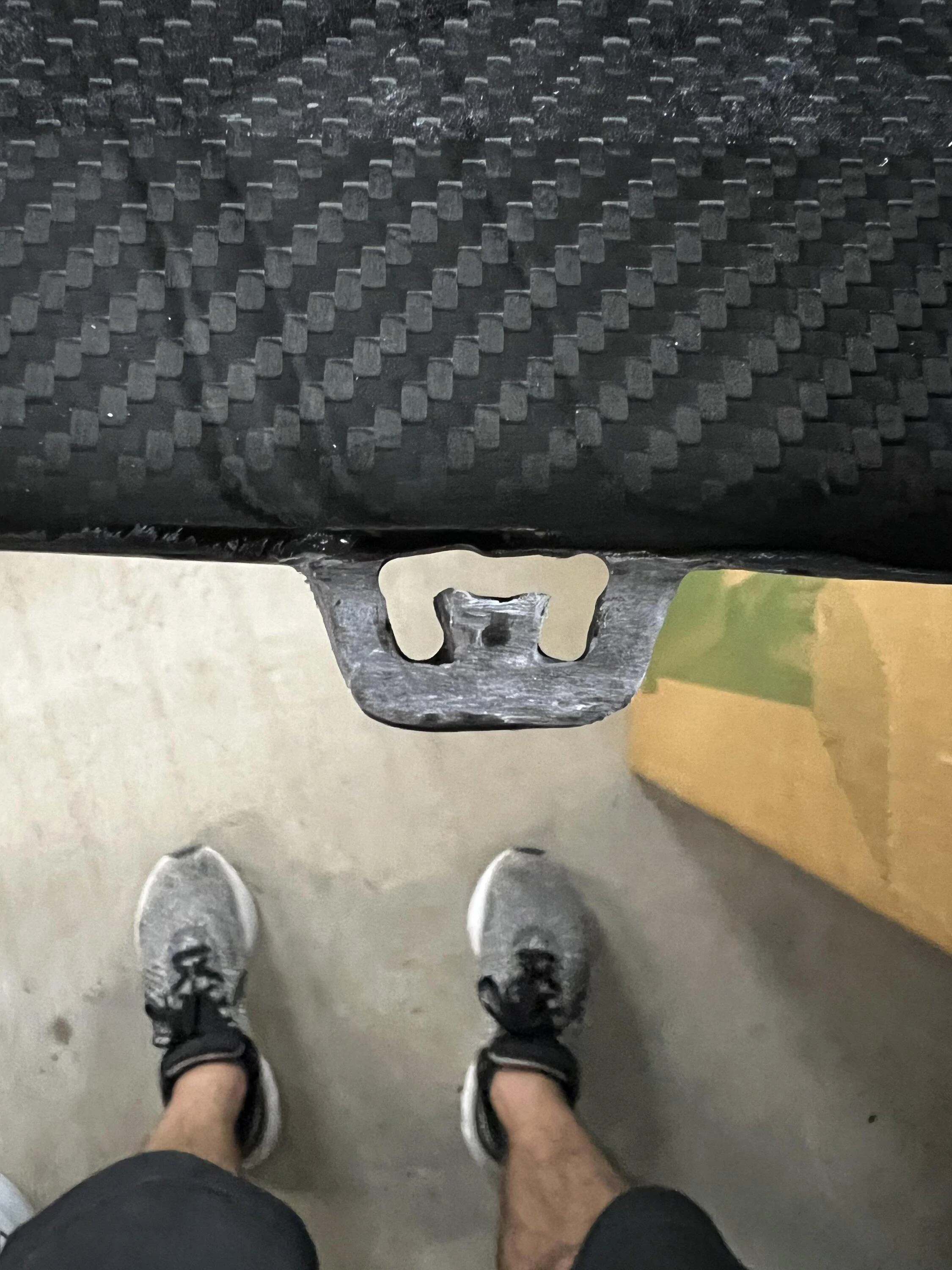

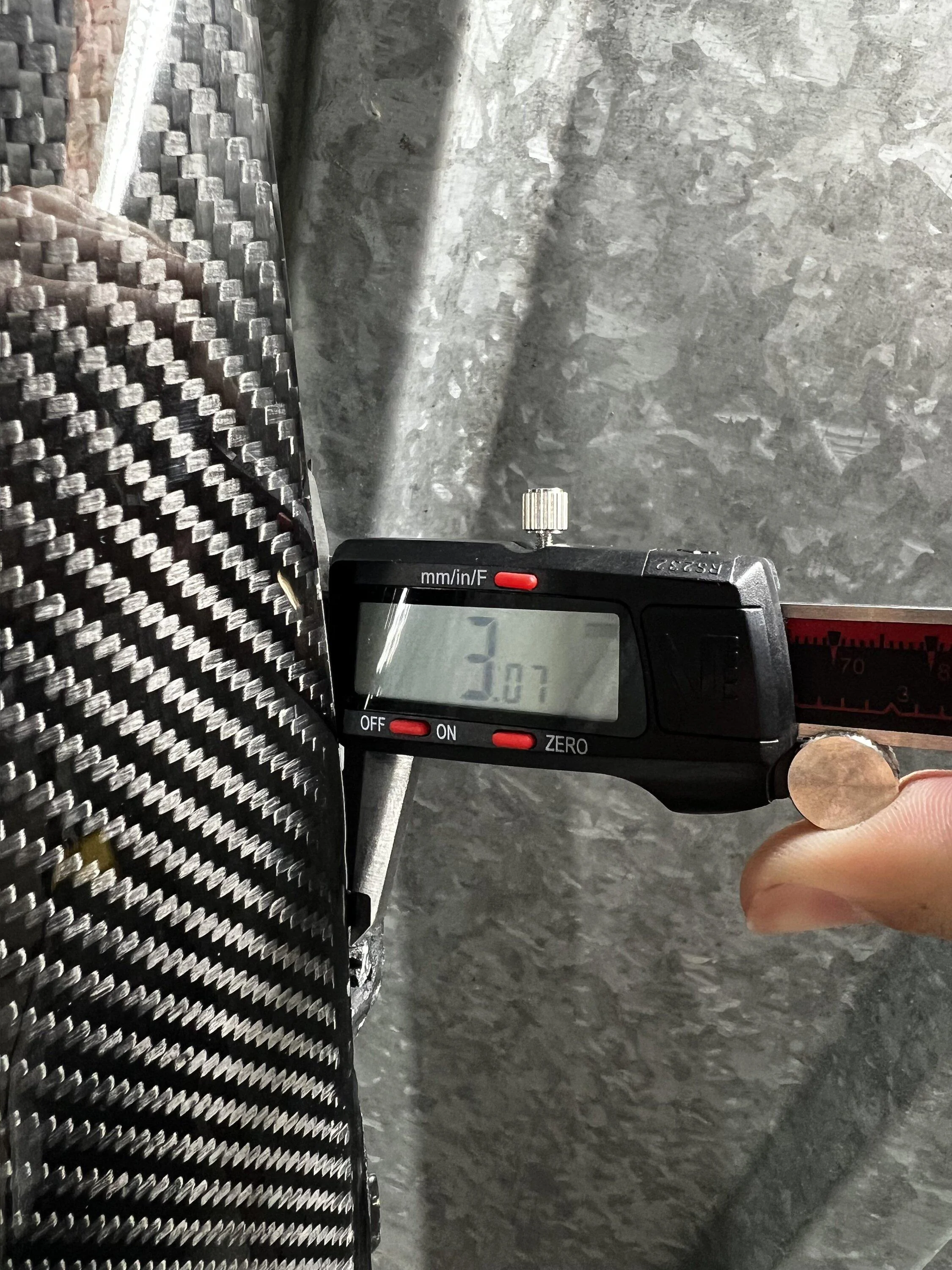

Alright just got back from dealing with this. I got it to fit, the drivers side is nearly perfect the passenger side is a bit off but its on the car. Im still fairly annoyed that an almost 2k part required any modifications whatsoever to fit but I will speak with APR about that tomorrow.

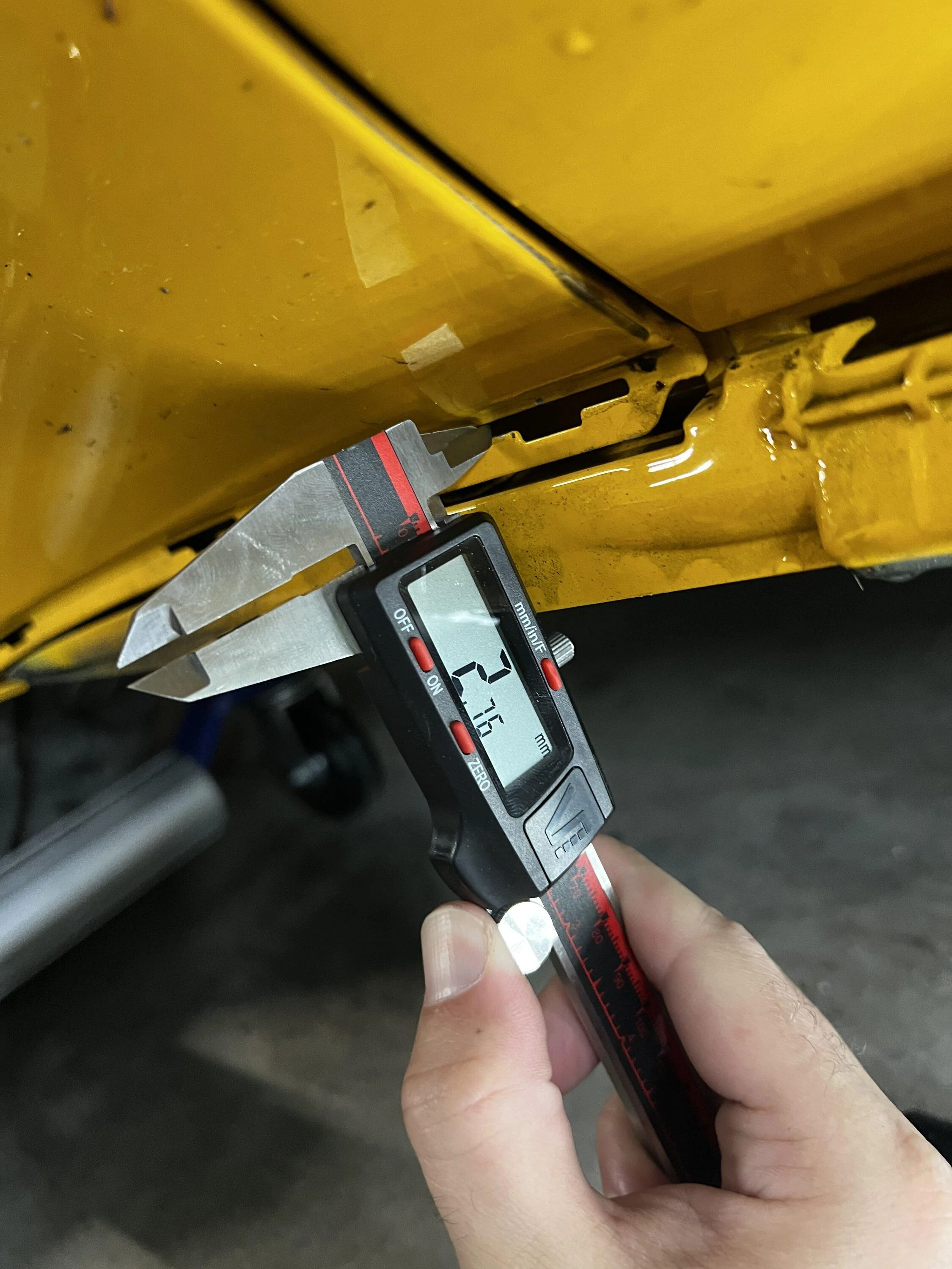

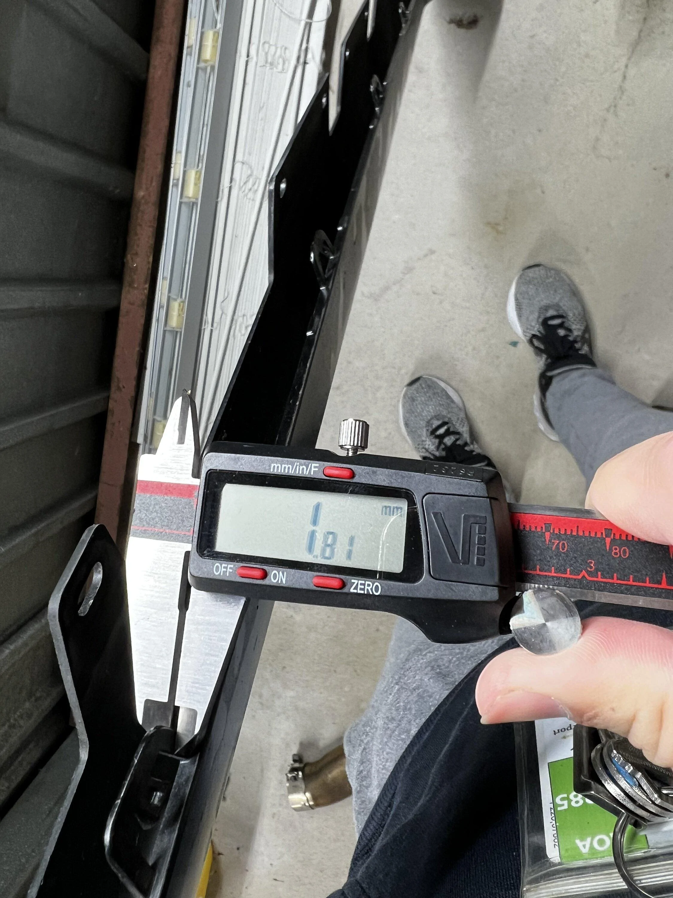

The deal is the tabs are way to thick and not shaped correctly in some cases. The fender behind the front wheel is the most sensitive because it has the tightest tolerance, this is the front most tab on the skirt. The other tabs go into plastic slots that seem to be much larger then the front tab that is metal. The tab needs to be smaller then 2.70mm in order to properly fit. The key is not to take too much off though because then it wont have a nice tight fit. Go slow and measure as you go.
Front slot tolerance:

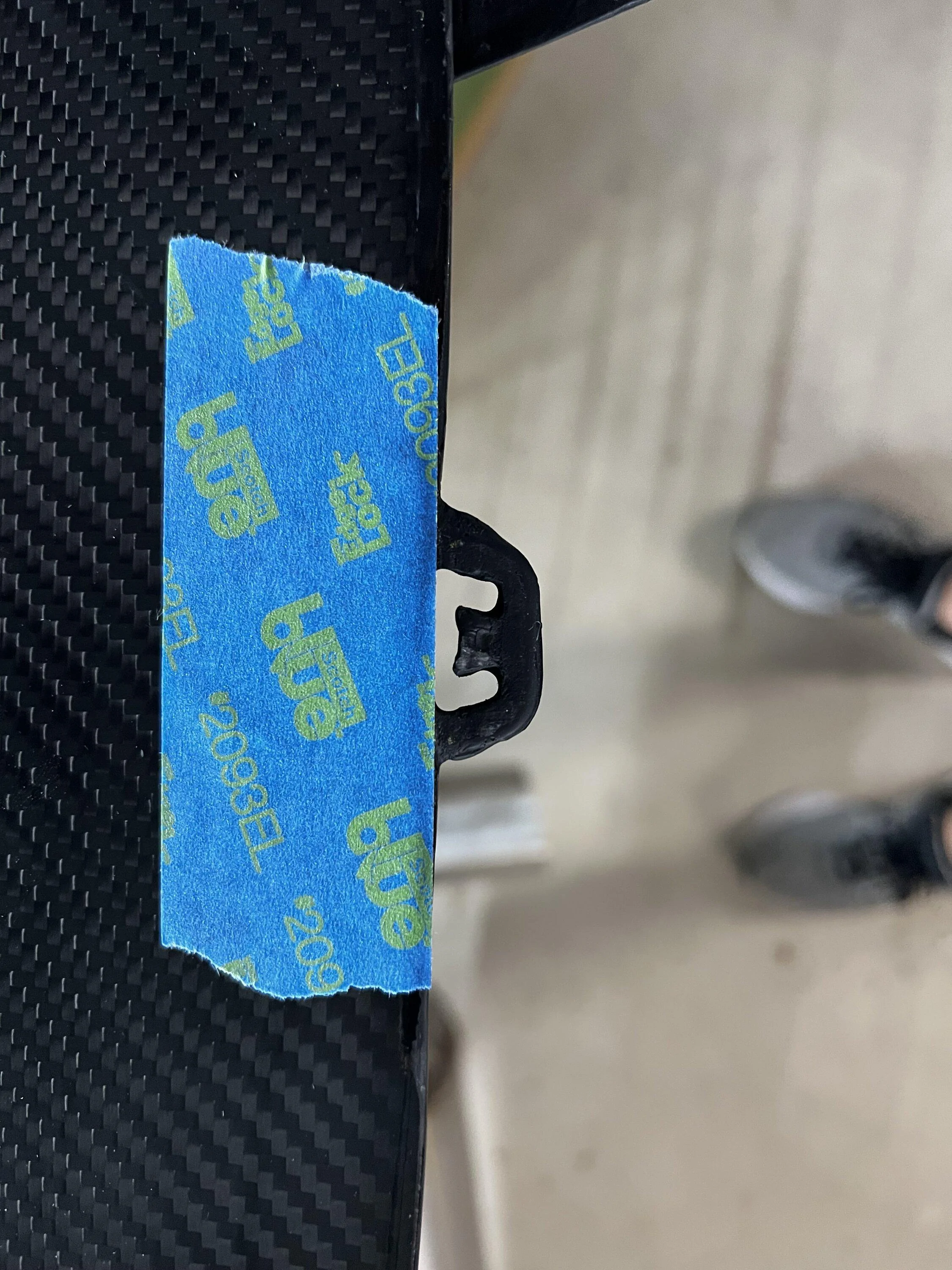

Example of a shitty tab:
Same tab fixed:
I ended up sanding down every single tab and making sure it was around 2.5 - 2.6mm. This seemed to get me the best results. The OEM tabs are in between 1.7 and 2.2 mm. Once this is all done and the tabs are engaged put in all of the push pins before doing anything with a drill.

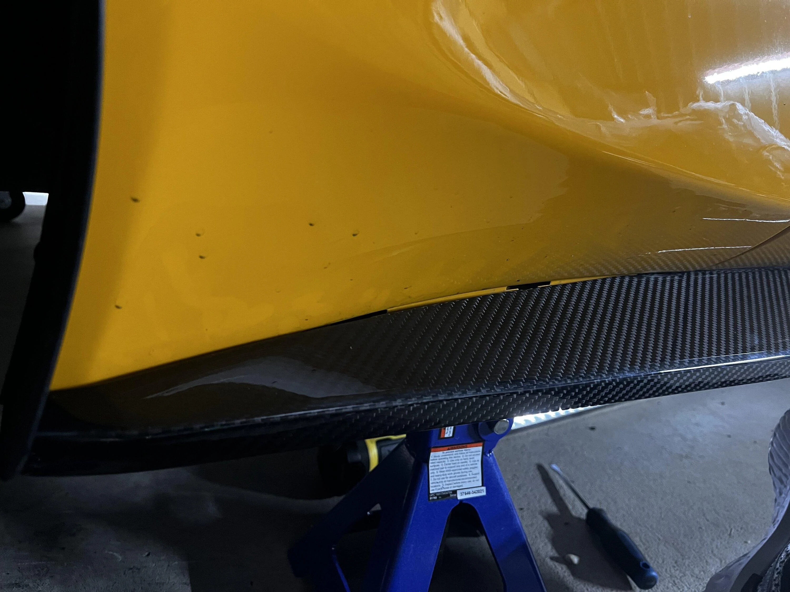

Finally when you go to drill the front two holes make sure you use one hand to push the skirt in to the car and up. The two screws will really help close that front gap but you need to make sure that front tab is 100% flush before you do any drilling. The rear is a bit less of a problem, but if you have issues getting the tab to engage, pull the rear tire off, remove the screw for the liner and hold the plastic behind where the tab goes, it will eventually pop into place.

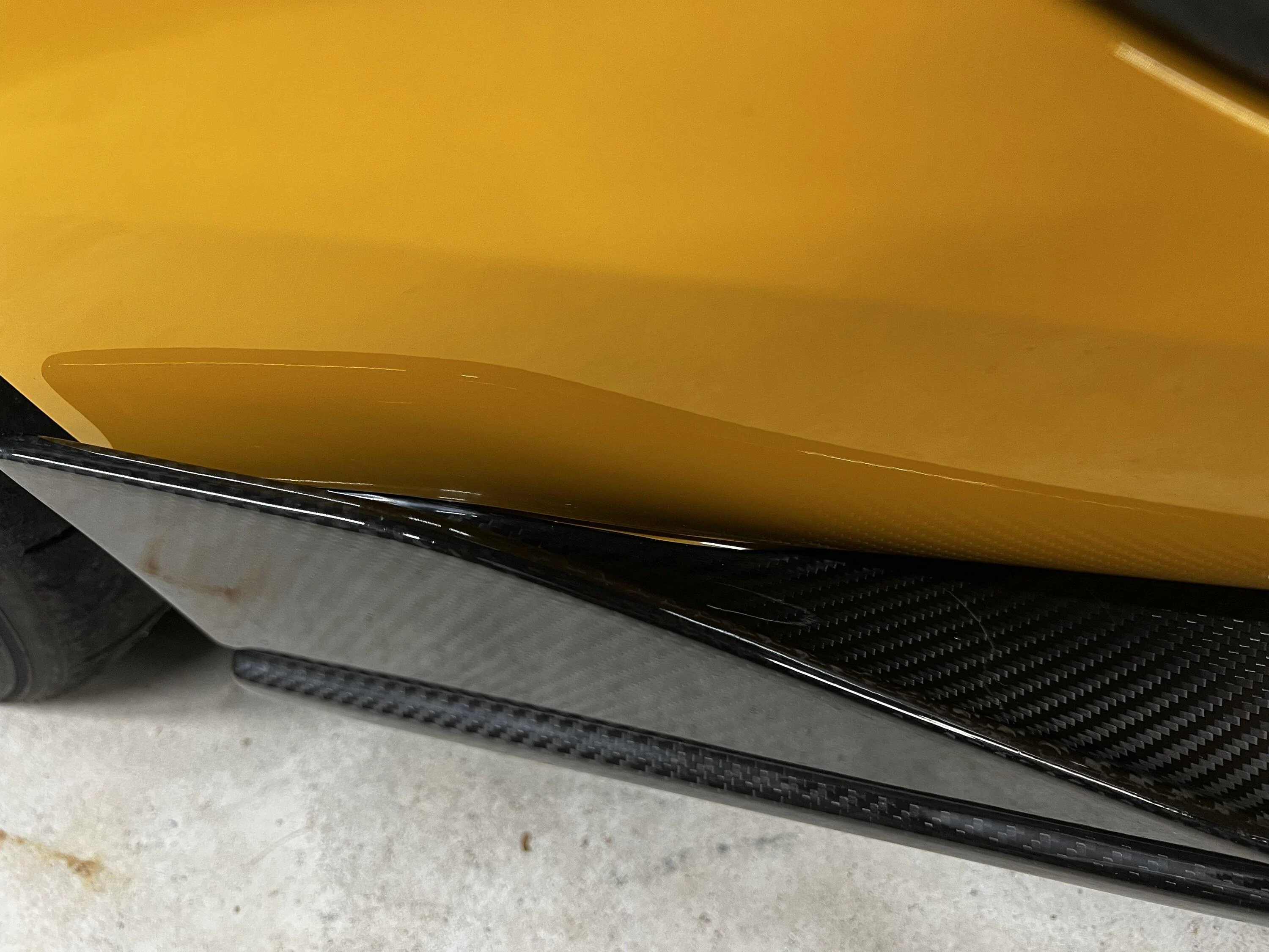

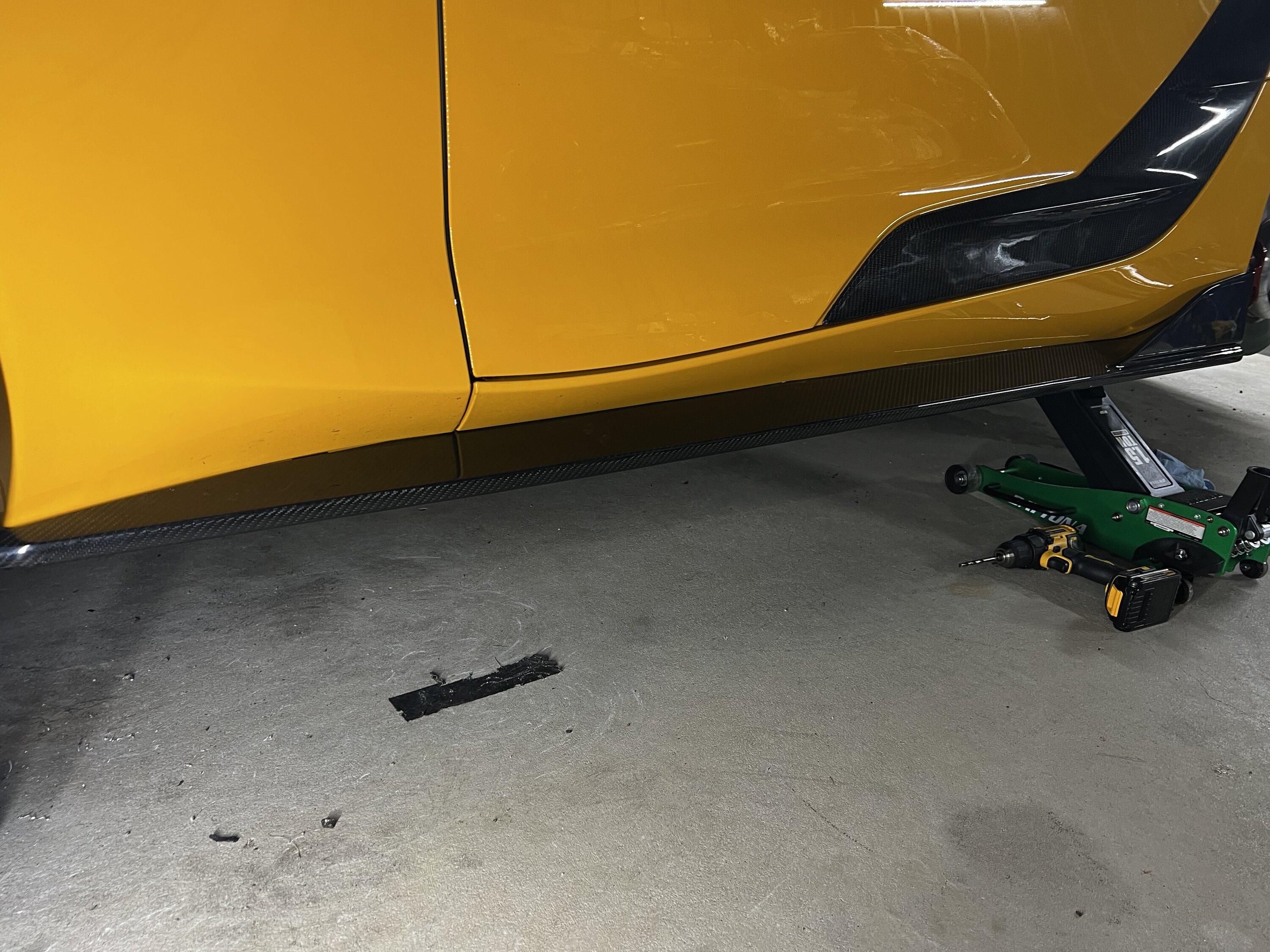

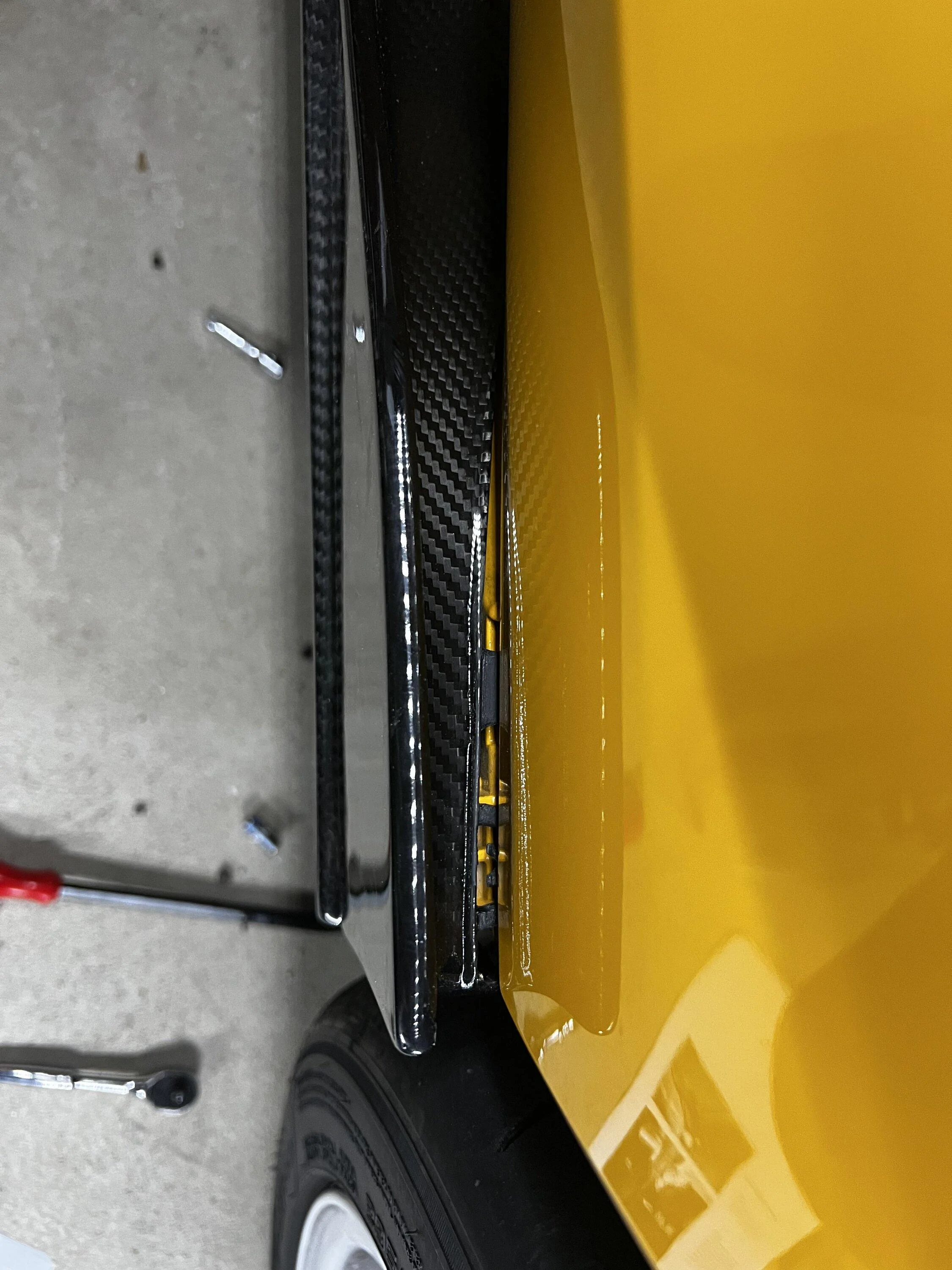

Only issue I currently have is the passenger side rear seems to be slightly off(you can see a bit of yellow where it should be CF:
Otherwise everything looks good now:
Hope this helps you and anyone else that runs into this issue. If you have any other questions let me know.

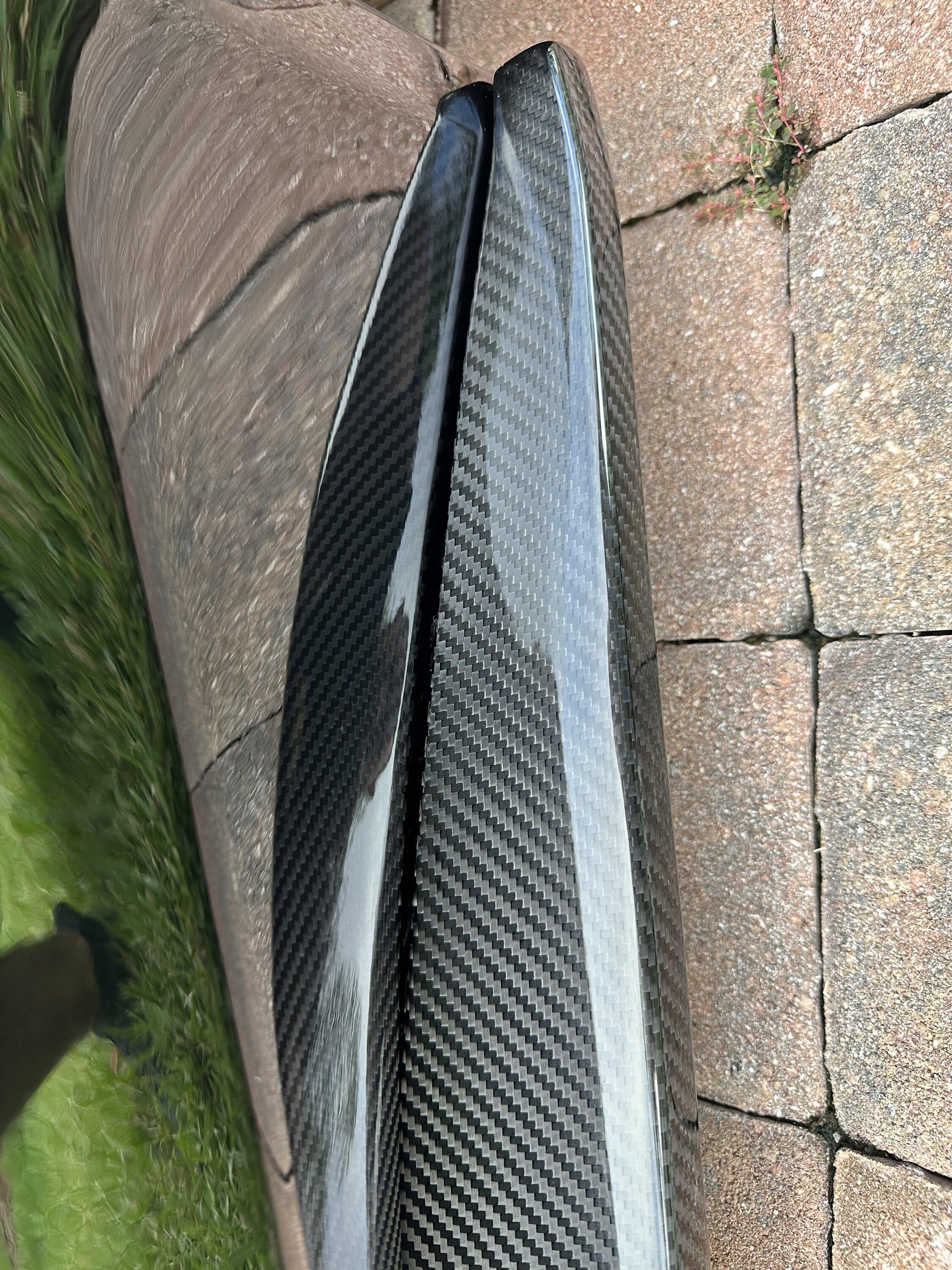

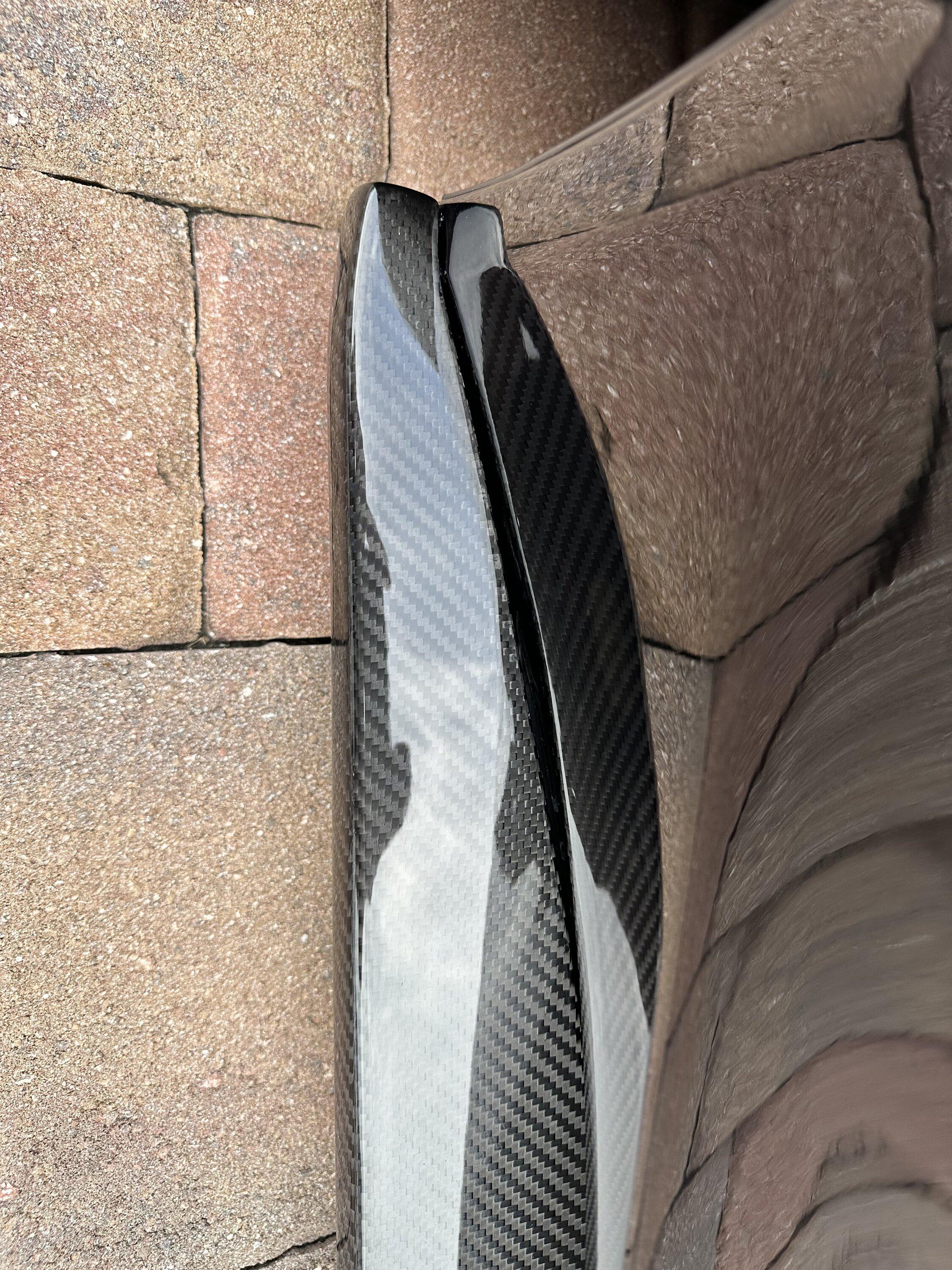

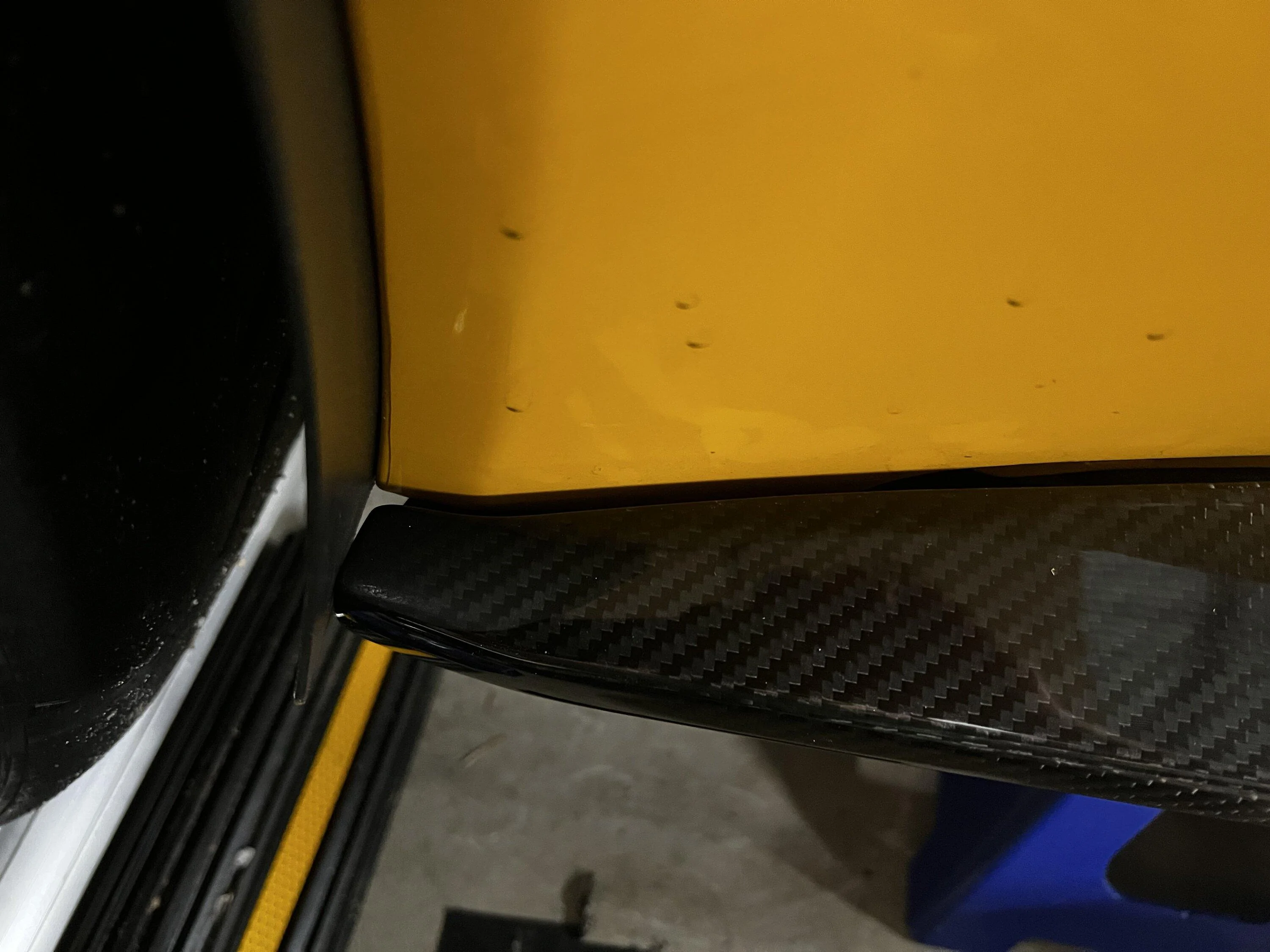

So I spent a bunch of time thinning out the tabs to your suggested specs. It fits better, but still not perfectly. Sent the info to APR to see what they want to do.
Bummer thats a bit more off then mine are. Mine arent perfect either but thats a much larger gap for sure. Is that with the screws installed up front? If the screws are not installed it will droop down and that gap opens up a bit more. You can try and pull the skirt up a bit towards the sky and see if it closes up.
Yep, i muscled them as hard as i could and drilled/screwed the front, or they were even more off.
Bummer. Something obviously happened to the mold or the person working the mold. Hopefully they get it sorted.
