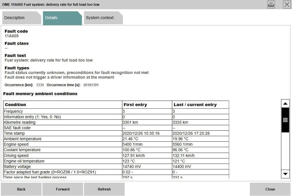

Hi folks,
Posted this for friends about their track day experience. I've heard this happened on 4 BM3 stg1/2 , 1 MGFlasher tuned and a local tuned B58 Supra so far.
The symptom is the acceleration becomes slow. The straight line can't over 170kph on the track. It seems been started during several conrnering. The gas tank was lower than 40%. Is this the defect of the Supra gas pump?
There's another code from another case. Not very sure if this is the same issue as fault code 11A605.

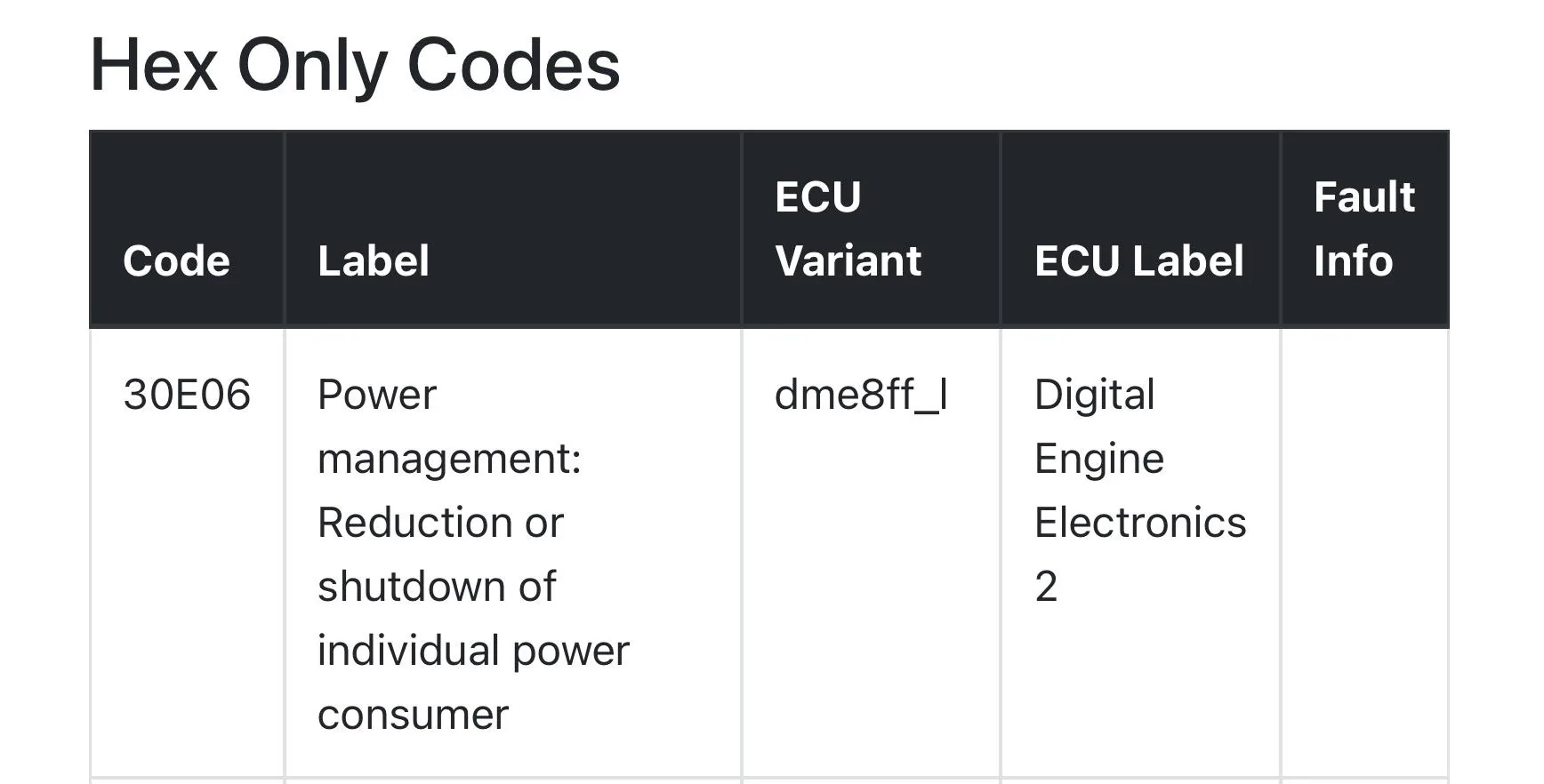

I am getting 030E06 as well and I have no idea what it means
This is a fault code, not a CEL code. You probably get this from randomly scanning codes, without a need to. It's indicative of a battery problem.
Actually makes sense I have this code as well as 2 battery codes lol
