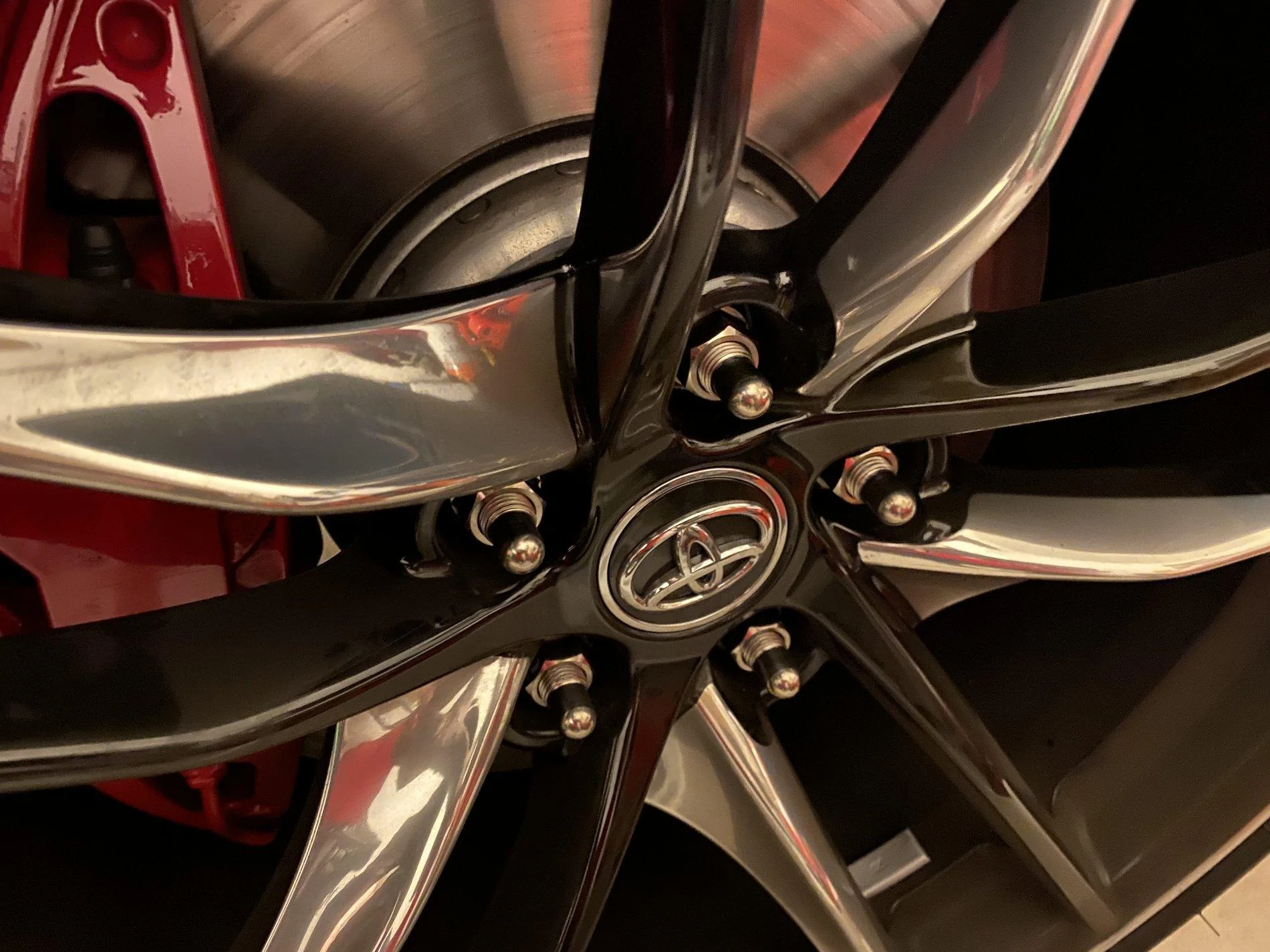

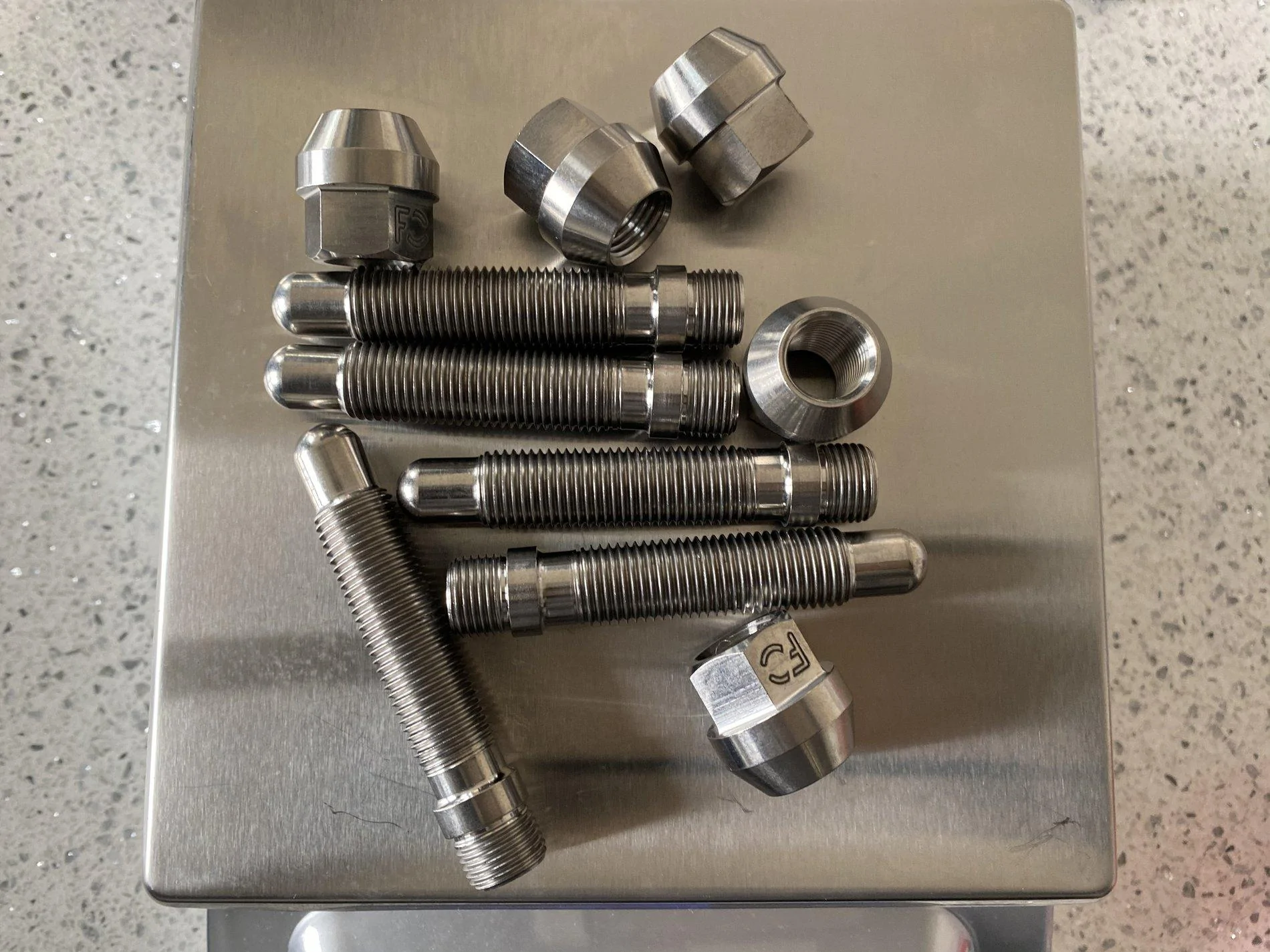

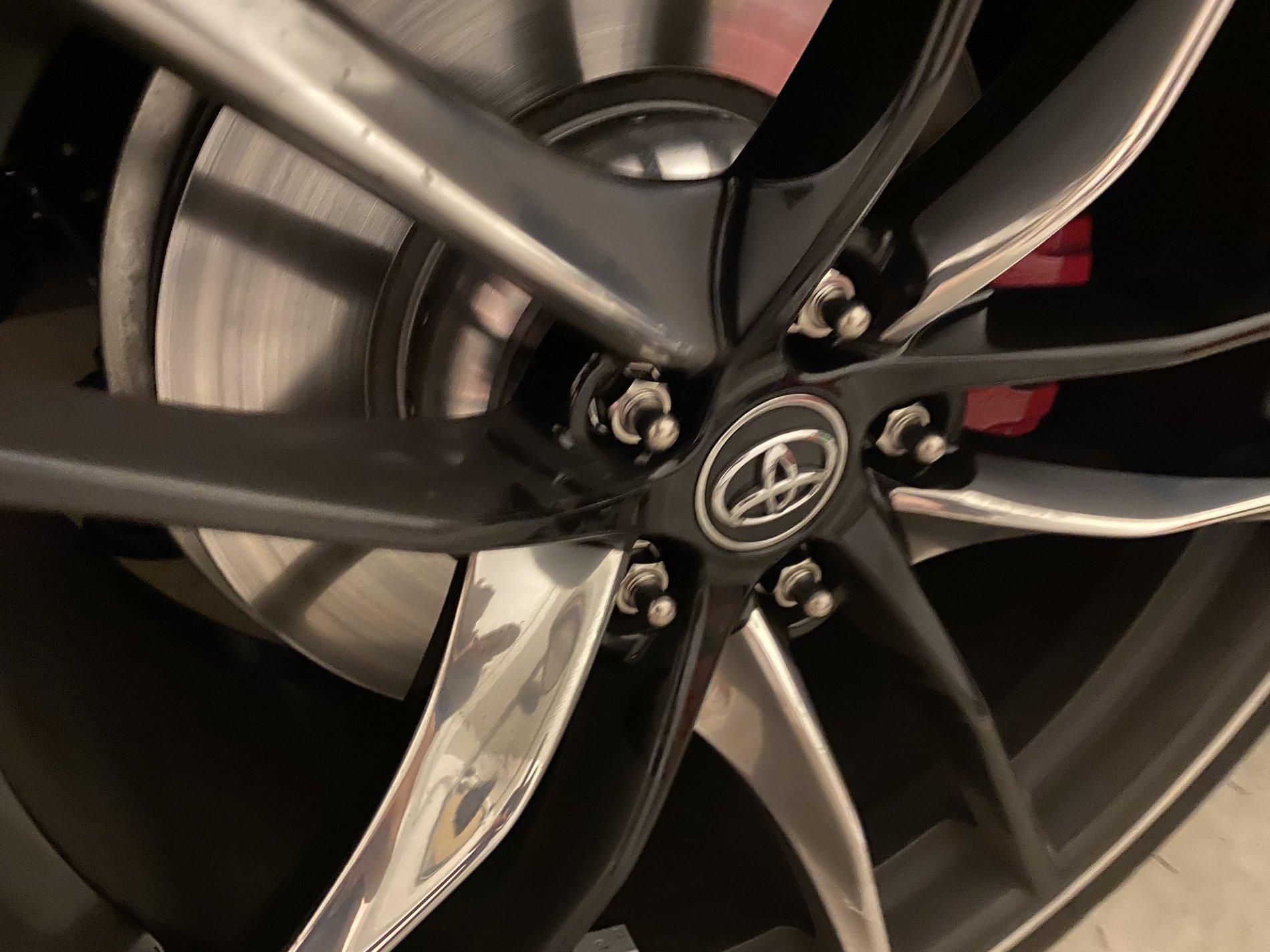

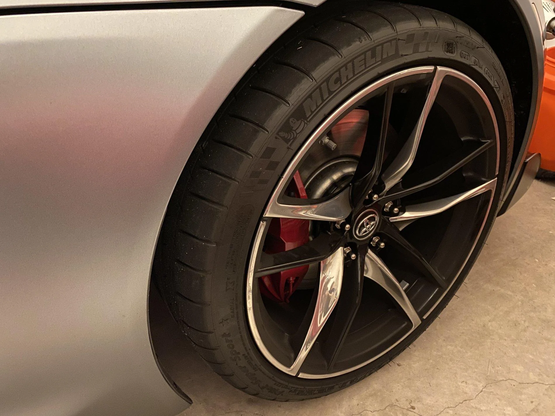

Wanted to fill out the wheel well a bit more so opted for their spacers and titanium stud kit.
I went 12mm up front and 15mm in the rear.

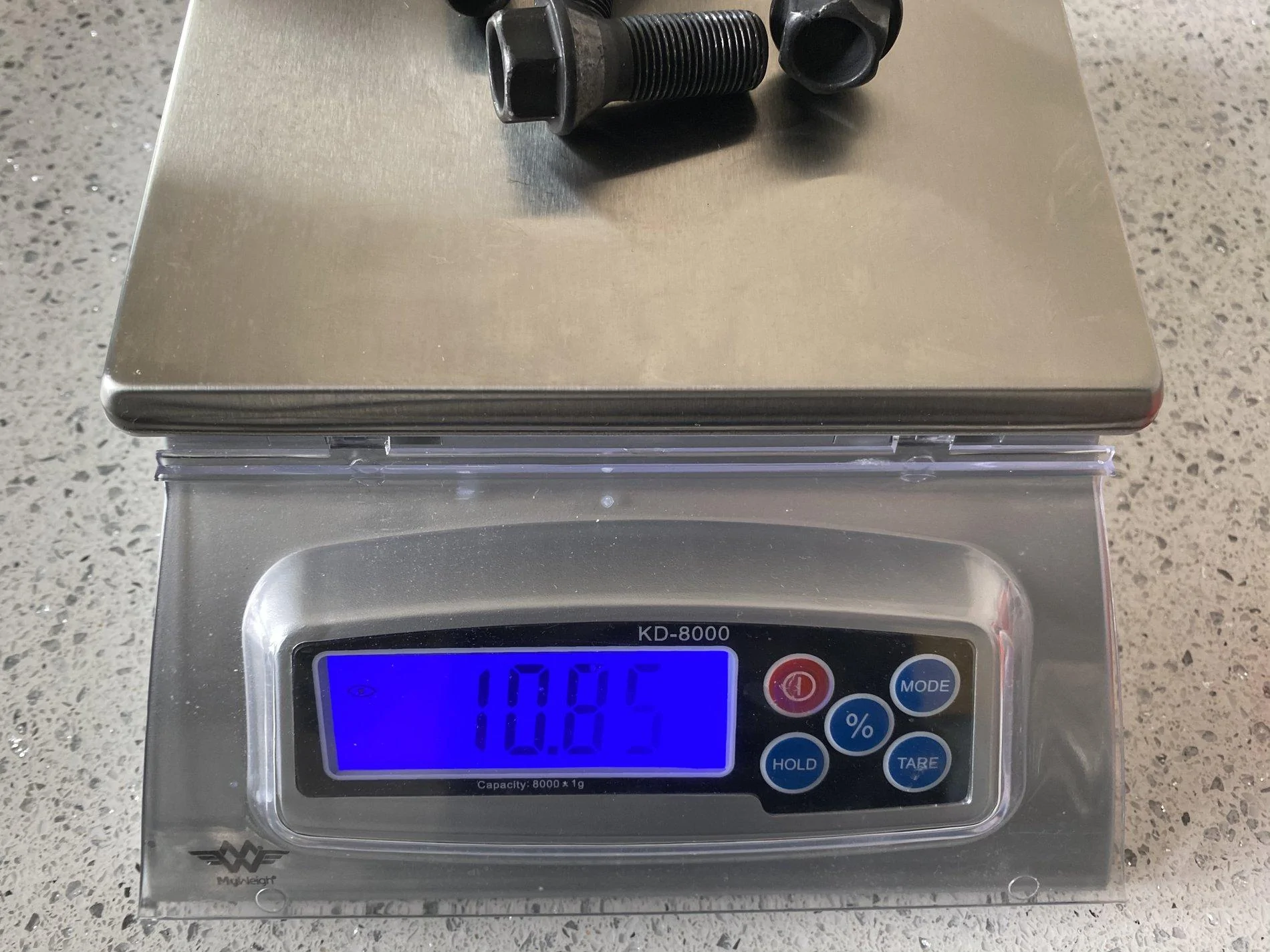

Stock bolt weight - 10.85 ounces

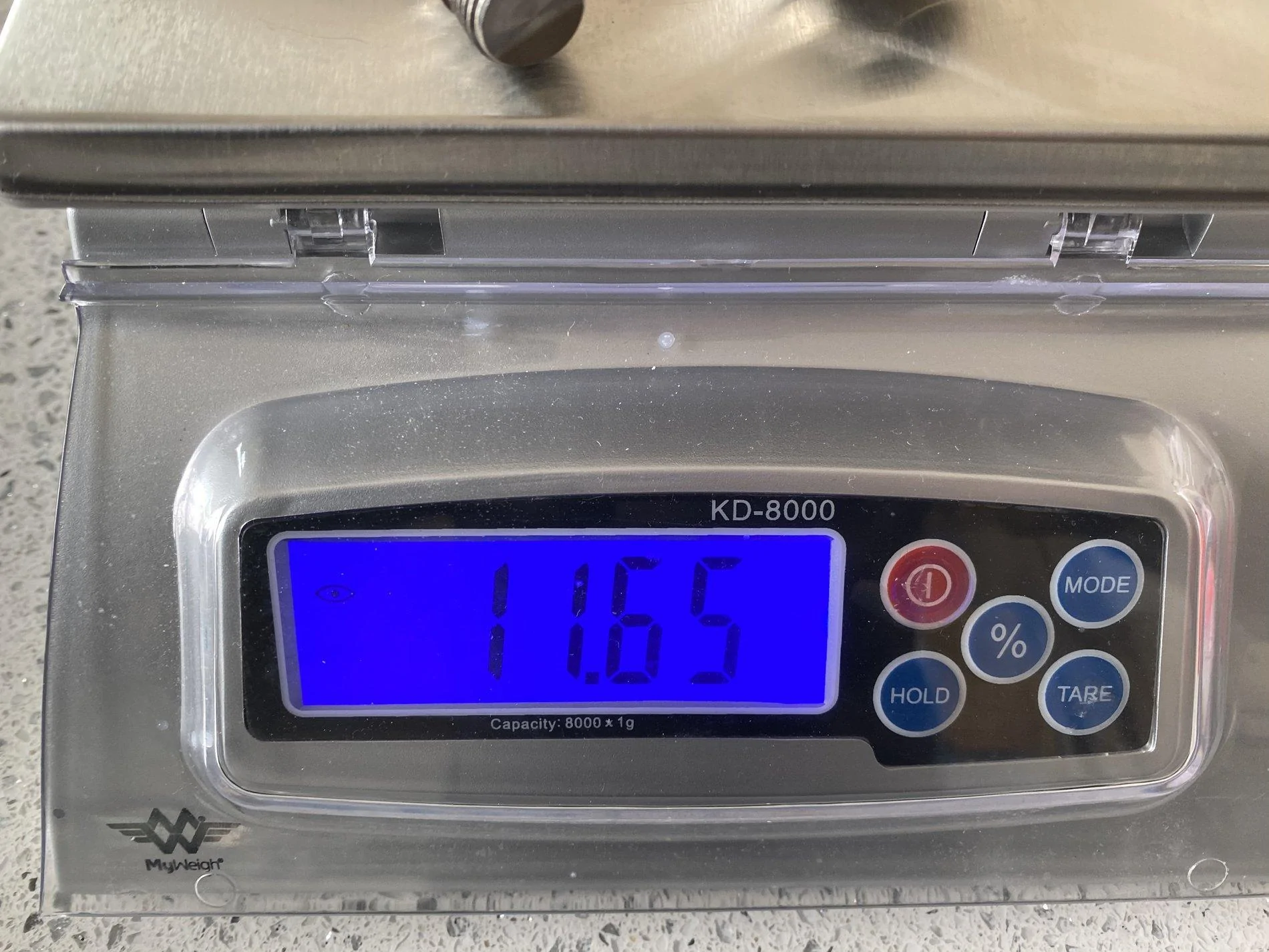

Titanium studs and bolts - 11.65 ounces

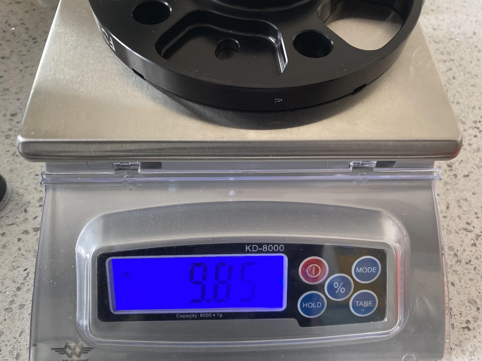

12 mm spacer - 9.85 ounces

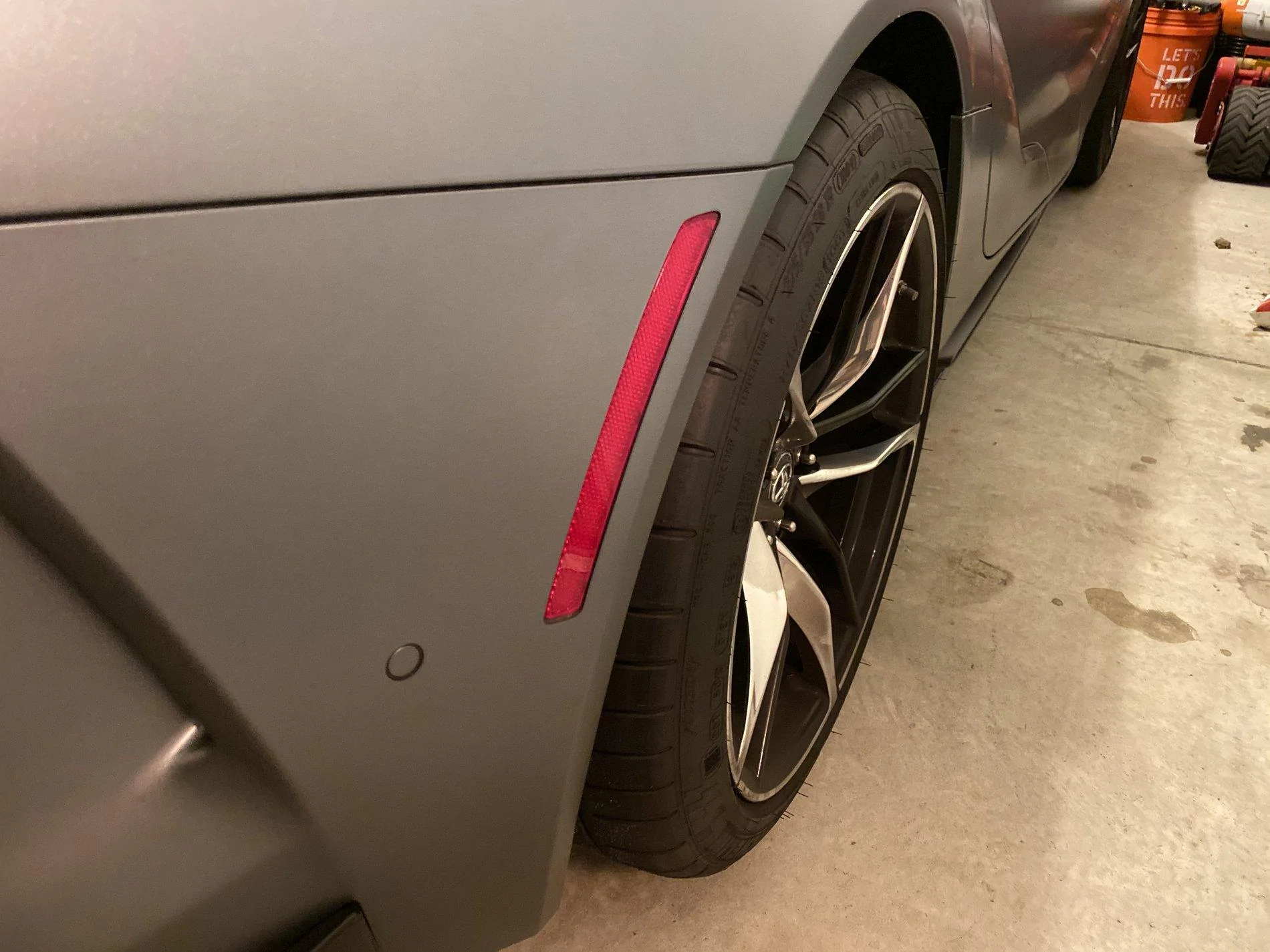

And the final look after installation.
tadda
