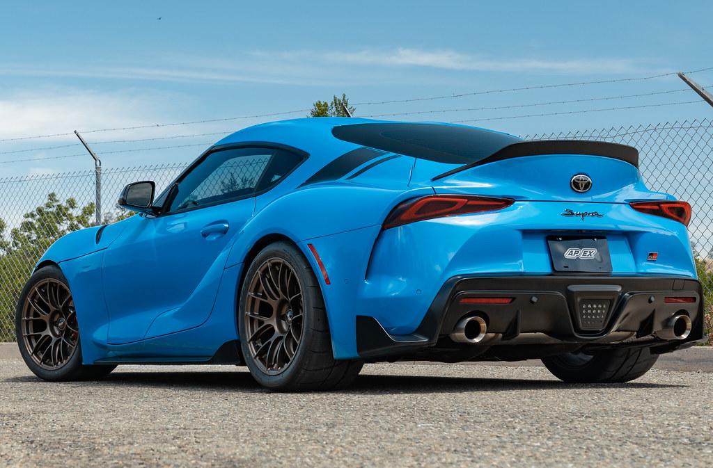

18x11 ET40 square EC-7RS with 315/30-18 Nitto NT01 tires, mods required.
When we initially began our relationship with the TAPG (Toyota Automotive Proving Ground) endurance racing team, we knew test-fitting and fitment validation would be key parts of our relationship. Their feedback about clearances on the MKV Supra platform proved to be invaluable for validating suspension clearances with both stock suspension and aftermarket coilovers for our 18x10.5 ET38 forged EC-7Rs. Once we knew we would also be bringing a staggered 18” fitment to market with our SM-10s, we asked TAPG to test our 18x11 ET40 rear wheel on the front of their A90 endurance race car to get an idea of what the clearances looked like.
We knew that if these wheels fit up front, they would be ideal for the driver looking to run an extremely aggressive square fitment. The benefits of a square 18” setup on the Supra platform are impossible to ignore. Having identical front and rear fitments would allow our customers to rotate their wheels and tires between the front and rear axles. This promotes even tire wear and ensures that grip levels remain consistent over the life of the tires. The huge increase in front tire tread width also leads to a significant increase in front-end grip aiding turn-in, especially when combined with a track alignment.
After testing this square fitment on TAPG’s track car running MCS suspension, as well as on other customer cars, we’ve added this fitment to our fitment guides and have begun recommending it to customers who are willing to heavily modify their Supra. Our condensed recommendations can be found on our GR Supra fitment guide with tire sizing and availability notes. Read on for a more in-depth look at the modifications required and test fitments conducted with these wheels.

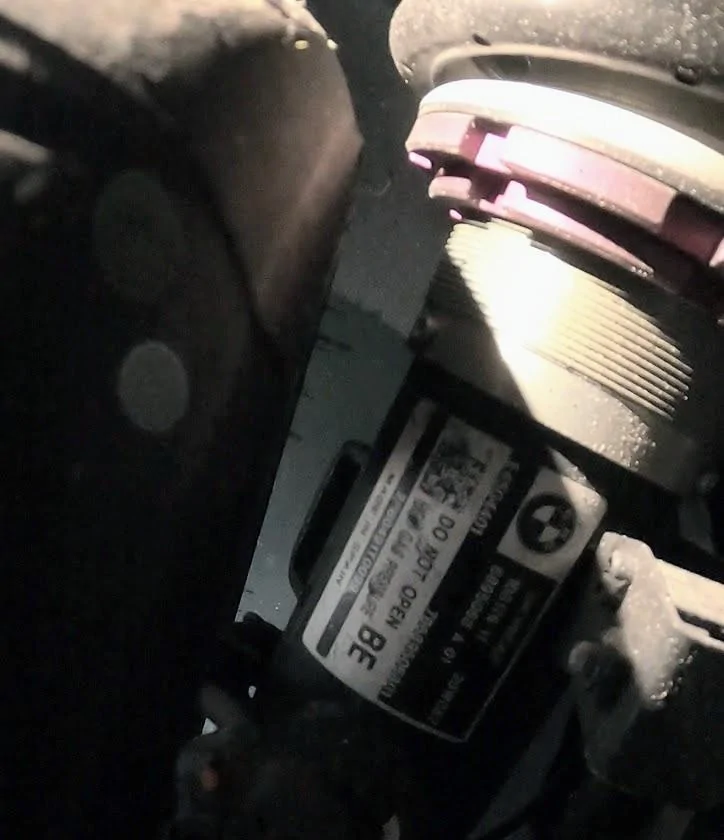

Mods Required:
Aftermarket Suspension: Coilovers & select HAS kits with excellent inner clearance are a must. The higher offset required by these wheels means that the front OE suspension configuration simply will not have enough inner clearance because of the OE spring perch and rubber isolator design. For an in-depth look at how the OE front suspension can limit inner clearance, check out our 18x10 ET30 wheel notes.
Motorsport-oriented coilovers are preferred, with the most beneficial setups being those that reduce overall front stack height to move the lower perch upwards, out of the path of the tire.

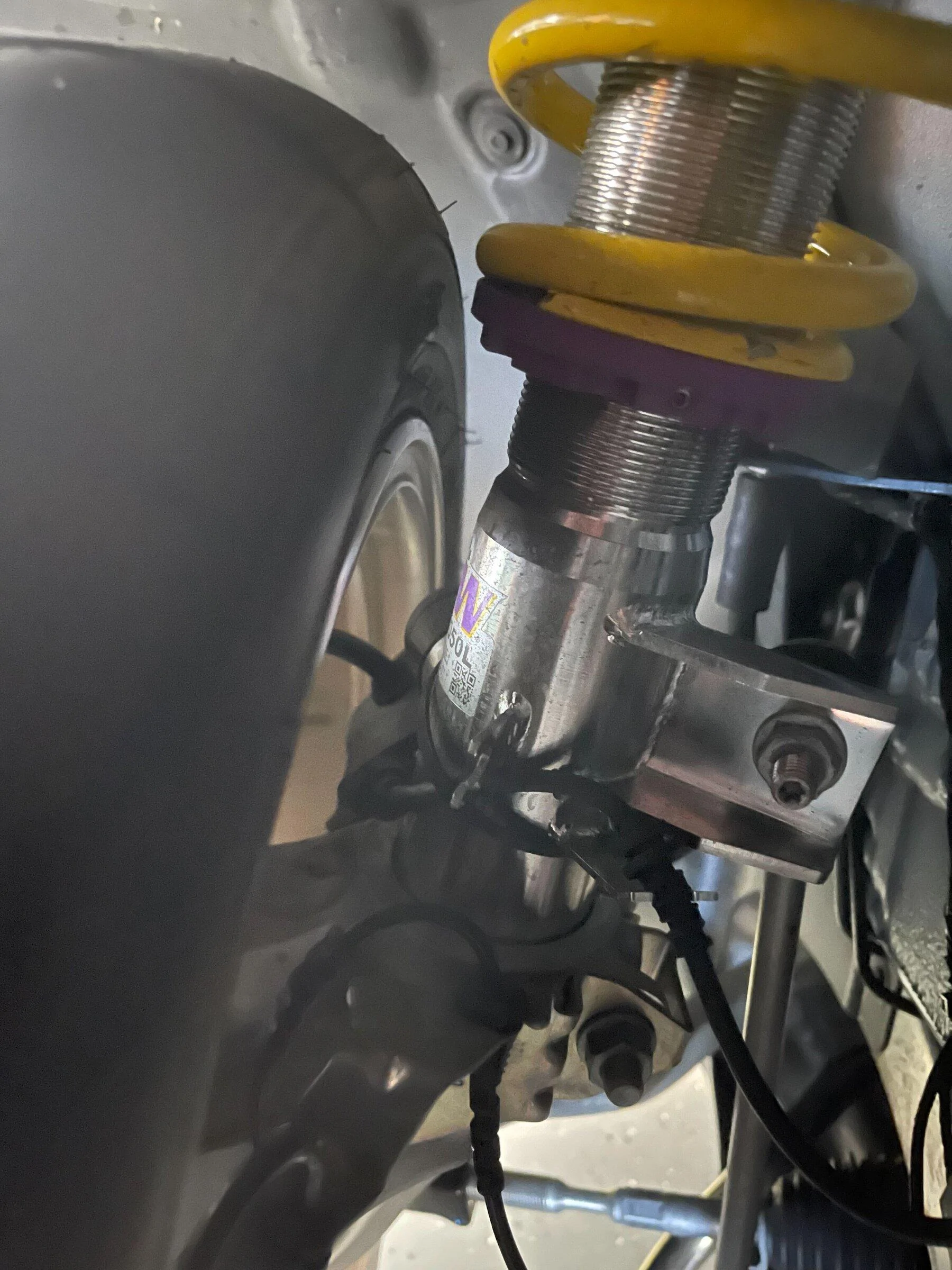

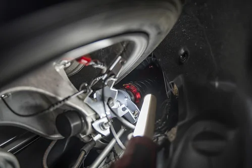

We’ve tested this setup with the HKS Height Adjustable Sleeve kit and it does fit without rubbing with most tire setups. This is a more cost-effective alternative for customers who want to retain the OE dampers, but we have not tested the clearances of every HAS kit on the market
Pictured: 18x11 ET40 SM-10 inner clearances around front struts with Megan Racing coilovers & 295/35-18 Yokohama A052s

Additional Notes:

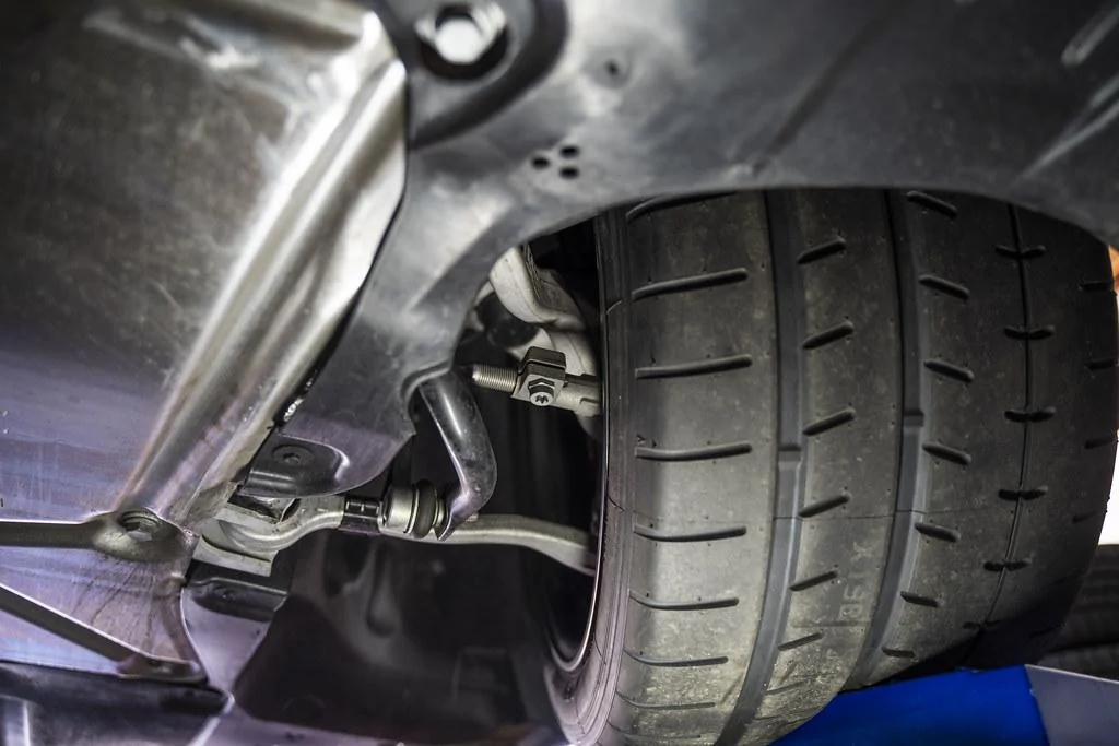

Full lock rubbing: This wheel and tire setup will likely rub at full lock in parking lots or midway through 3-point turns. The wider front wheels and tires will gently rub non-critical wheel well liners or in some cases aftermarket suspension arms. This will not typically be an issue at speed on the street or track where full lock is less common. An SPL front offset caster rod bushing can be used to reduce rubbing during high-steering lock turns.
Pictured: 18x11 ET40 SM-10 inner clearances with Megan Racing coilovers & 295/35-18 Yokohama A052s

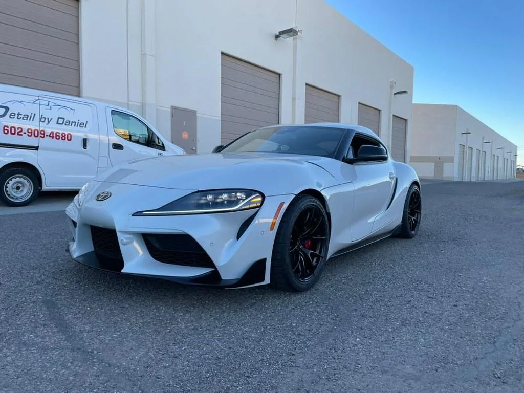

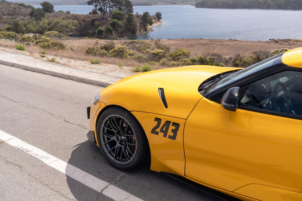

Nitro Yellow GR Supra
Wheels:
18x11 ET40 EC-7RS
Tires: 315/30-18 Nitto NT01 (100tw)
Brakes: Stock
Suspension:
HKS height-adjustable sleeve kit
SPL Lower Control Arms
SPL Caster Bushings
Camber: -3.4° front, -2.4° rear
Additional Notes: Minor rubbing noted at full lock

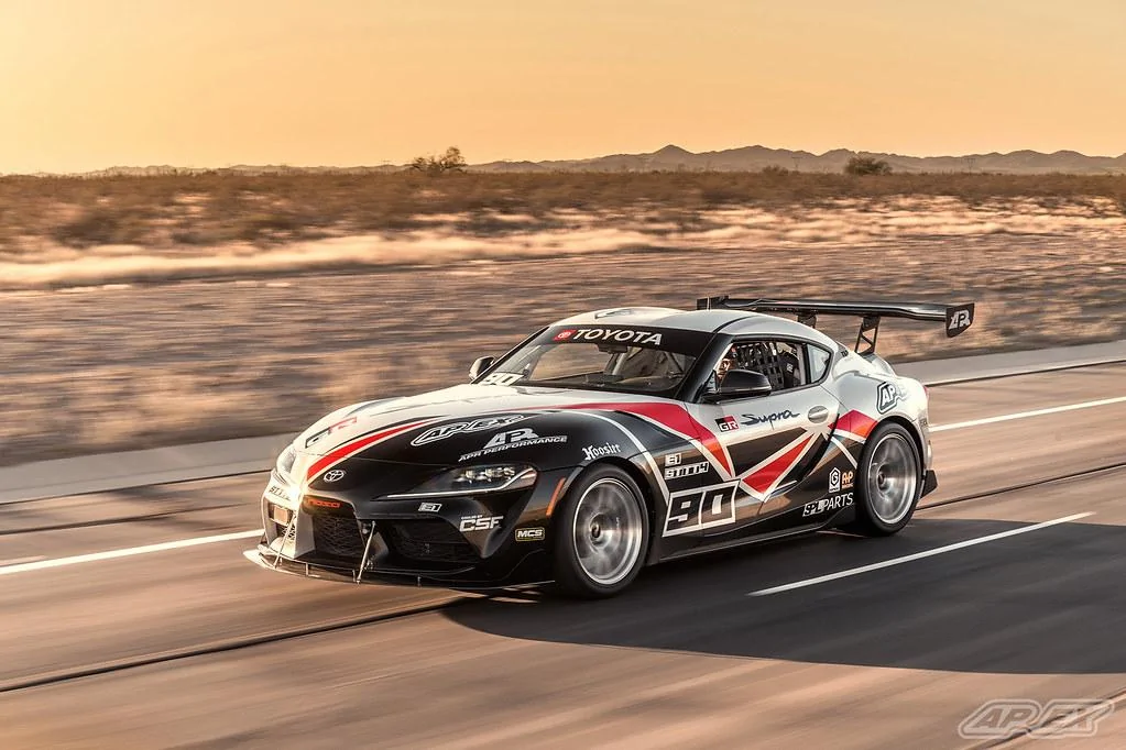

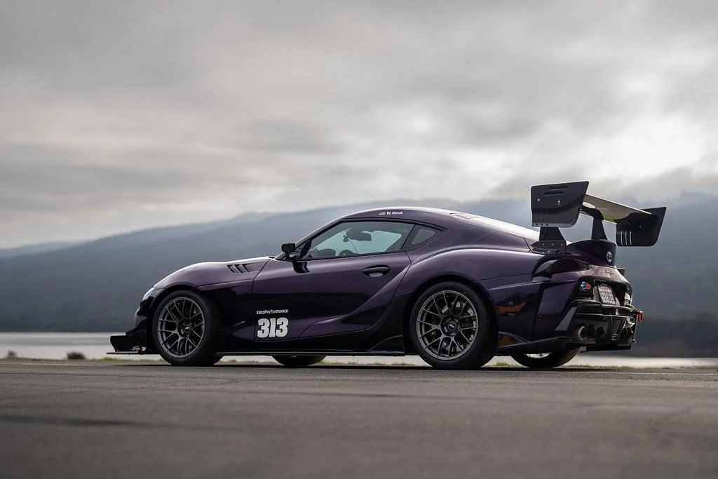

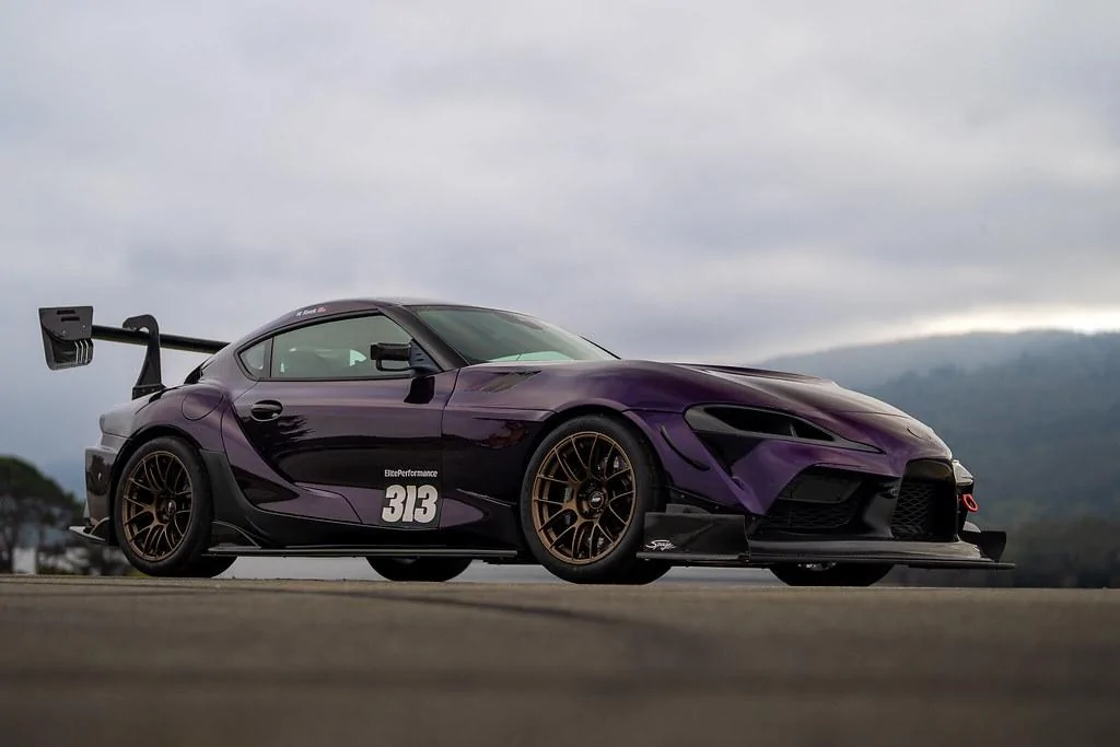

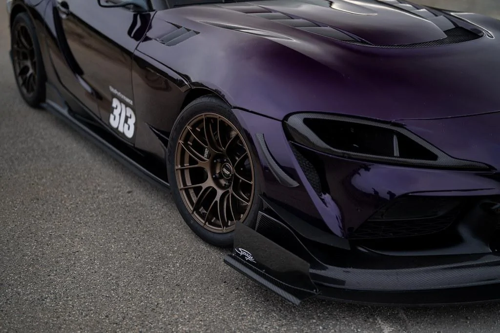

Will’s Purple Track Monster
Wheels:
18x11 ET40 EC-7RS
Brakes: AP 9660
Suspension:
Full SPL setup + MCS 3 way RR
Camber: Over -3° front
Additional Mods: Full build thread + mod list here

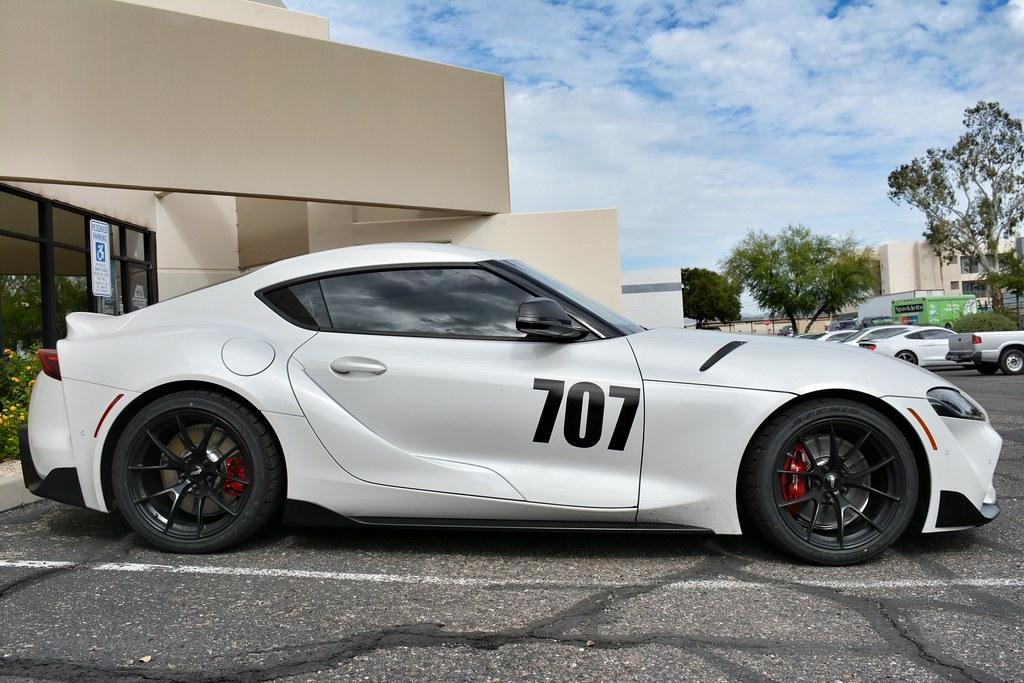

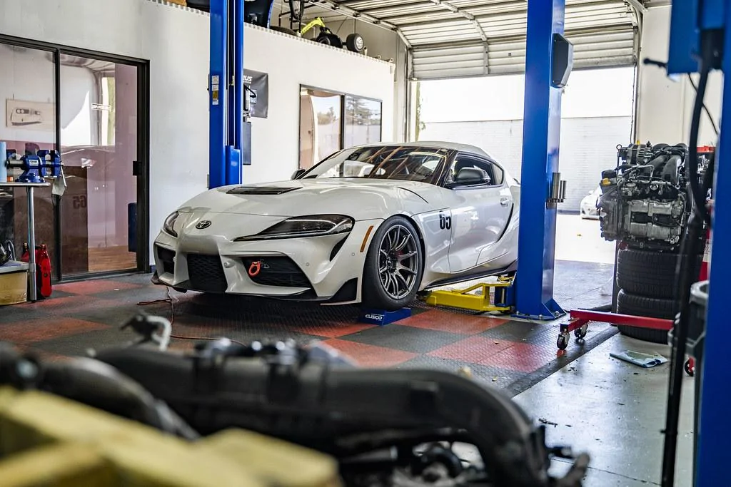

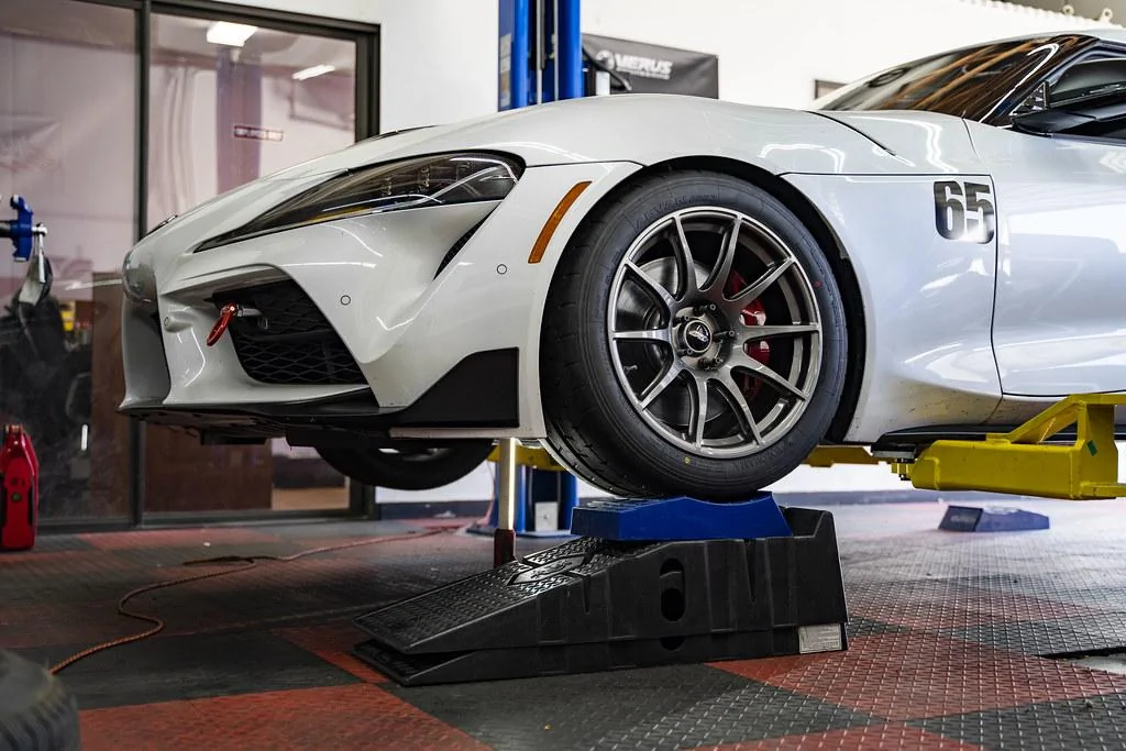

TheRacersLine White Track Car
Wheels:
18x11 ET40 Anthracite SM-10
Tires: 295/35-18 Yokohama A052
Brakes: Stock
Suspension: Megan Racing Coilovers & SPL parts
Camber: roughly -2.75° front
Additional Notes: Single wheel test fitment

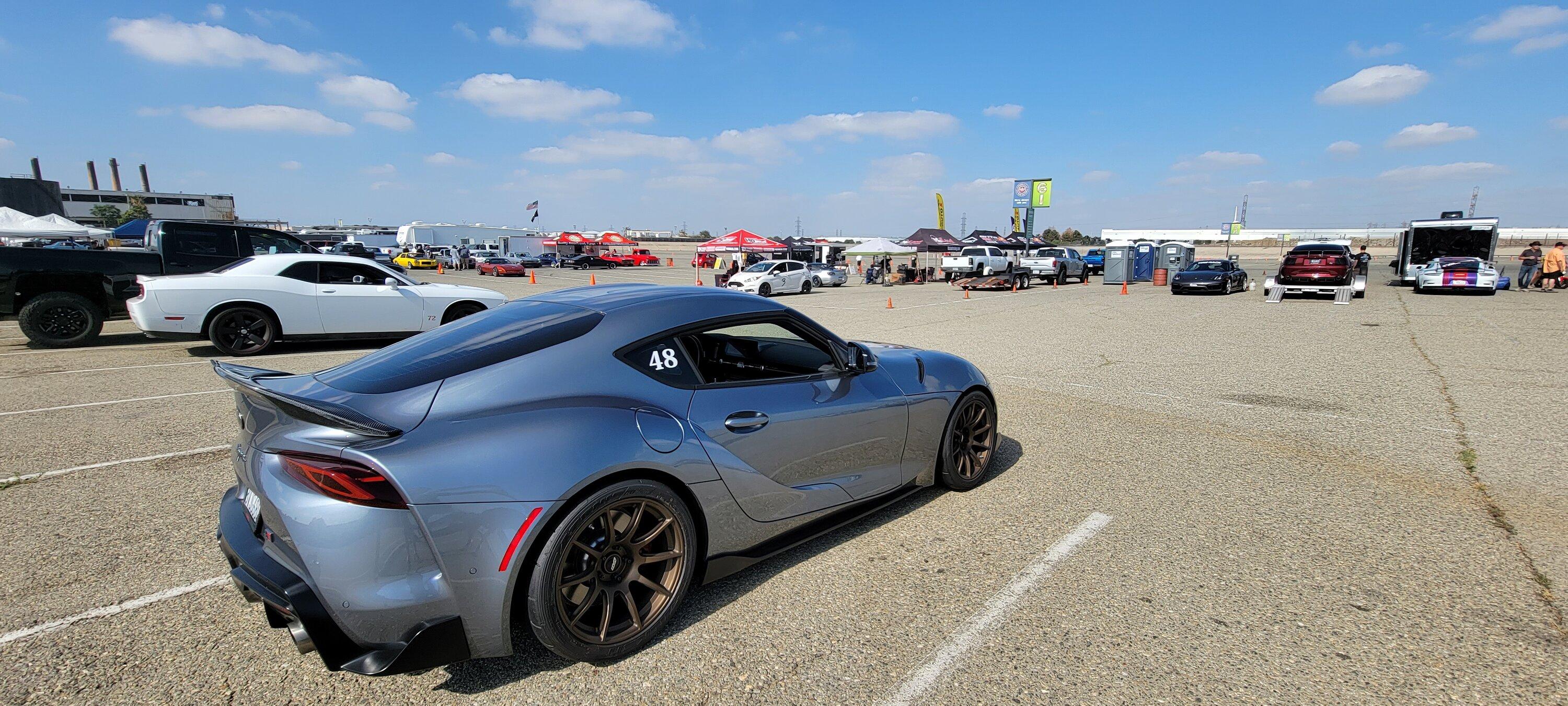

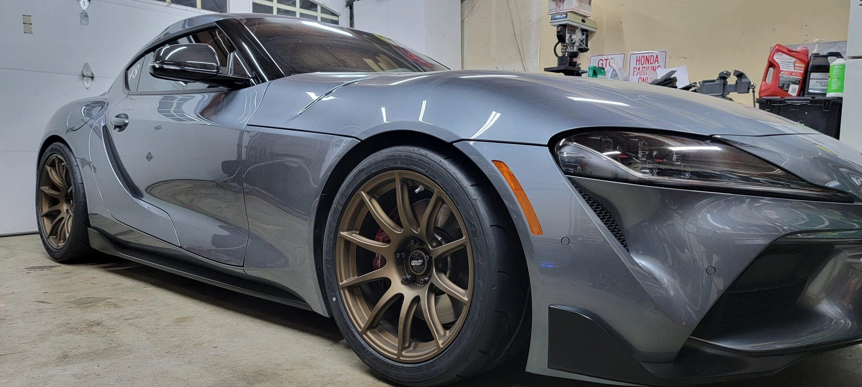

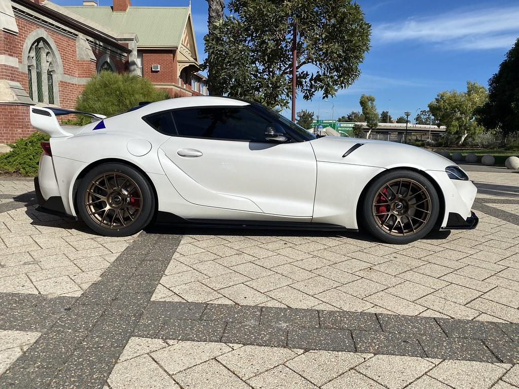

Brad's Blue A90
Wheels:
18x11 ET40 EC-7RS
Brakes: N/A
Suspension:
KW DDC
Camber: -3° front
Additional notes: Light scrubbing noted up front with 315 section tires under compression. Would recommend more camber or narrower tires if camber could not be altered.

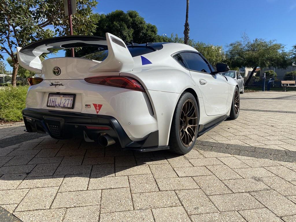

Luke’s A90 Track Setup
Wheels:
18x11 ET40 Satin Bronze EC-7RS
Brakes: Stock, Circo race pads
Suspension: M Factory coilovers & camber plates
Camber: -3.5° front, -2° rear
Additional Notes: Minor rubbing at full steering lock, Used to win a local time attack competition in Australia (Congrats Luke!)

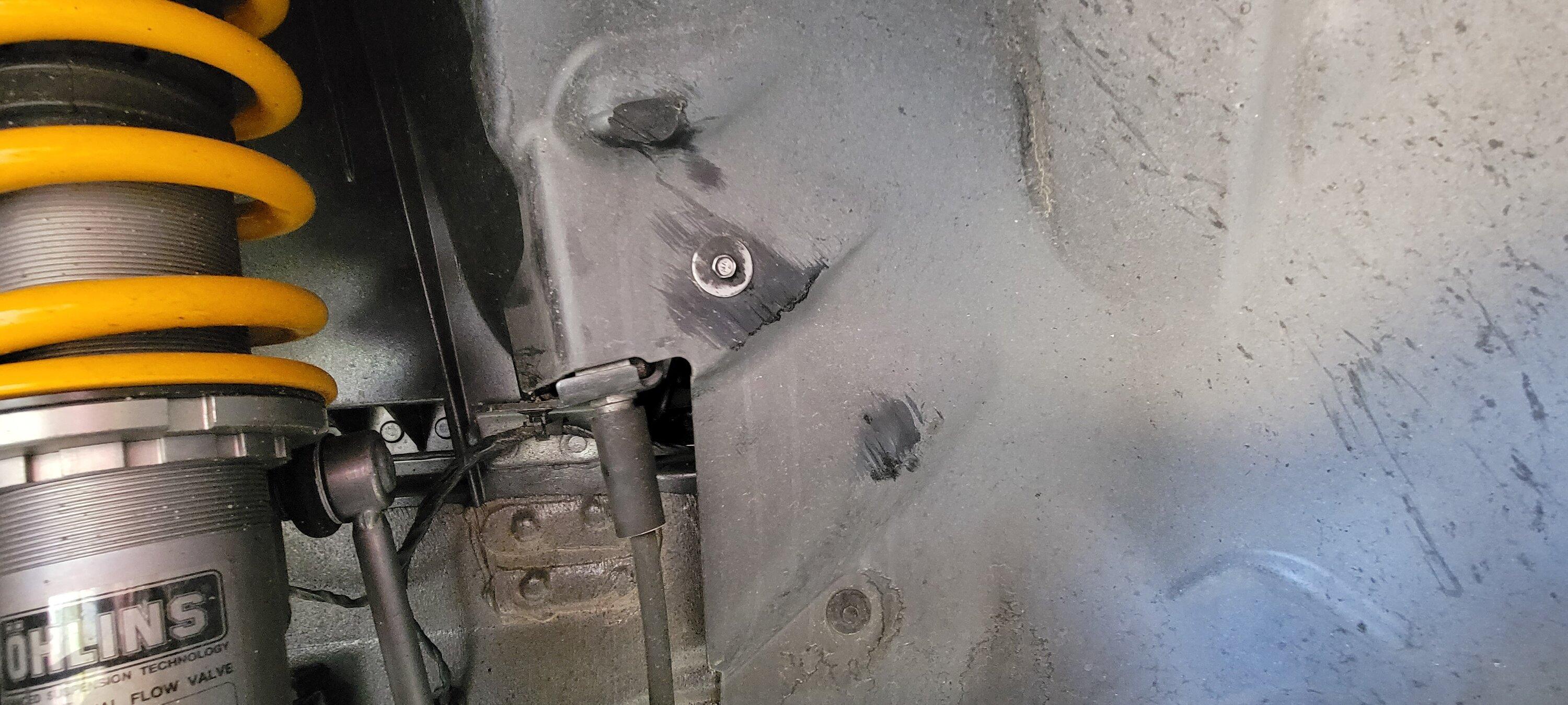

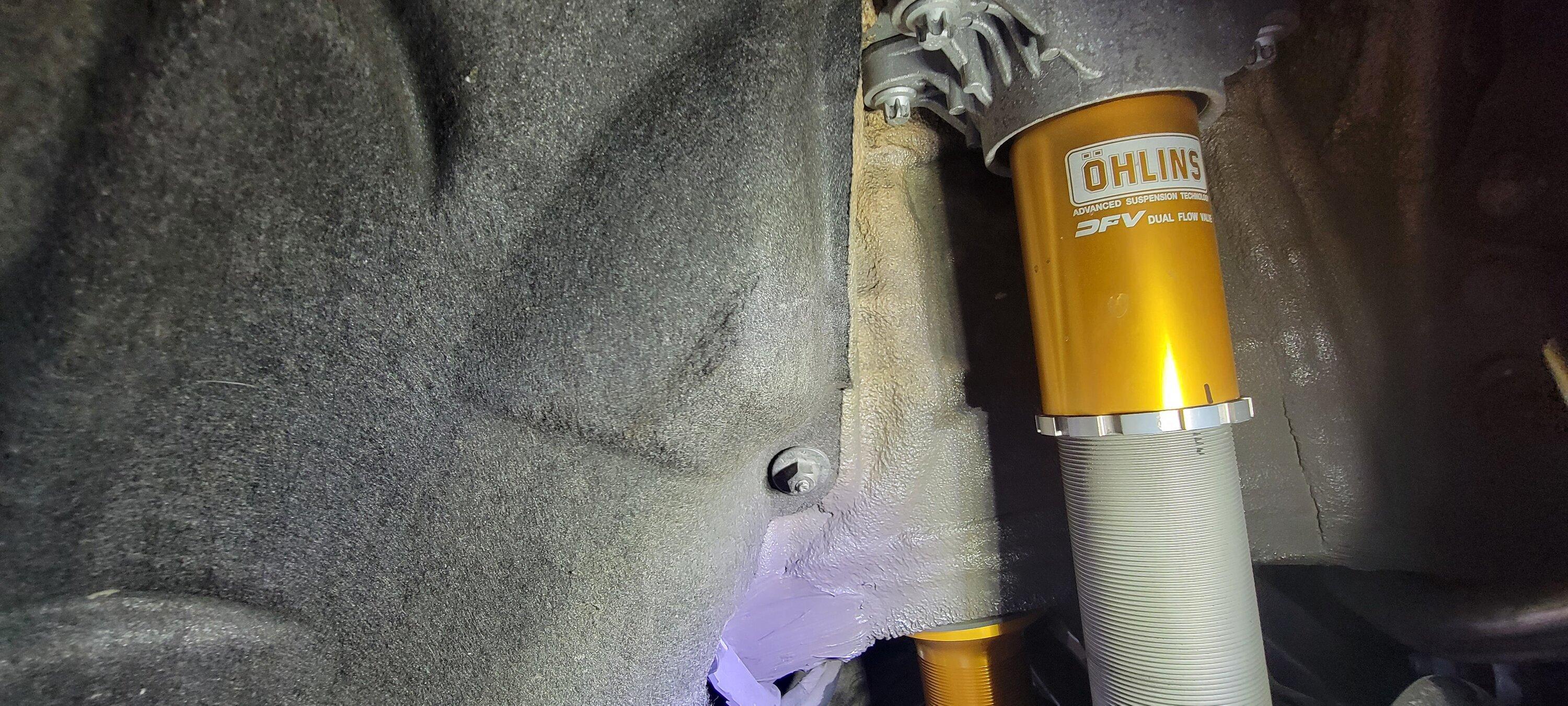

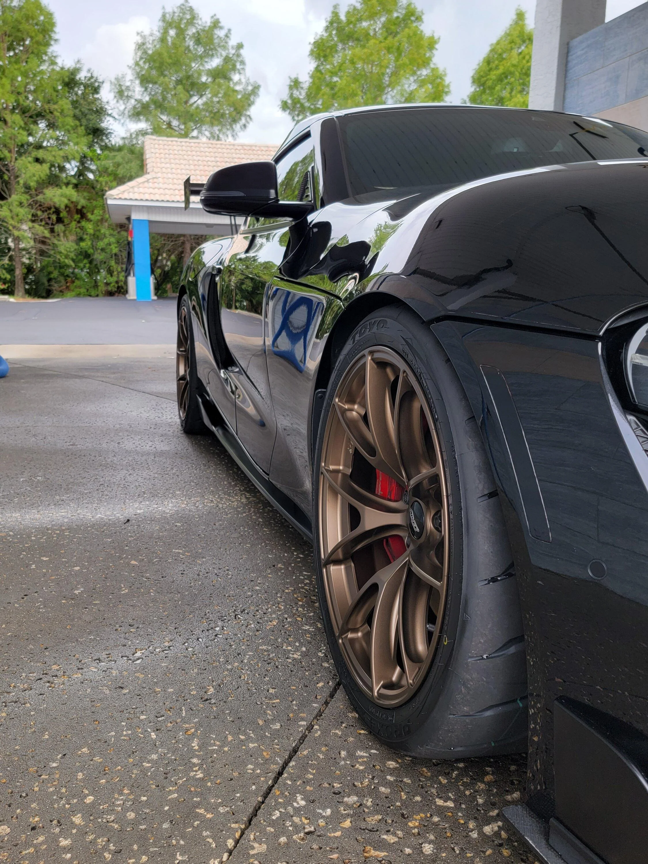

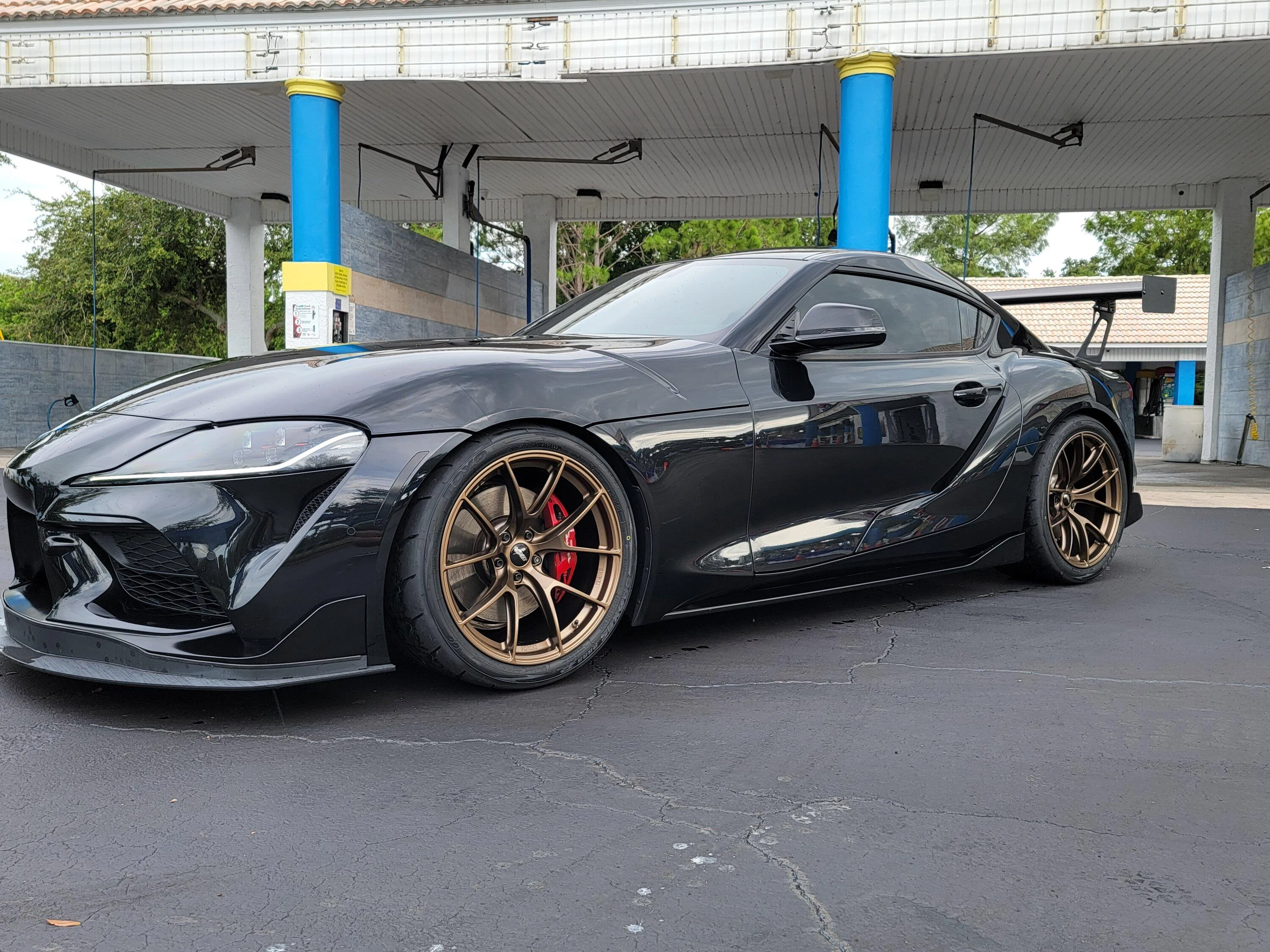

@Evolution 's Square setup
Wheels: 18x11 ET40 Satin Bronze SM-10
Tires: 315/30-18 Falken RT660s
Brakes: Stock

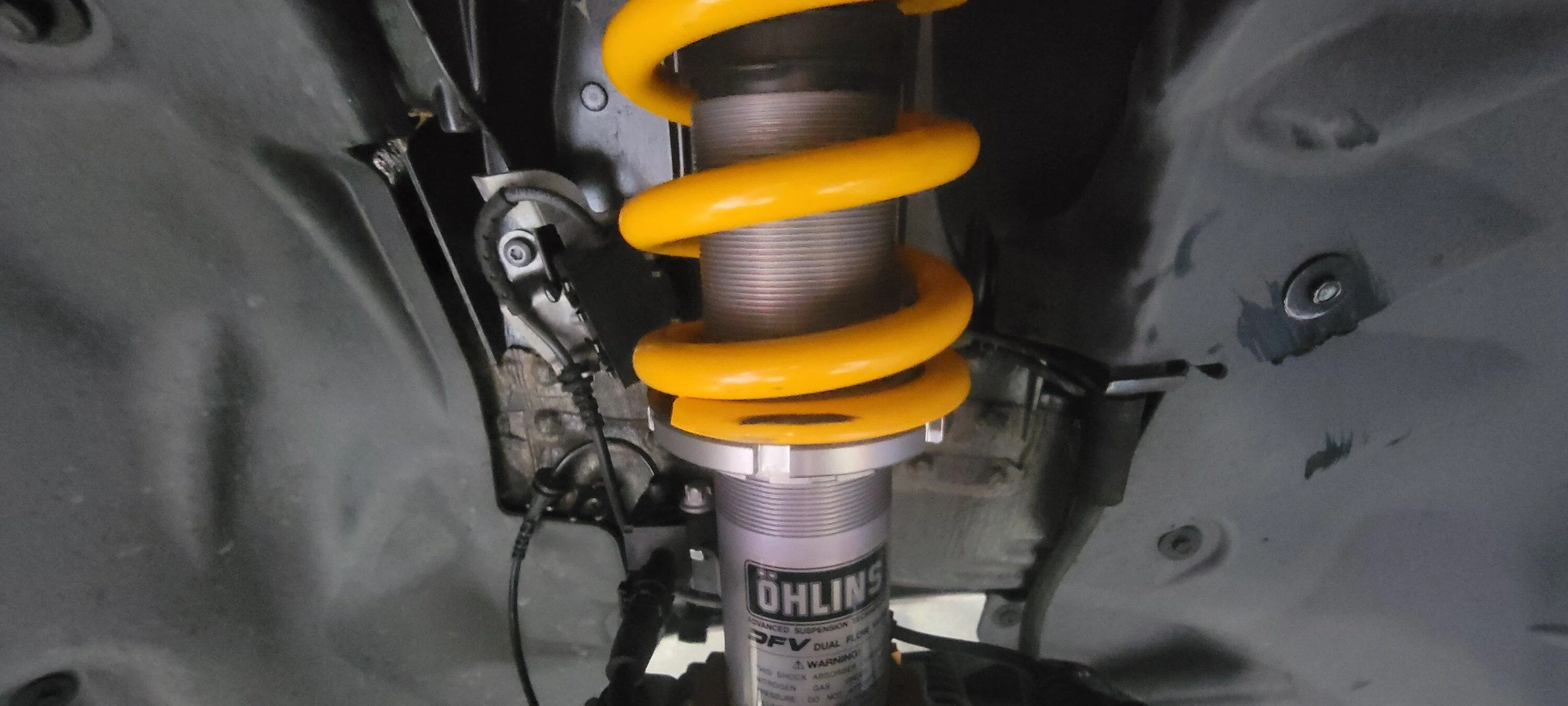

Suspension: Ohlins DFV
Camber: -3.1° Front, -2.3° Rear

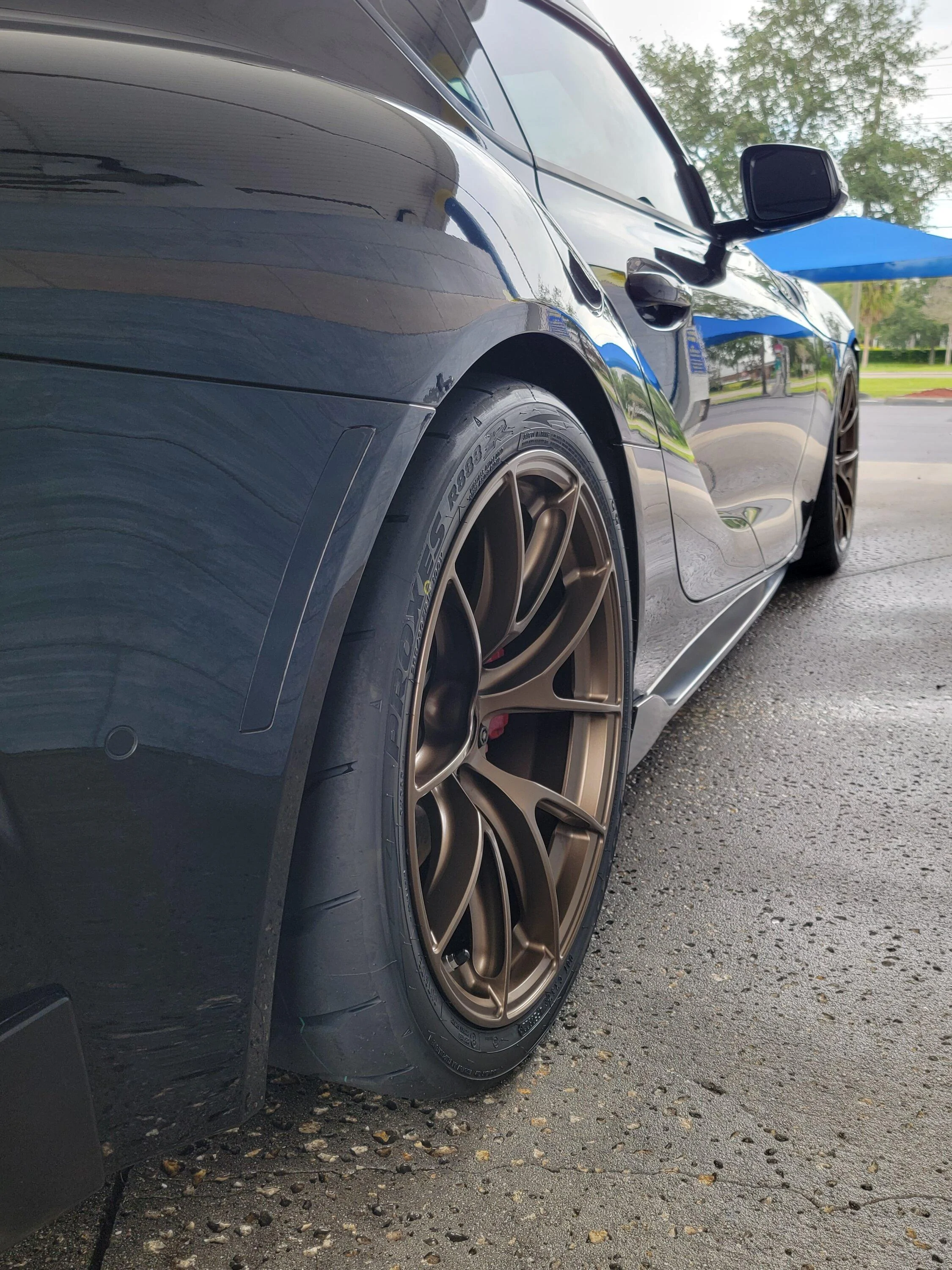

Additional Notes: 3mm spacers required front (strut clearance) and rear (to eliminate liner rub, shown below). RT660s are known to run wide and this is the widest setup we have seen on the A90 thus far in terms of tire. 3mm spacer required but is likely not needed with 315 tire models that run narrower.

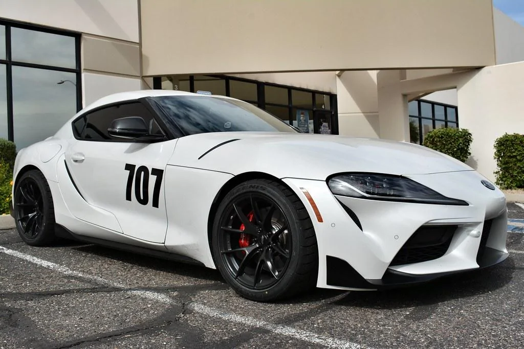

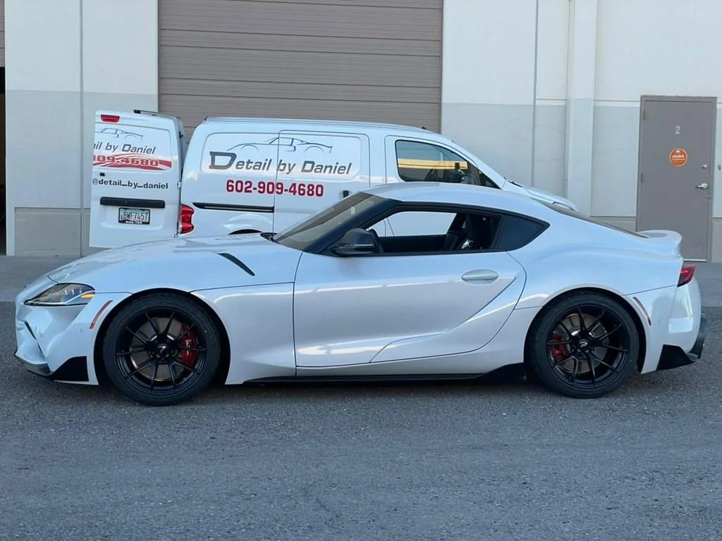

@AZAutohunter's Supra on 18" VS-5RS:
Wheels:
18x11 ET40 Satin Black VS-5RS
Tires: 315/30-18 Falken RT615K+
Brakes: Stock
Suspension: Ohlins coilovers, SPL arms
Camber: -3° Front, -2° Rear

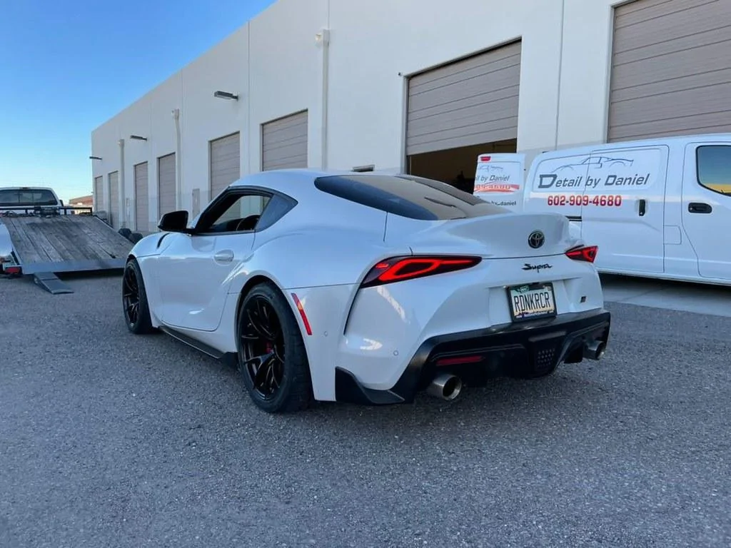

Spacers: 3mm front & rear

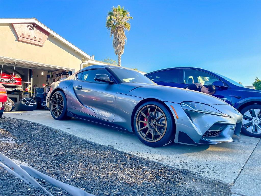

Joe's 19" square setup:
Wheels:
Satin Bronze VS-5RS
19 x 11 ET40 square
Tires: Toyo Proxes R888R
295/30/19
Brakes: Stock
Mods:
HKS height adjustable spring
Verus camber plates
-3.4 degrees camber
lowered 1" on the front, .75" on the rear
No spacers
Notes:
Haven't noticed any rubbing on compression. As others have mentioned it does contact the fender liners at full lock.

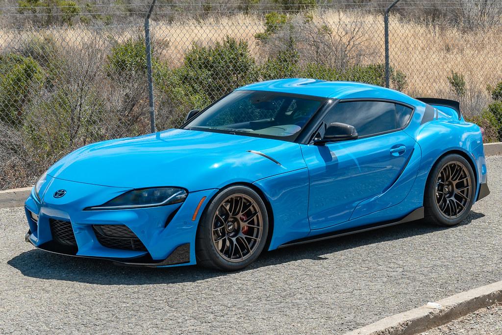

Updated OP with photos and Notes on Brad's Refraction blue A91:
Camber: -3° front
-Tom

Adding photos and Notes from Joe's 19" fitment:
Wheels: Satin Bronze VS-5RS
19 x 11 ET40 square
295/30/19
Mods:
Verus camber plates
-3.4 degrees camber
No spacers
Notes:

Added the following 18x11 fitment to the OP. -Tom
Brakes: Stock
Additional Notes: 3mm spacers required front (strut clearance) and rear (to eliminate liner rub, shown below). RT660s are known to run wide and this is the widest setup we have seen on the A90 thus far in terms of tire. 3mm spacer required but is likely not needed with 315 tire models that run narrower.​

Added our first 18" VS-5RS 18x11 ET40 square fitment to the OP:
Wheels:
Brakes: Stock
Camber: -3° front, -2° rear
Spacers: 3mm Front & Rear​
-Tom
Wheels:
Brakes: Stock
-Tom
Those look like Falken RT615, not 660. 660 run wider AFAIK.
