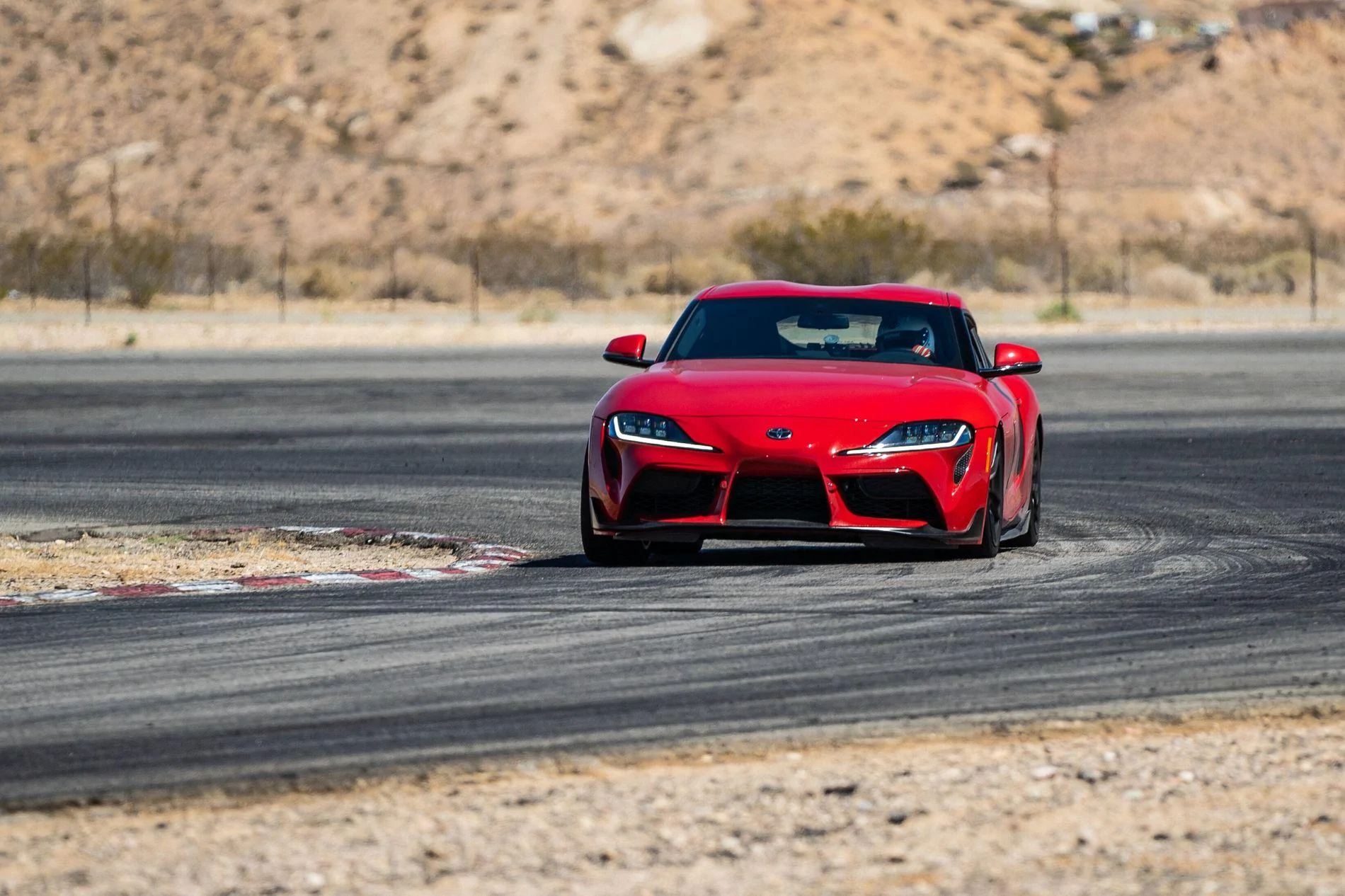

Modifications:
H&R Lowering Springs
Toyo Proxes R888R 265/35R19 & 295/30R19
(Stock engine and brakes)
Streets of Willow is a fairly tight and technical track requiring finesse and smooth applications all around (steering, throttle, brake) to tie together a decently fast lap time. There are a few high speed sections and transitions that will definitely test your courage. The Supra seemed to be a perfect fit for the track as it shares the sharp steering qualities similar to a S2000 (well not quite, keyword similar) and a healthy amount of power even in stock form. We didn't have time to upgrade the pads from stock, but we did install a set of H&R lowering springs as I was general curious as to whether or not lowering springs would actually provide a noticeable improvement in roll, especially in mid to high speed sweeping corners. To my surprise, the H&Rs did a fantastic job both on track and on the public streets/highways.
On Track Performance:
A few noticeable improvements the springs gave us were:
1. Lower ride height (very important)
2. More camber. Fronts were able to achieve -2.2 to -2.3 deg camber (matched rears), which translated in improved turn in/mid corner grip, as well as better tire wear (as the tire was not rolling over the sidewall nearly as much as it did with -1.8 deg camber).
3. A notable decrease in body roll. The stock suspension caused the Supra to roll more than ideally, giving a slight "floaty" feeling in high speed sweepers and transitions. While the overall car was still planted thanks to its' great chassis, the softness was definitely not what you'd call confidence inspiring in certain sectors of the track.
Streetability/Comfort
I drove the car to and from the track approximately 120 miles each way and can honestly say that the springs did not add much, if any, harshness or discomfort on the road. In comfort mode, both the H&R and factory springs felt nearly identical in my opinion, whereas. Lowering springs are definitely not the end all solution if you are looking to maximize lap times. However for the daily driver or average weekend track day goer who still uses their Supra as a daily driver and wants to maintain the electronic suspension options, the H&R's won't disappoint. The next step for our Supra will be KW V3 (or Clubsport) coilovers with the Electronic Suspension Cancellation kit in a few weeks to come.
Before leaving this on a note of spring "praise" lol, it is very fair to mention that upgrading the stock brake pads should be at the top of the list when going about track preparation. Brake fade is apparent after a few laps, and progressively worsens as it gets hotter (Especially on the second track day, even with Motul RBF600 fluid). The next pad upgrade will likely be the CSG C2 (Race) pads.

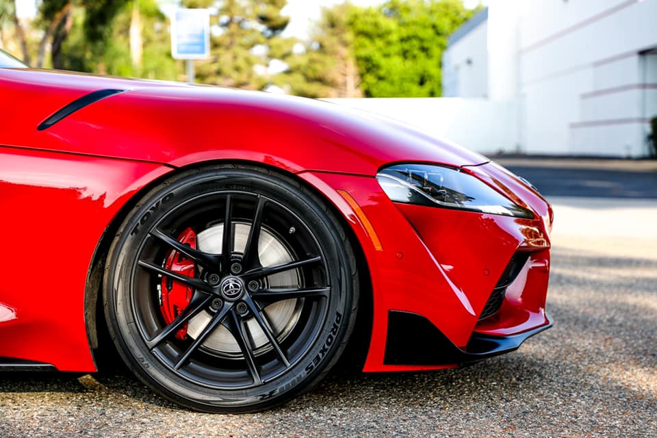

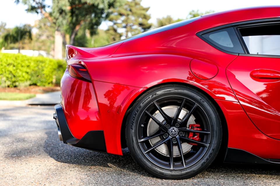

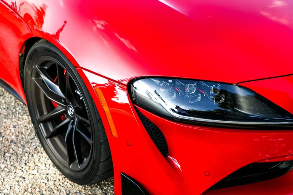

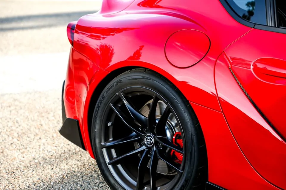

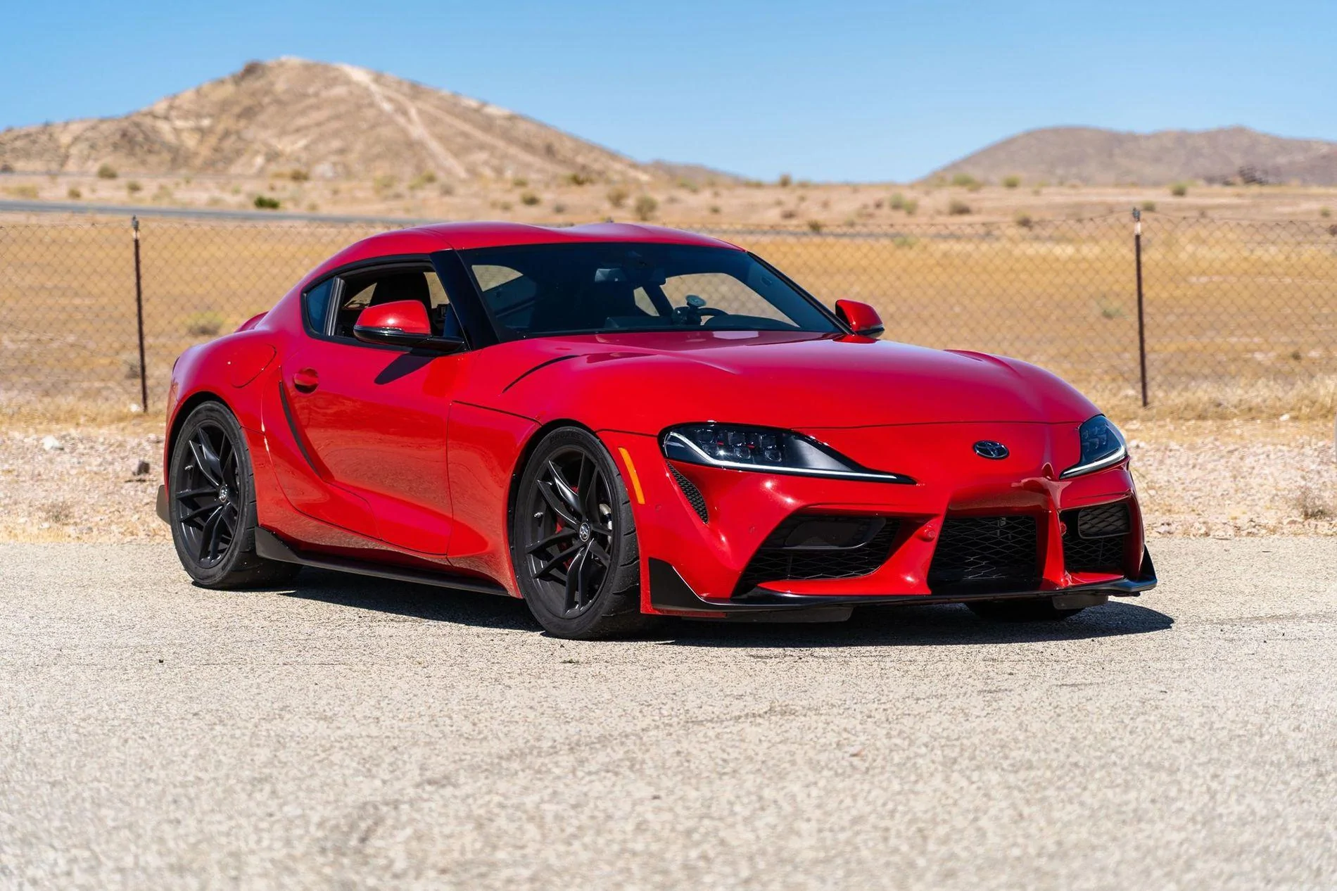

Post installation Photos:
c-aqkdhcdqbwfr_jiorpxl5swdlex2wzozc5bi6xn69bg62z25ou3utx2xdjnruqzpwru-_nc_ht-scontent-lax3-1-jpg.jpg
c-aqnq0m4p6lbkgkqvrsonp5hcz30vxyk7s2dtsjt9bfojiv8oqpcnccolftjxjokcfpi-_nc_ht-scontent-lax3-1-jpg.jpg
c-aqlle7lti02w-xmyro9te3fp7misqf235l62oycqfs4dhhsyiml90beemgb-nkjwhpw-_nc_ht-scontent-lax3-1-jpg.jpg
c-aqkqjy6kg3ap5uuzkaakmufxhit9xo9lnx1ti_qmpfka8sqx98-uamhxphtwu-nomdi-_nc_ht-scontent-lax3-1-jpg.jpg
c-aqllcsk9uw70cnocchinkw1px3gd3ujec9sn0w5jzfqjwhsm_nofzrpsxlkxeimbpxa-_nc_ht-scontent-lax3-1-jpg.jpg
c-aqnvhoge1garard3plq5rshye-9i2ozidlcm9pn6brd-zn3cwk8-nxj9qmrzsh2ysts-_nc_ht-scontent-lax3-1-jpg.jpg

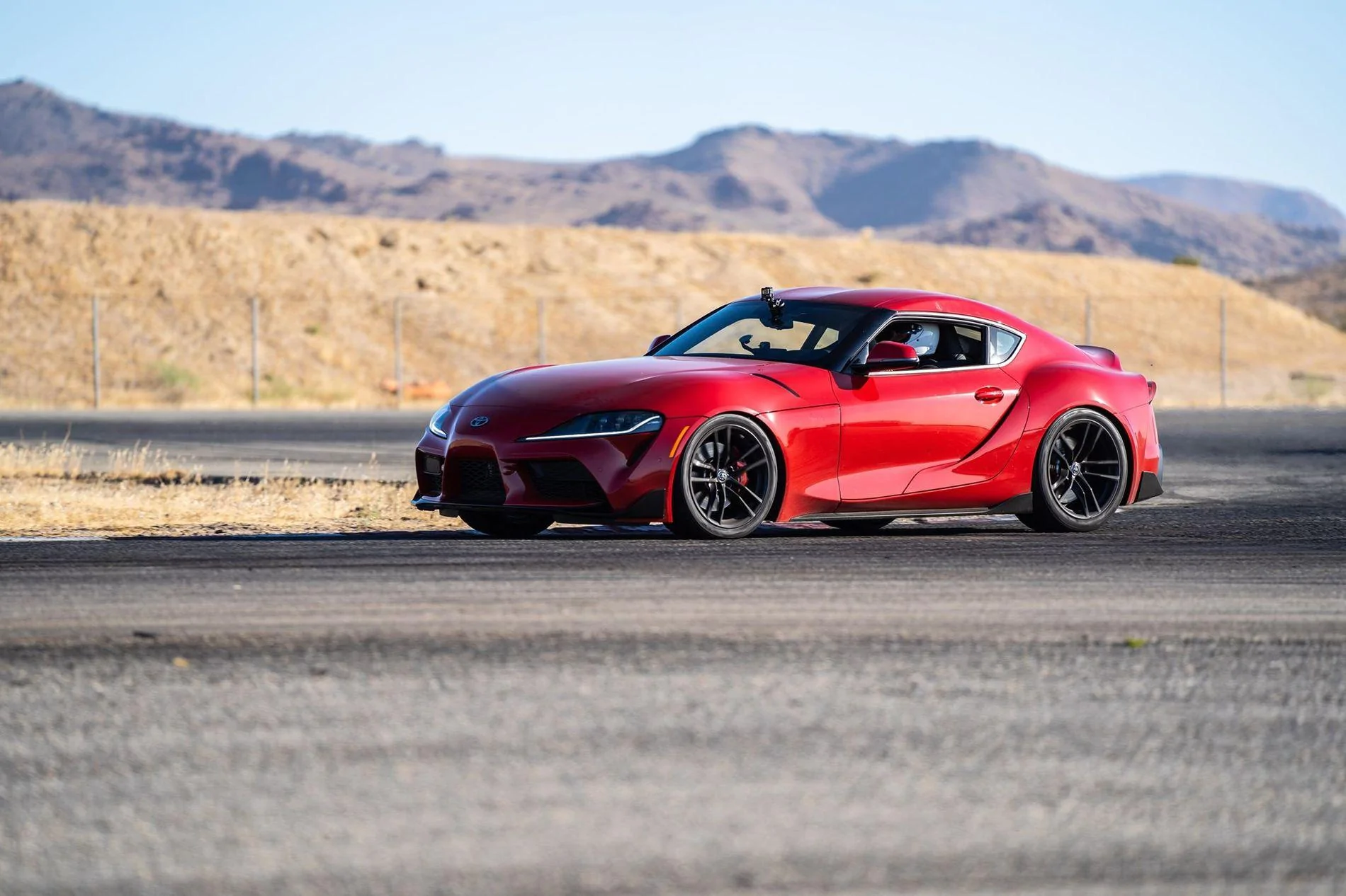

Parked and Action Side by Side Comparison photos:

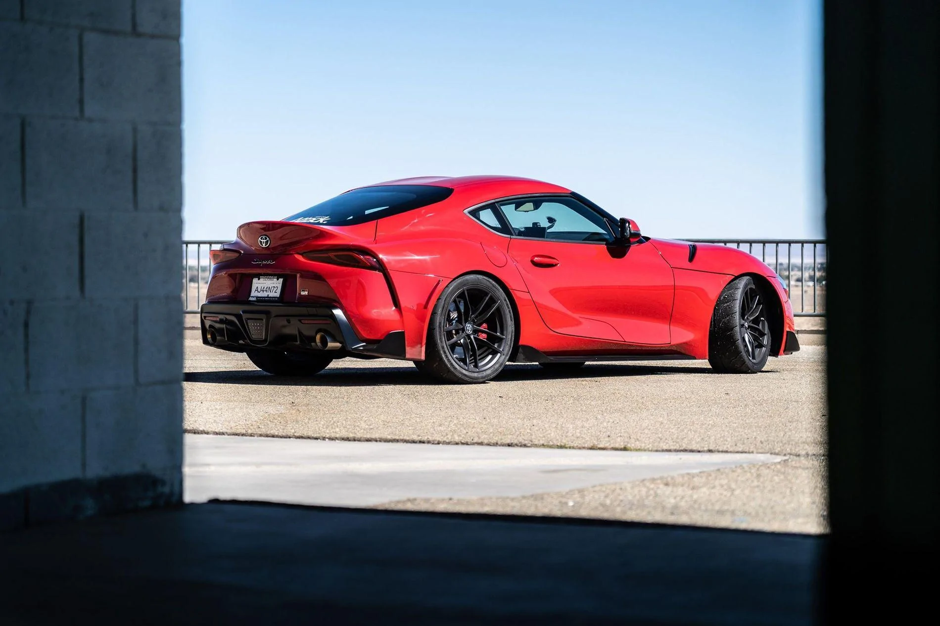

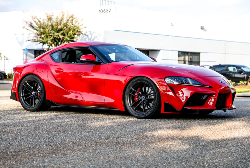

Installed photos!
Sits perfect. Love it. How was the install? Pretty straightforward?
MMR
MMR
Matt
Sep 6, 2019
37
73
Southern California
2006 Honda S2000 (Time Attack), 2020 Toyota Supra A90
Any thoughts on why Toyota included such soft springs consider the car’s cornering abilities?
Street comfort is my best guess. Although Jackie Ding posted a video when he removed his factory suspension and tested the spring rate and damper on a shock dyno. Some pretty interesting insight with the shock valving and how the rear suspension was engineered with the struts placed further inboard in comparison with the fronts giving requiring a higher spring rate in the rear (3k/9k iirc). I'll post the link so you can check it out, definitely some cool info.
Install was super straight forward for the most part. If you've installed springs or coilovers before you can install these.

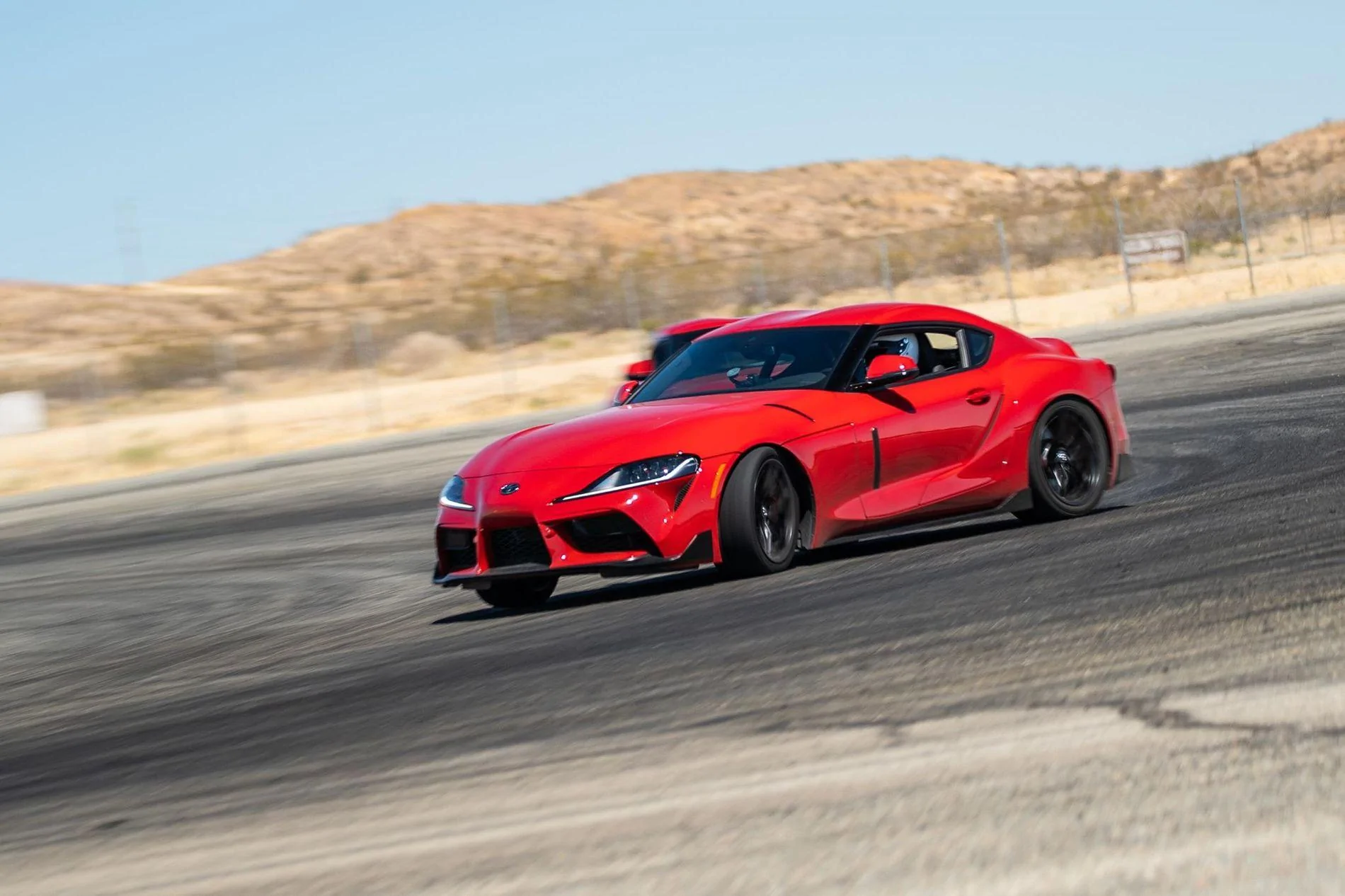

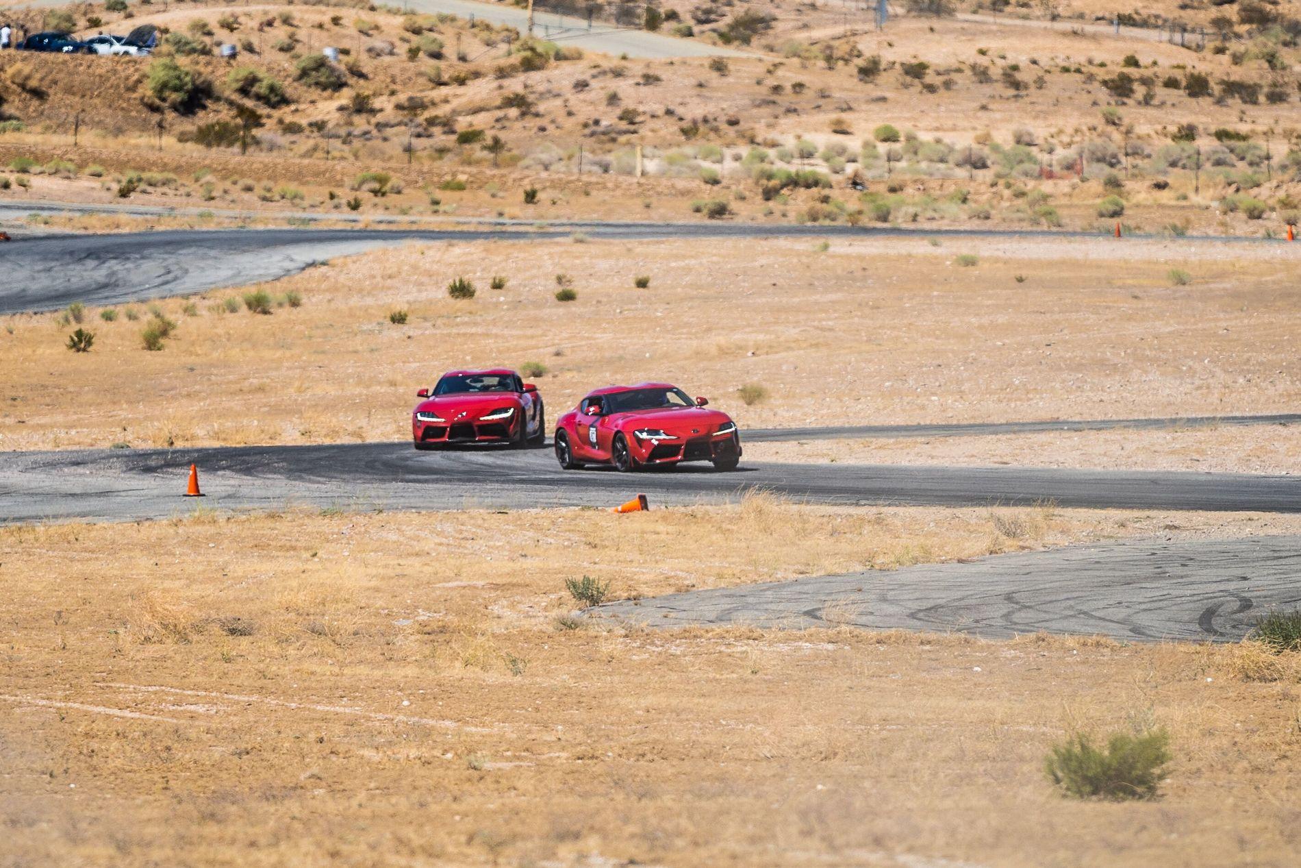

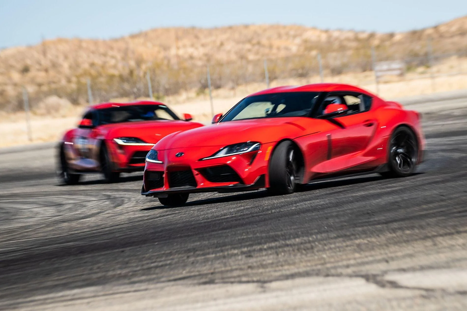

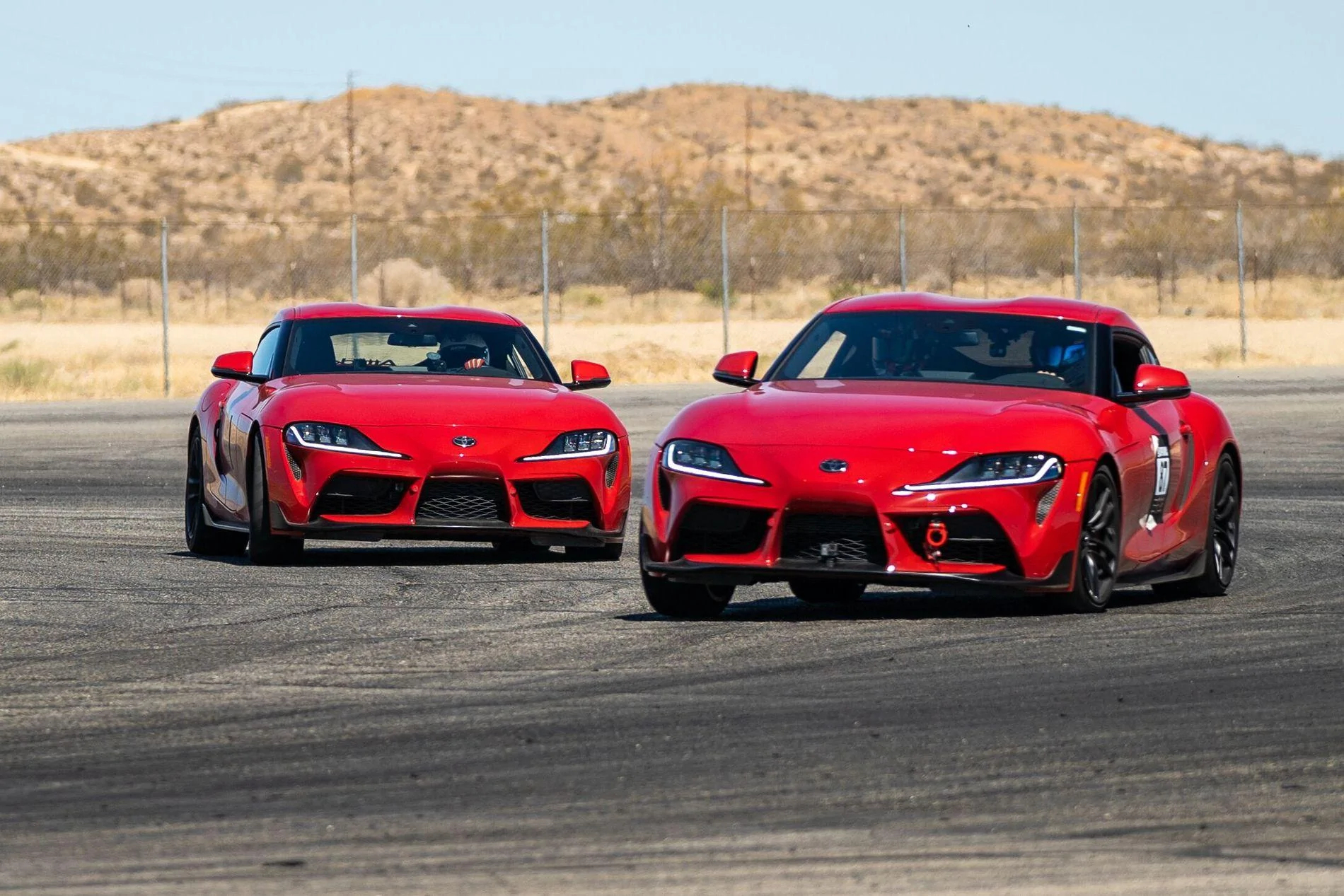

*Updating original post with new photos and info*
The springs should now be fully "settled in" after 300 miles of street driving and 3 sessions at the track. It may also be helpful to note that there was zero rubbing with the springs installed, and Toyo R888R F: 265/35R19 R: 285/30R19 under the factory fenders.

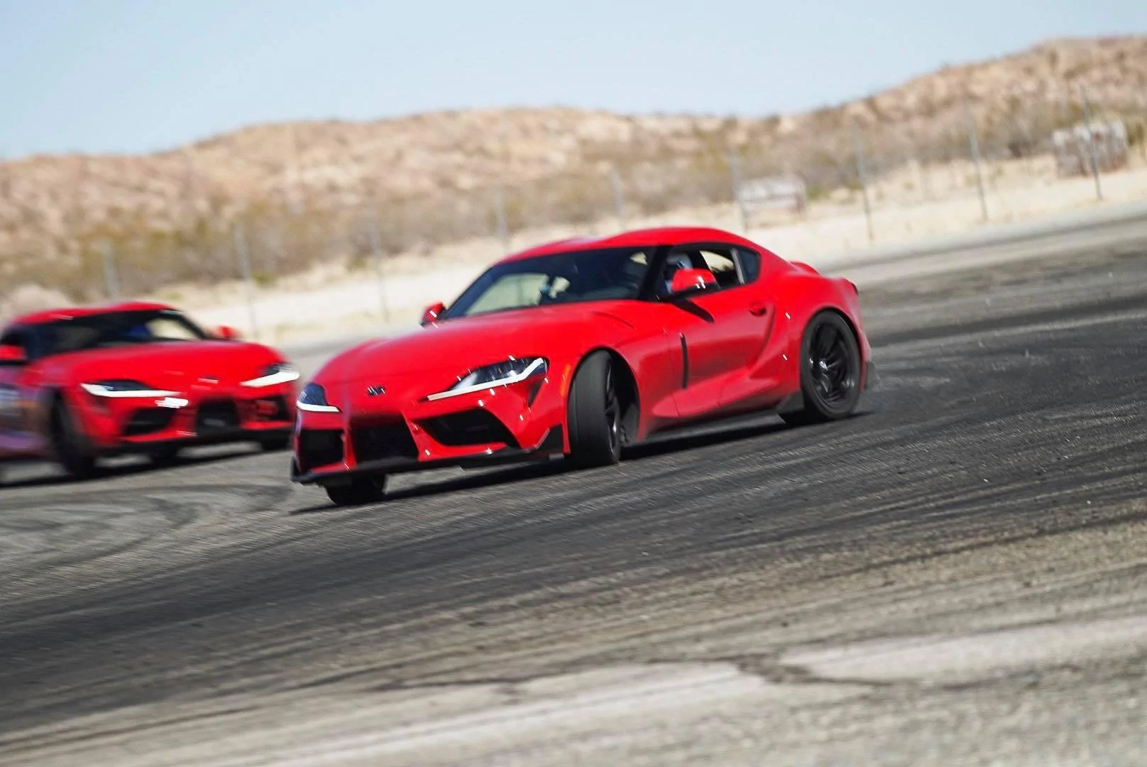

It was also interesting to see a close comparison between one MKV on springs and one on stock suspension, both in the same corner. Ours (with springs installed) and Jerel's Supra (factory springs)!
