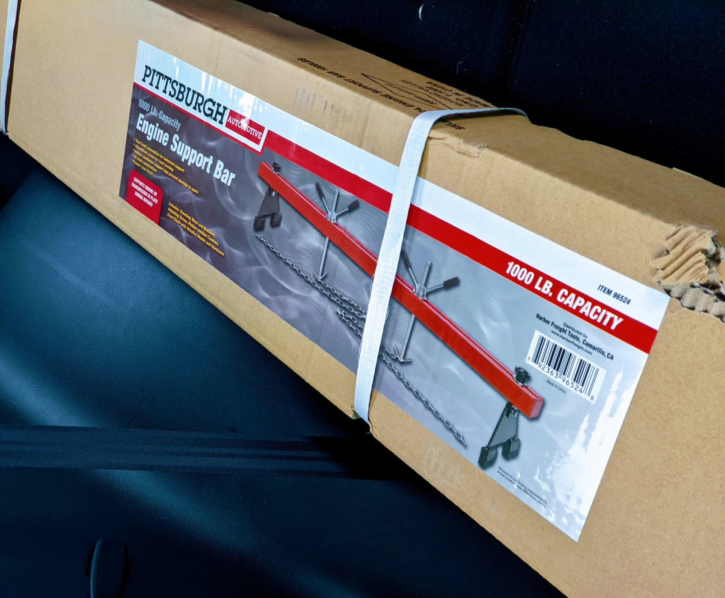

Seems not. :) I'm gonna try an engine bar to keep the motor in place, then I can safely unbolt the arms from the block (one side at a time). When the arm is free, I can lift the mount out if its cradle on the subframe. No jacking of the engine required.
YOLO.

I guess you can say it's getting pretty serious.

Update:
Spent the day working on some projects and was coming to this last. Turns out, there are no engine hoist loops anywhere on the block? I searched high and low and couldnt find anything. :( Who ships a motor without engine hoist rings?!
