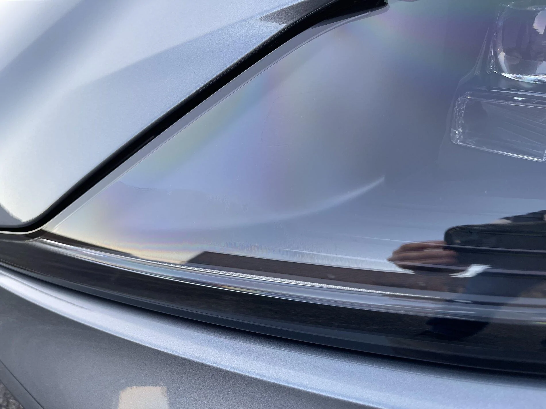

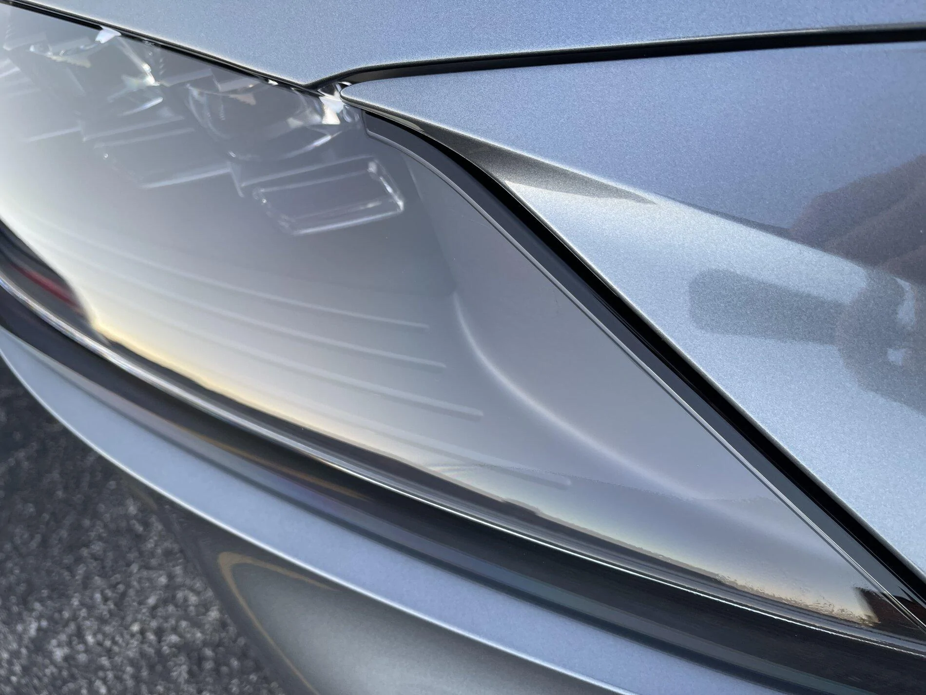

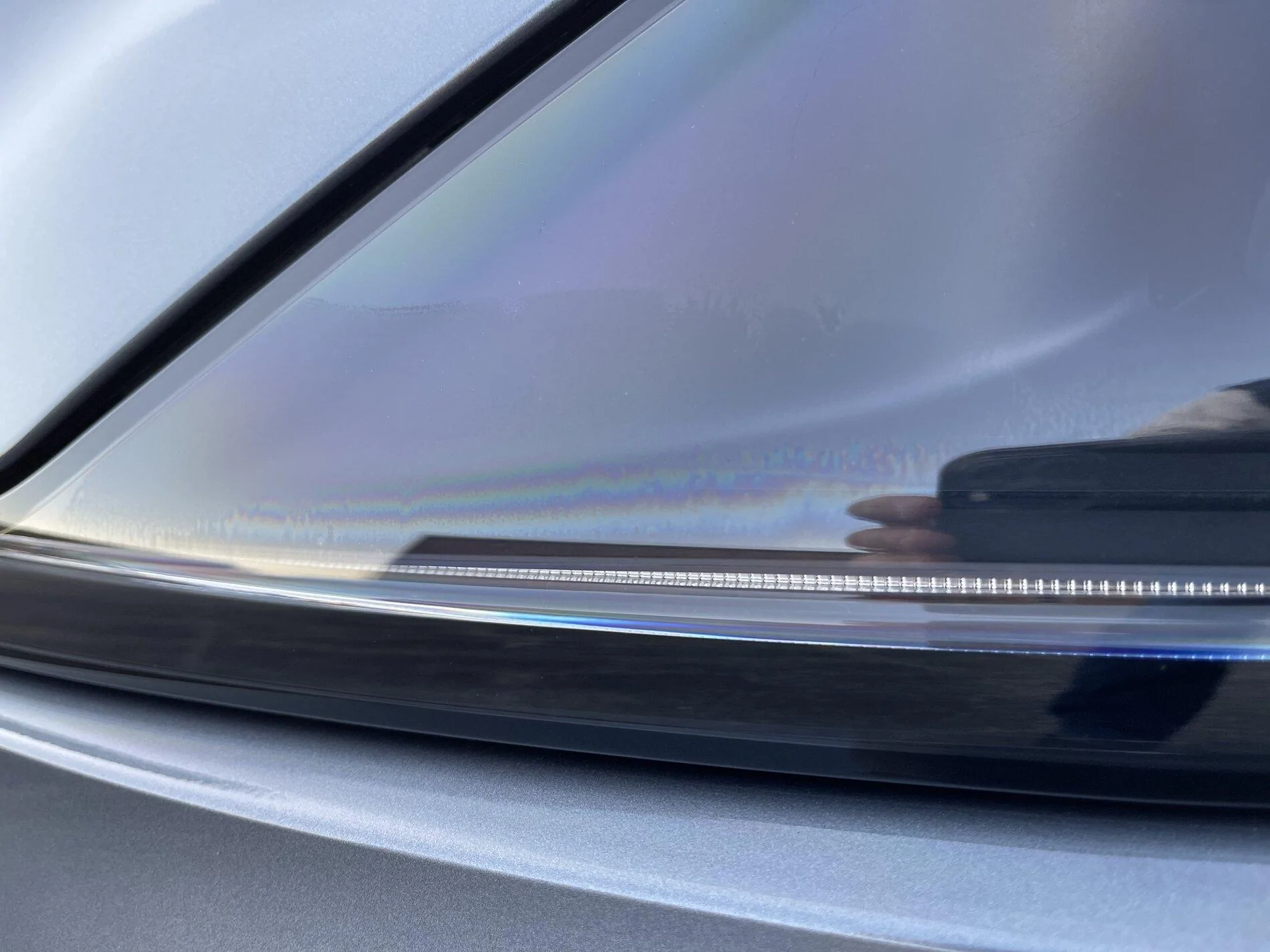

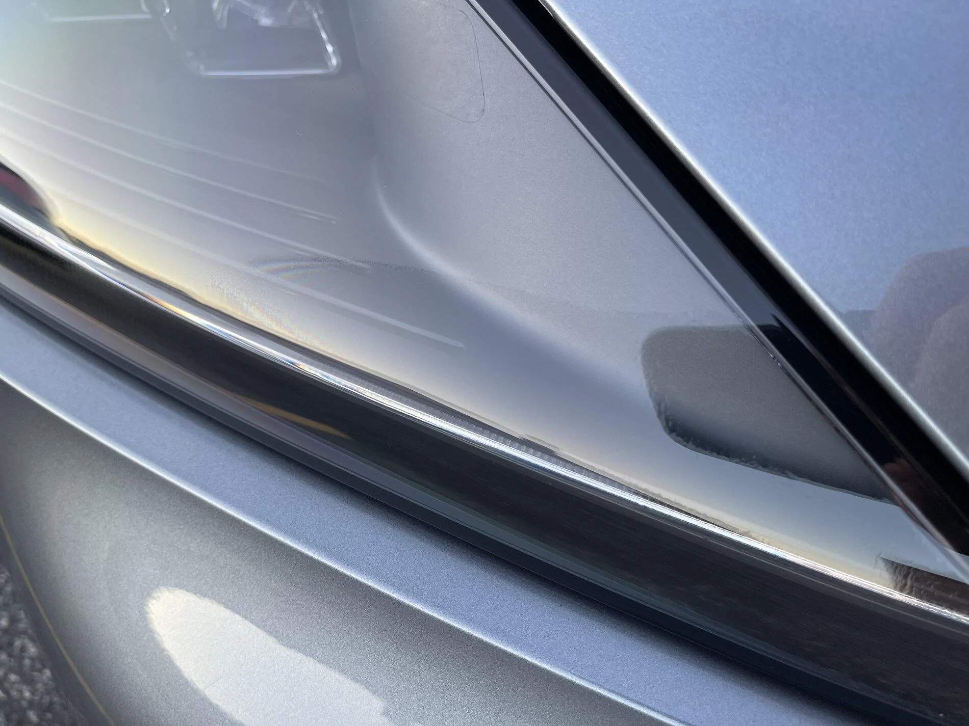

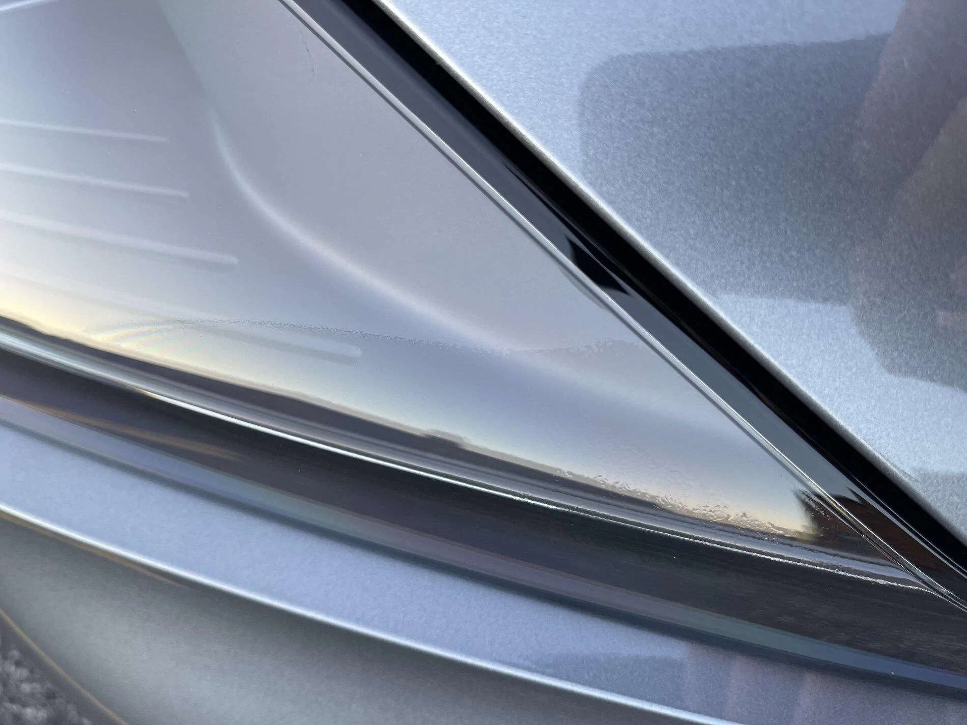

I recently purchased my 2022 and now only have 144 miles on it from driving it home from
dealership.
This morning at 6am with an outside temp of 44 degrees F, I drove my car for 50 miles to a place to get PPF after sitting inside my garage all night (did not have the garage heater on).
I got out to go inside the business and noticed both headlights have condensation in the corners after the drive. It did rain last night but cleared up around midnight and the roads did not contain any water during the drive.
They are going to be wrapping both headlights as well, anyone else experienced this issue or is it just due to so much moisture in the air and the temp of the day
If this issue is posted elsewhere my fault.
I hope this goes away and never returns or causes any weird imaging inside the headlight.

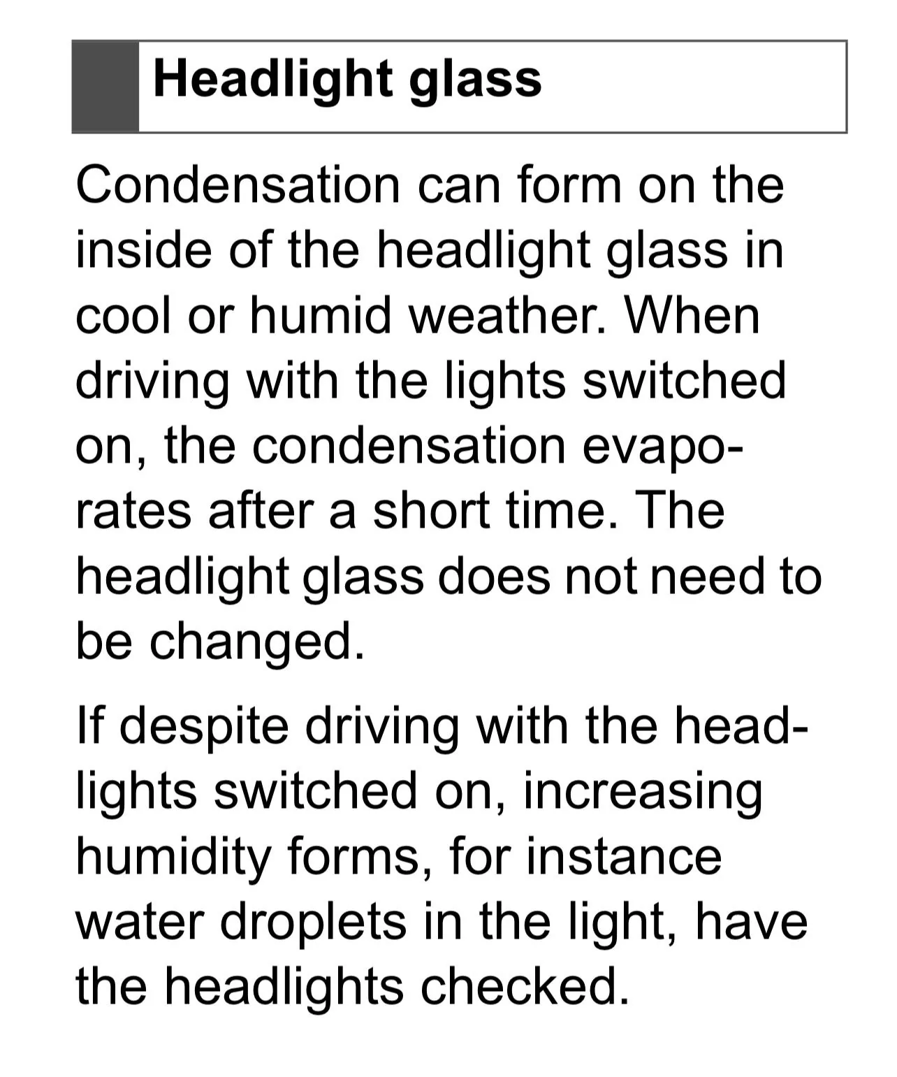

I guess this is normal per the owners manual. If doesnā€™t dry out properly and causes smearing or weird artifacts Iā€™ll get a warranty issue started.
Do not think anyone else needs to reply. Shoulda read my manual before post.

Normal. Iā€™ve seen a bit of condensation in the corners before. The headlights arenā€™t sealed so this can happen. They only need replaced if you see excessive amounts in there.
