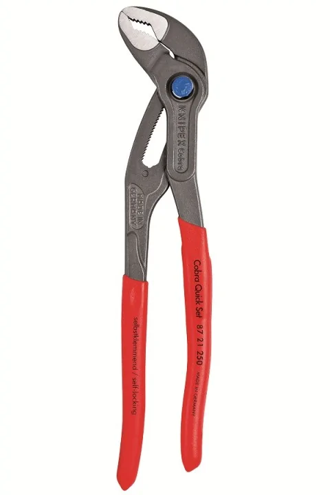

Yes, it does stick and I couldn't pull it off by hand. So I use a set of Knipex pliers to "gently" pull it off. Doesn't hurt anything if you don't try and crush it.
