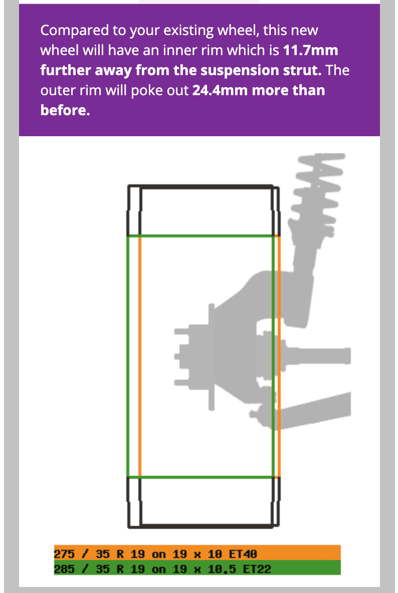

Offsets can be a bit tricky. This may help you visualize the difference between your OE rear wheel and tire and the 19x10.5 ET22 you have in mind.
OE wheel is orange, while the wheel you are considering is green.
In this case, the new wheel will poke out an additional 24.4mm (just about 1 inch) more than the stock wheel on the outside edge. This is an aggressive fitment and I would expect it to cause rubbing if you aren't running a significant amount of negative camber in the rear and stretched tires. Full page with measurements here: https://www.willtheyfit.com/index.p...=35&wheel_size=19&wheel_width=10-5&offset2=22

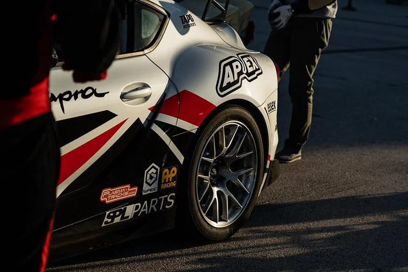

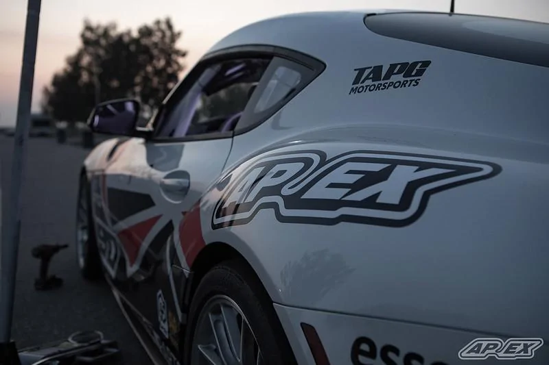

For reference, this is an 18x10.5 ET38 wheel in the rear:
The TAPG guys run aggressive tires and this is an 18" wheel rather than a 19", but it gives you an idea of what a 10.5 inch wide wheel with ET38 offset would look like. The ET22 wheels you are interested in would poke out 16mm (~.62 of an inch) more than the wheels pictured above.
I would double-check the offsets of the rear wheel that you are considering for sure as ET22 might take some work to fit without rubbing.
