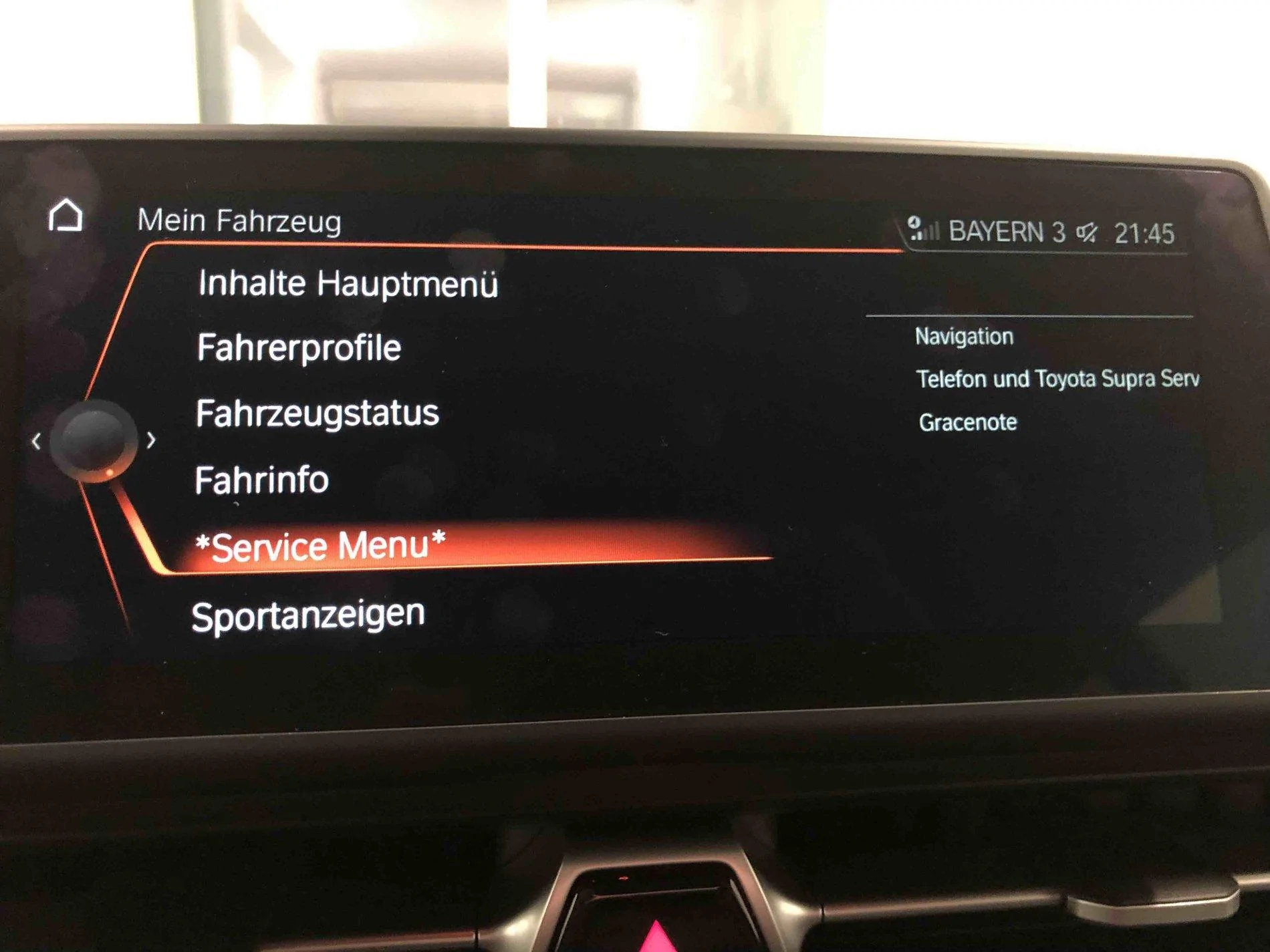

Anyone tried this?
F30 with (professional) navigation
This implies that you have an idrive controller that can slide up and down
Call up Start (main) menu
• Push controller in up direction for at least 10 s
• Rotate controller, 3 notches to the right
• Rotate controller, 3 notches to the left
• Rotate controller, 1 notch to the right
• Rotate controller, 1 notch to the left
• Press controller once
• The Service menu is now added as the last submenu to "Settings"

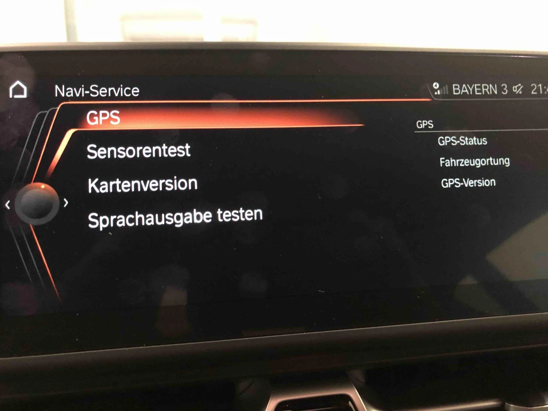

It works for me on a European (German) version of the GR Supra. Thank you. It will not disappear after switching off the car.
It shows details of
Telephone and Toyota Supra Connected Services
Gracenote
BMWAF
It shows details of
Gracenote
