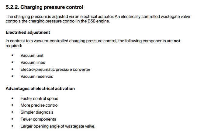

Apologies for the confusion. I remember reading some time ago that the B58 charging air pressure was controlled by the electronic wastegate (as well as exhaust pressure) and I might have misinterpreted this. I assumed that meant the wastegate did not fully release exhaust pressure but would control the amount of exhaust pressure, to slow the turbo and subsequently reduce charging pressure... (too hopeful I guess)
I think this is the bit that might have confused me...

im probably going to regret wading into this, but.....
The wastegate plays a key role in the boost bypass logic of the b58. If the tuner doesnt get the wg open and the valvetronic load delay protocol correct as they increase wg duty, they can easily pressure spike the turbo on downshift. This is why the N55 motor went to a electronically controlled wg in the first place, and factory information manuals from BMW and Bosch tell tuners to do exactly this and for this reason.
it is more important without a bov to make sure the wg gets opened to get the energy off of the turbine and stop applying force to the compressor.
There is a thread currently going on about this exact issue. Cylinder deactivation does part of it, but stupid burble tunes can make that problematic, and you still have to pull the tq off the turbine wheel And overlap the cams and give load delay to the throttle plate. By sequentially deactivating cyl’s, yes -that can cut gasses to the turbo, but the motor still has to do something with the pressure in system on throttle lift, and in this case digesting it through valve overlap is another key part of the strategy.
Jmho, but given that tuners who have no experience tuning valvetronic have piled onto the supra like a gang bang in a Brazzer’s video, people need to pick their tuner carefully and probably just add an electric solenoid valve to prevent more blown turbos.
