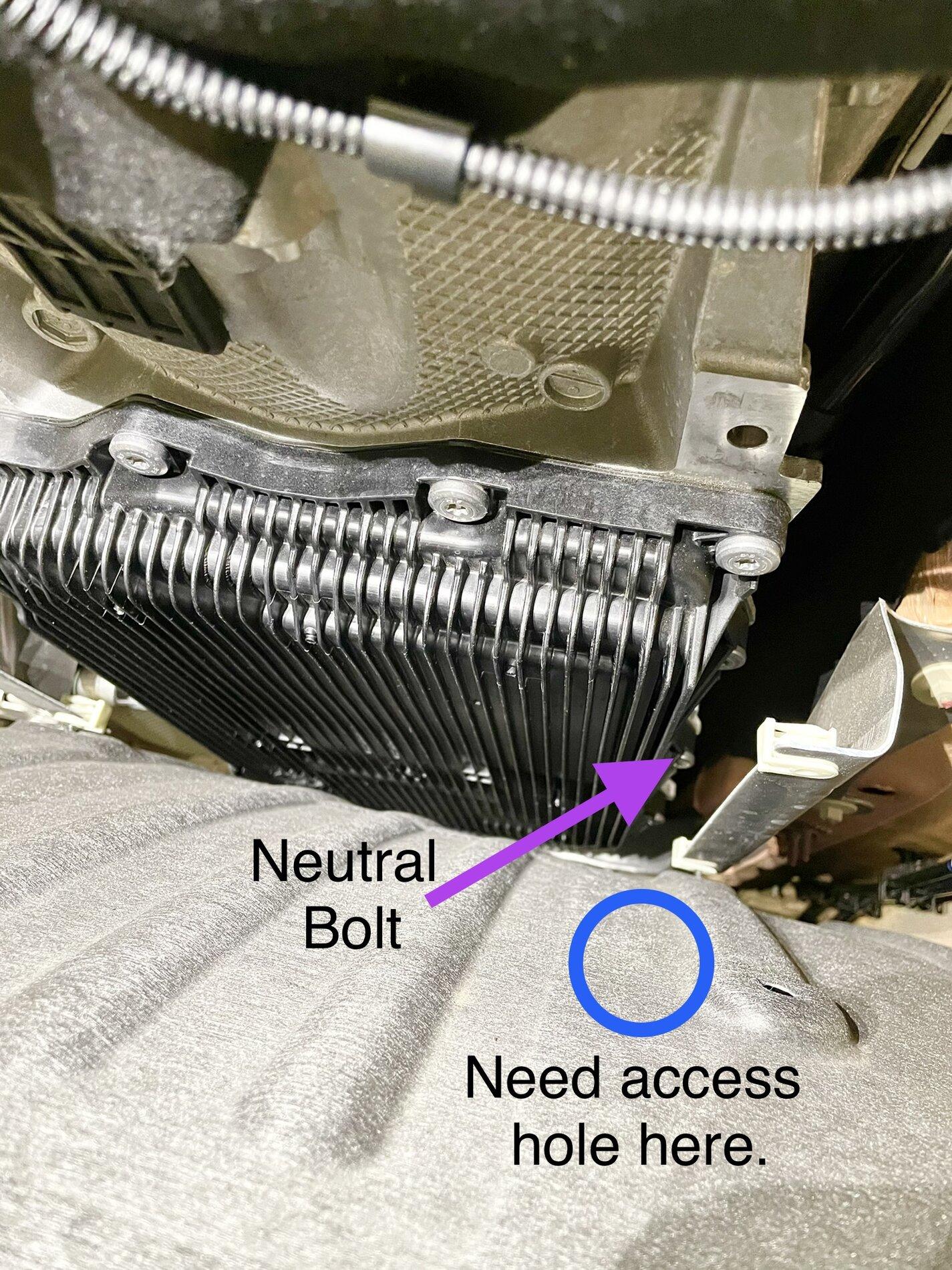

Here you go, good luck getting to the bolt.
-RJM
Where is the ZF 8-Speed Neutral Safety Switch Bypass Located?
The ZF 8HP neutral safety switch bypass can be found on the bottom of the transmission; there's a bolt positioned below a small foot that comes out of the transmission. That little foot is the manual neutral safety switch bypass. Depending on your vehicle, the location of this bolt could be obscured by various belly pans/plastic panels. You will need to remove these to gain access.
As you rotate the bolt to the right, the foot will move upward. As you push the foot up, the transmission will click into neutral, allowing the car to roll freely.
Tools Needed to Put The ZF 8-Speed Transmission in Neutral:
How to Put The ZF 8-Speed in Neutral:
First start by safely lifting the car in the air. We always advise using a quality floor jack and jack stands to support the vehicle. Once it is in the air, you need to gain access to the transmission. Depending on the car in question, this could be behind belly pans or covers.
Once you've gained access to the transmission, locate the hex-head bolt. Use a 5mm hex bit socket on a ratchet to rotate the bolt to the right. Listen for a click as you move the foot up. The click indicates that the transmission is no longer in park, and the car will roll freely.
After the transmission clicks into neutral, loosen the bolt until there is a gap between the bolt and foot. The transmission will stay in neutral and will be able to be shifted into park with a charged battery. Leaving the bolt tightened will prevent the car from being shifted into park once it is charged.

This is what it looks like on the GR Supra. I’m surprised BMW or Toyota didn’t put an access hole in the belly pan. I will probably drill a hole there and add a grommet for future emergency access.

time to fab up a little cable actuated plunger to rig in the cabin to easily pop into neutral. wonder if the car will allow you to put it in park on accessory power?
I like your thinking. ?
