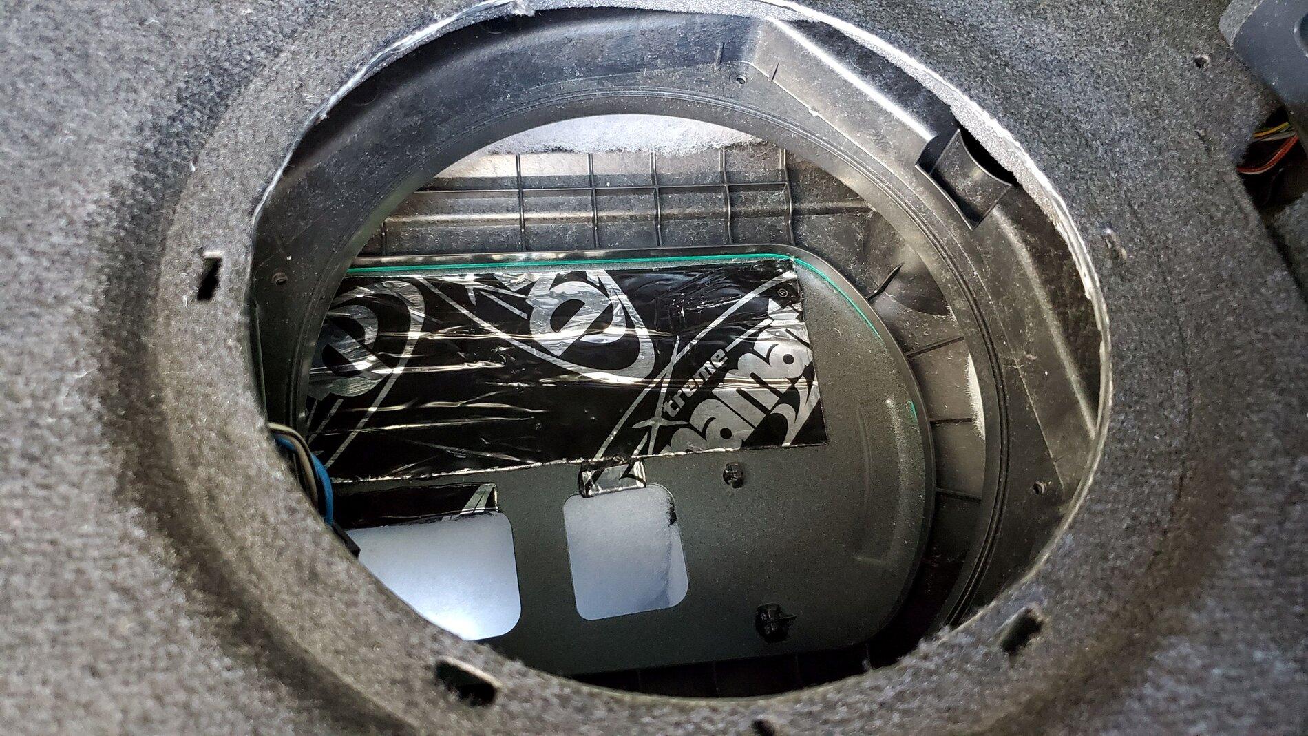

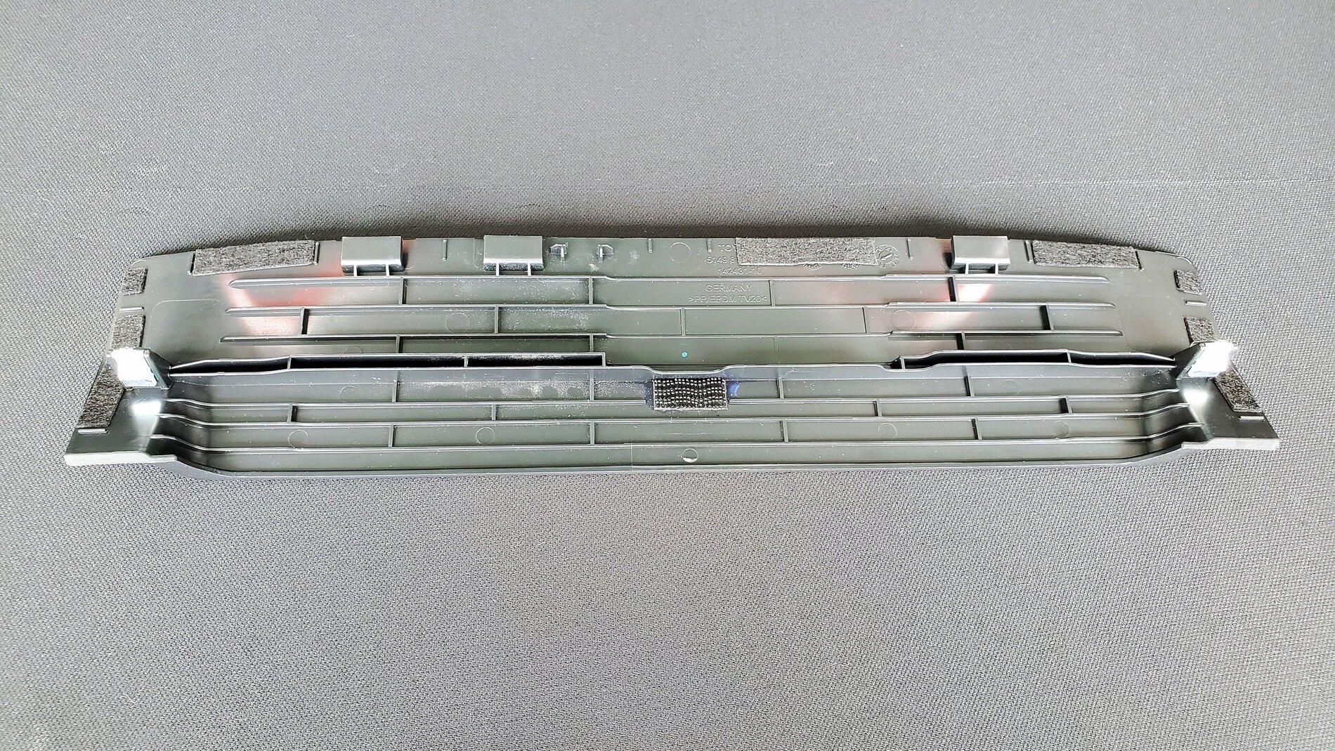

This pic might help clarify things...As you can see with the sub removed there is actually a top port and a side port ..you don't want to block either with the wadding.....
spta97
Mar 19, 2021
200
118
New York
GF Shopping a Supra, BMW X3MC
Thanks Tom - yes, that is how I figured it should be done (after doing it incorrectly lol).
Today we'll switch around the batting and tackle some of the other sound deadening (like the back piece).
Only part I'm missing is the self adhesive foam to block the underside of the (now ported) trim piece.

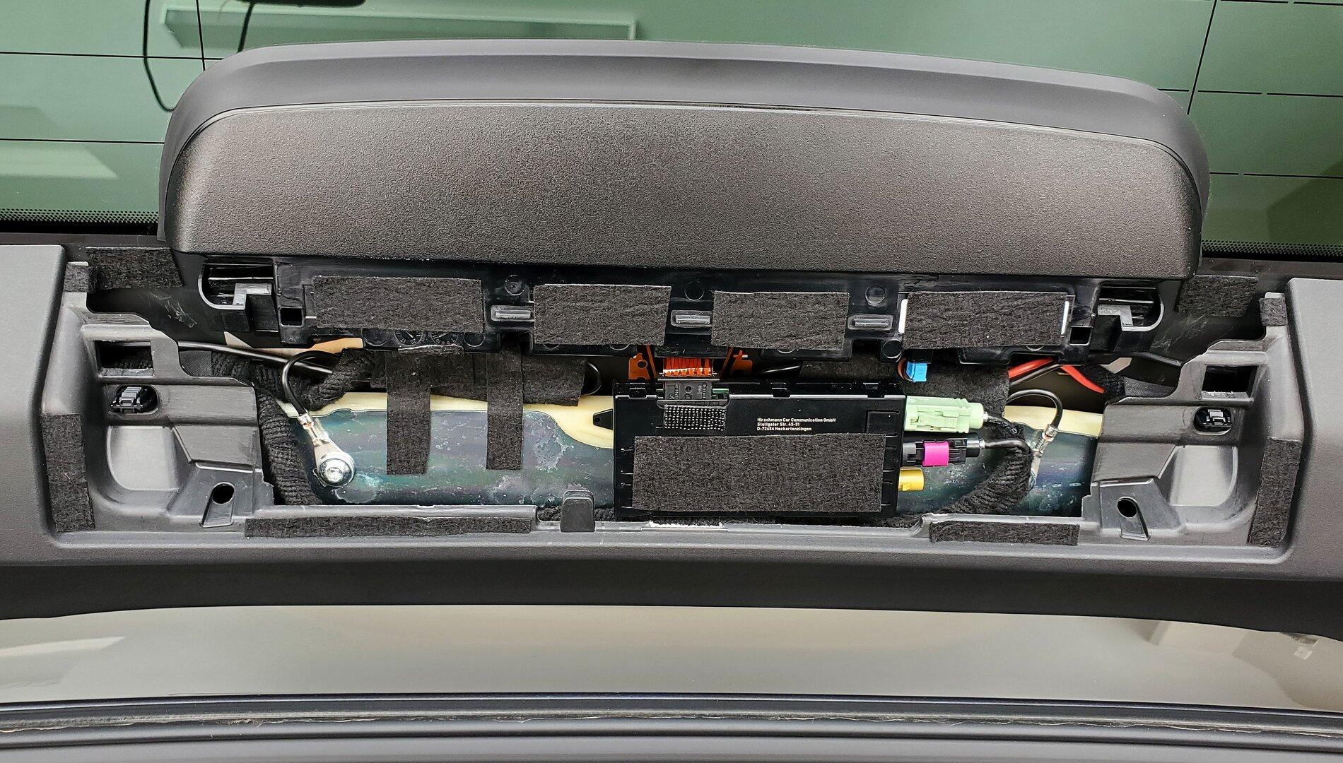

FYI...
Just applied adhesive backed felt tape to a number of places around the edges of the plastic rear hatch brake light cover and contacting hatch surfaces....There was a good amount of vibration coming from this plastic cover, particularly obvious during very low bass notes...Vibration from this area has been eliminated...

Did you also apply silicone adhesive between the woofer grill and cover plate as I mention in my 1st post? ..Those had quite a bit of vibration until the 2 plates were isolated from one another using that adhesive....
I also stuffed quite a bit of foam in the empty cavities within the subwoofer cover itself...
