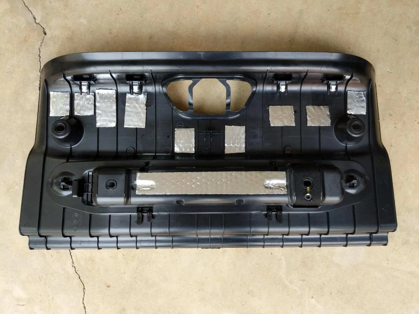

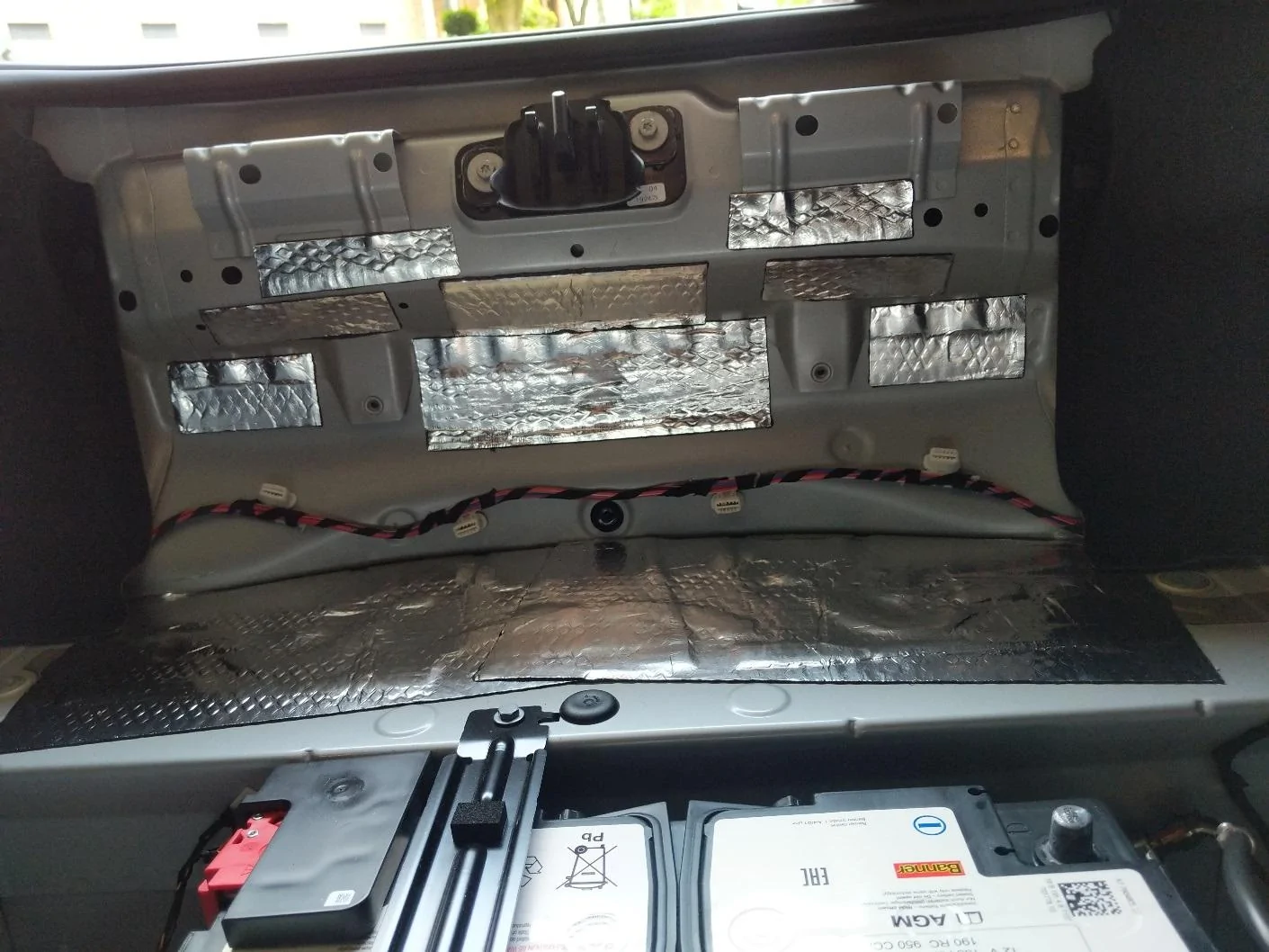

(3) Rear Lower Deck
This are is pretty straight forward. I just did section strips being sure to not cover any nuts, bolts, wires, etc. You don't have to cover an entire piece of metal with dampening to change the vibration response of the metal. Of course, the more the better, but any amount will have some affects.

Just finished adding the foam and taken her for a spin down the block. I gotta say I'm pretty happy with the overall results! If you're on the fence about doing this mod I highly recommend it! It will make a difference in the sound quality. Thanks for everyone that contributed!
