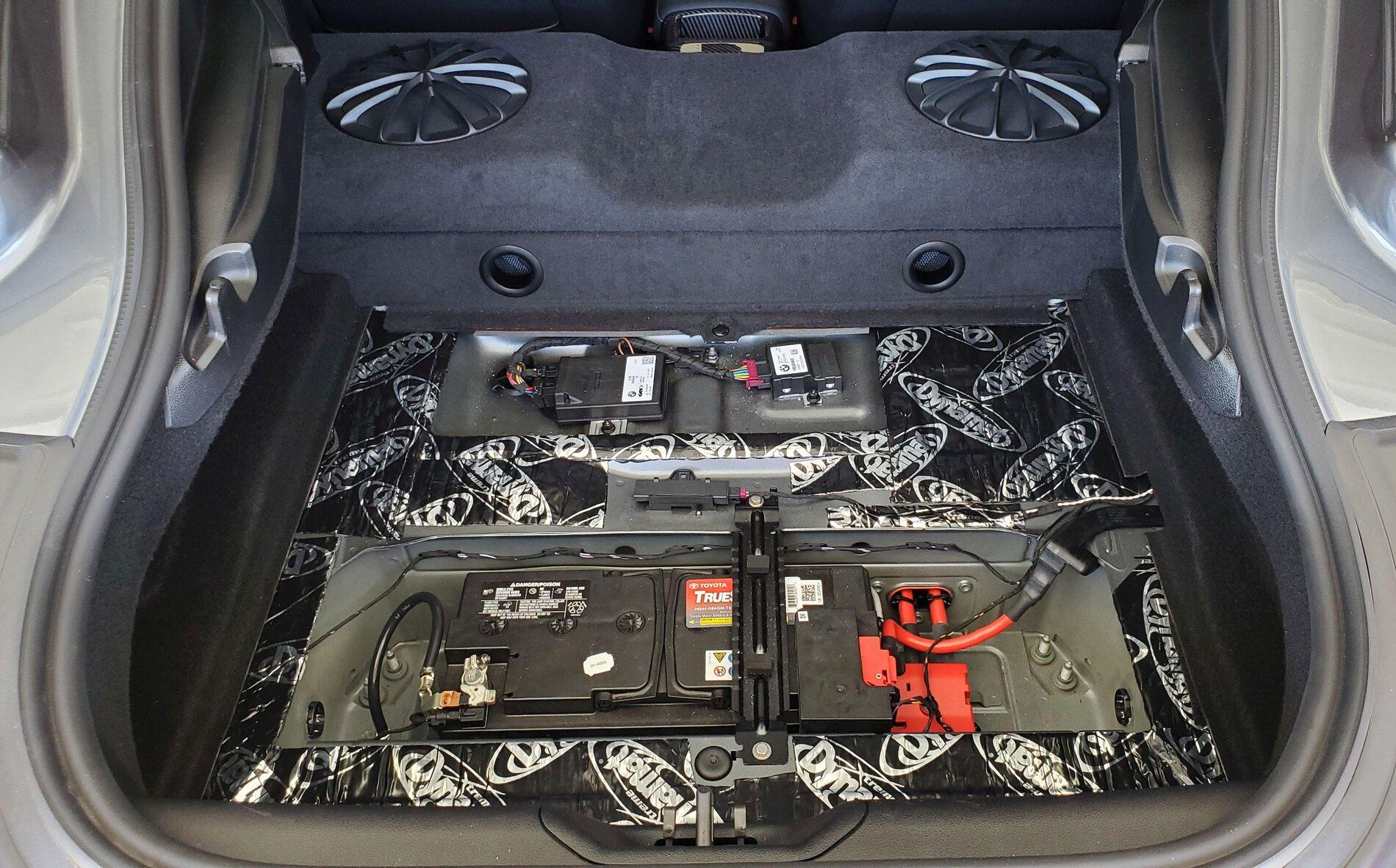

@tadda. I trying to remove all the trunk pieces to do the dynamite. I am currently stuck on the top side panels that normally hold the cover.
I'm not sure what pieces your trying to remove to apply Dynamat...I only did the rear floor under the cargo cover which only required removing the floor cover....
