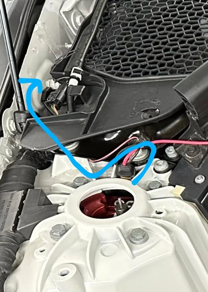

Can anyone explain how to remove this black plastic cover piece? It covers the + battery terminal extension in the engine bay. It has one tab to lift on the front side but I can’t get the back side off. Trying to install a battery tender connector. TIA!

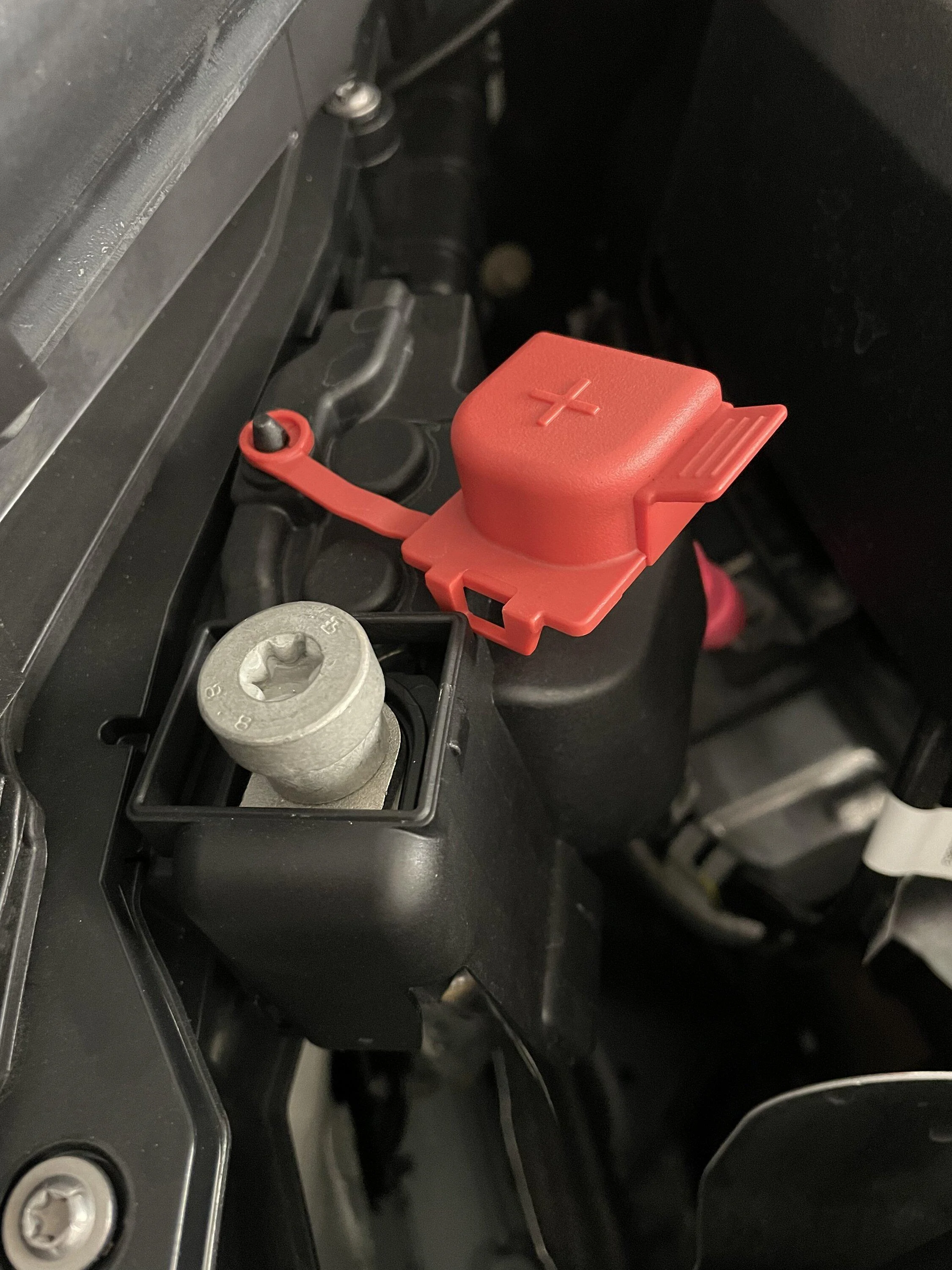

Looking at the picture I would say you pry the small tab on the left side out and use the tab in the front to lift up.
Hopefully that explanation made sense.
I put a blue spot where a tab is to pry. There is the same on the opposing side.

The red piece is already off. If someone needs instructions on how to pop that red cover off they have zero business doing anything in that engine bay. Just close the hood.

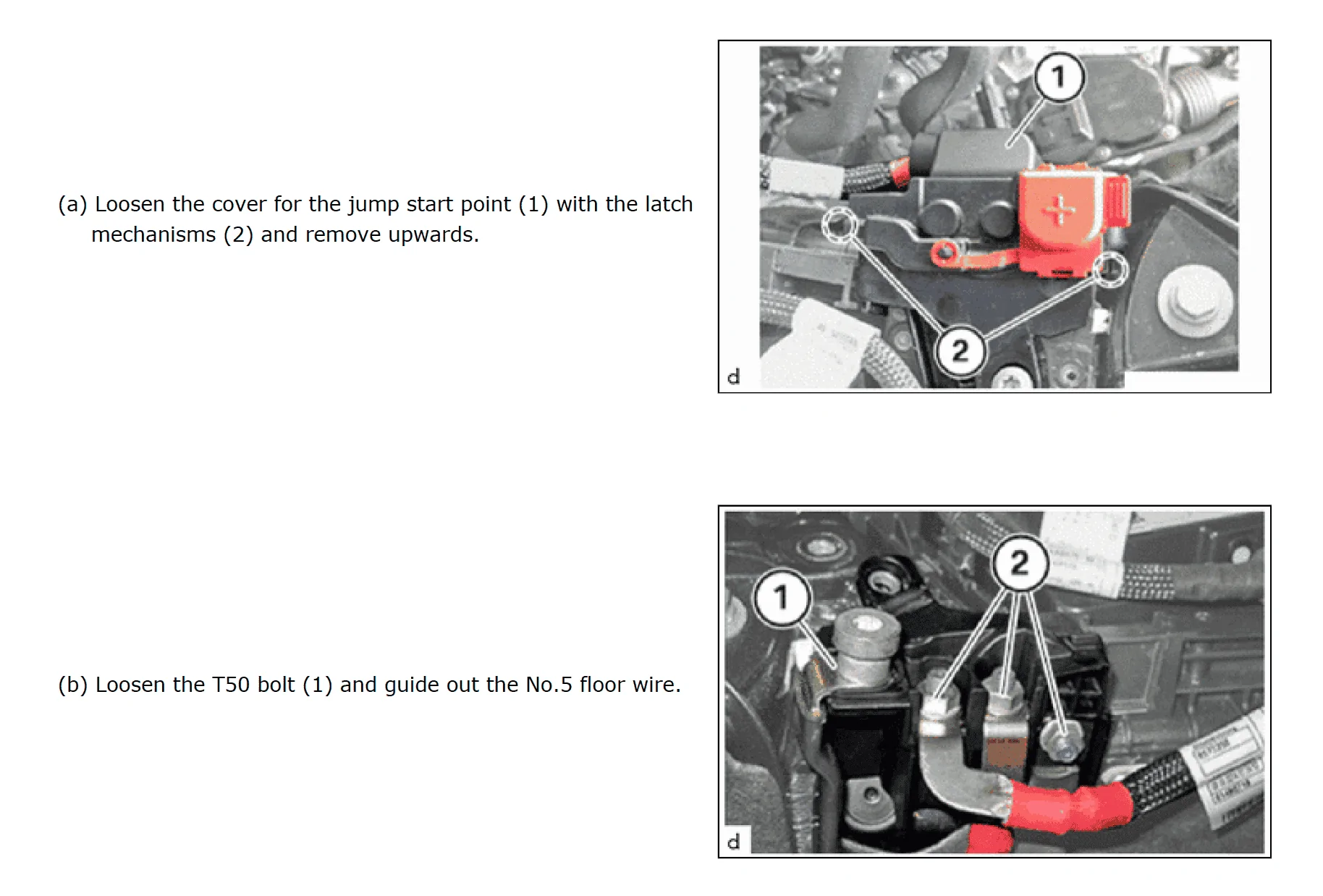

As far as the black part:

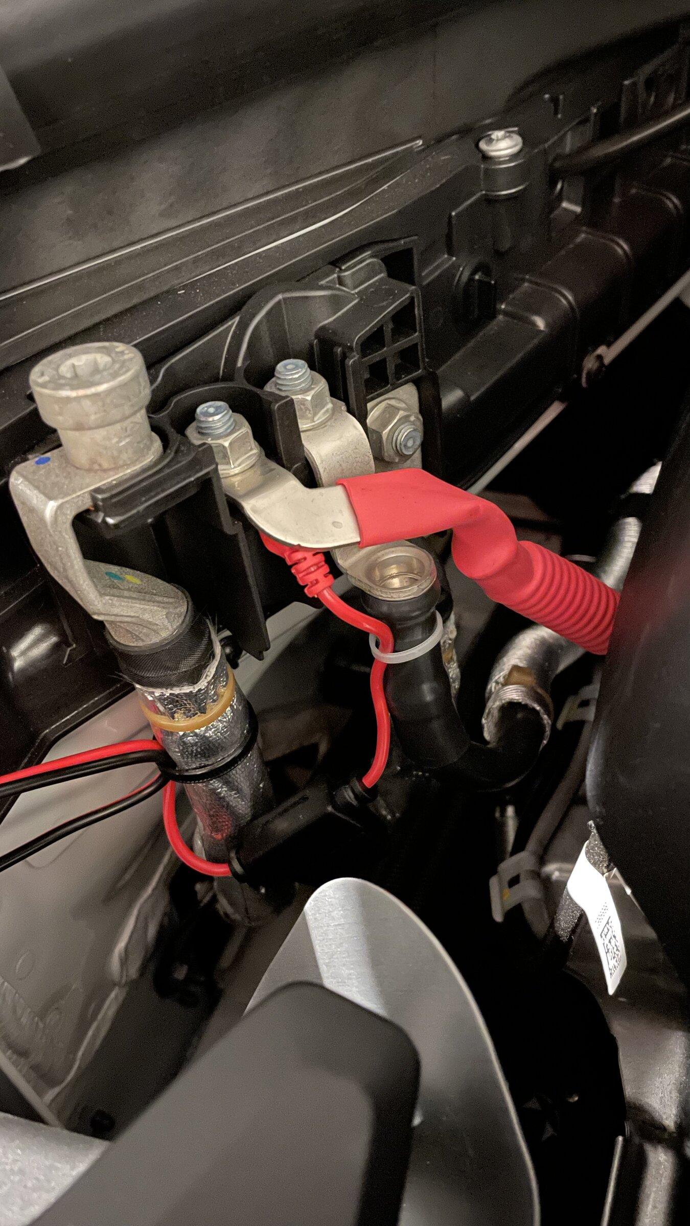

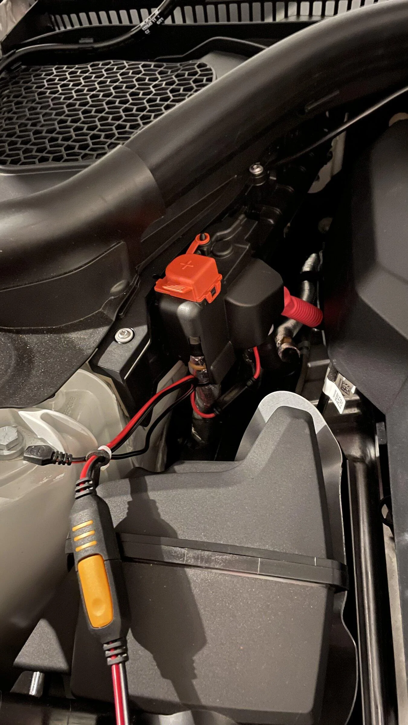

Here are mine for a starting point…
30
3,411
3,385
OMG 😱 What a clean job… Looks great!!! I really wanted to use alligator clips 😂 .

Sorry, totally glossed over that you wanted to do the clips. Positive would go on that massive looking bolt under the red cap. Someone else circled the negative post in the picture below…
