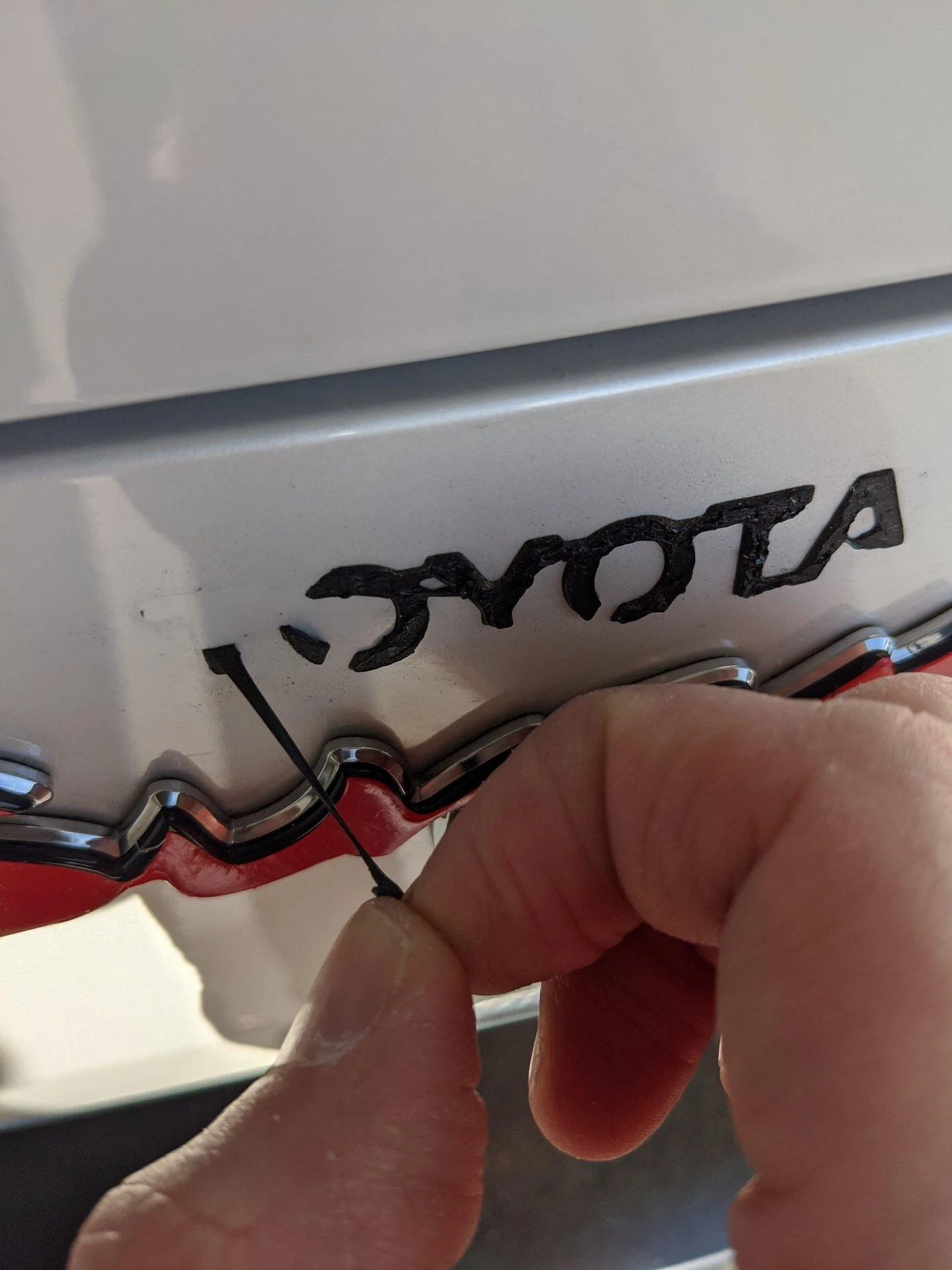

Hello,
Just did this today so figured I'd take some pics and write it up, pretty simple. Took amount 3 minutes all up

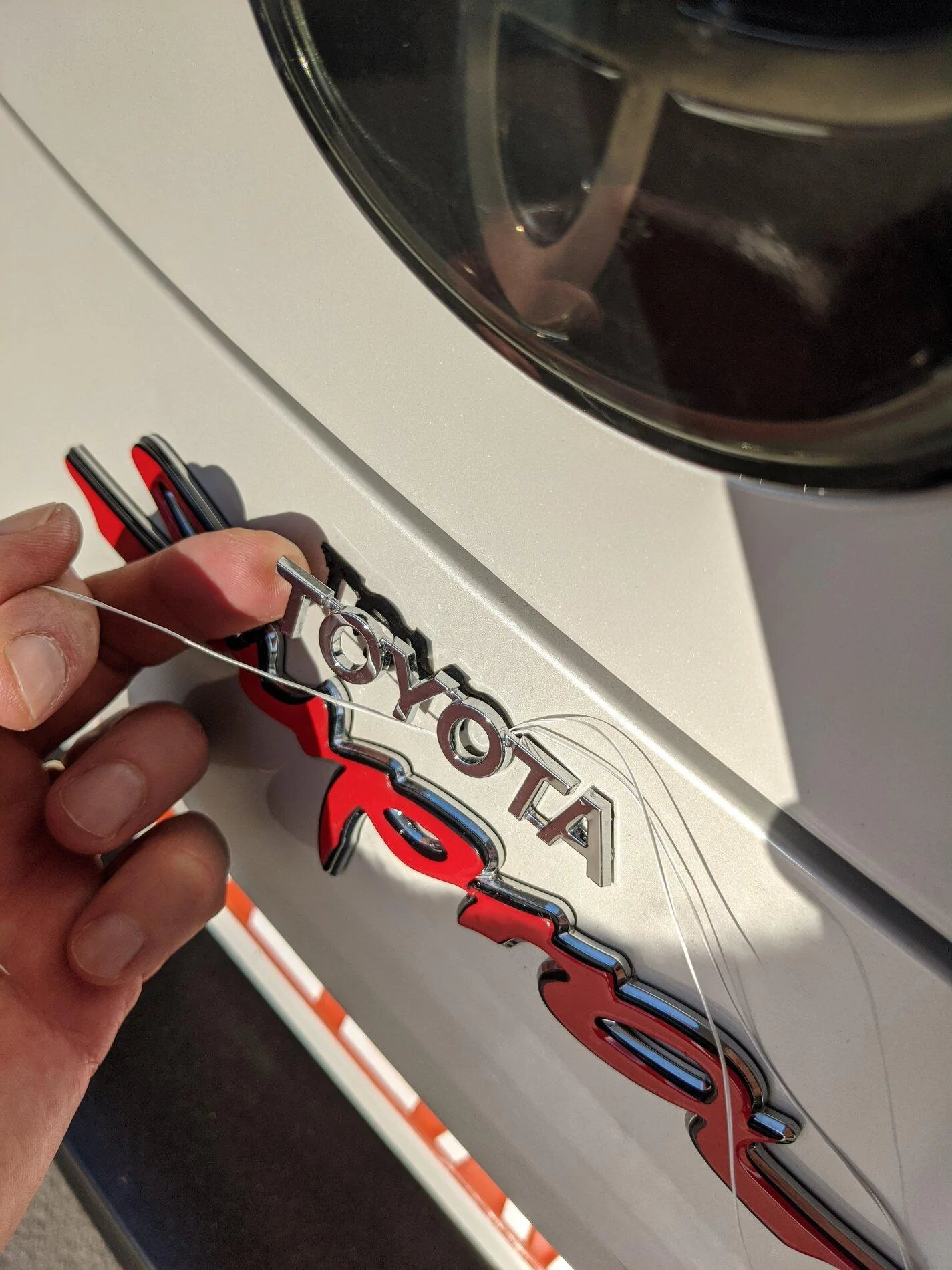

Works best on a warm day or if car has been in the sun for a while to loosen the glue, otherwise just use a hairdryer

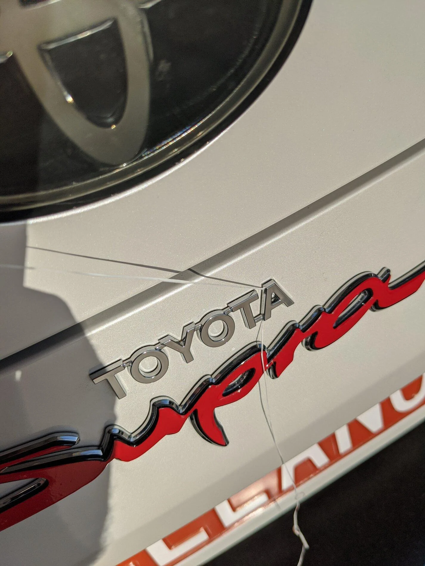

Get some fish wire, or even tooth floss if you double it up will be fine
With a sawing motion work your way through the glue, try the other side also working your way to the middle

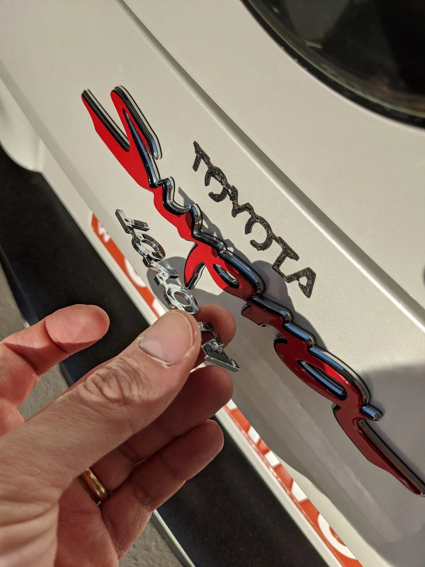

Eventually the plastic logo will come off totally

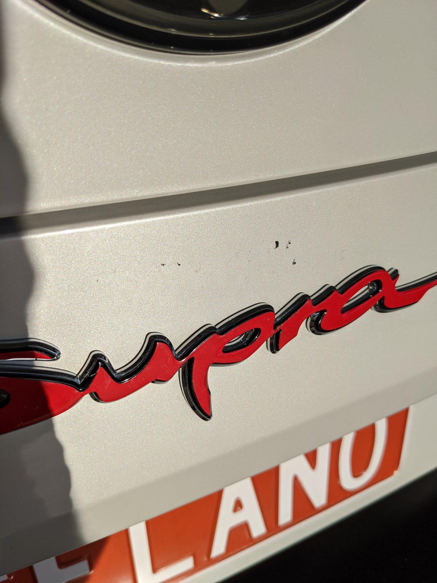

Since the glue was still warm I just started picking it off the paint and using clumps of the glue to pull the rest off

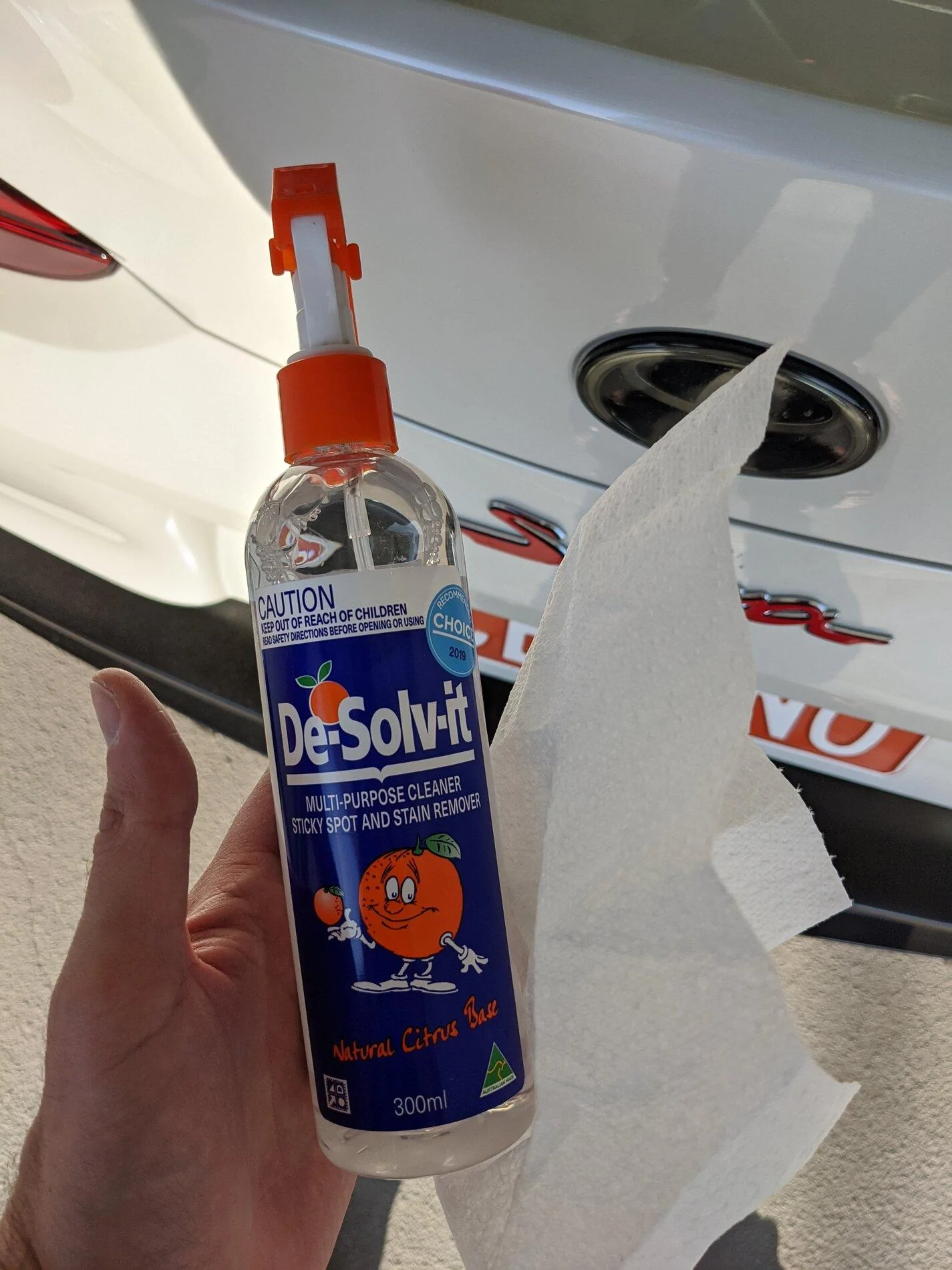

If that doesn't work then use a goo remover or eucalyptus oil to soften the glue
At this point I used goo remover and a paper towel to gently remove any excess glue

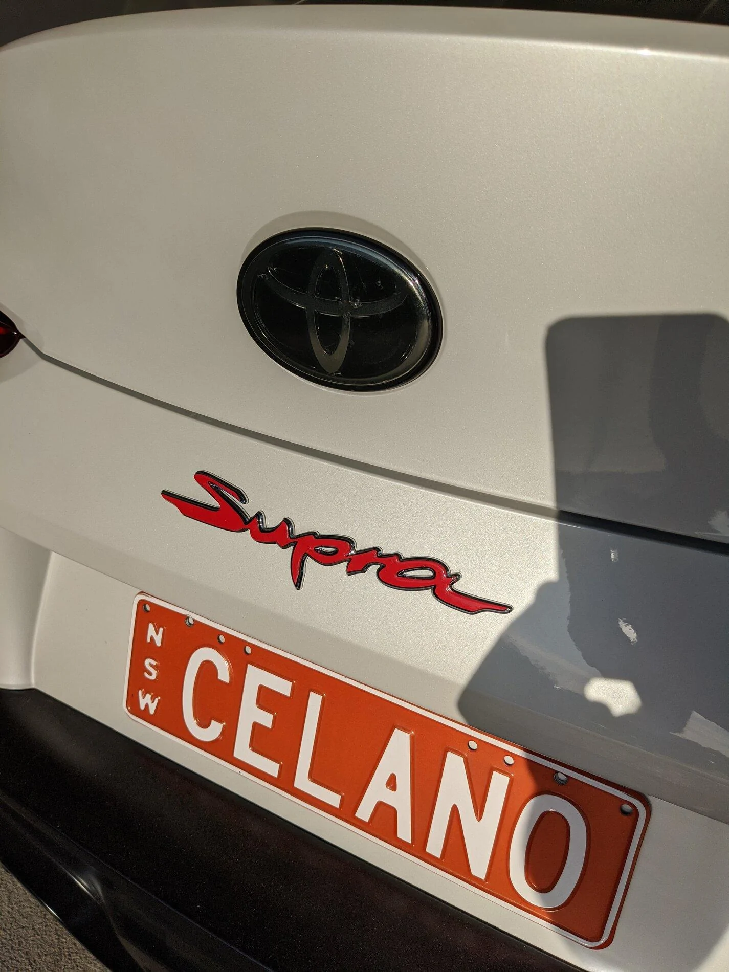

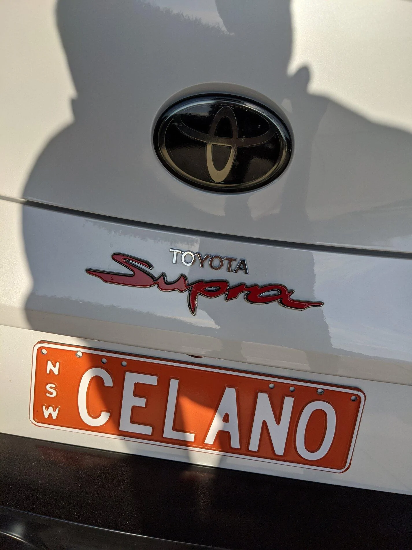

and here's the end result
Pretty happy with it, that TOYOTA logo was kind of silly looking especially since there was a round logo just above it

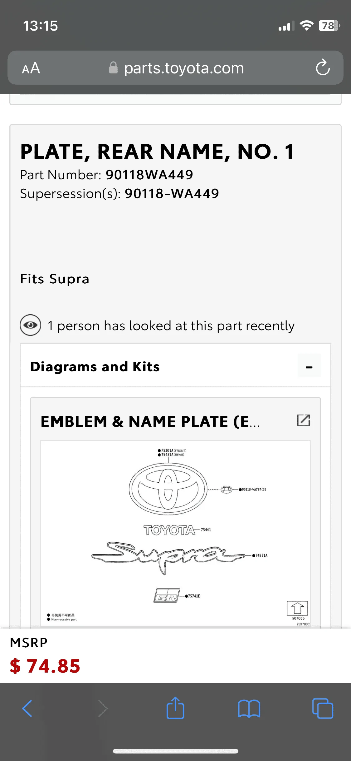

Anyone have the part number to this toyota badge? Future reference, possibly might add it on my car to be different. 👀

This is an old thread mate... 2020, i think he just put an overlay. Anyways, by chance would you happen to know or are you able to get me that part number of that Toyota badge for me please? Lol

Thank you bro, you saved me from throwing my phone into the wall because i found every other part number EXCEPT that one. 🙄
Be sure to select a local dealer below the price to purchase through. When I do that the price of everything goes down about 20% so it could be cheaper.

Yeah, eventually i'll get it, i'm trying to get a little notebook going on part numbers of stuff for the Supra that the US Spec ones don't come with. So far, tail lights, reflector triangle, and toyota badging. 😂 next up would be the matrix headlights that the US doesn't get. 🙄
