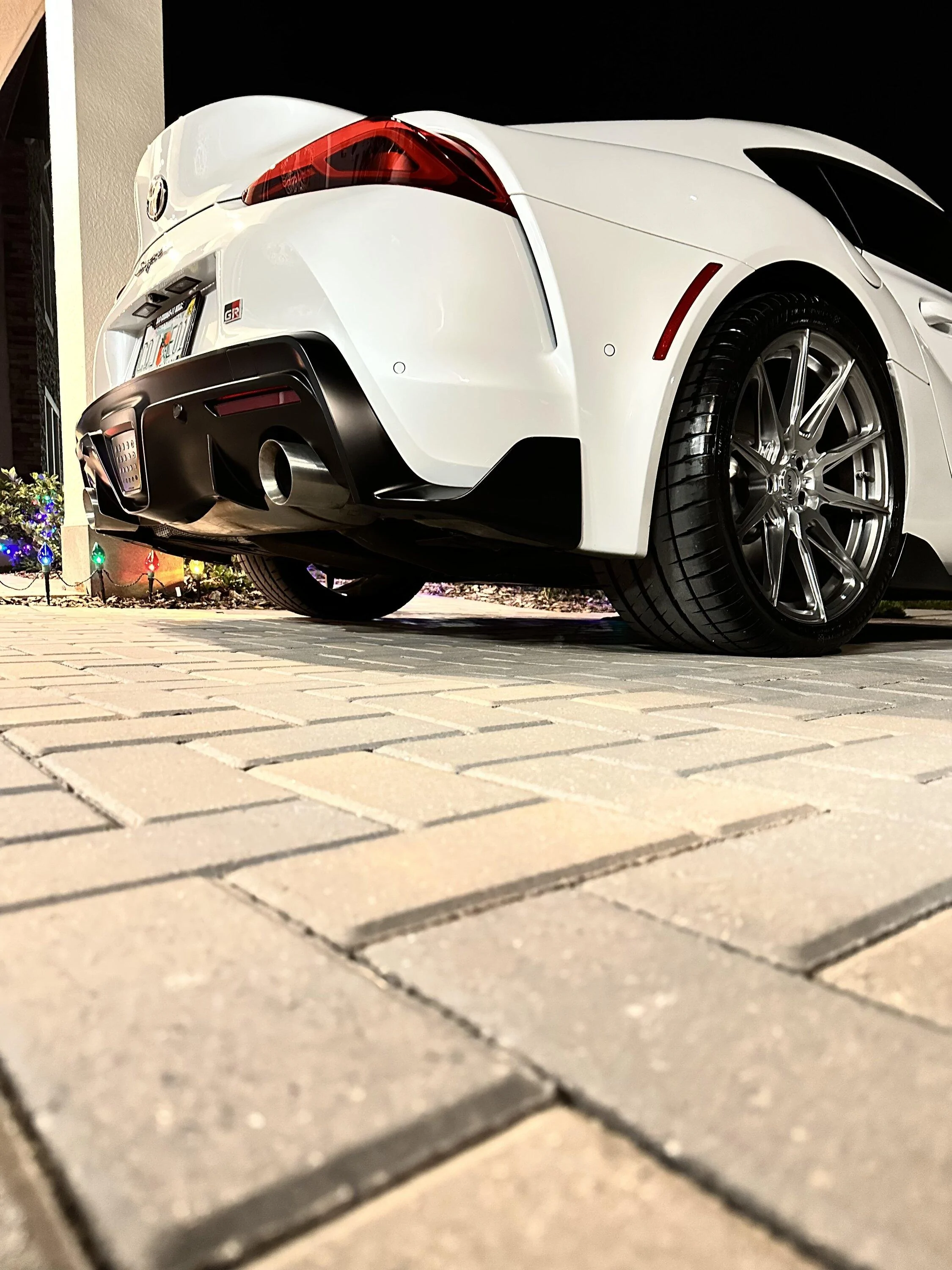

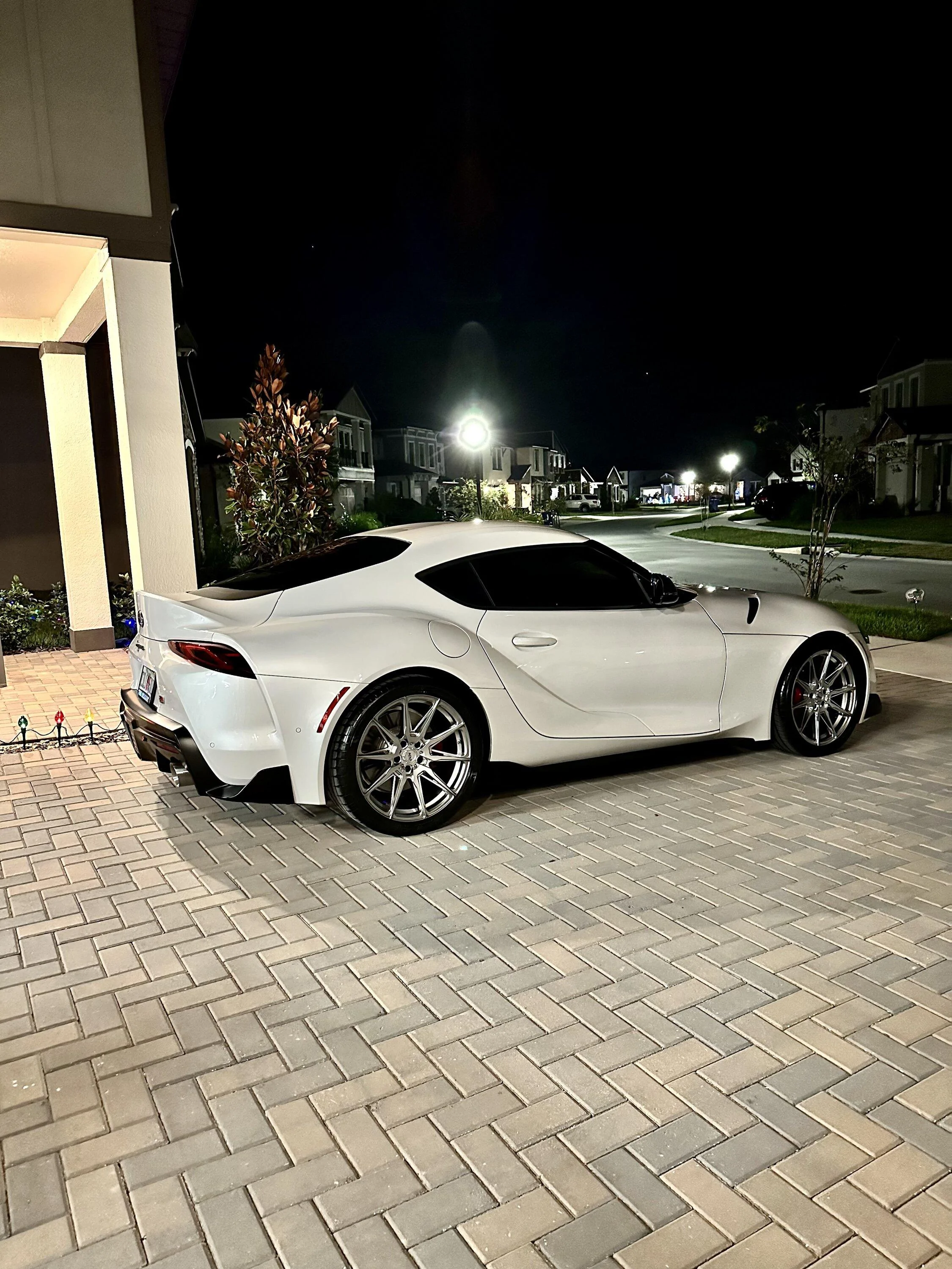

You can run a 305 on the stock wheel. Tiny bit of sidewall roll but totally doable. Here is mine with 305’s on the back and 275’s on the front with 19x8.5 front and 19x10 rear ADV1 5.0 wheels 25 off set rear should be about the same as stockers with 15mm spacer In the rear. Pics for reference…
