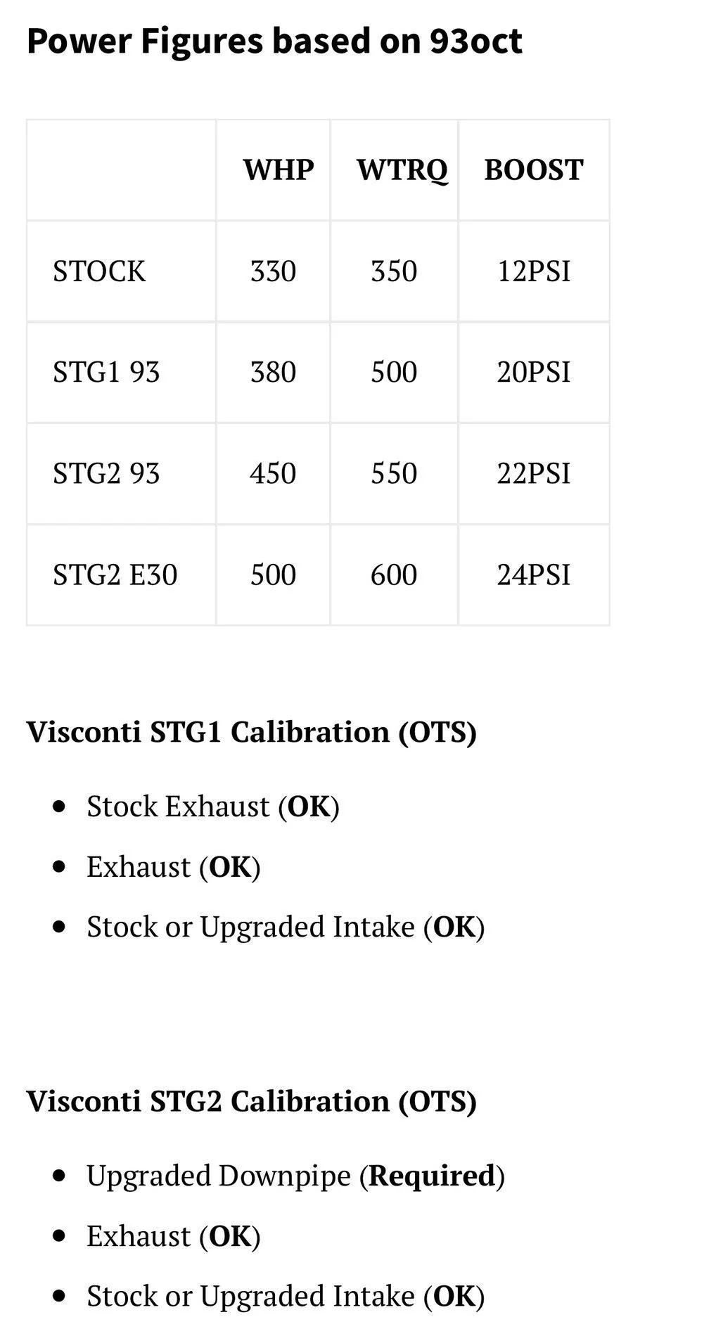

Unsure on exact JB4 gains, but Iā€™ve attached a photo of our average gains on EcuTek with modifications as follows.
Feel free to reach out if you have any questions. Happy to help. Contact info is in my signature.
I didnā€™t realize stock boost is only 12 psi.
What if you run stage 2 tune with a stock dp? It will just have lower hp and richer a/f?
Itā€™s just more what we offer as a ā€œstage 2ā€ package.
We can 100% custom tune your setup specifically for your modifications with no problem.
Someone wanting an off the shelf file, would just receive the one they need.
If you have any questions, feel free to reach out. :)

When you quote boost figures as in the above post, where is the boost actually measured? Is it at the charge pipe before the intercooler or is it manifold pressure after the intercooler?
It is actually highly variable. The car looks for a torque target and will adjust airflow depending on he environment to get hte power. So if its warm out and the timing is pulled back it would need aditional airflow to produce the same power level. Or if you were at a high elevation it would increase air flow. The car also runs in aboslute air pressure for its calculations so in Denver the absolute pressure of 2Bar is much different than Los Angeles.
