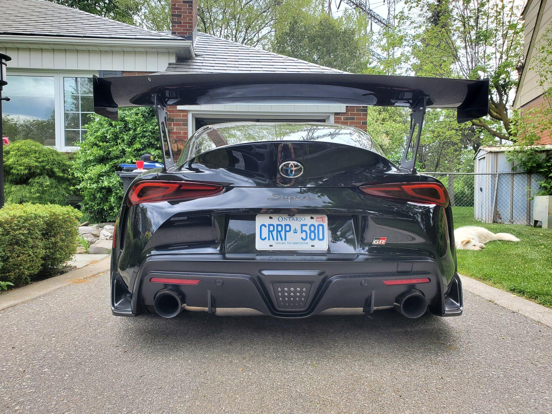

I got the Fi in black and I love it! It sounds really good, 0 regrets. Sport mode off its insanely quiet.
Side note wide angle made the verus wing look gigantic lol.
