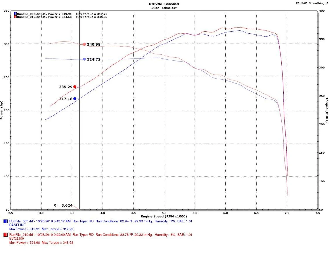

Here is link to Injen's dyno sheet they posted on their website for the Supra Evolution CAI ....
"Dyno Proven:
...Injen has put in the time and diligence to stand behind our performance data. We put in the time to test and prove that we have developed a superior kit for your 2020 Toyota GR Supra L6-3.0L Turbo. After hours of designing and dyno testing, Injen is proud to say that the EVO2300 Evolution Cold Air Intake system puts down numbers of up to 18 additional horsepower and 26 lb.-Ft. of torque..."

Every tuner I’ve spoken with says that intakes and charge pipes aren’t doing much if anything on tuned supras under 550-600whp..... With that in mind, Injens claimed numbers on a stock car are interesting... I have yet to see anyone else’s runs come up with more power than torque on the baseline run.... The Injen parts on my evo were the first thing that had to be replaced for a better flowing option when tuning so unfortunately I won’t be going with them again this round.
When the B58 engine was first released, i posted dynos showing the increase of each mod.
Intake on a full stock car made 5-8 whp more than stock airbox
That’s definitely a more reasonable number than what Injen is claiming. Their whole graph kind of seems off though.... I’ve never seen one of these cars (atleast on stock turbo) show more power than torque. Have you?
Looking at it a 2nd time, the HP numbers they show don’t even match what the graph shows? Seems like Injen might be fudging some numbers. Idk... I’ll stick with the HKS for now
I think you need to view it a 3rd time...Look closer, the left and right vertical axis are not "scaled" the same and the left y axis is "power" and right y axis is "torque"...The indicated power and torque values on the plot are reading correctly...
Oh wow, I stand corrected. I’ve never seen a graph laid out like that and completely overlooked it. What a dummy :confused::confused:!
I’m still not convinced that the claimed gains are legit. No way Injen makes a better flowing intake than the likes of Eventuri, AMS, etc.

Oh wow, I stand corrected. I’ve never seen a graph like that. What a dummy :confused::confused:!
No worries...from time to time various tuners and shops choose not to sync the left and right vertical axis.....
I'm always skeptical on any power claims when it comes to intakes regardless of who it is! That said, Injen is a solid standup company and has been at this game as long as the others mentioned....

For the hp, it all looks to happen down low, not up top. That's quite nice. A decent amount more torque down low too. Someone should Dyno this intake themselves to see if numbers down low are similar.
