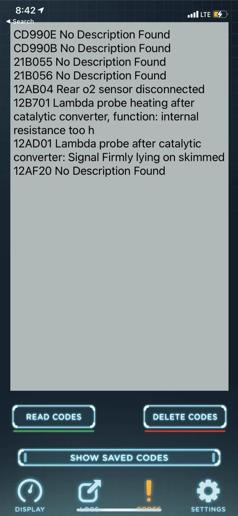

Is my O2 Sensor Bad?
andrewtrxnn
Andrew
Sep 21, 2020
Irvine California
2020 GR Toyota Supra 3.0
Everything seems normal to me except signal skimming. I have Megan Racing Catless Downpipes with an 02 Extender on the downpipes. An CTS Intake and a JB4 Tune. I occasionally run E30, please let me know what might be going on. Will it cause my car to run any differently?

I was also getting some random codes with my catted DP prior to doing a tune. jb4 does not turn off the o2 codes, so you would need to do an ECU tune and have those codes tuned out.

Did you ever figure this out? I just got the same codes...I've gotten many different o2 codes with ets dp, but the heater one is consistent...the skimm one I read it means you were running too much e and your dme thinks you're always running lean...I am testing that theory now...my car is running really rich according to jb4

If you change your dp then expect the o2 sensors to trip

I understand that, many people are running aftermarket dps with no cel...I am also on a e30 blend and always pay attention to cel in case it's something important...I was just wondering if anyone was able to fix this issue. I changed the o2 sensor and cel just came back after 2 weeks...wasn't sure if I am doing something wrong

Which dp you have?

Ets catted dp with 4in connection...
Sometimes those throw CEL. Nothing really you can do.
Well.. besides getting a different dp. If you’re that worried about the light

I am not...but I just read the cel should be a cat efficiency one not a lambda probe heating after cat malfunction with internal resistance too high...

So does that mean I have a bad o2 sensor? Or is that cel also possible with aftermarket dp?
