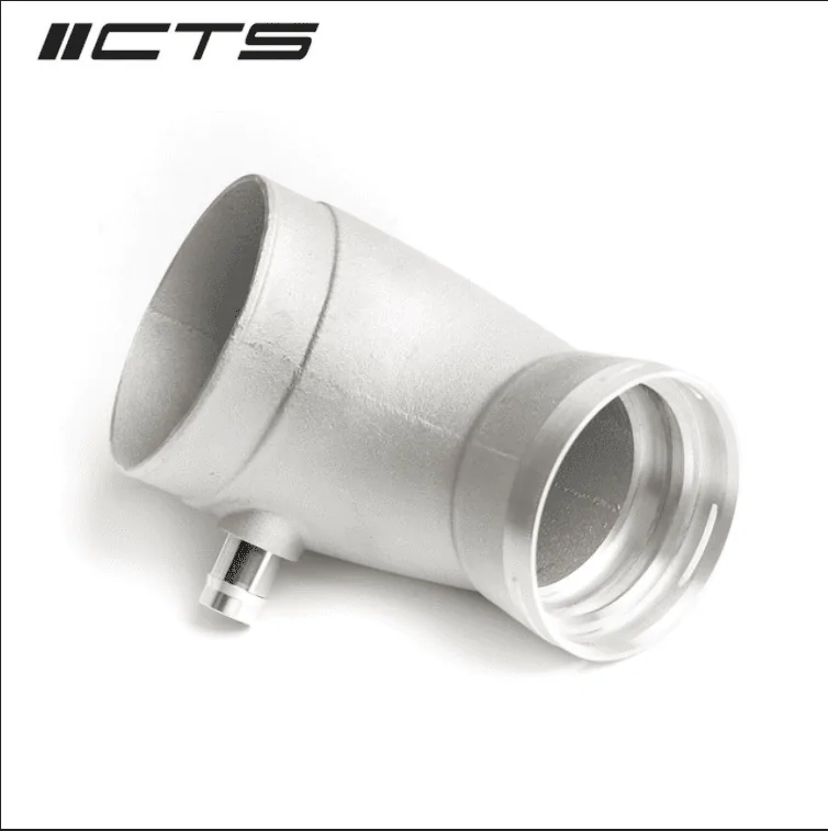

I had the MST inlet on my car for a while, I actually ended up going with the MST V1 (top) and a CTS cast inlet that I had powdercoated...
